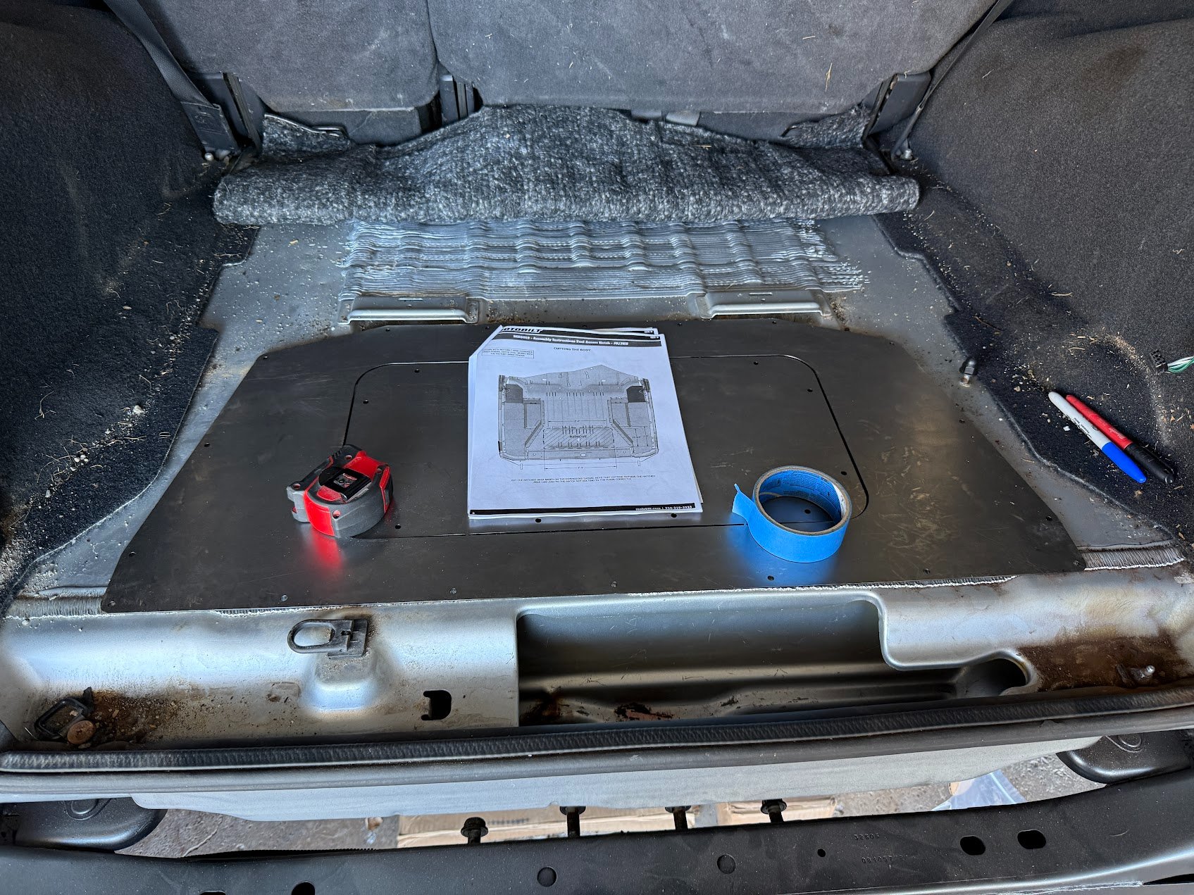

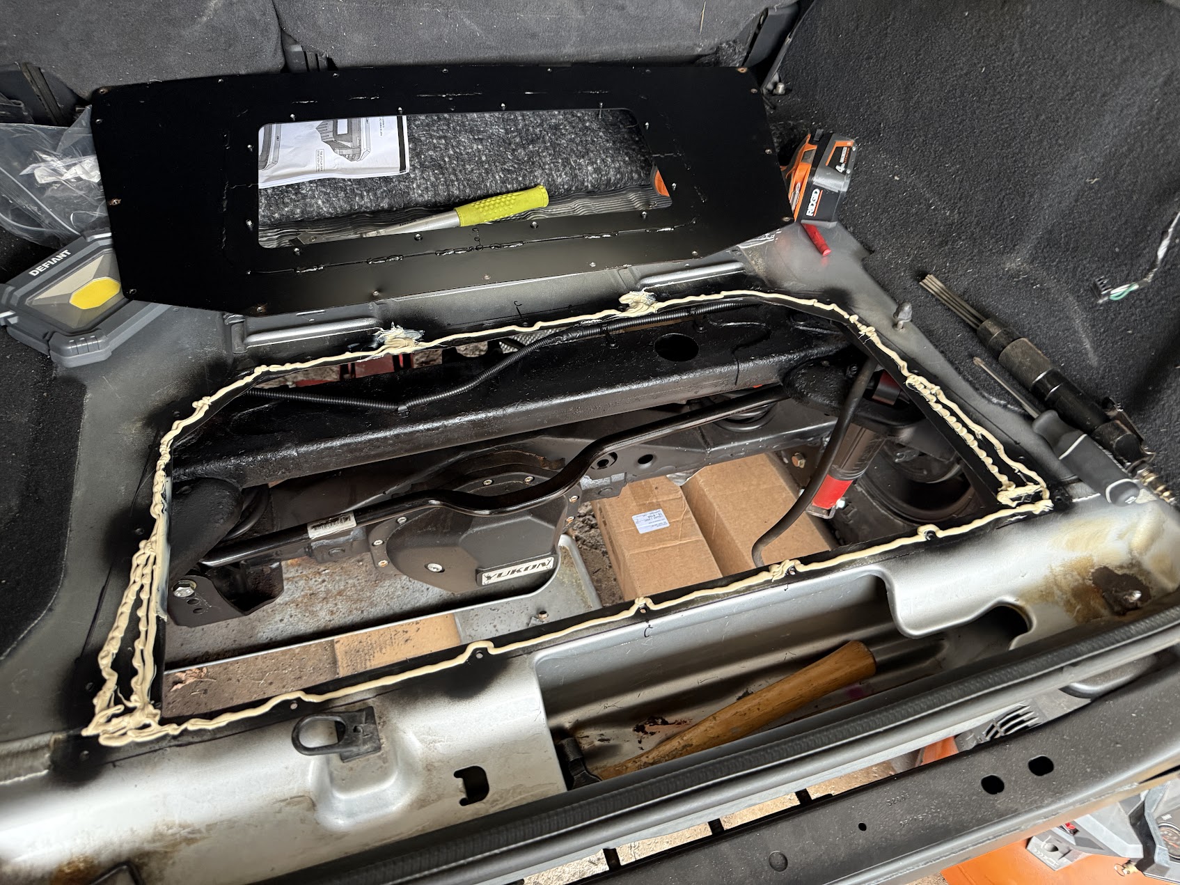

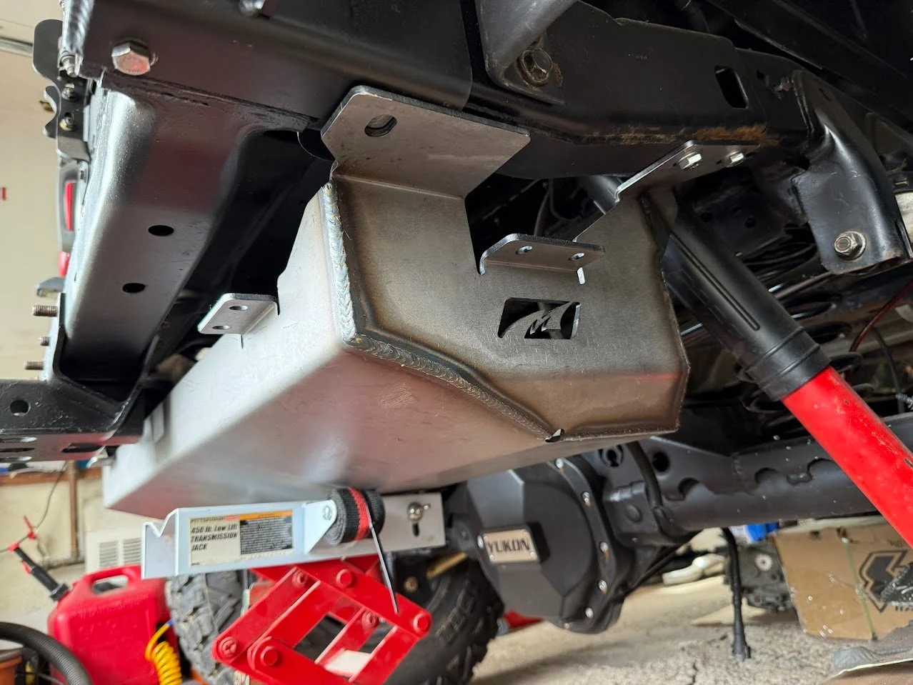

The Motobilt Rear Fuel Tank Kit arrives today, so over the weekend, I worked on getting it ready. The first step was getting the fuel filler neck removed and trimmed out.

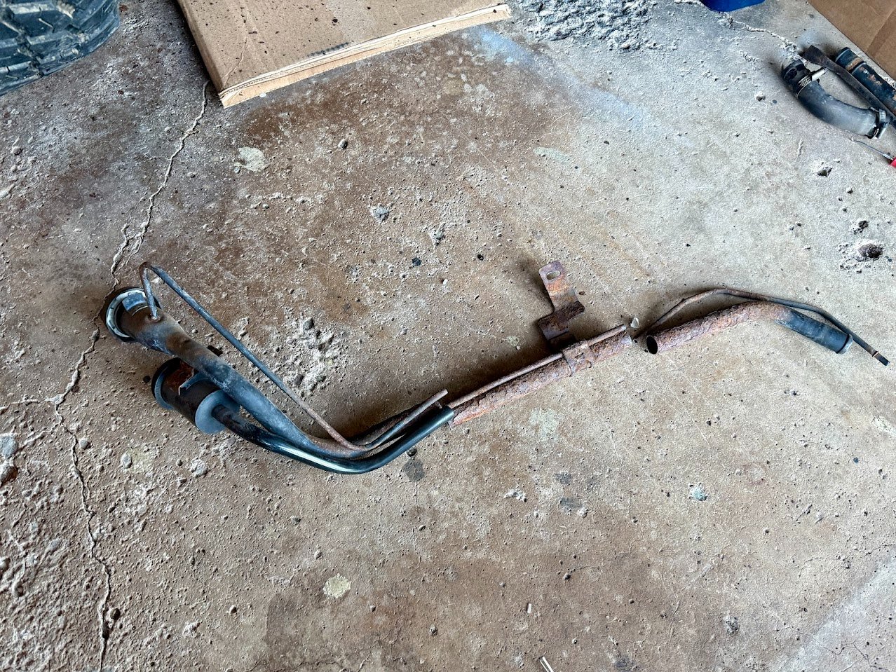

I was shocked that it could not be removed without lifting the tub. Since I don't need to "save" it, I simply cut it out with a Diablo Sawzall blade, using the space in the "notch" in the rear driver-side wheelwell opening.
The Motobilt tank doesn't allow the use of the factory rear sway bar, so you have to run a Currie or similar. Unfortunately, removing my OEM sway bar led to this:
I need these holes since the Motobilt rear tank skid uses them as a mounting point. So far I tried to get the broken bolts out with the "weld on a nut" trick, but it's being stubborn. I may have to drill these out and run a bolt/nut through the frame...

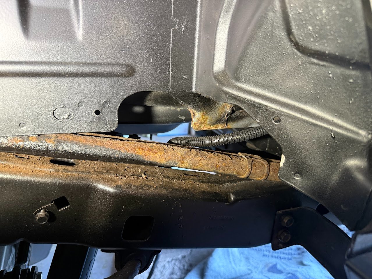

Update 5/27/2026

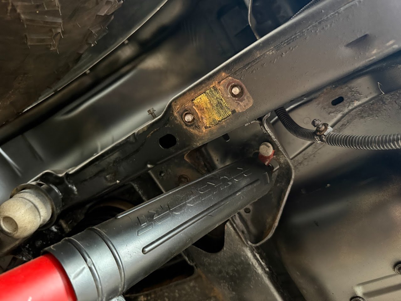

Getting back to the gas tank install, it took me some time to deal with these broken bolts. I went through about 20 nuts trying to get a solid weld onto one to get it removed, but with no luck. I ended up drilling out the bolt and the nut on the inside of the frame. I then used a step bit to open up the drilled hole to just shy of the welded "nubs" on the nut that was holding it to the frame rail. A quick whack with a chisel and they popped free.

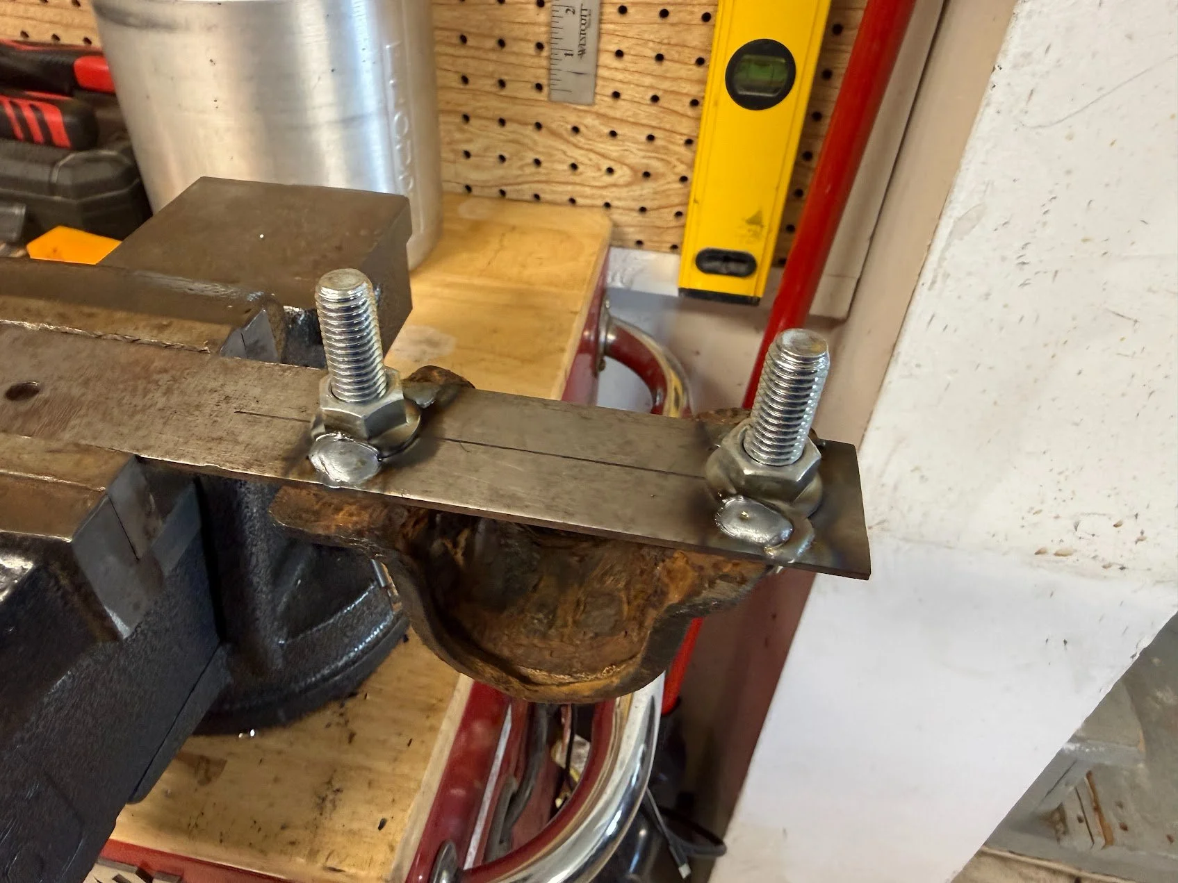

To remedy the missing nuts, I made a nutplate that I can install from a hole in the frame, even with the bumper installed. Nothing fancy, just some nuts that matched the factory bolt thread size (this way I don't need to use a different socket on either side of the tank):
Test fitting the tank skid was easy, though this thing is a little heavy and the awkward shape makes doing it by yourself a little tricky. Luckily, the Harbor Freight Trans Jack worked perfectly for this:

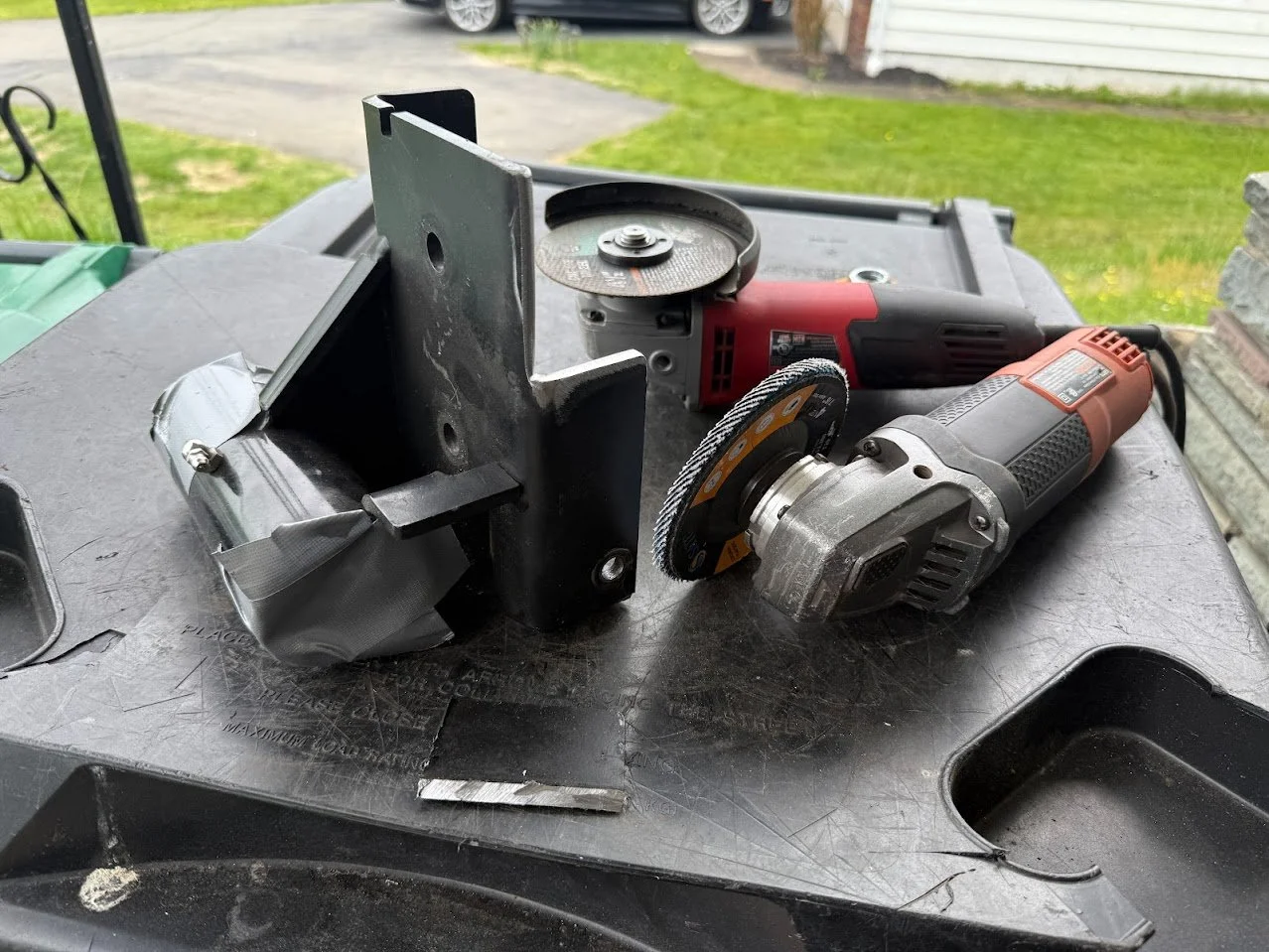

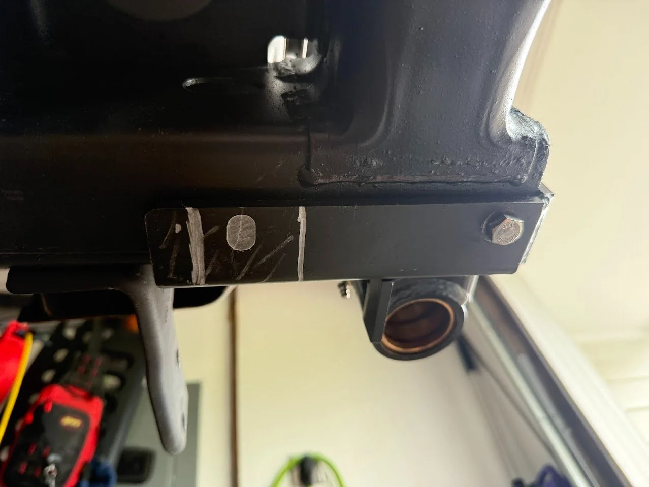

The frame bracket for the AEV Tire Carrier cradles and wraps around the frame right where the rear-most portion of the tank skid gets bolted down:
A quick hit with an angle grinder fixes this:

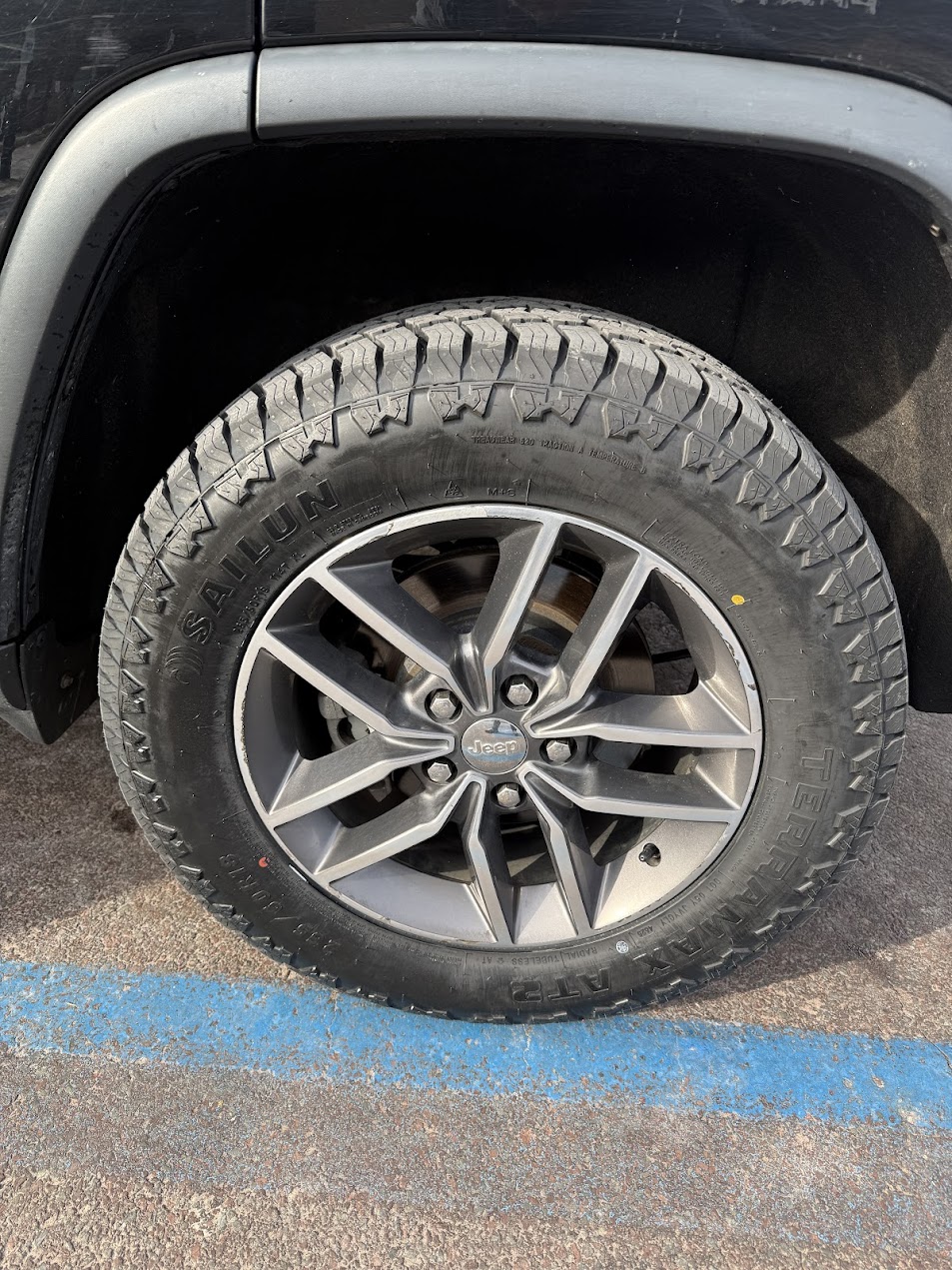

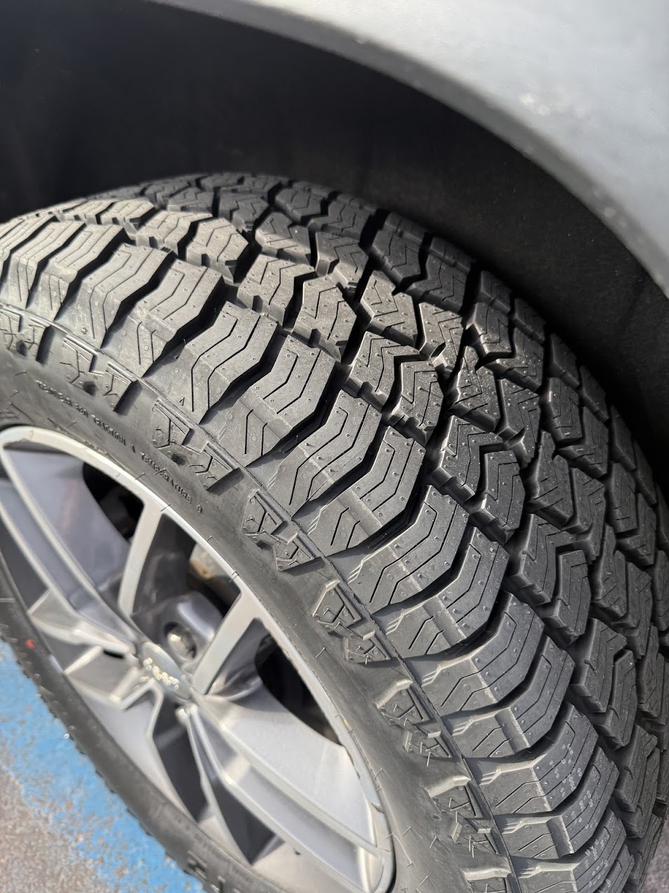

With winter (almost) over, it means it's time for some maintenance, first of which was some new shoes. We had great performance, but TERRIBLE life with the Cooper AT3x tires. They wore out fast and got noisy quickly. They also never wore smooth, despite plenty of rotations and checking the alignment three times on this Jeep over the past 6 years.
I don't tend to go with "budget" options, especially when tires are involved, but I went with these "Online Only", house-brand of tire sold by Discount/America's Tire (made by Saliun) thanks to a few recommendations. They are significantly quieter than the Coopers (even when the Coopers were new, they still very much sounded like an "A/T" tire) and so far have had great wet weather grip (I've done some heavy brake tests just to make sure I was comfortable with them). The tread pattern also very closely matches the pattern of the Evoluxx Rotator tires on the Islander, which have proven to be really good for snowy/icy roads here in the country.
Assuming they last a while, I think these will be a good option for her. We got all four installed for $413, thanks to a $$ credit we got back due to some of the Cooper tires wearing out significantly faster than their warranty mileage.

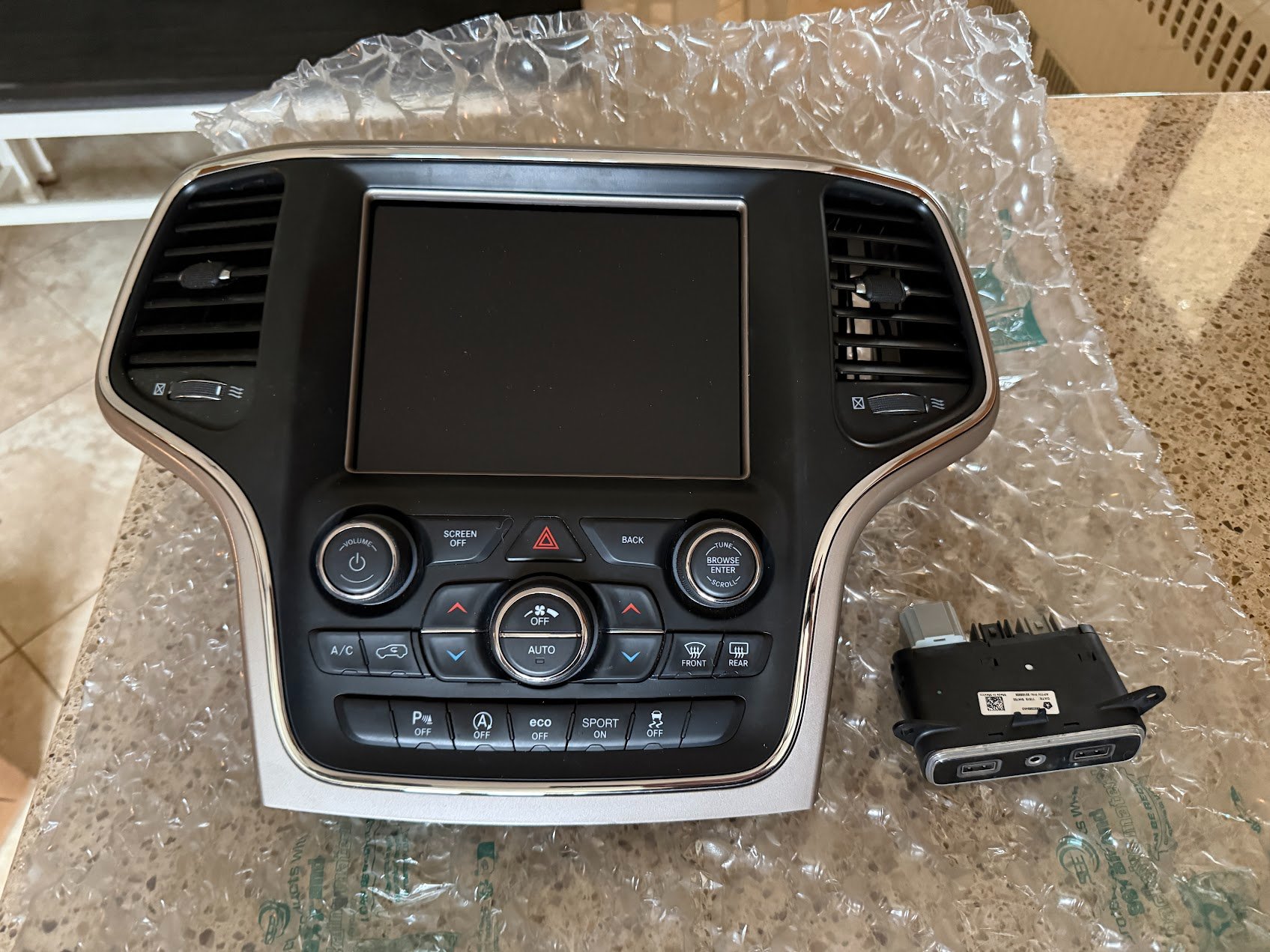

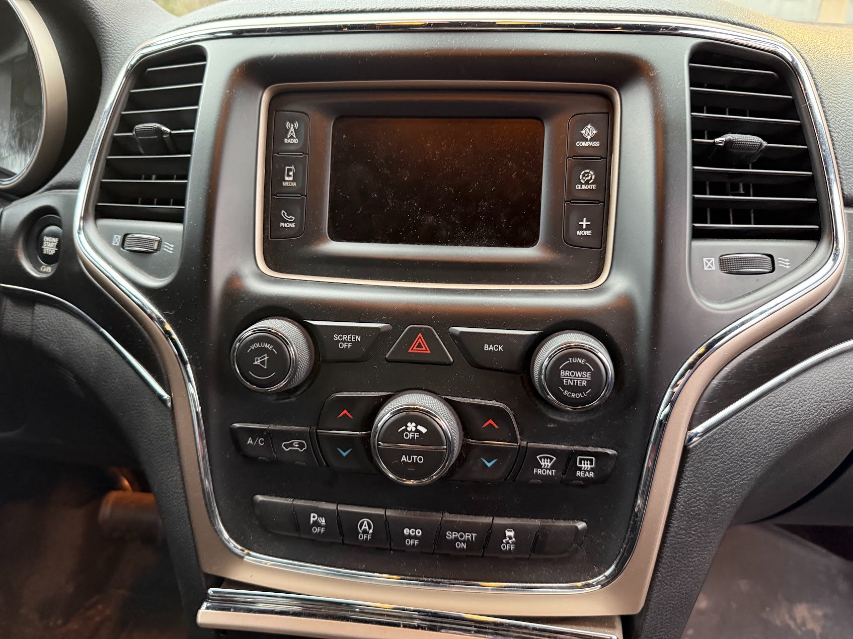

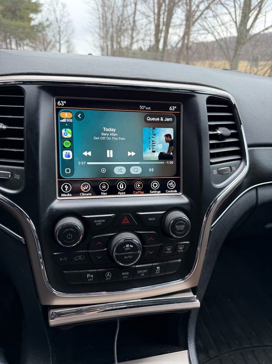

Also part of that deal was to swap out the baby radio/screen to something with CarPlay.
I had wanted to do this for some time, but could never justify the expense (at least not as of a few years ago when these upgrades were $2200+). I was able to find a 2018 Grand Cherokee 8.4" UConnect with updated "Media Center" (to replace the factory one that only have a single USB port and a SD card slot). I got the radio, color matched trim ring, and media center for ~$800.
A whopping 30 minutes later to install and let update, and it now has CarPlay, a remarkably faster BT connection, and a bigger backup screen.

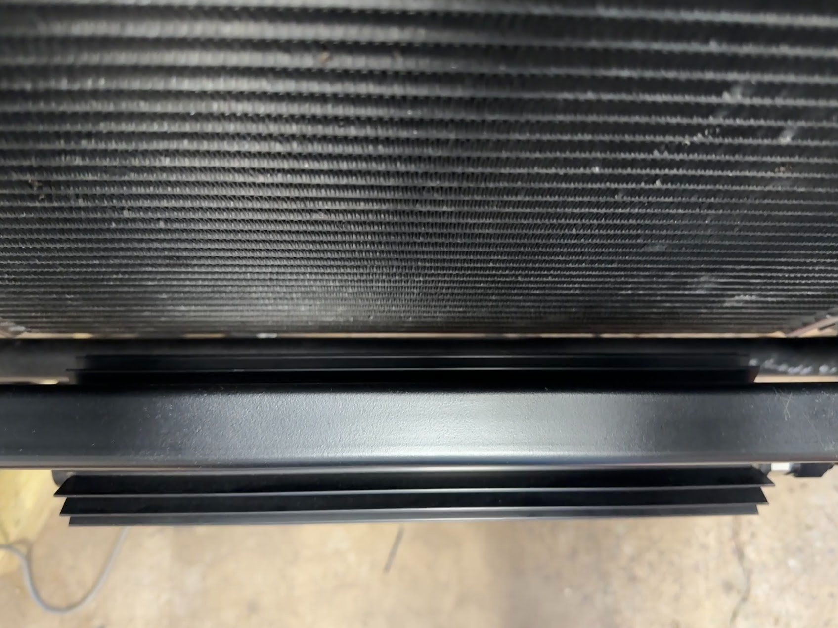

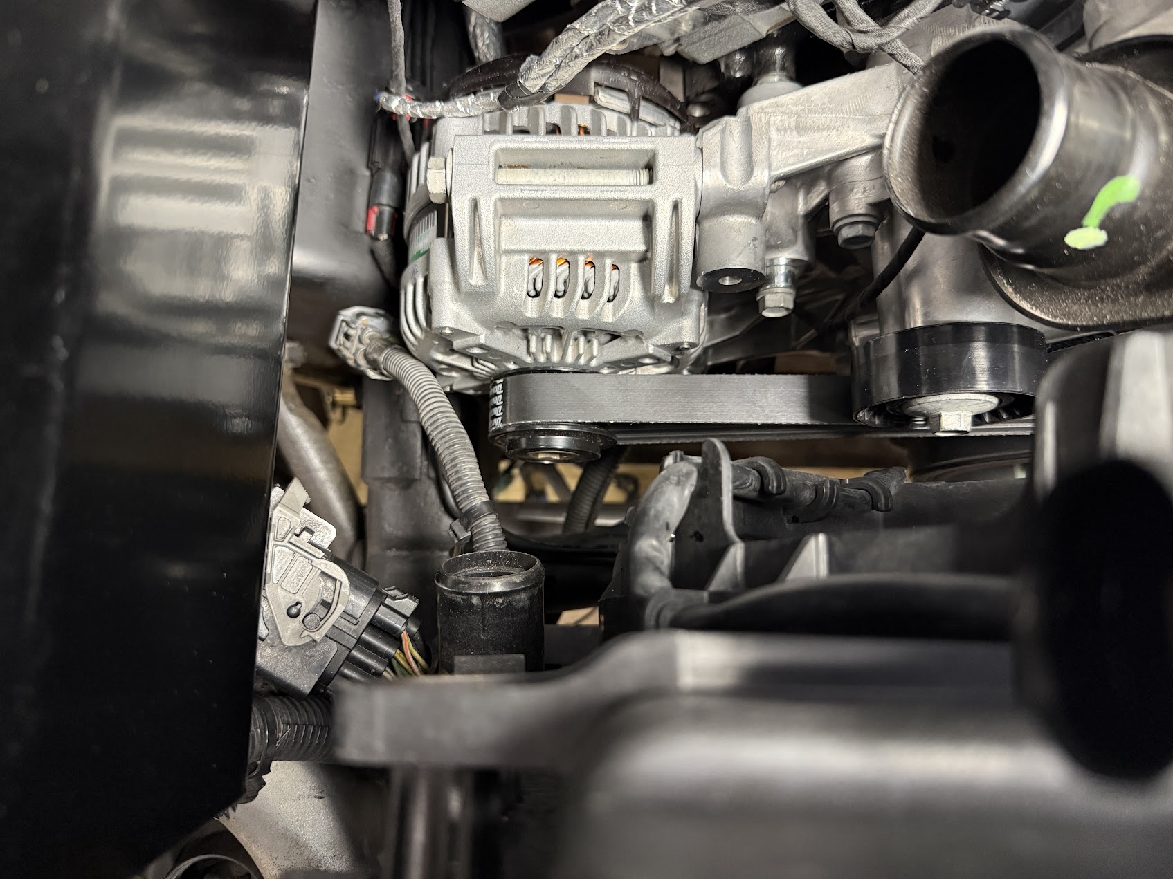

Speaking of radiators, I'm working on getting mine sorted out with the Hemi swap. I will need to make/modify some of the brackets to work with the OEM 392 JLUR cooler (above), but this looks fairly simple. Unlike the OEM transmission cooler that is integrated into the bottom of the A/C condenser, the 392 JLU unit is standalone and is at the top of the radiator, instead of the bottom.
This is a good thing since it gives me a lot of room to locate the PSC fluid cooler:
I may order the PSC "dual pass" version, which has both the inlet and outlet fittings on the same side. Given how tight the radiator and hoses are down there, it's one less thing to have to "fit"...

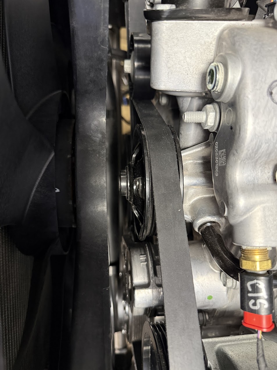

I test fit the Pentastar radiator fan and as expected, I have ~3/8" clearance between the fan motor and the water pump pulley. This is excellent news as it means I won't have to move my grille support at all and will eventually be able to do a proper front "chop" bumper.
With the fan fitment confirmed, I'm moving my attention to finding/making some radiator hoses. Since my hope is to run the OEM JKU radiator, I need something that connects the lower Hemi outlet (1-3/4") to the radiator inlet (1-1/2"). Thankfully, the upper hose for a Durango looks like it will not only work for the upper hose, but with a chop and union, might be perfect for the lower hose too! I've got some unions coming today, so I hope to play around with this and cross one more thing off my list...
Before I can really begin to button up the front end, I still need to figure out what I want to do with the power steering pump/belt clearance. I did some massaging of the PSC Big Bore with a 120-gri flapdisc:
This gained me maybe another 1/16" of clearance, putting me at ~1/8" total. It's better, and some people run it this way, though a number of people have talked about clearance issues and belt rubbing. I will admit that one of my frustrations with the Hemi swap has been the complete lack of DETAILED information and solution options. Many people, especially on social media, constantly shout "do a search" or "check the BOM", which time and time again shows up to have little to no meaningful solutions provided (though there are lots of questions!). Some of the solutions also seem to only help ~50% of the time, with this PSC big bore box clearance being one that seems to work for some and not others.

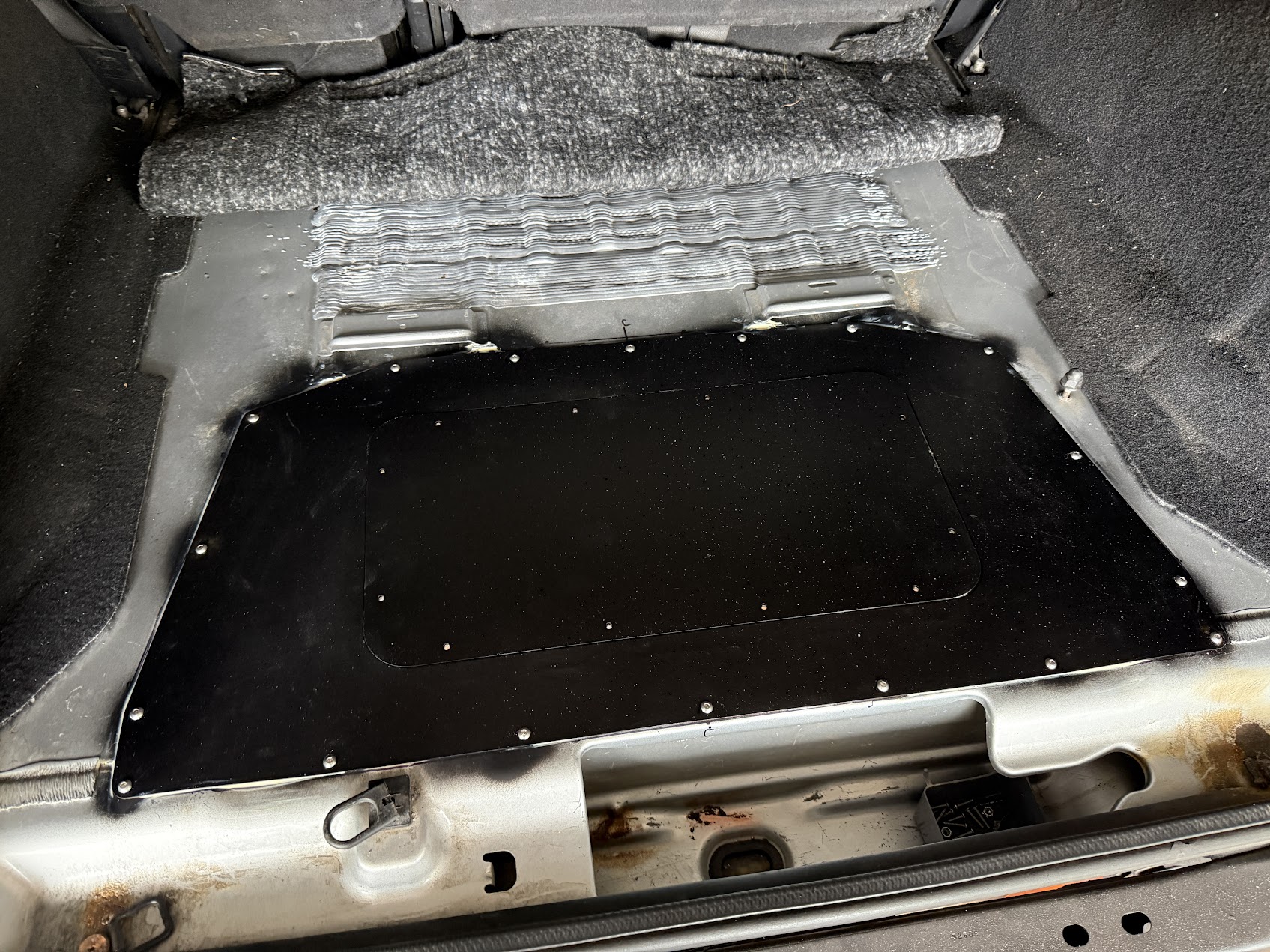

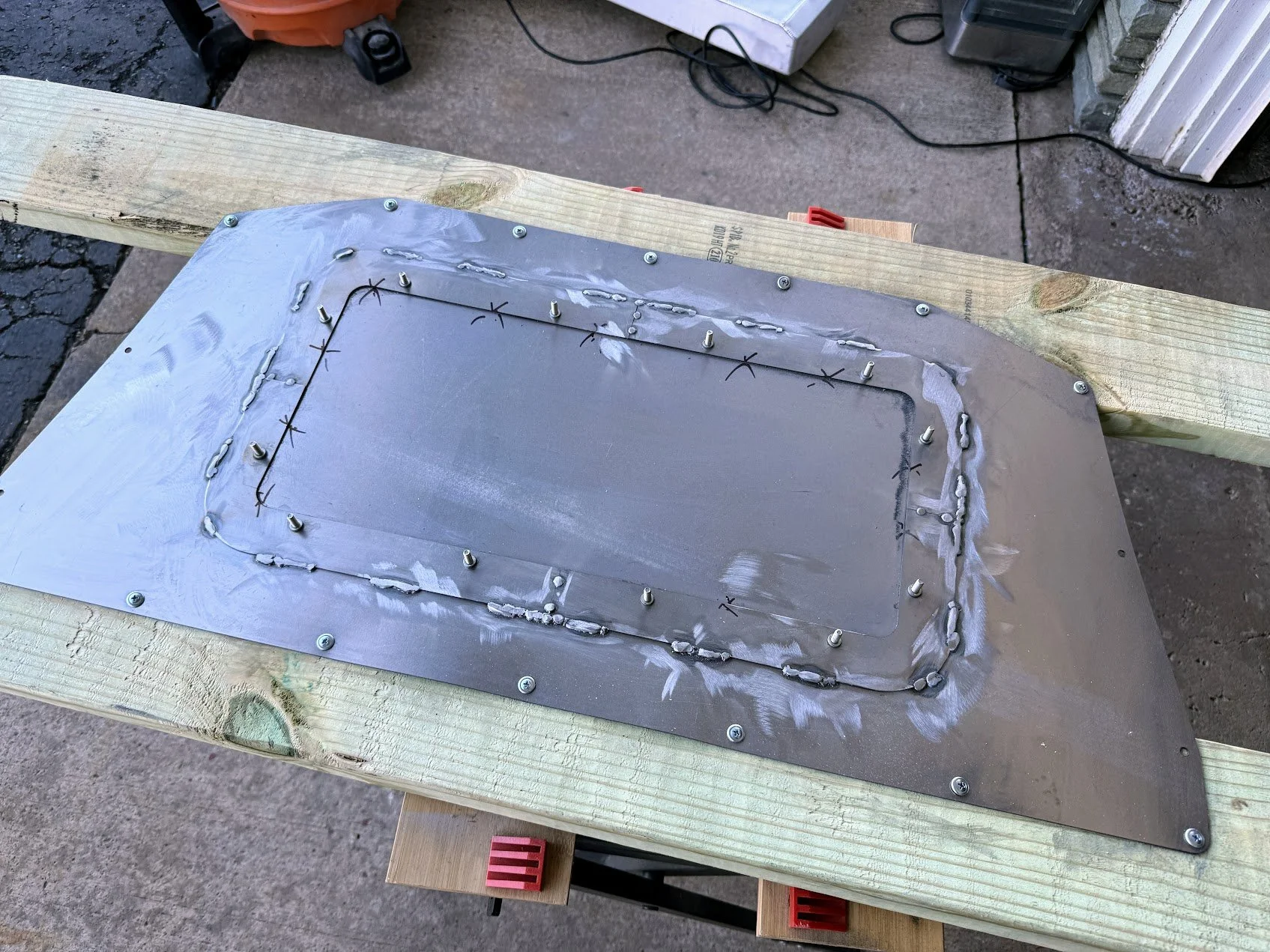

Switching to another item on my to-do list, the rear gas tank hatch and cover:
It's super thin, only 16-gauge:

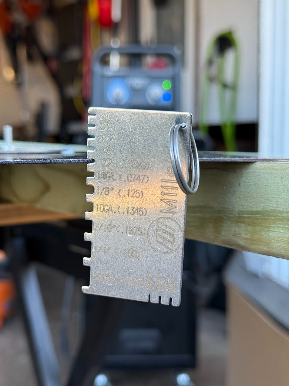

As you'd expect being so thin, there's a worry about blow through and warping. As a result, I stitch welded the underside while the top panel was screwed to a set of 2x6" boards. This seemed to help but did get a small bit of distortion, nothing that will be noticeable however once secured to the tub.

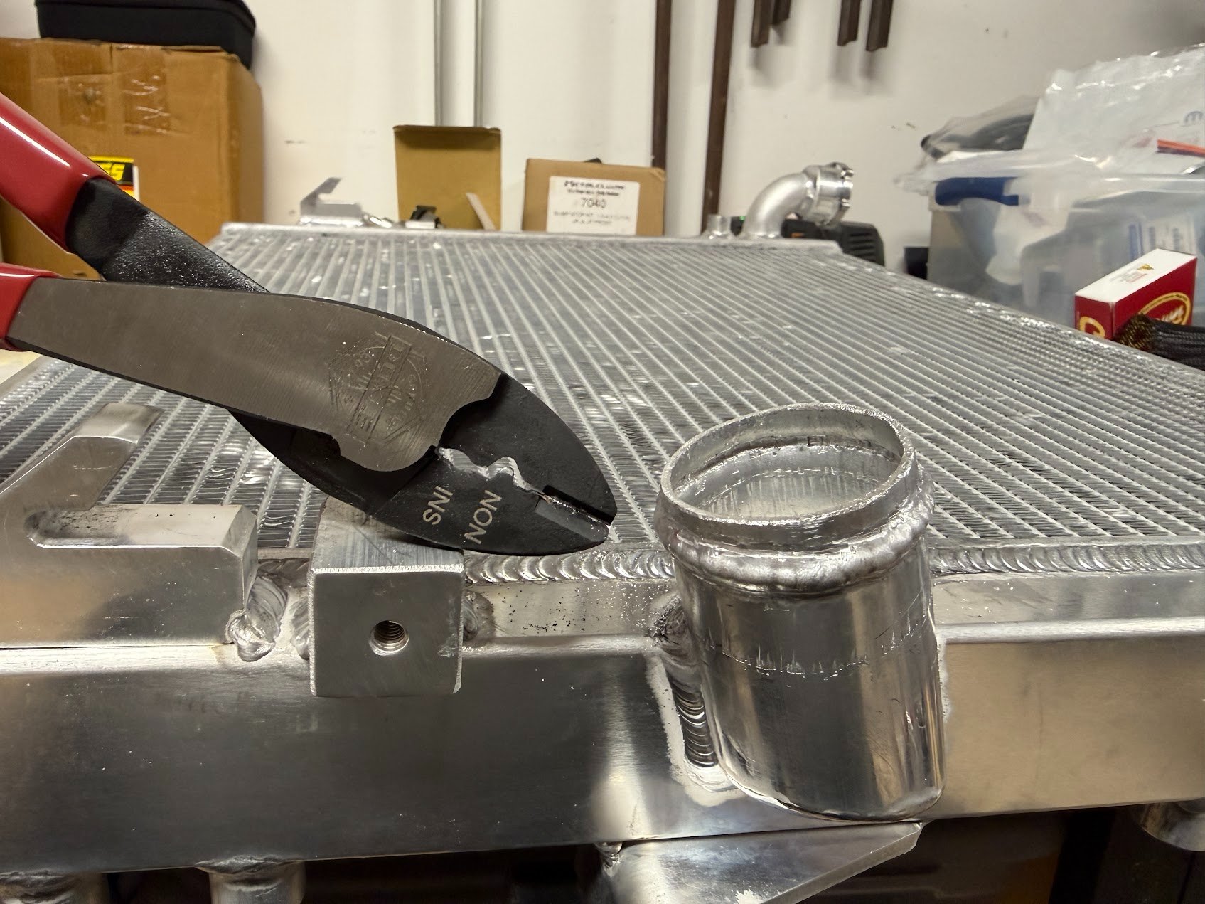

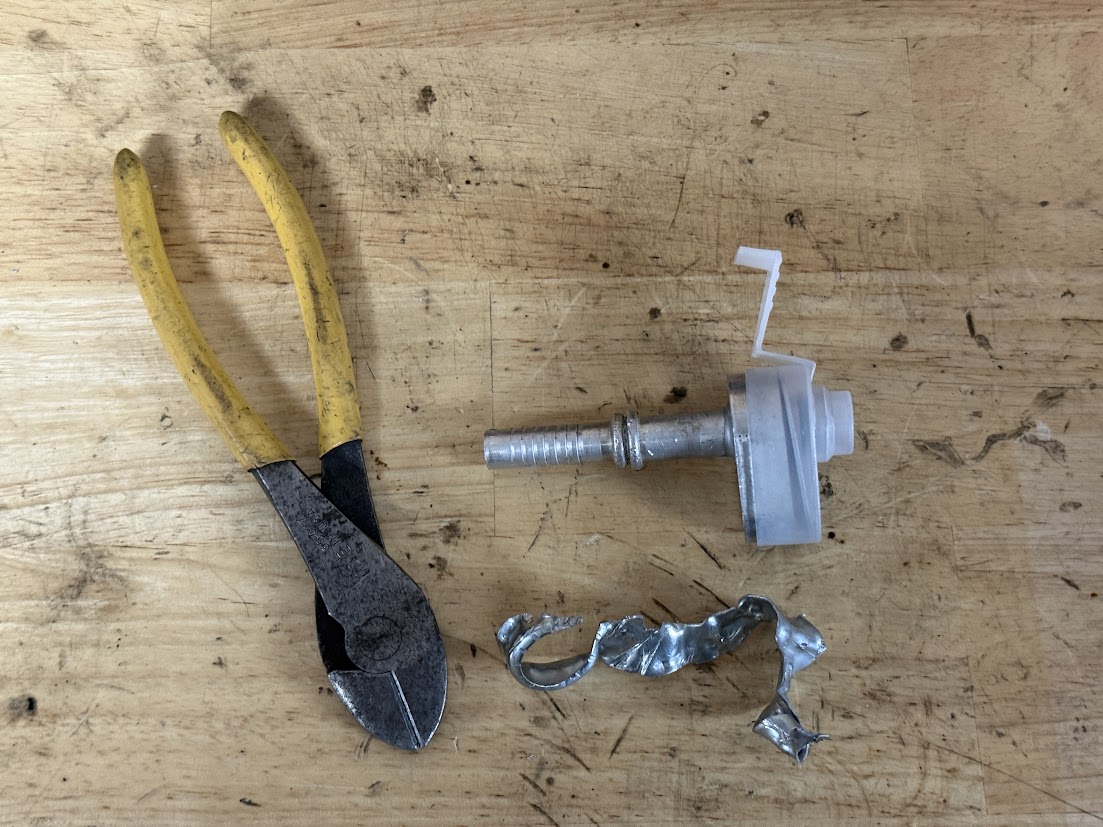

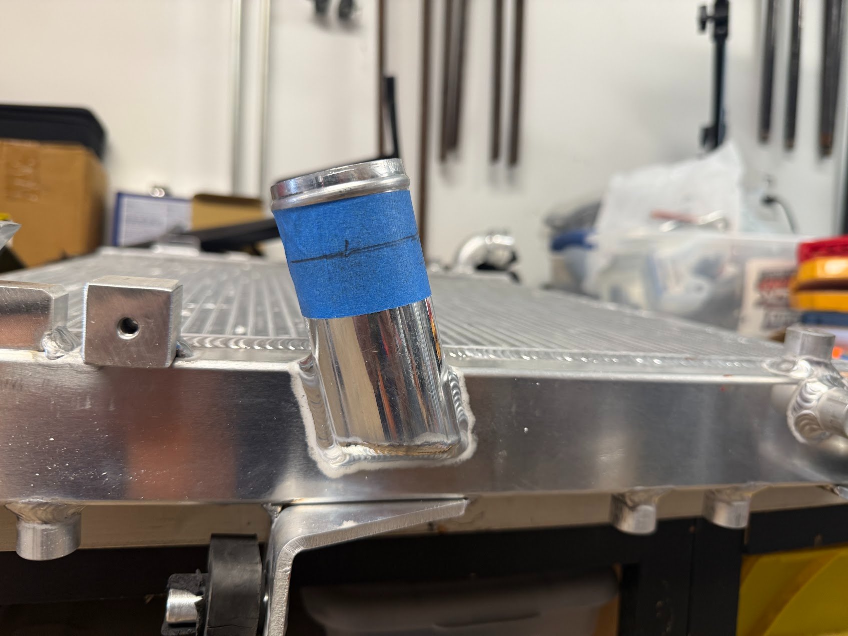

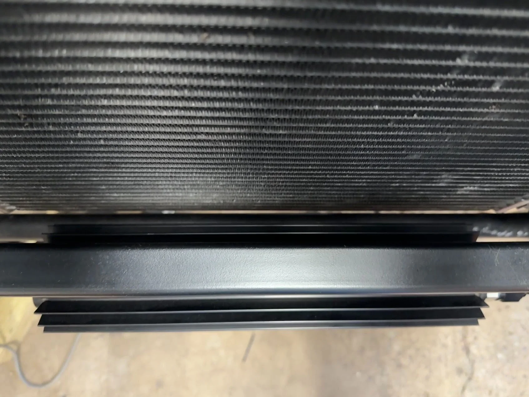

I gave up on the idea of keeping the OEM radiator - that outlet was never going to work for me. So, as much as I despise the thought of an aluminum radiator, I ordered the Northern made one meant for the Hemi swap. These have the best track record and I used new bushings that should help with flex-cracking.
Even though this is meant for the Hemi swap, the lower hose outlet still needs to be trimmed for use on LX/Car based Hemis (the outlet works fine as is for truck VVT engines as the alternator is located much higher). It's not hard, but taking a Sawzall blade to your new $800 radiator is a bit anxiety inducing...
You can see the angle here is much better for clearance compared to the OEM (which is physically higher AND points "up"):
I used some electrician pliers to put a crimped bead on the outlet to give the hose clamp something to ride against.

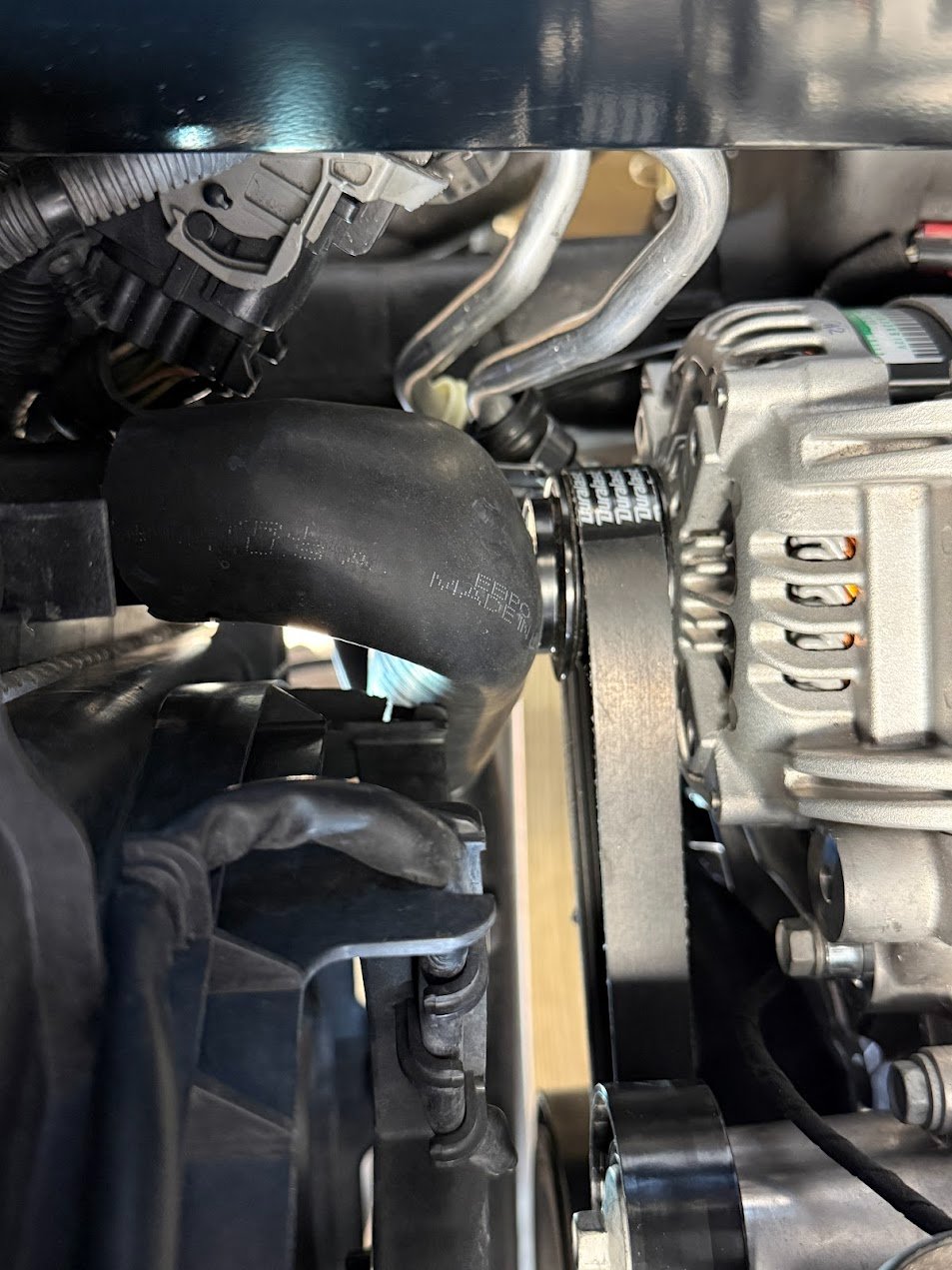

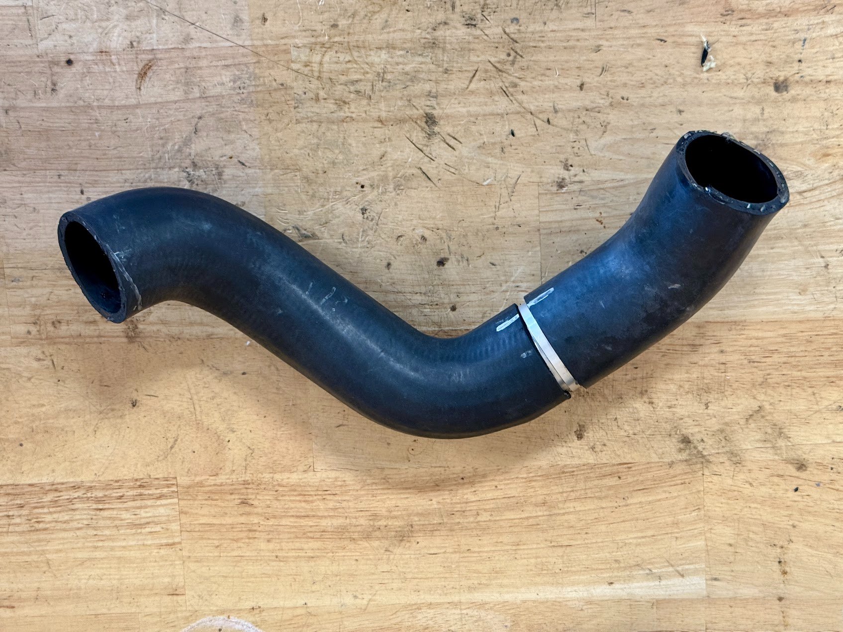

With the radiator secured and modified, it took me about 4 days of trying, trimming, parts-store-searching, and mock-ups to make a hose that sits perfectly in place and clear everything:
What you see is actually two DS72019 hoses unioned together. Check out the Hemi swap page for more details: https://wranglerjkforum.net/threads/jku-hemi-swap-reference-guide-swap-info.32731/post-472868

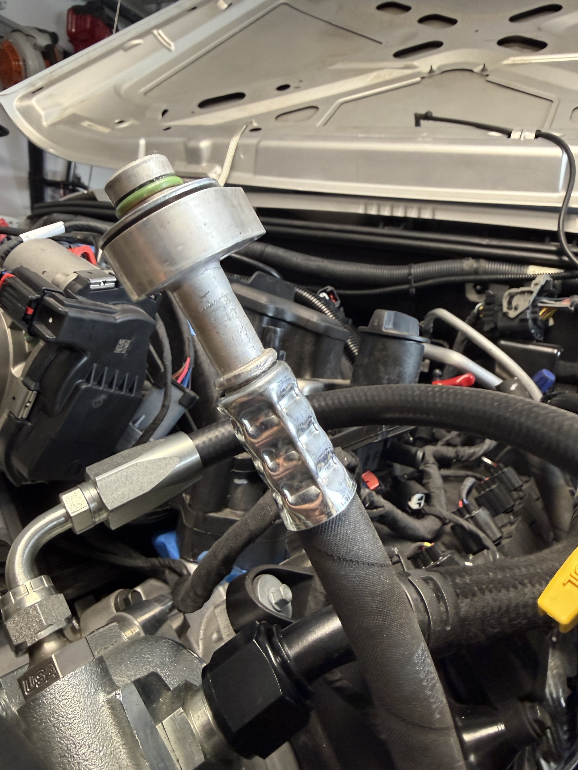

After getting the radiator hoses squared away, I've turned my attention to the A/C lines and PSC cooler. First step was installing the condenser on the radiator and checking fitment. Looks like I'll need to do some trimming here:

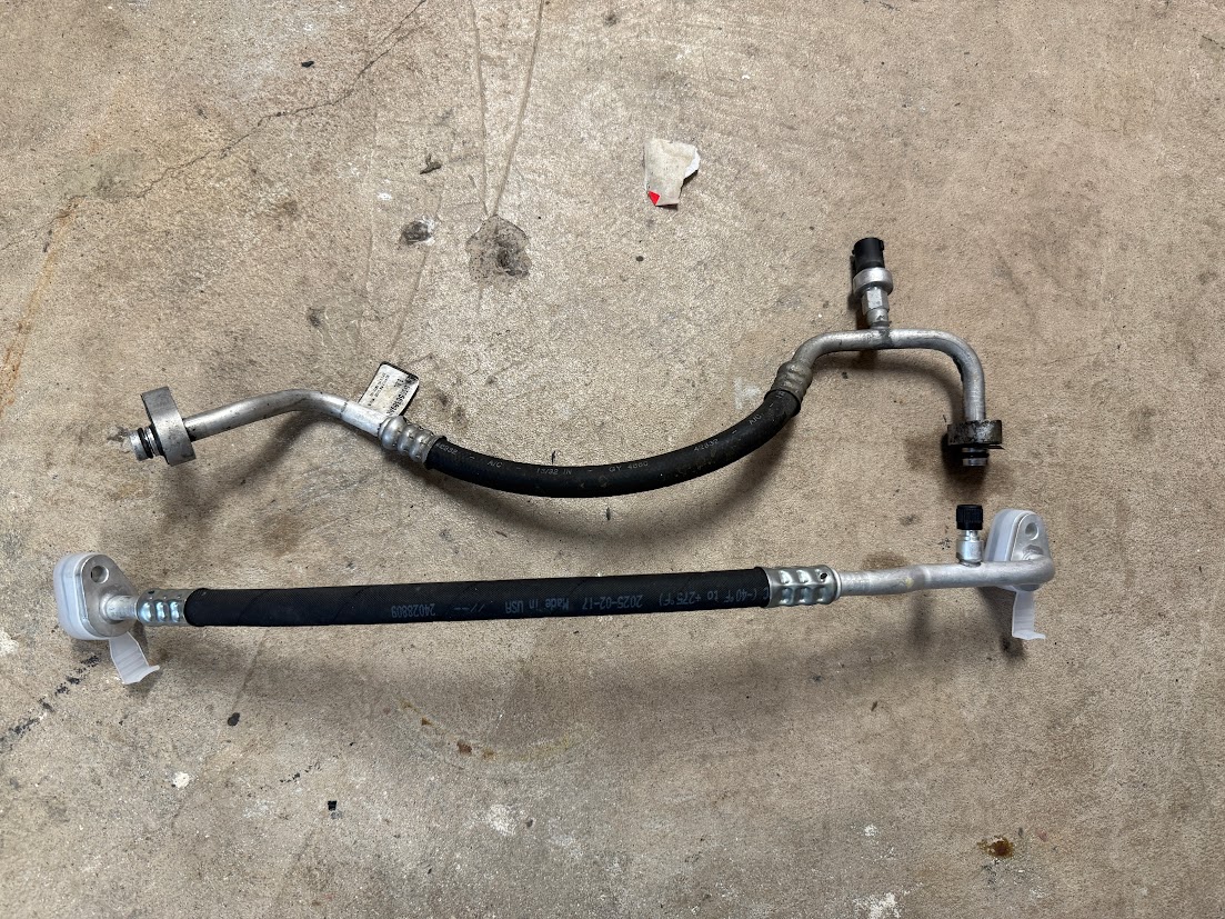

I got the lines from JSS and the fitment was, well, less than great...
There was a big kink in the high pressure hose (and this was after "manipulating", aka bending the shit out of, the tubing portion to get the best fitment):
And the suction hose was worse - not only did it have a kink, but it hit the booster, the bracket on the firewall that held the wire harness, and it rubbed on the engine oil dipstick. Supposedly, this is "fine" as the system, when pressurized, will "fill in" the kinked portion. After picking the brains of others on the JSS Facebook page, I realized that people get it to fit in the best possible way it can for their configuration, and then use zip ties and spare rubber hose sections to keep things from rubbing holes...
For me, that's totally unacceptable. I don't want to be driving, constantly worried about "is the zip tie holding"? Plus, with a kinked hose, how are you going to evacuate the system well? It didn't make much sense to me to "just deal with it", so I took matters into my own hands (which is what it seems like I'm doing with this swap for the most part). I ended up cutting the ferrules off the ends of the JSS A/C hoses, at the evaporator and at the condenser:

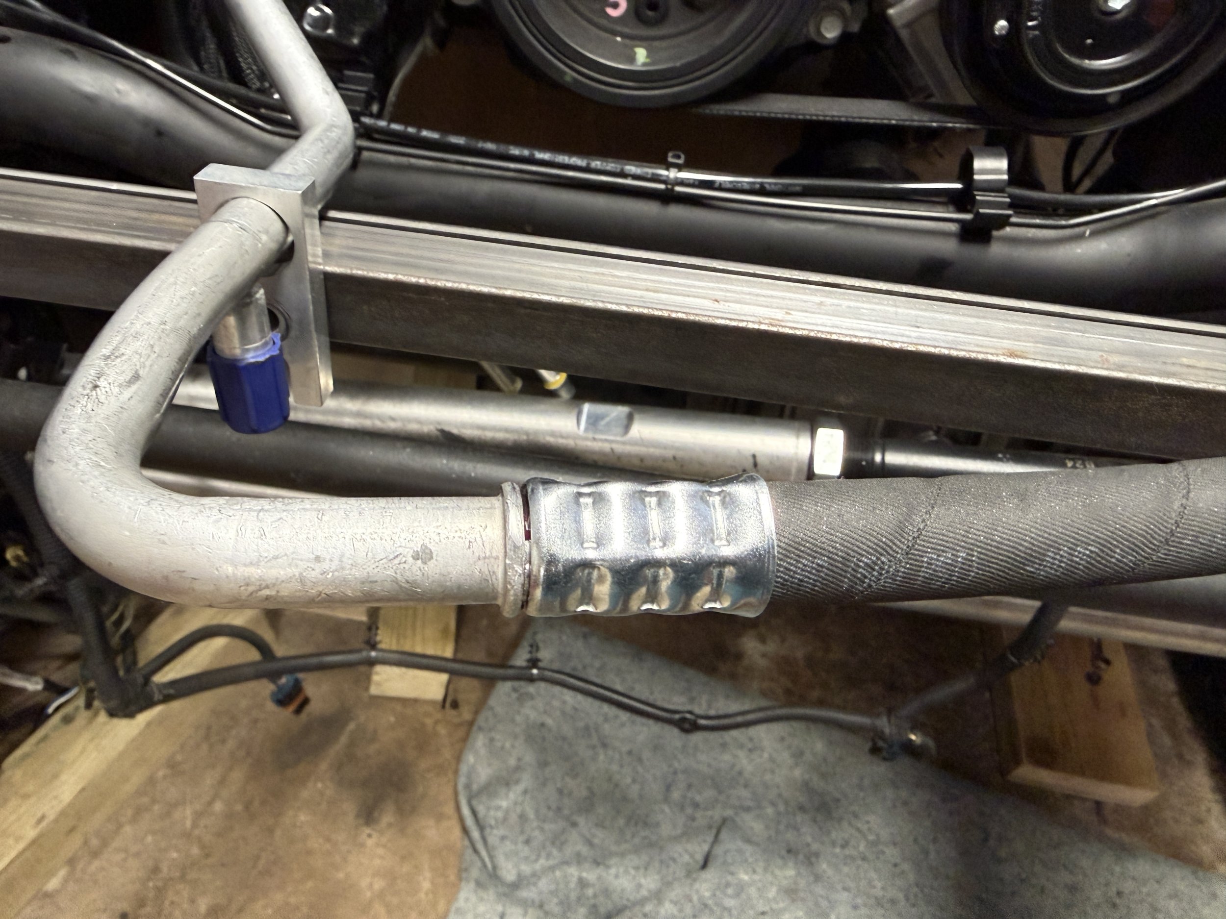

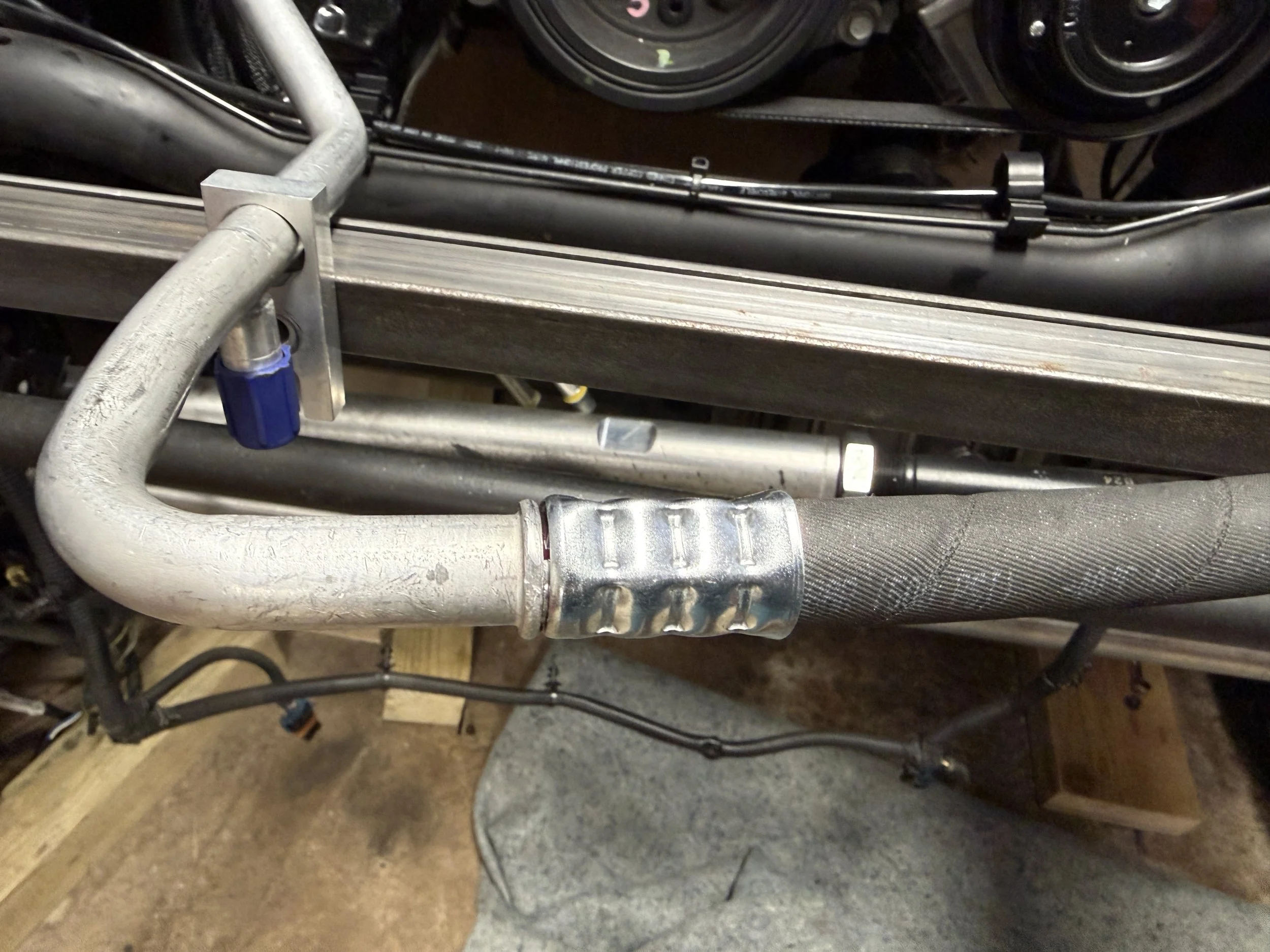

After manipulating the tube into the "best fit" shape, I figured out that by cutting off ~2" of each hose gives a perfectly "neutral" fit, with no tension or compression on any of the fittings or hoses, and with ZERO rubbing anywhere:
I ordered some ferrules and a crimper from Amazon, so once I'm back home later this week (currently on a work trip), I'll get these crimped up and secured! Once these are done, I can turn my attention to putting the final touches on the PSC steering lines and mounting the PSC cooler:

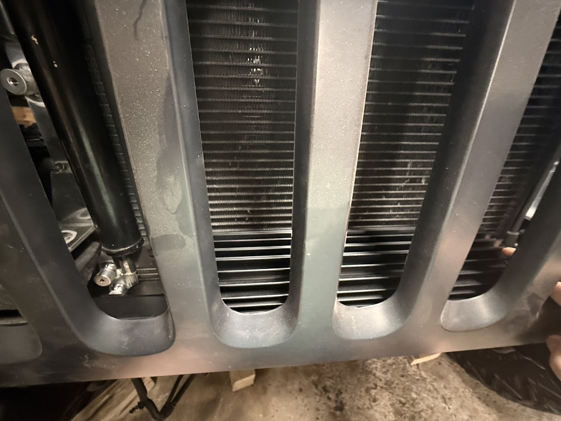

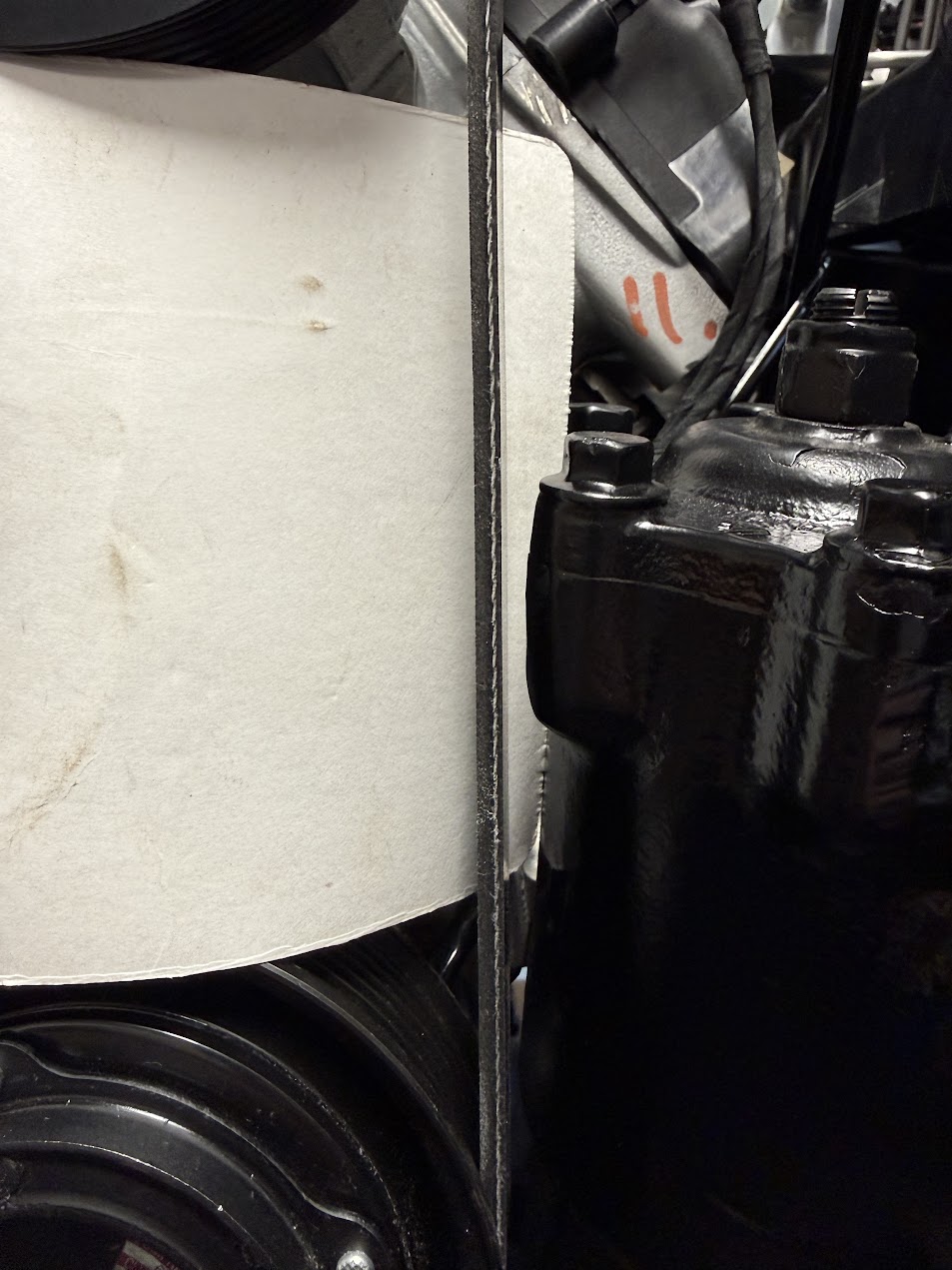

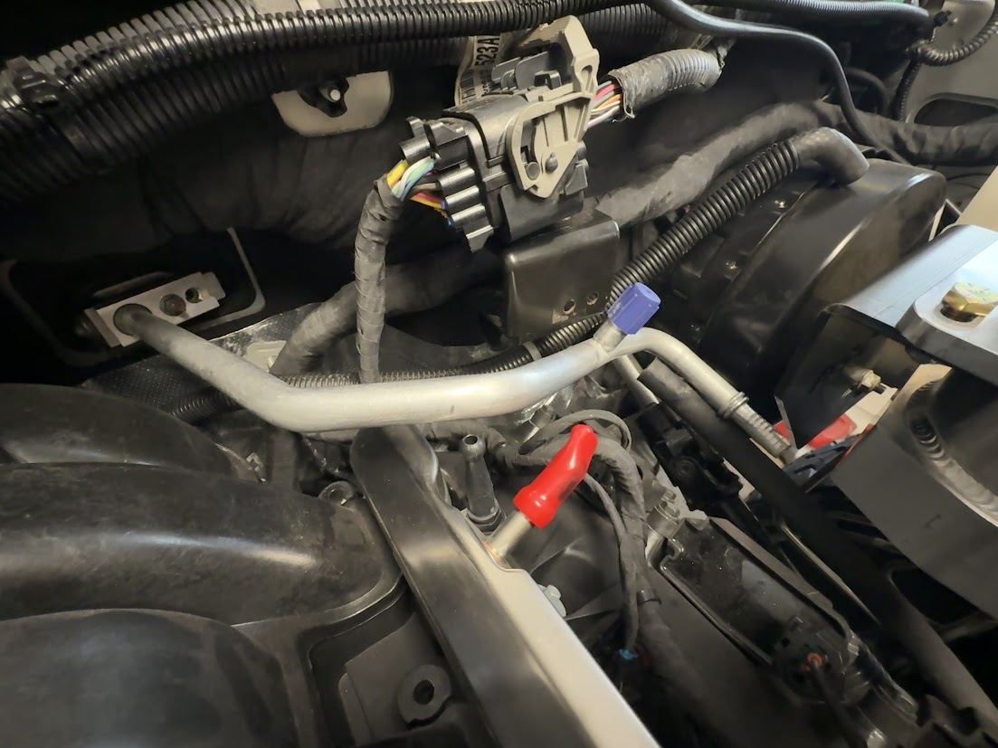

PSC says to install it as you see above, just in front of the condenser and behind the grill. This seems foolish to me, and many people have complained about overheating their engines AFTER doing this (and not before), so I think there's a better place. I'm going to "flip" it, and install it UNDER the radiator support bar. It should have plenty of protection from the bumper, engine cradle/crossmember, and steering stabilizer, but shouldn't impede airflow into and through the radiator (I'll make some aluminum panels when I'm all done to replace the hardened plastic/rubber "dams" that came from the factory.

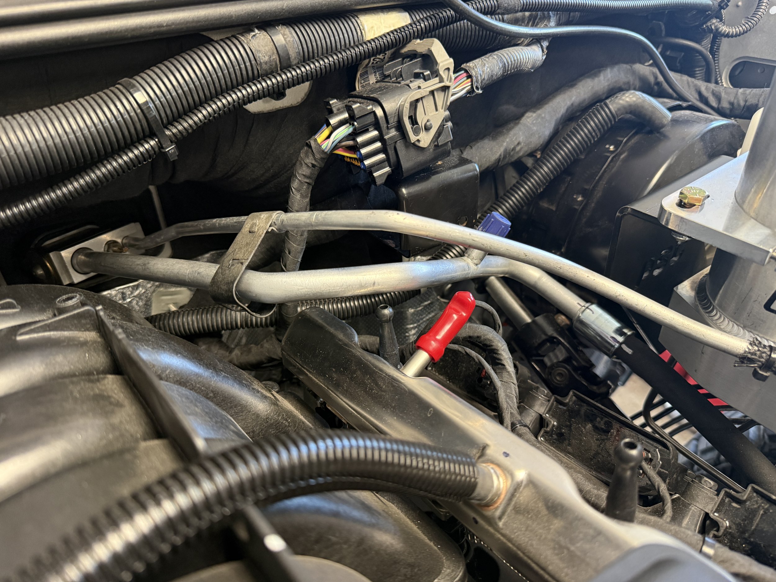

I got the A/C lines trimmed up and re-crimped...
Everything fits great now, with no rubbing on anything and away from significant heat sources...

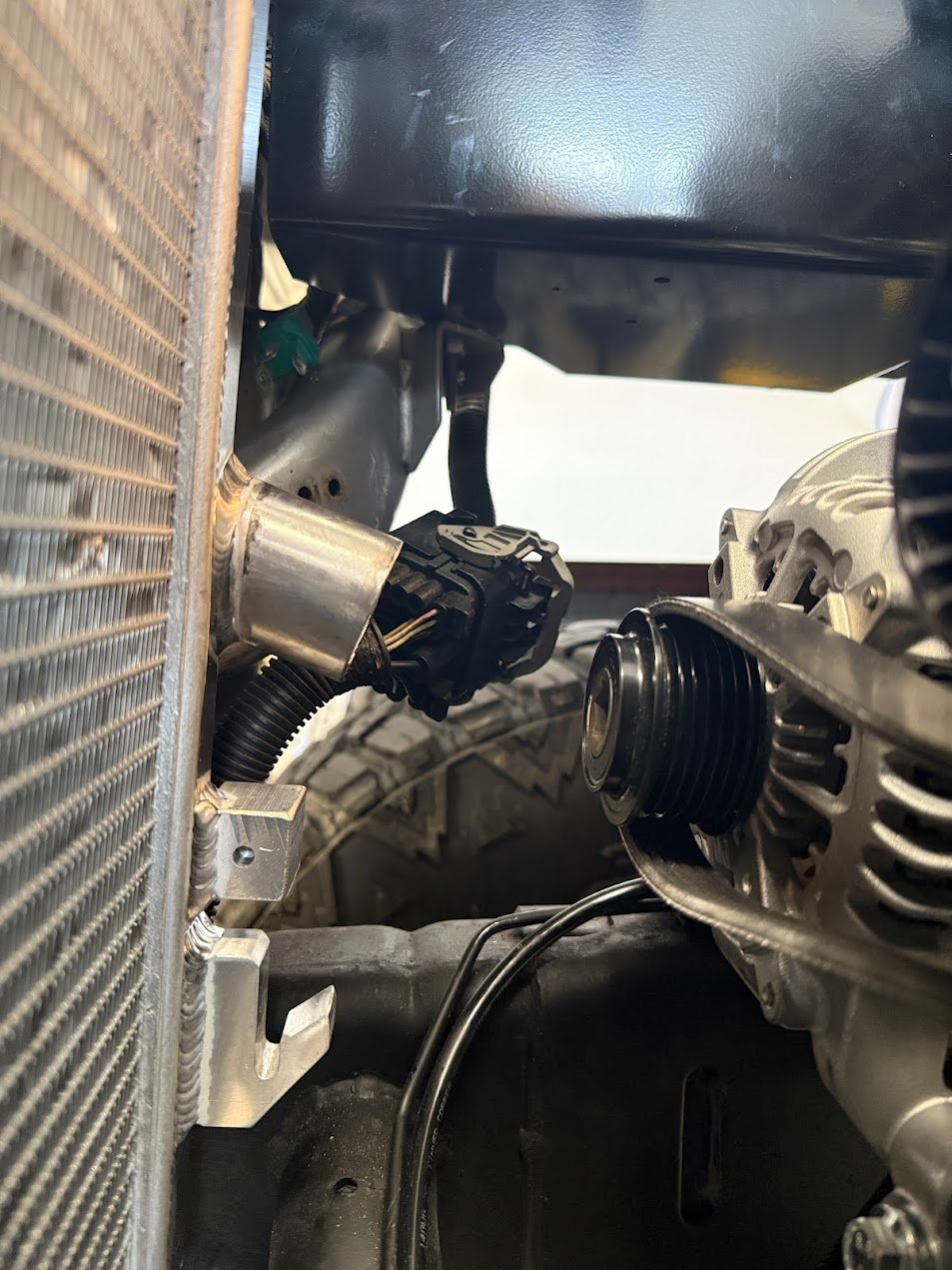

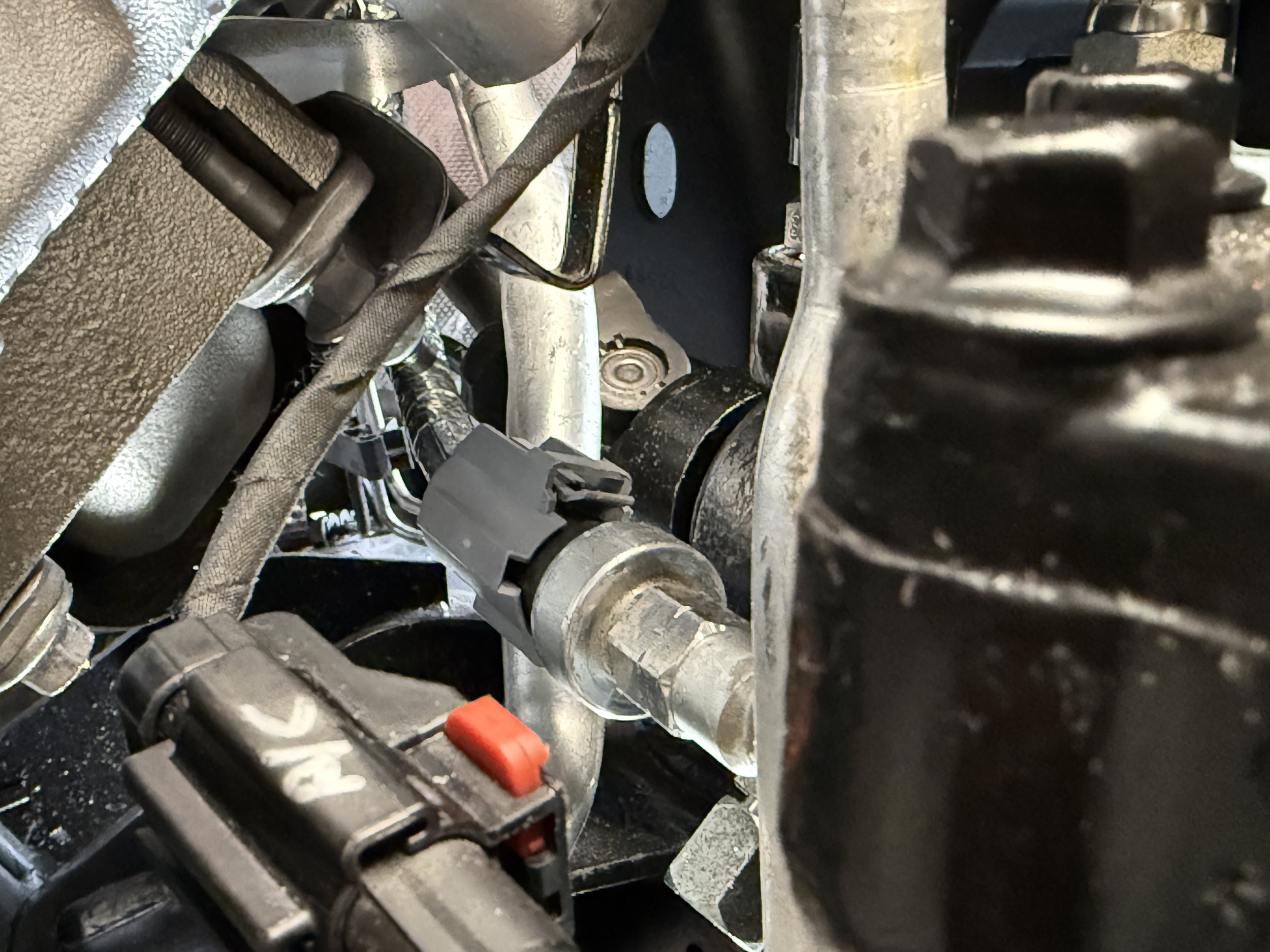

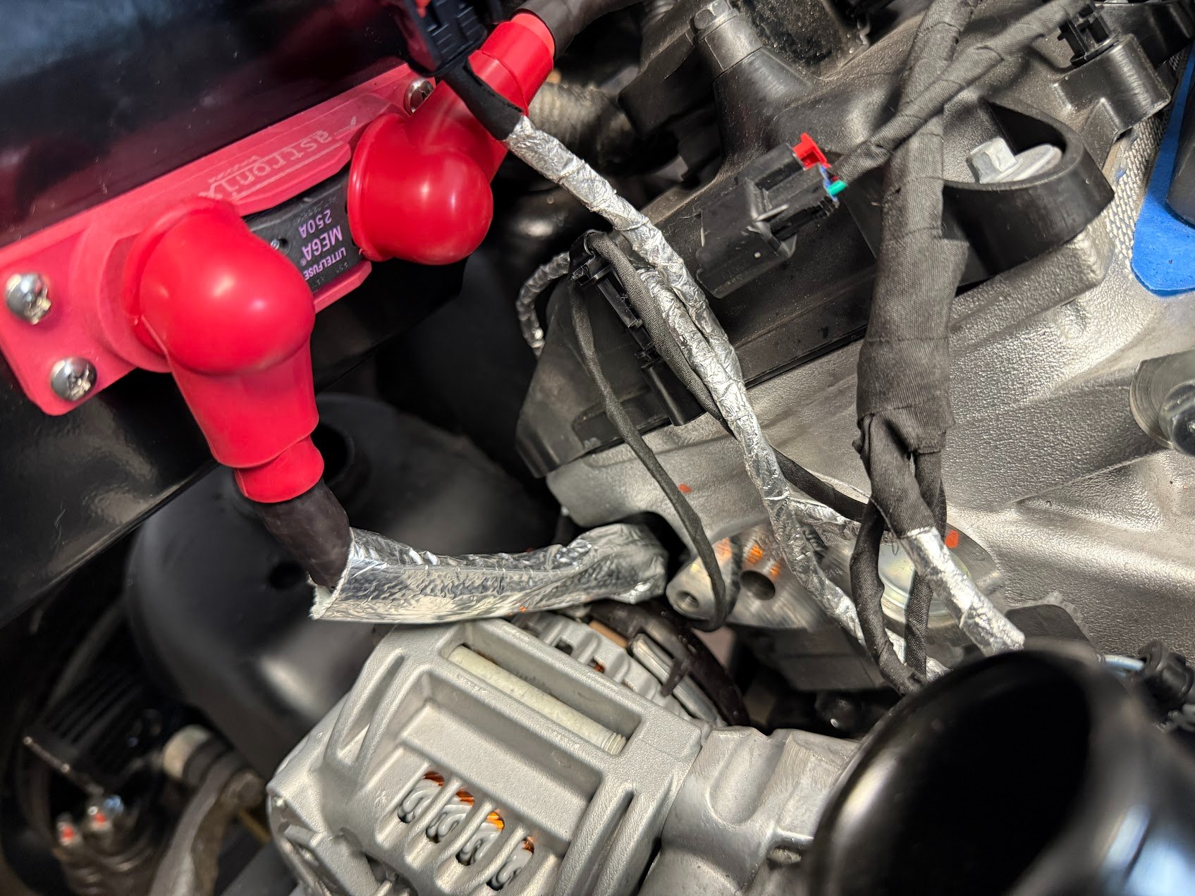

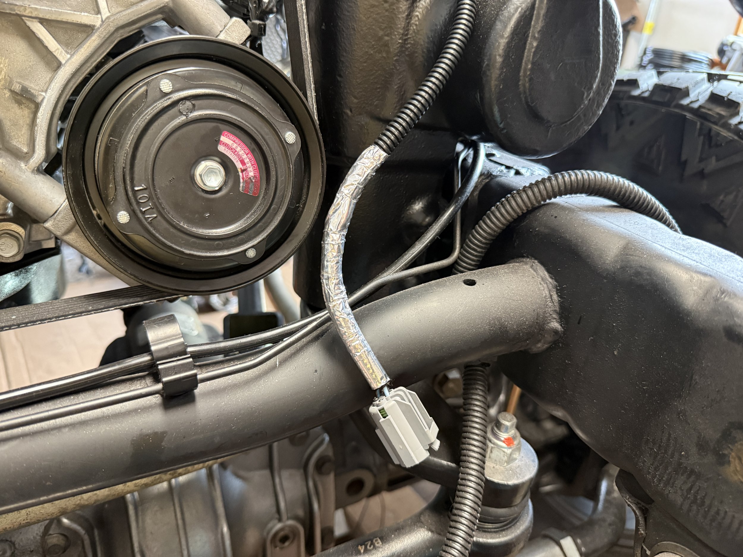

The pressure switch installed on the suction line is a little close to the exhaust manifolds but supposedly doesn't cause any issues:
Even still, I decided to add some loom and aluminized HVAC tape:

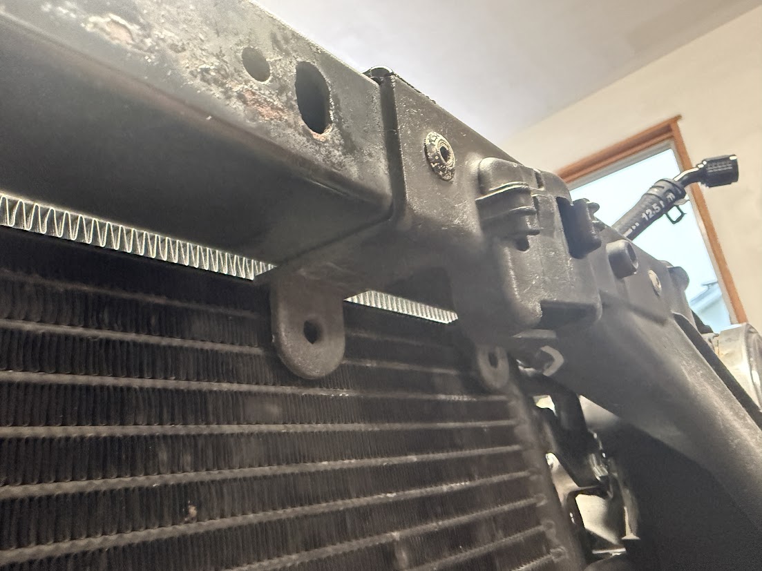

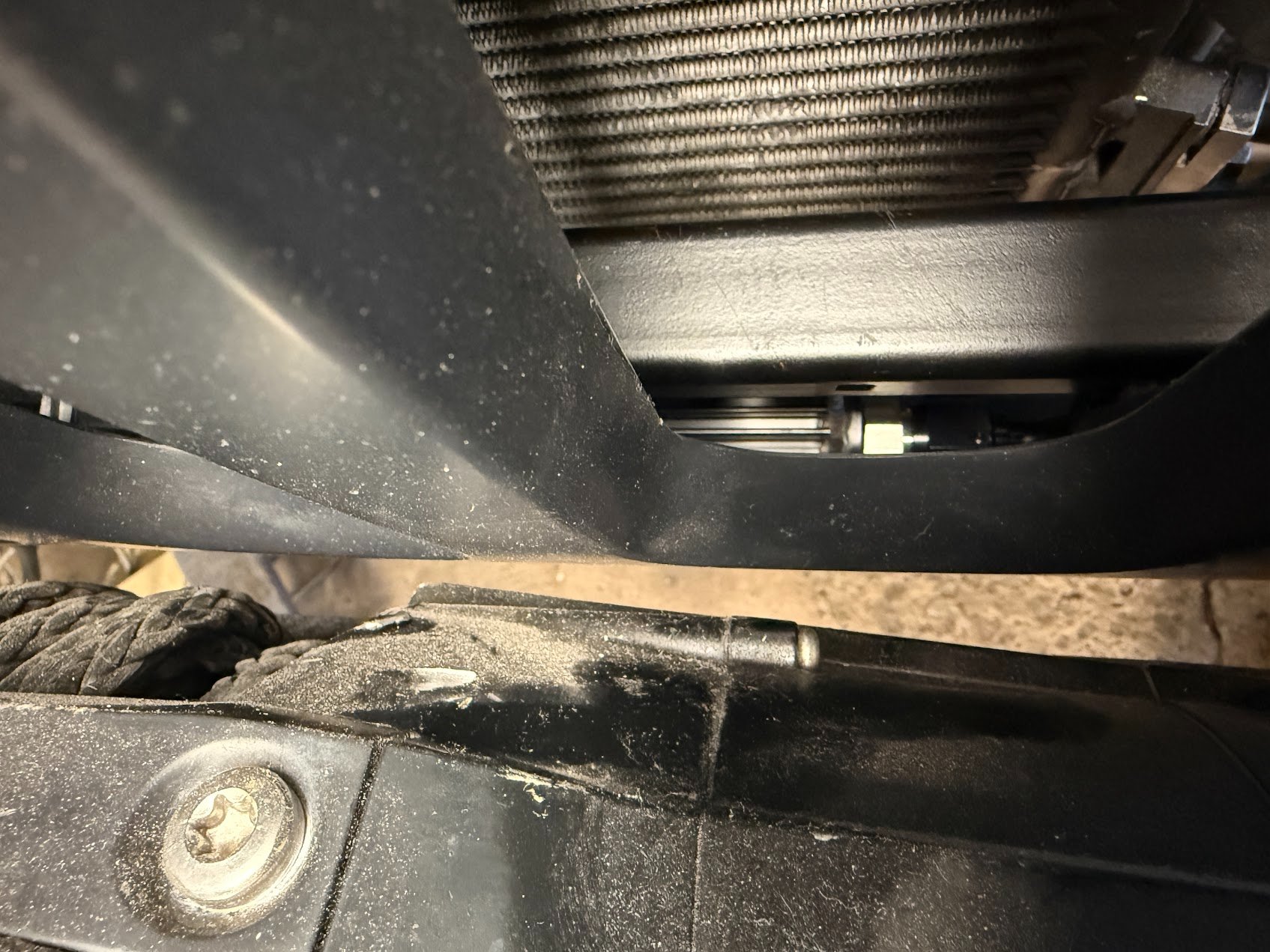

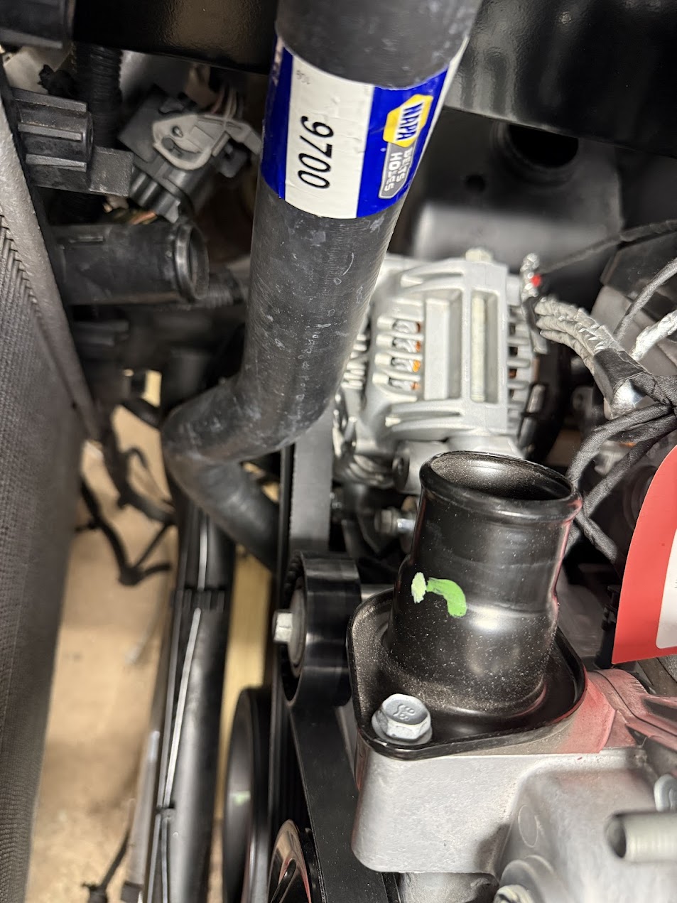

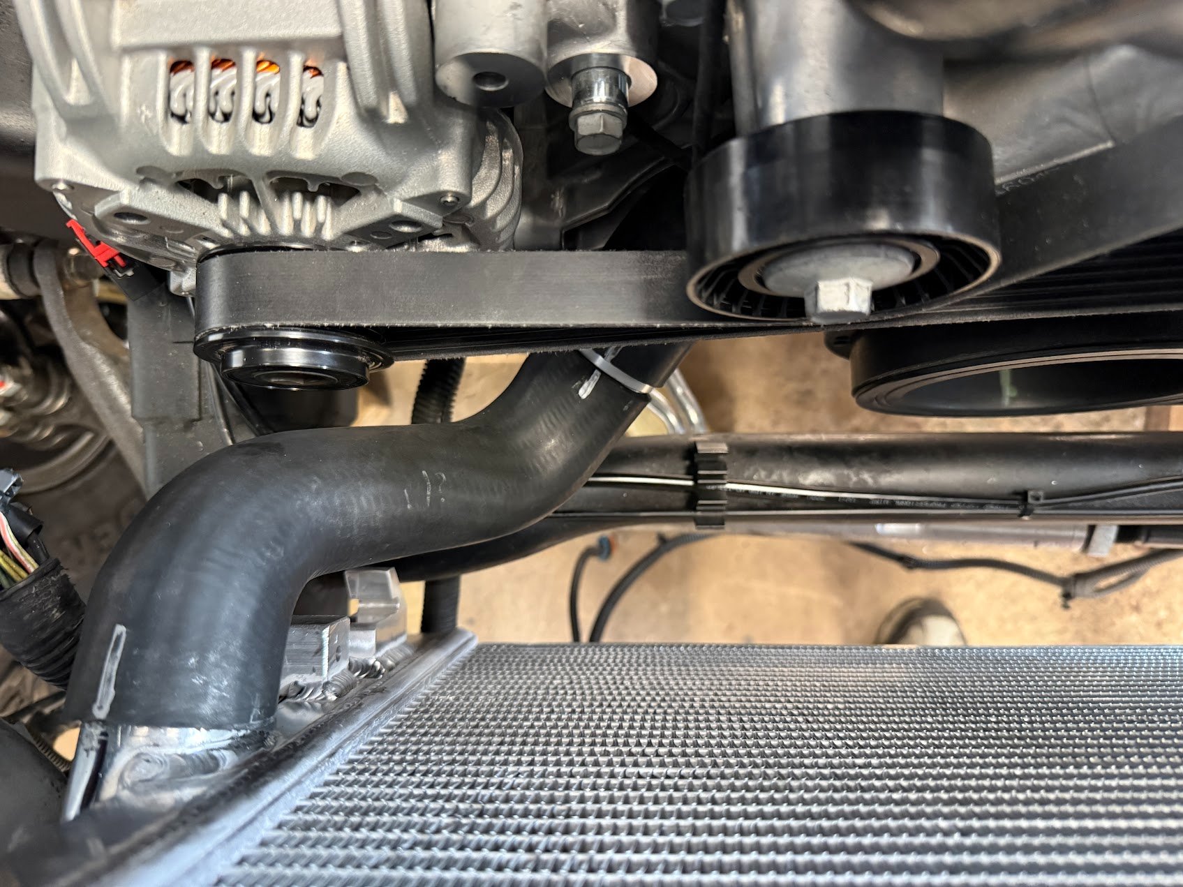

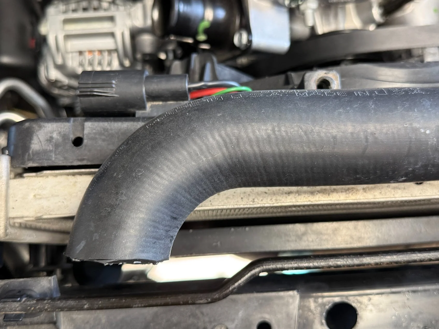

With the new radiator in place, the lower hose was really close and rubbing on the OEM body harness connector. To remedy, I simply drilled two new holes about 1-1/2" away from the original ones:

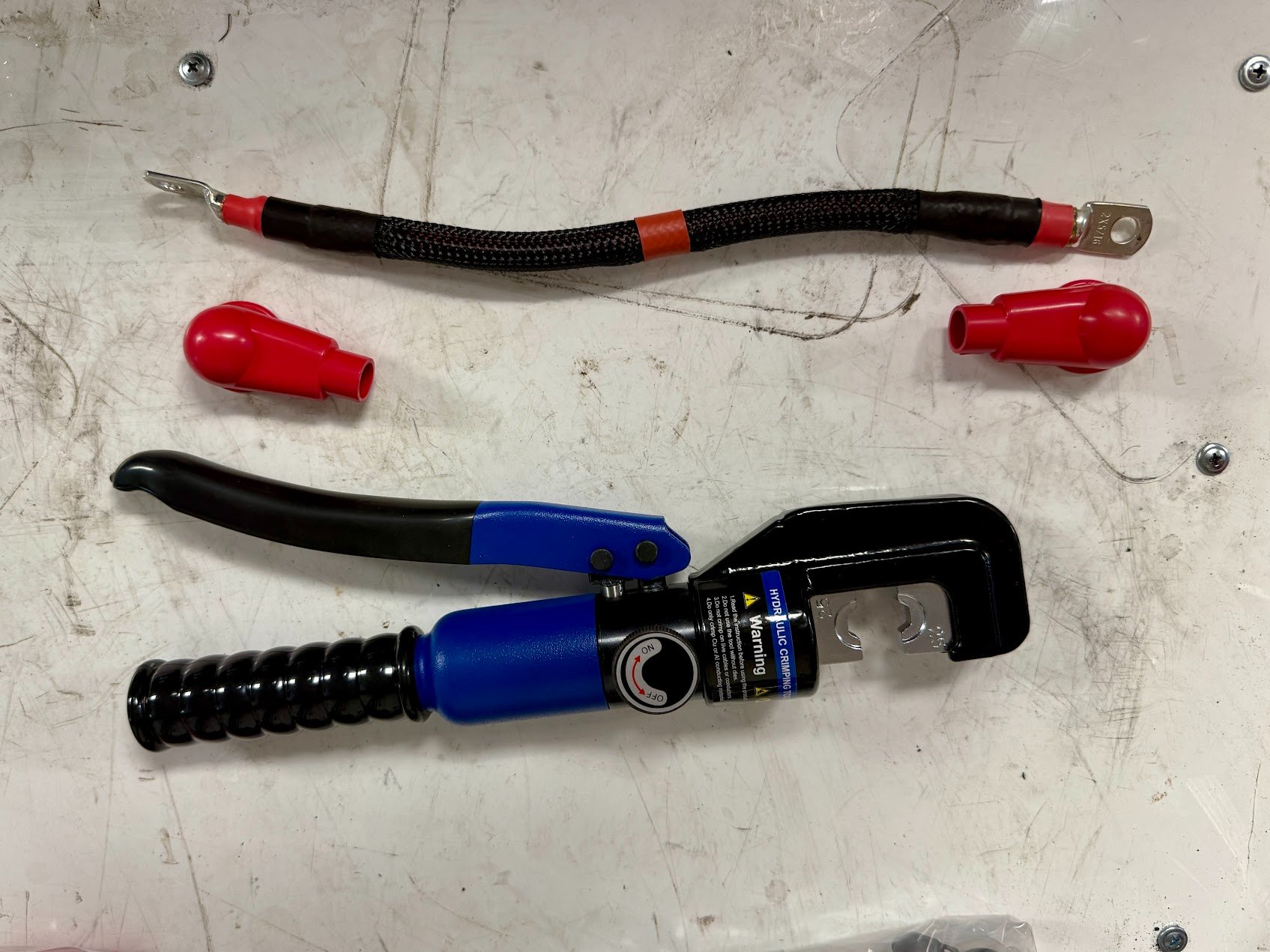

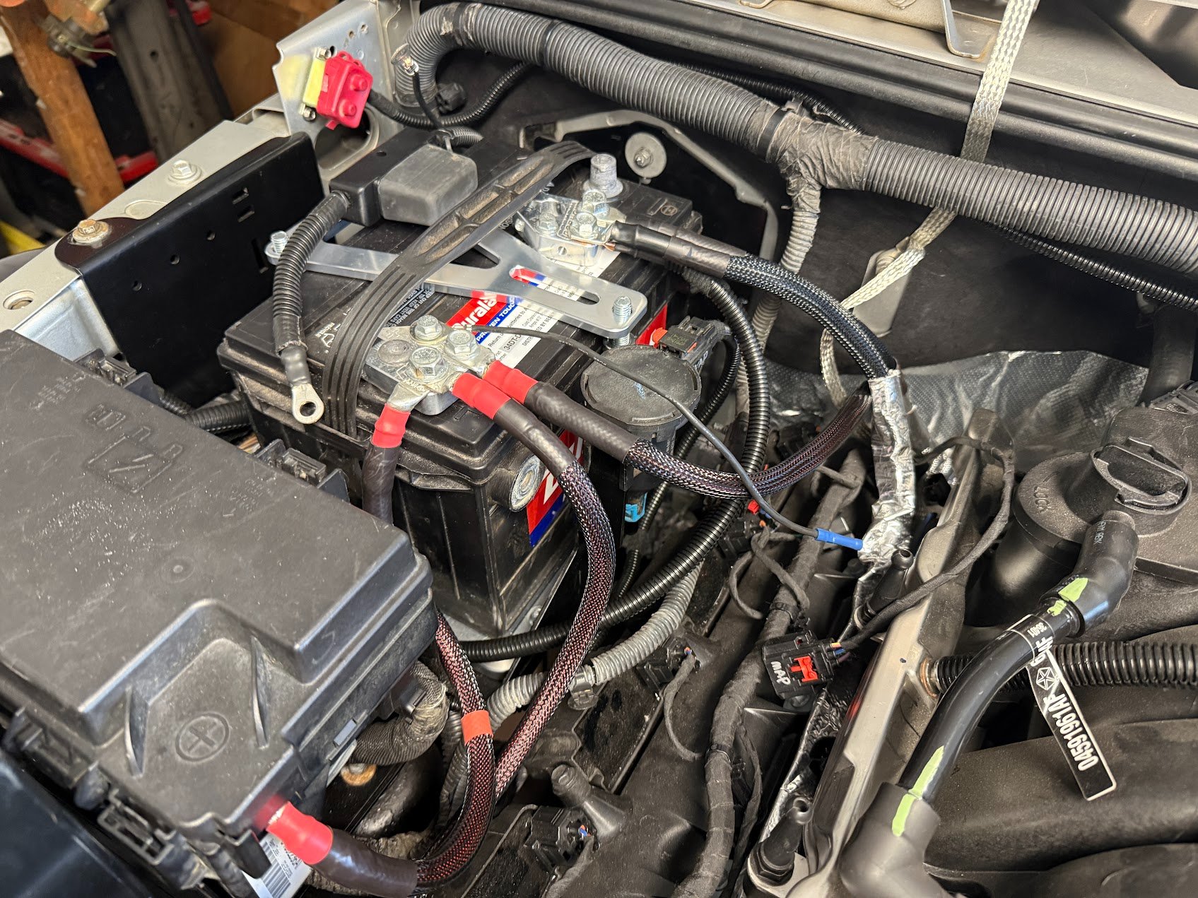

Radiator hoses and A/C lines are done, so I'm turning to the battery cables.
I'm using tinned copper, 2AWG cables for basically everything, except the battery-to-inner-fender ground wire, which is 4AWG for easier routing (still larger than the factory ground wire, which is #8AWG).
The OEM configuration uses a fusible link on the cable coming out of the alternator to the battery. Since the Hemi is running a large 180A alternator, I wanted to run #2AWG wire, which necessitates the use of a Mega Fuse. I installed it on the JSS intake box, close to the alternator but safely out of the way of moving parts and other items. It's easy to get to, but also protected. I have the cable coming out of the alternator, sneaking through a spot between the alternator itself and the cylinder head. I covered this wire with some heat reflective, fiberglass heat sleeving. I may reroute this cable around the outside of the alternator if, when I finally install the front inner fenders, it clears sufficiently.
I'm running the 34-DT series battery and want to be able to run the winch cables up through the radiator support to the battery. It's tight, but not as bad as it was when I was sneaking the winch cables around the TIPM and intake box. As I was working the cables, it occurred to me that the EVAP purge solenoid was almost directly in front of the + side terminal of the battery. Flipping it around made more room, and allowed for better hose routing, but the connector no longer reached. Some solder and a few short pieces of 18 AWG wire took care of that issue:

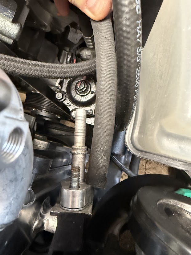

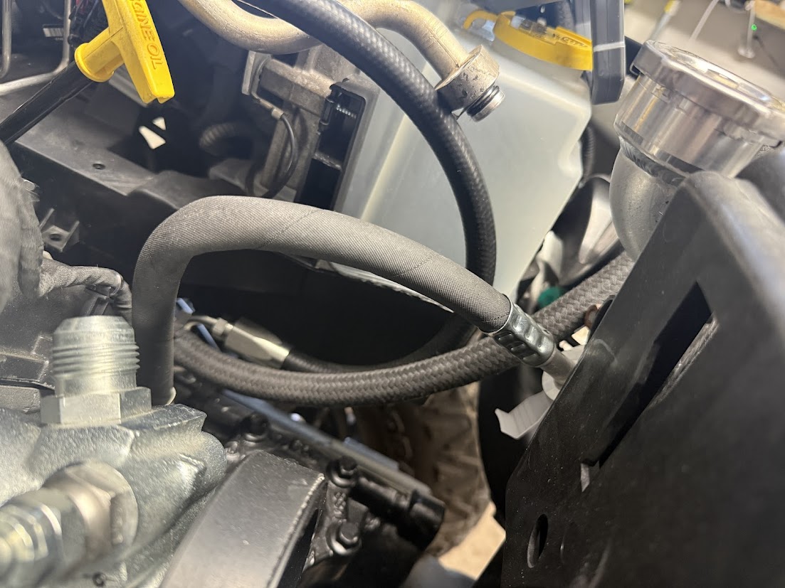

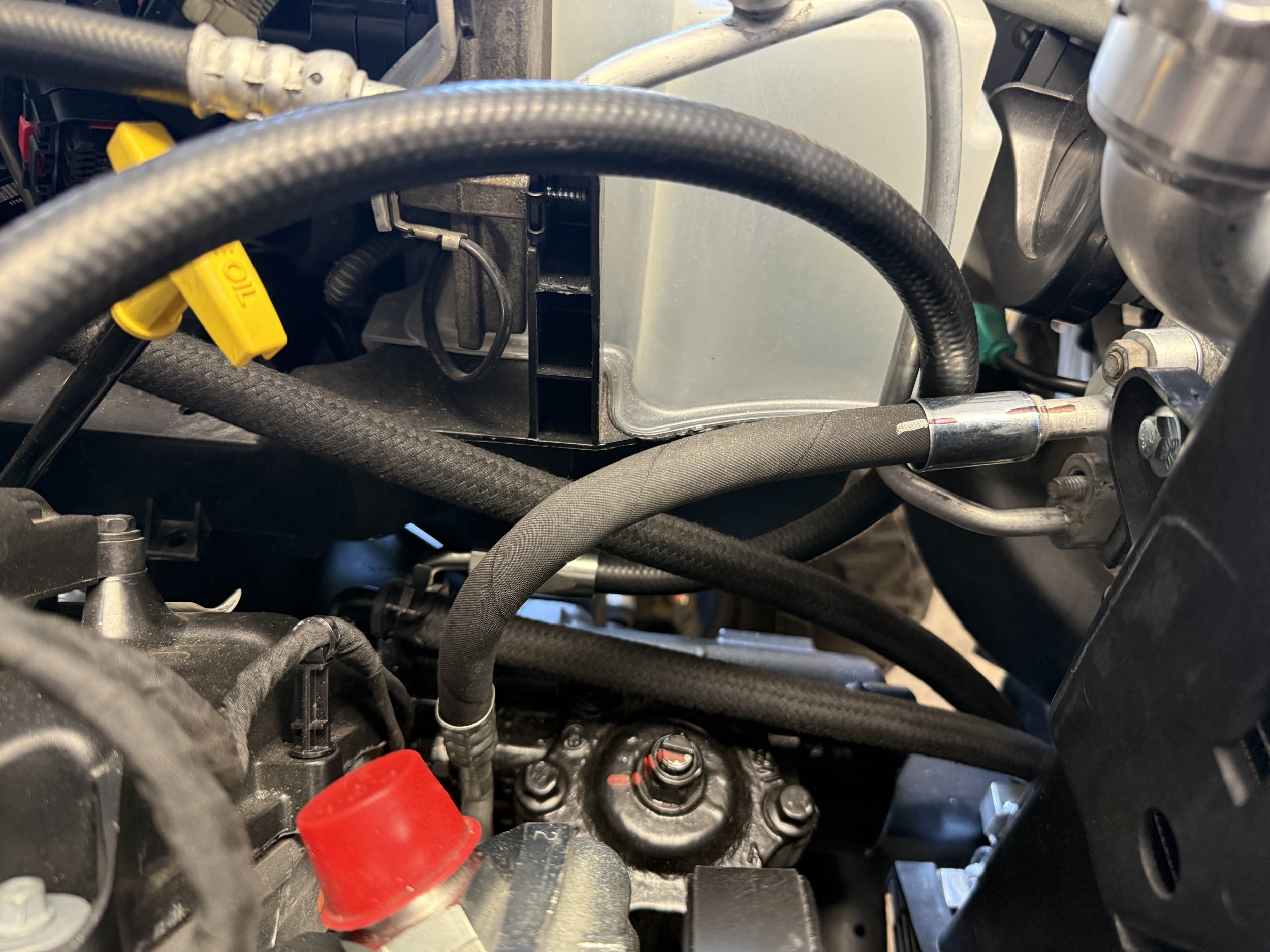

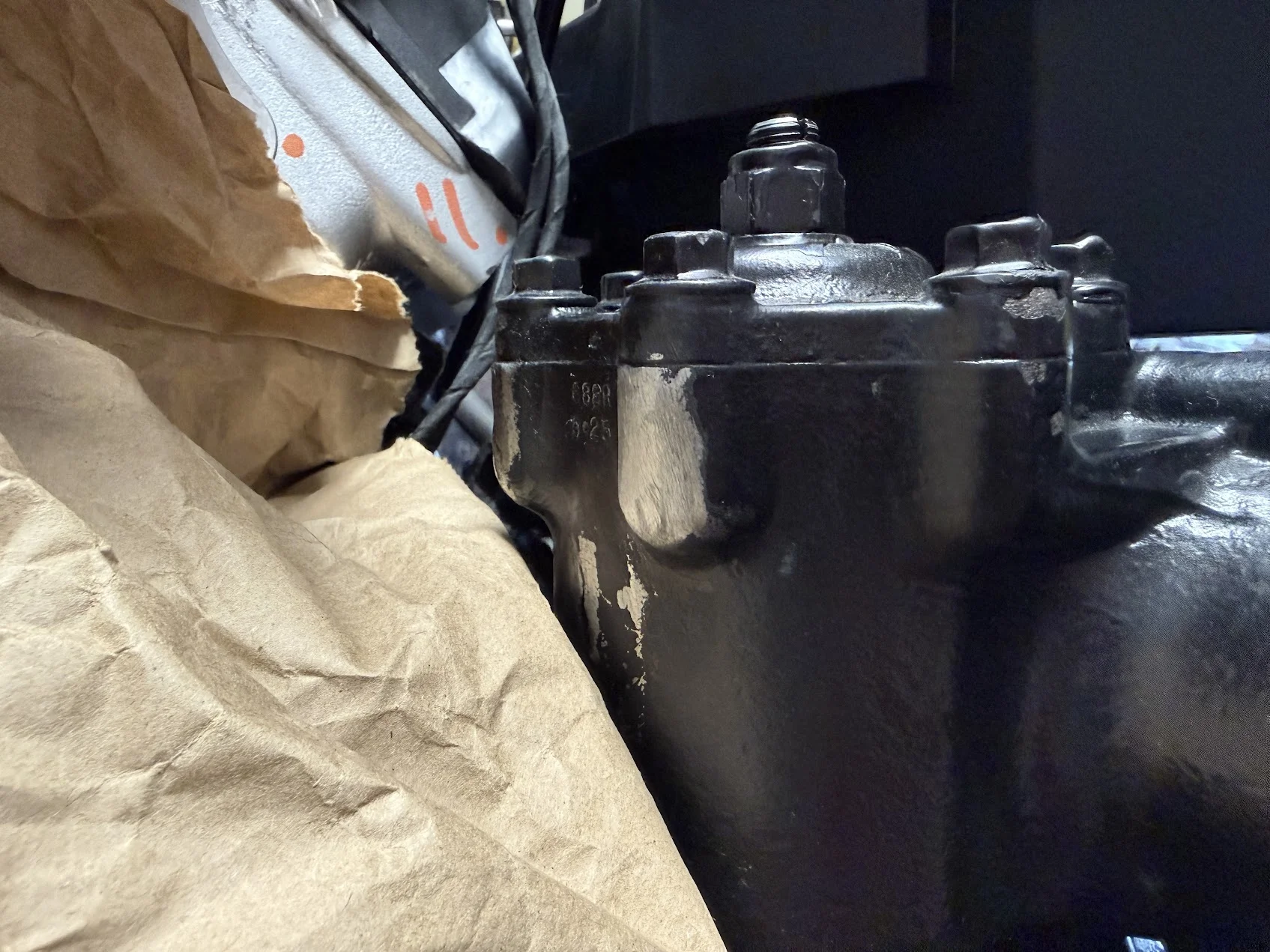

Battery cables are done, next up is the rest of the power steering lines. I ended up using some 1/8" steel angle iron to make a brace across the frame rails. The PSC cooler will sit on top of this, and be completely "free" of the radiator support or grille. This will let me service those items without having to crack open the PSC cooler lines.
Lots of room in the back between the cooler and the condenser:

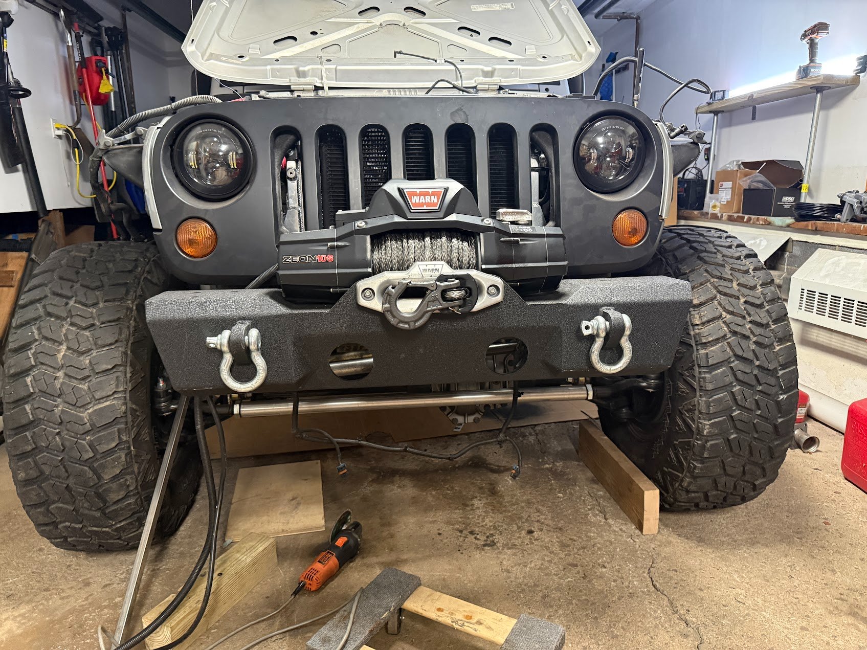

I threw on the bumper and winch just to confirm clearances before fully welding the brace in place. I've got a lot of room and can still likely go with a frame chop at some point...
This bumper was cheap but I still like the shape and style...

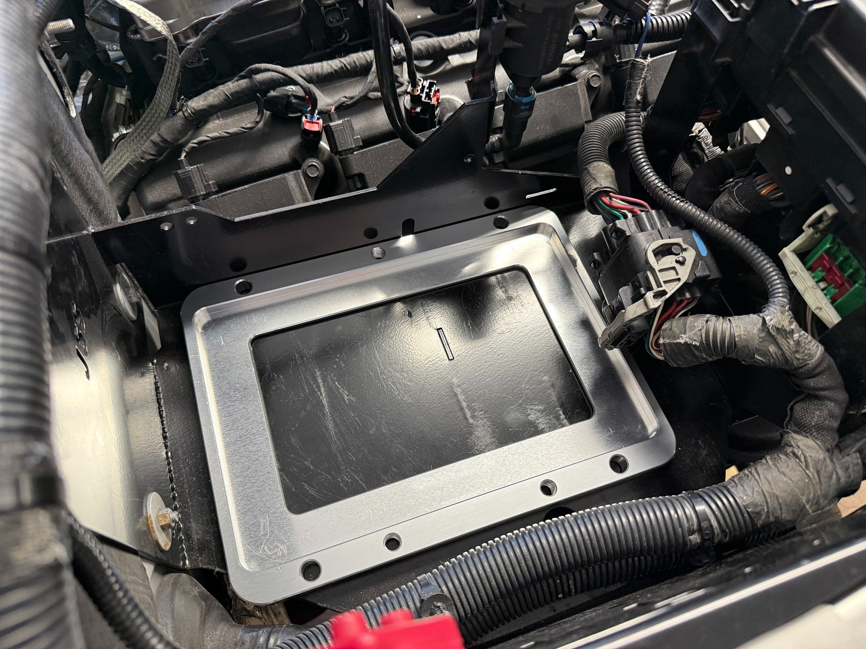

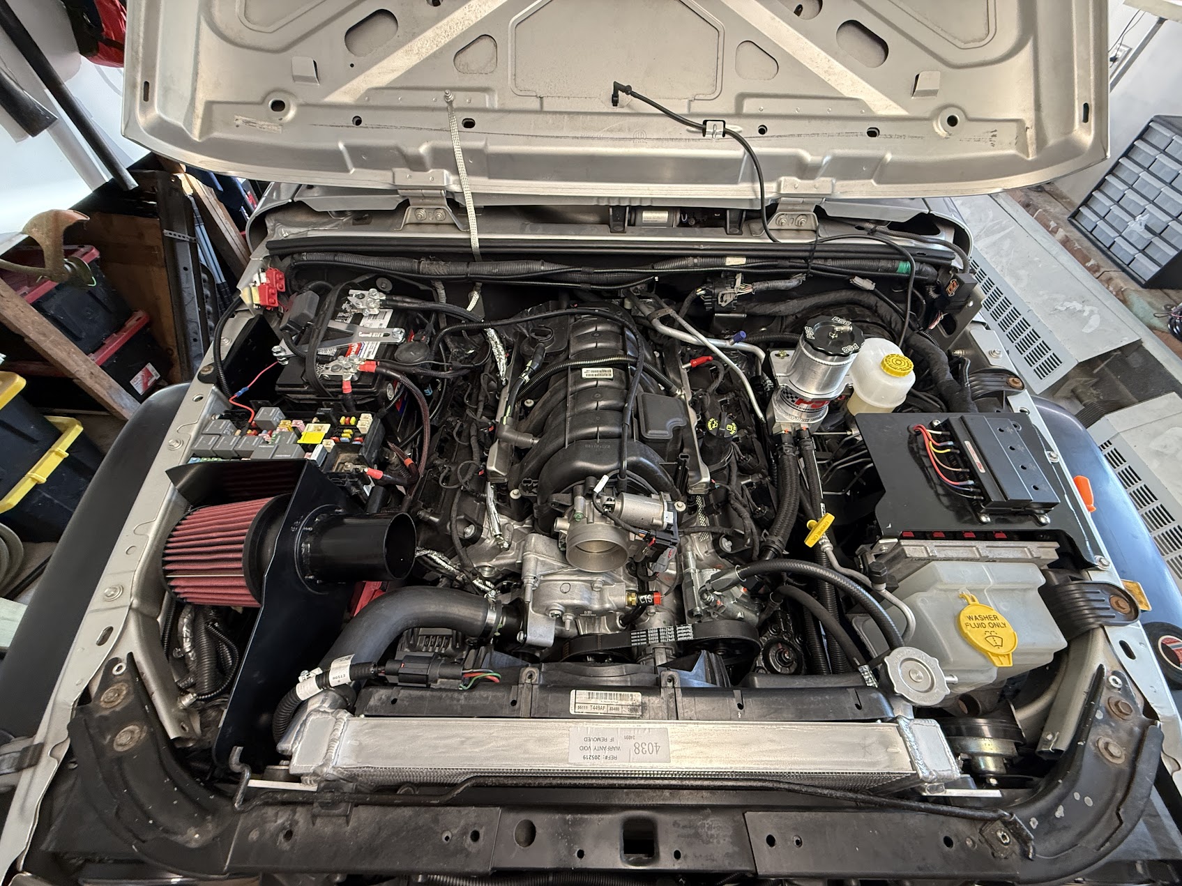

Remaining items before my test crank:
- I need to trim the plastic pieces on the radiator support to let the Norther Radiator and A/C condenser fit flush ✅
- Replace the remaining cracked loom at the front of the radiator support✅
- Connect the PSC cooler hoses and bleed the system (a lot easier when the radiator and grille support are off for the last time!)✅
- Reinstall the intake manifold and hook up the last few harness connectors (e.g., MAP sensor) ✅
- Reinstall the radiator and fan; connect the A/C lines
- Determine if the JL392 trans cooler is feasible; either install or find alternative and connect trans cooler lines ✅
- Install the RPM Extreme Fan Controller and Pentastar Fan harness; tap into CANBUS (also needed for TCM) ✅

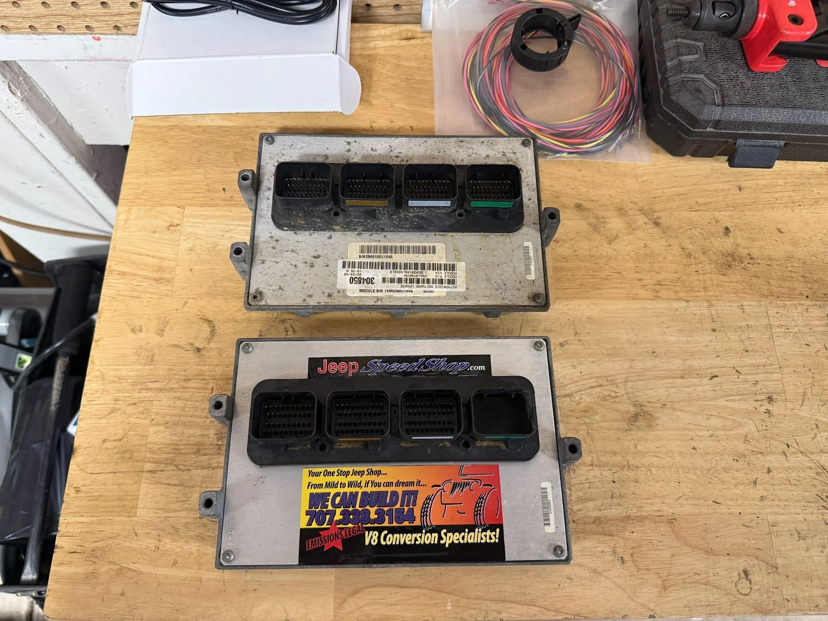

- Swap out ECM for JSS provided Hemi ECM (when it arrives) ✅
- Install and wire up the JSS 8HP TCM ✅
It's getting close, but also feels like a lot of work remaining when I start listing it all out. Still, I'm excited to be closer to the end than the beginning. Since I installed the engine at the same time as the axle swap, there are some other items I will need to do before my first drive (e.g., align the steering, bleed the brakes again, bleed ABS, etc.).
Well, what I was afraid of has happened - the delays have pushed the Hemi swap into the spring and into my second busiest time of the year. Between leagues shoots, team coverage, and end-of-the-school-year activities to cover (e.g. prom, graduation, etc), the Jeep unfortunately gets pushed down the line.
But - at least I now have everything i need to cross the finish line, er, well, at least get me to a test start soon. The JSS ECM and 8HP trans controller and wiring has arrived.

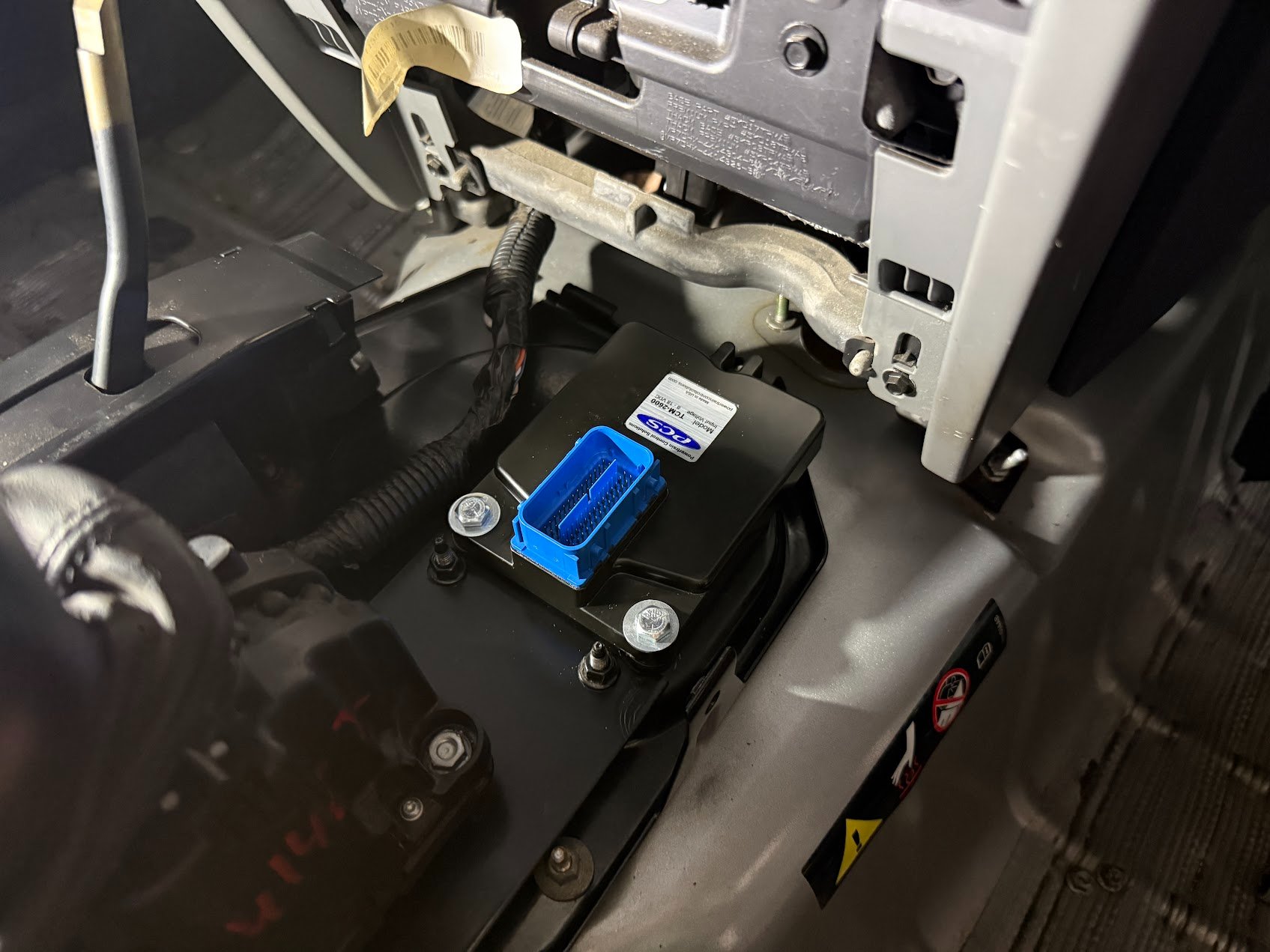

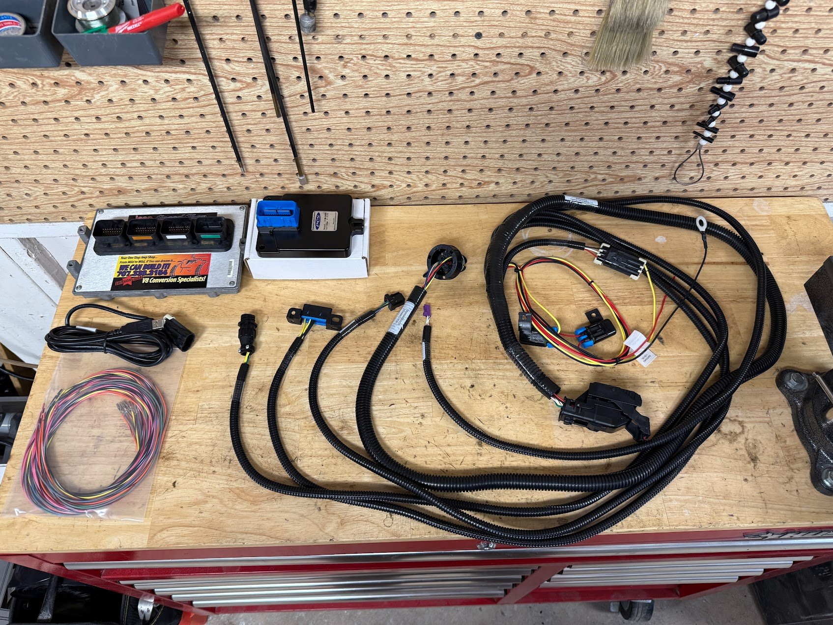

I've started running the wiring for the trans, including getting the PCS controller mounted. Many people just use two sheet metal screws on the back end of the controller, but that seems a bit ghetto for me. I ended up drilling some holes and installing some 1/4"-20 rivnuts. I actually ended up using three rivnuts, two for the TCM itself, and a third underneath that will let me use some sort to spacer nut/push-clip to help support the front of the controller. This, combined with two nylon 1/4" spacers will allow the PCS to float above the floor pan and stay away from the heat.
I need to run the power, CANBUS, and other wires, plus a couple to the ECM, but this will hopefully be done this weekend! My goal is to get a test-fire by the end of next weekend... fingers crossed!

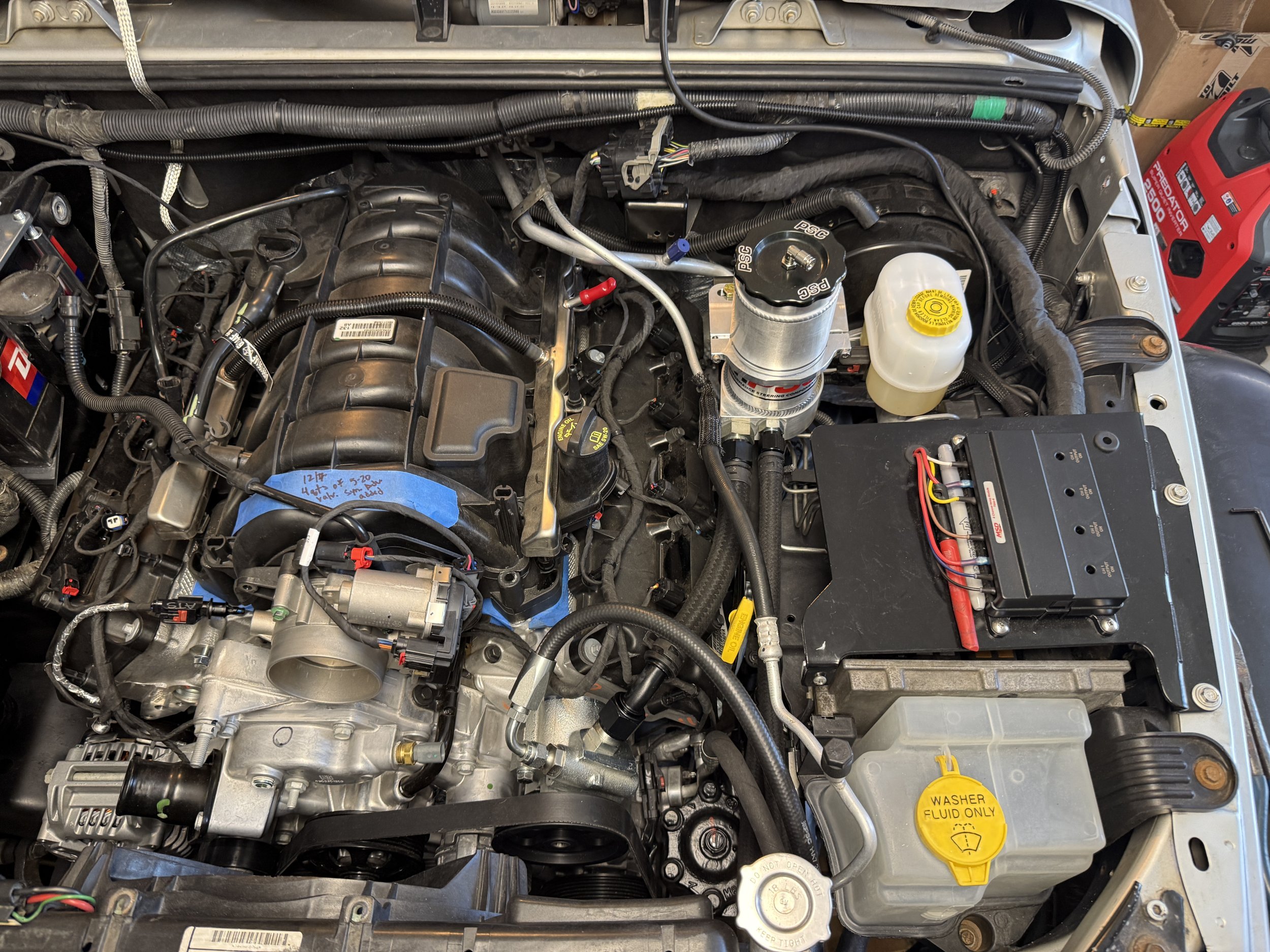

Some good news - I was able to test crank (not start, just crank!) the engine!

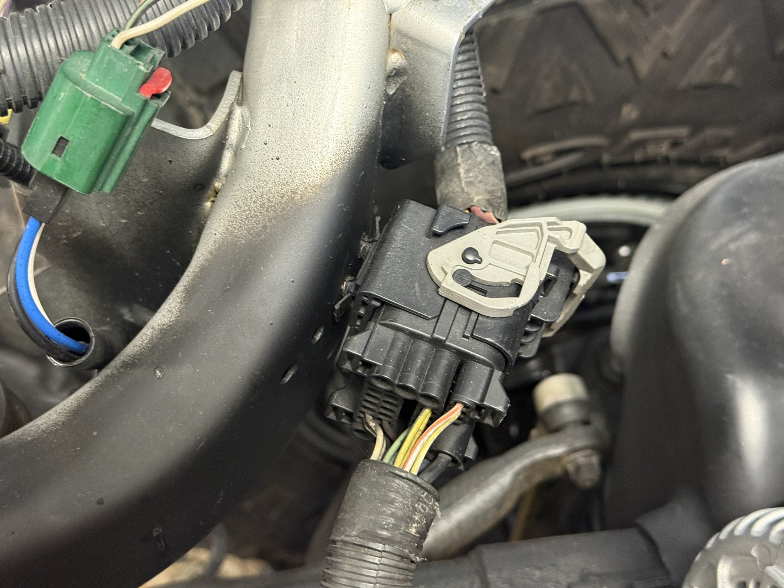

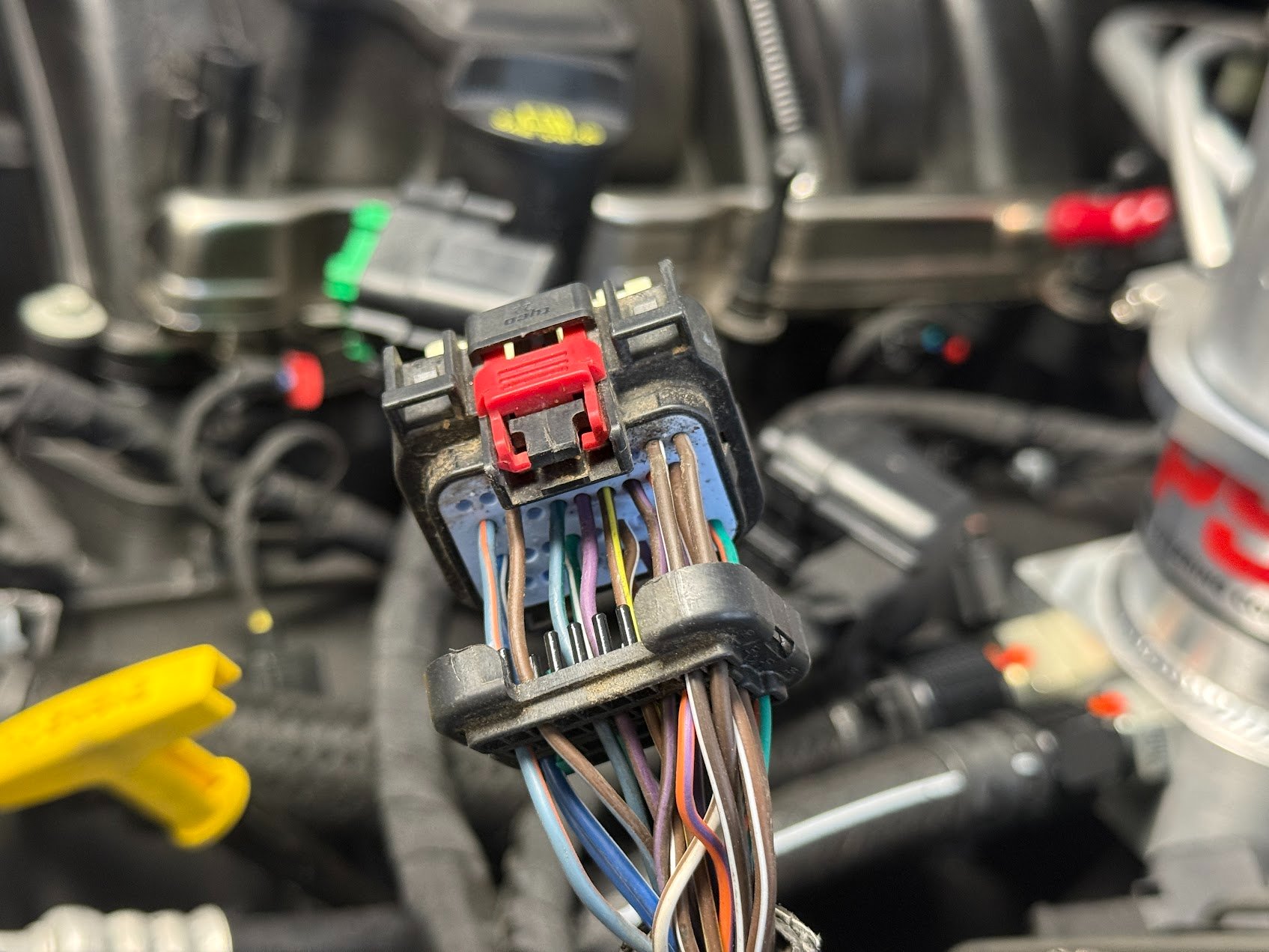

I got the C3 connector (the body harness portion of the ECM wiring) updated with the wires from the JSS harness... I gotta say, these aren't nearly as tough as the older JTEC connectors. These broke and I was even using the proper tools!

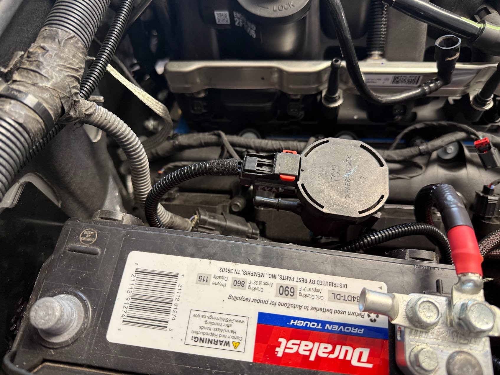

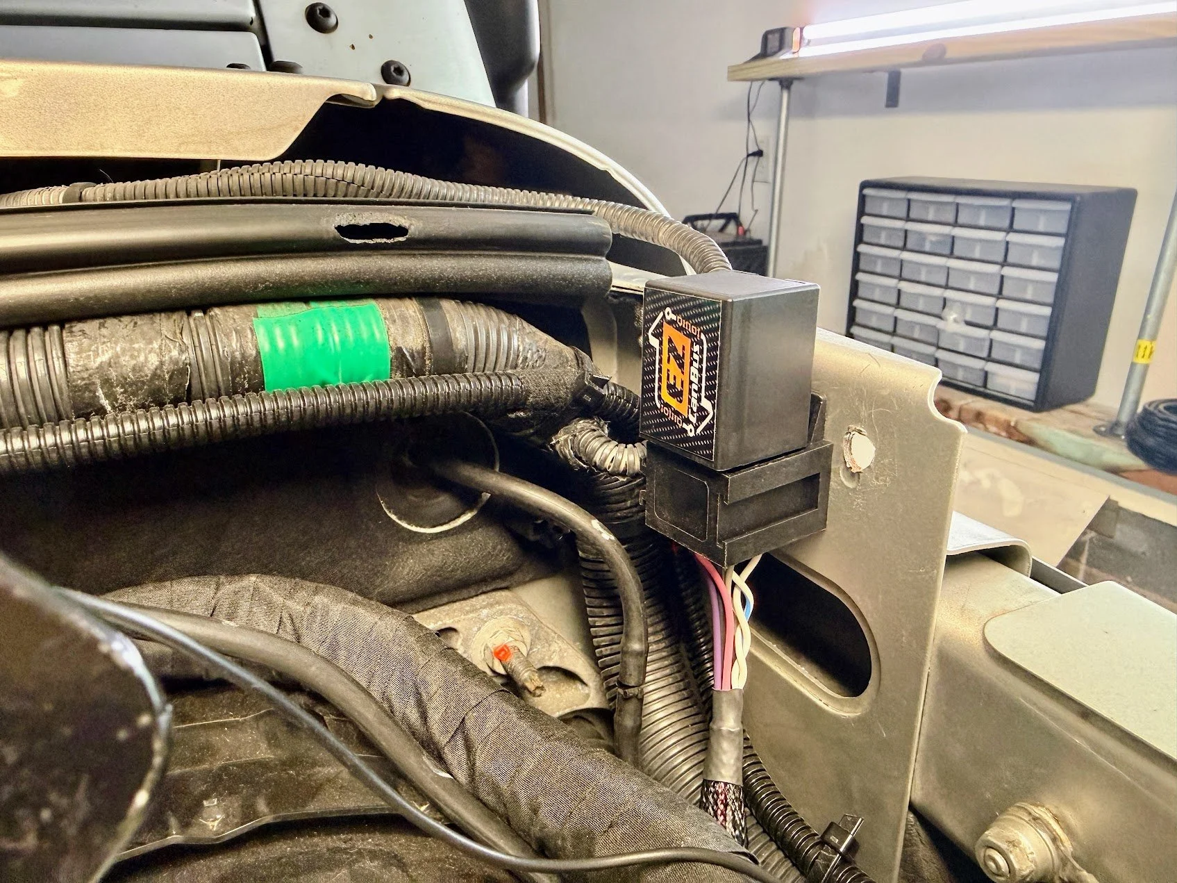

I think I found a home for the RPM Extreme PWM Fan Controller... it's close to the ECM, away from heat, and protected from the elements:
I have only temporarily connected the trans wiring, just to confirm that it all works, the shifter and dash gear selector illuminates properly, and I don't get the "Hot Oil" error (which means the CANBUS wires aren't correct). With a successful test, I now need to go back through, solder and heat shrink the connections, then tuck everything away.

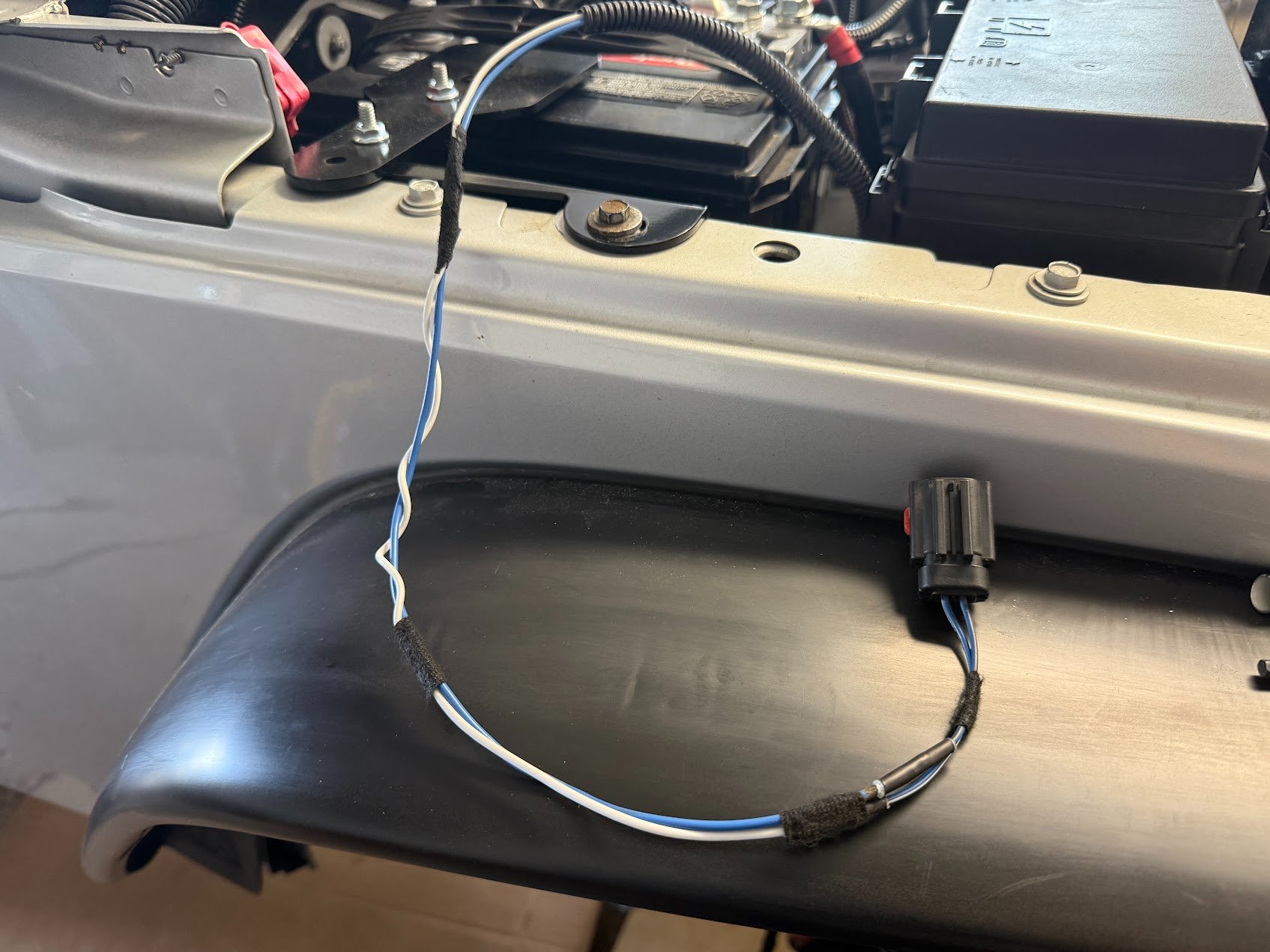

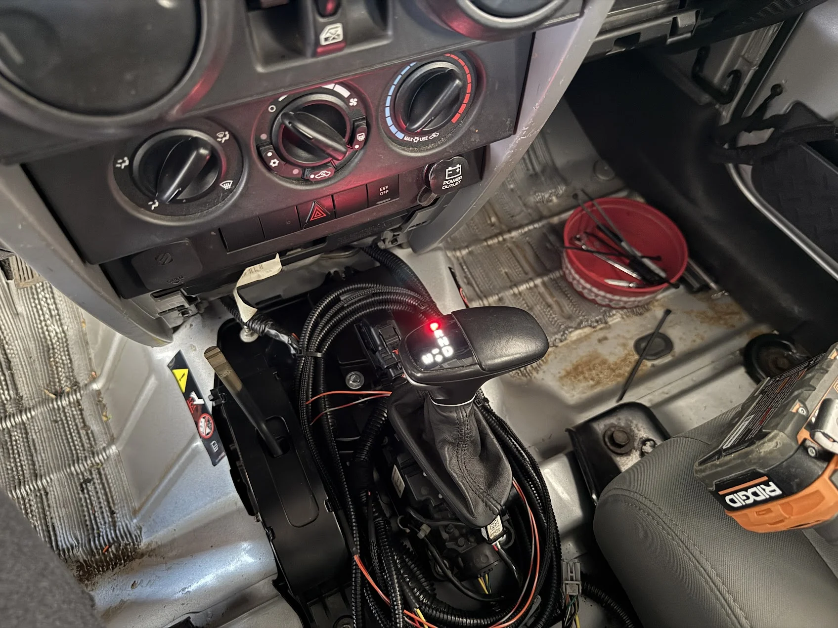

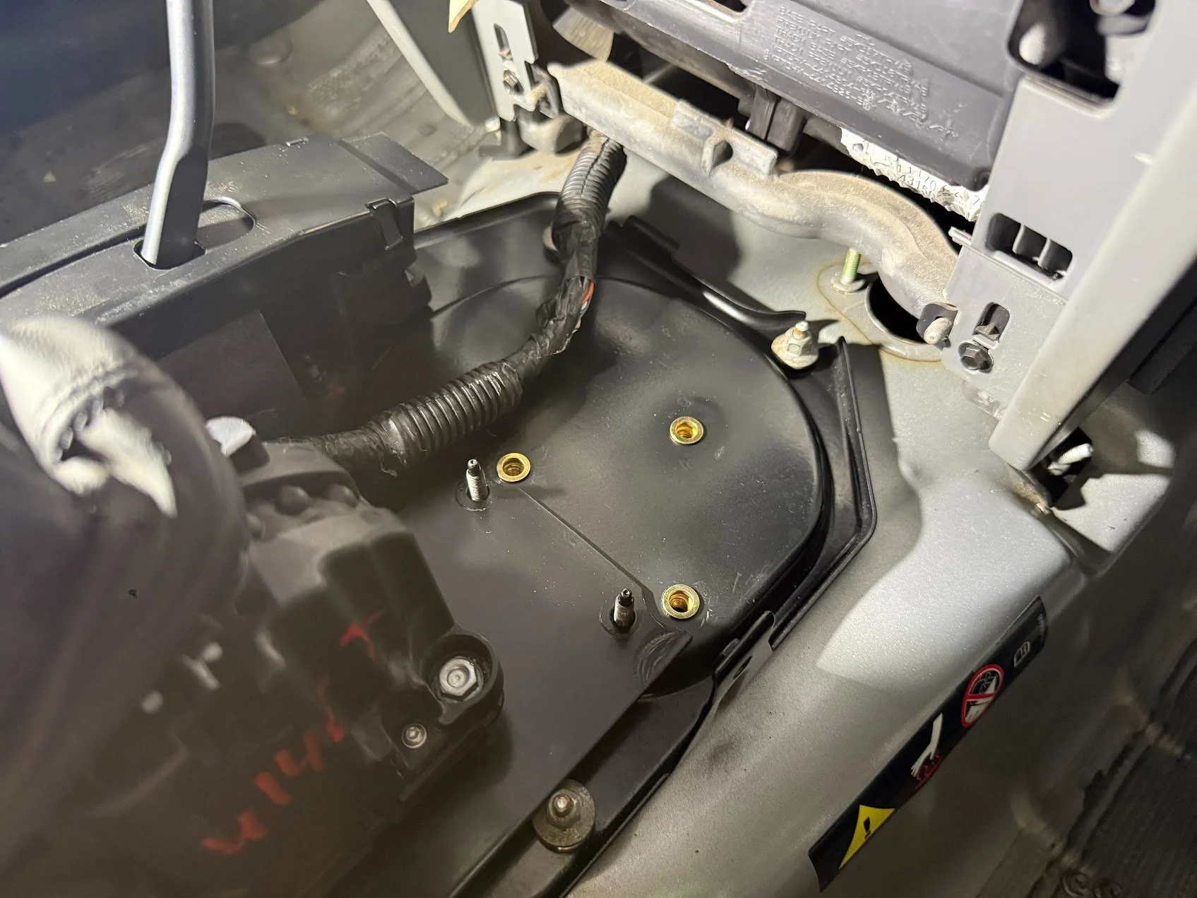

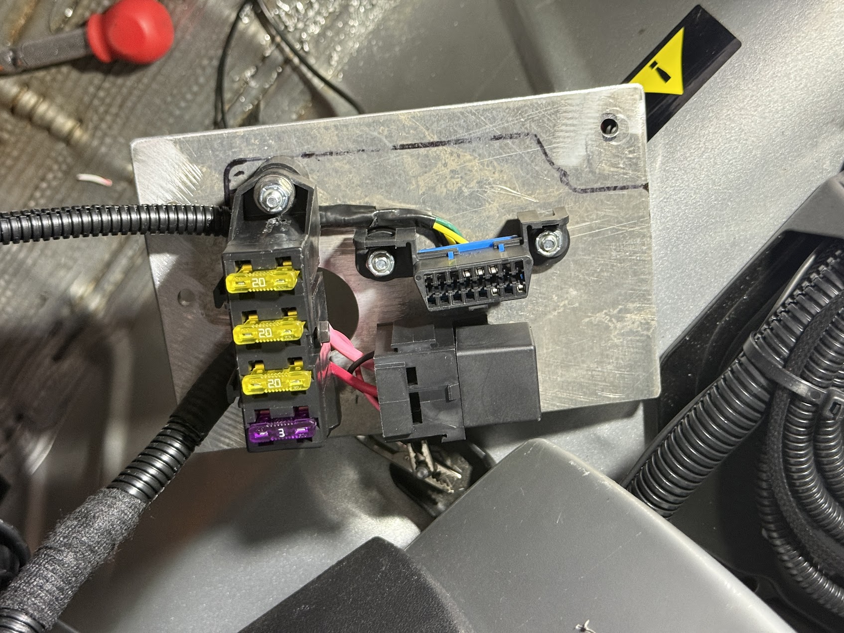

I went back and cleaned up all the wiring for the transmission and shifter. I ended up using a small aluminum plate under the glove box to hold a small Painless 3-circuit (2 IGN/1 Hot) fuse box and relay, as well as the OBD-II Data Link port (this is used ONLY for the trans):

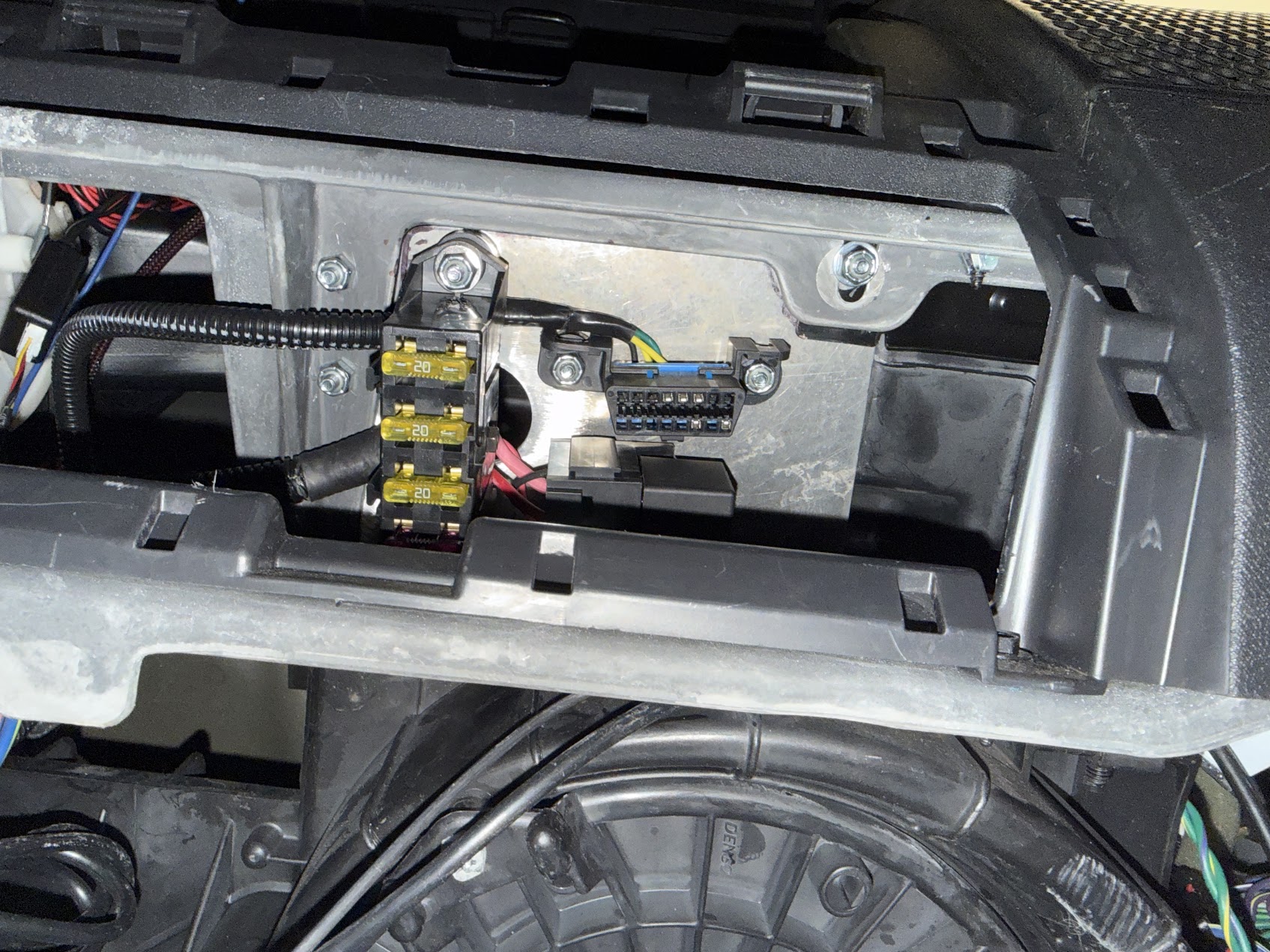

The angle of the photo here makes it look blocked, but I can easily access the purple 3A fuse for the relay "trigger" circuit (which is tied to the TIPM via an "add a fuse" tap):

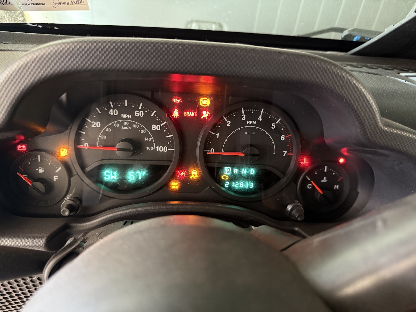

With everything soldered and wrapped, I confirmed that the dash still lights up like it should (the only time you WANT to see all your dash lights on!):
...and the shifter correctly shows "Park":
I was at the point where I wanted to confirm that the various CANBUS connections were working as they should, so I cranked the engine to see if the starter would engage. This worked as it should, so I cranked it a few times throughout the afternoon to get some oil up through the system and into the valvetrain:

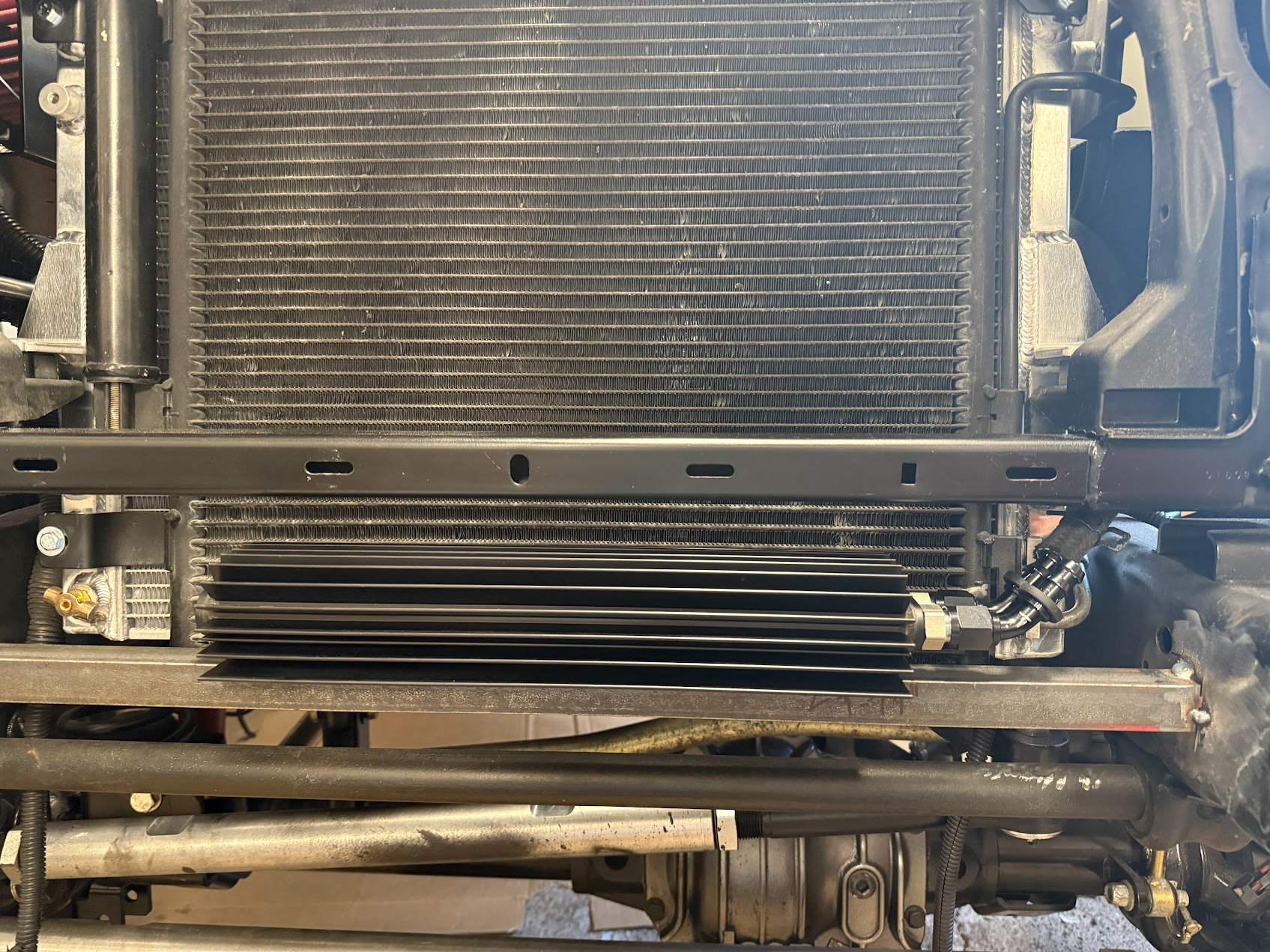

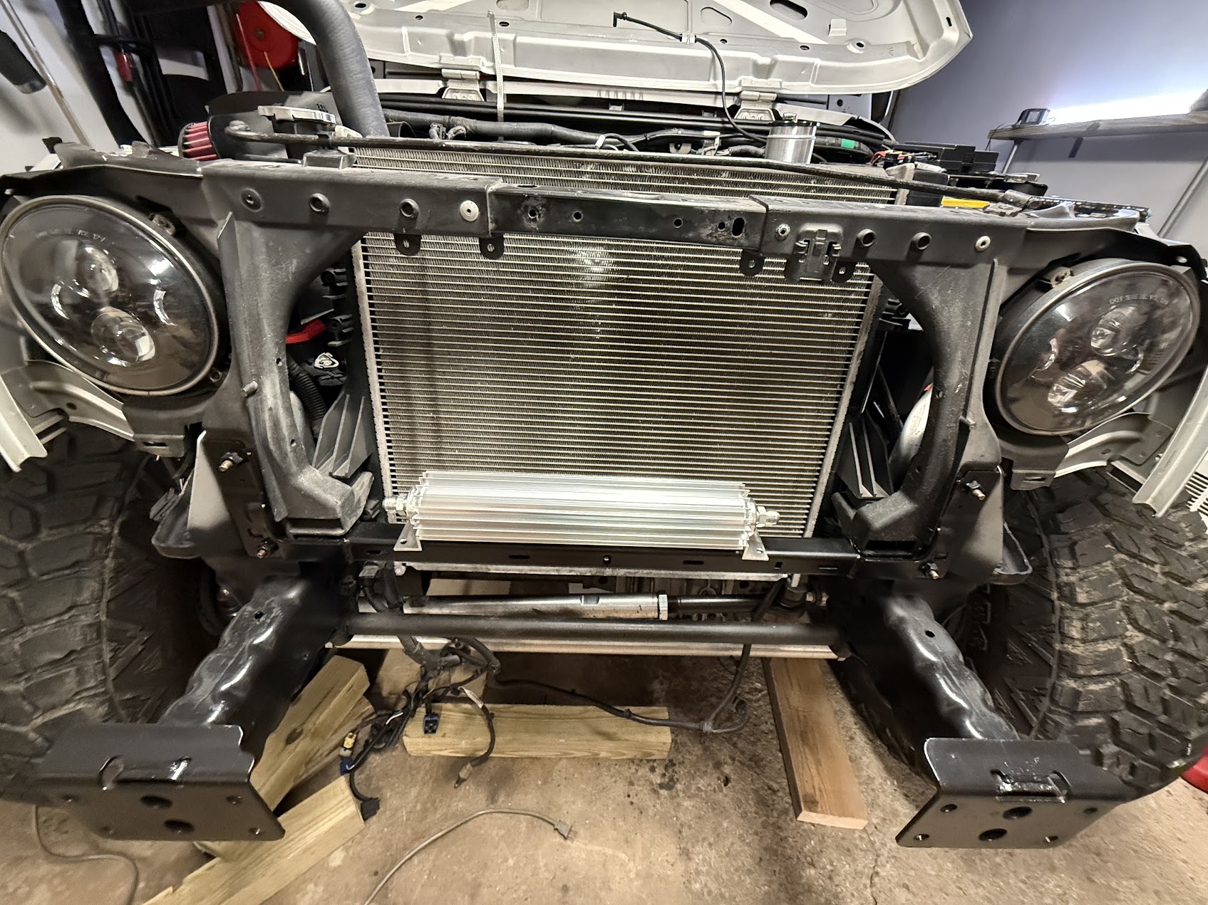

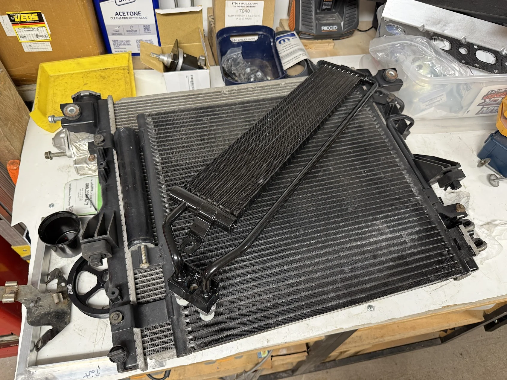

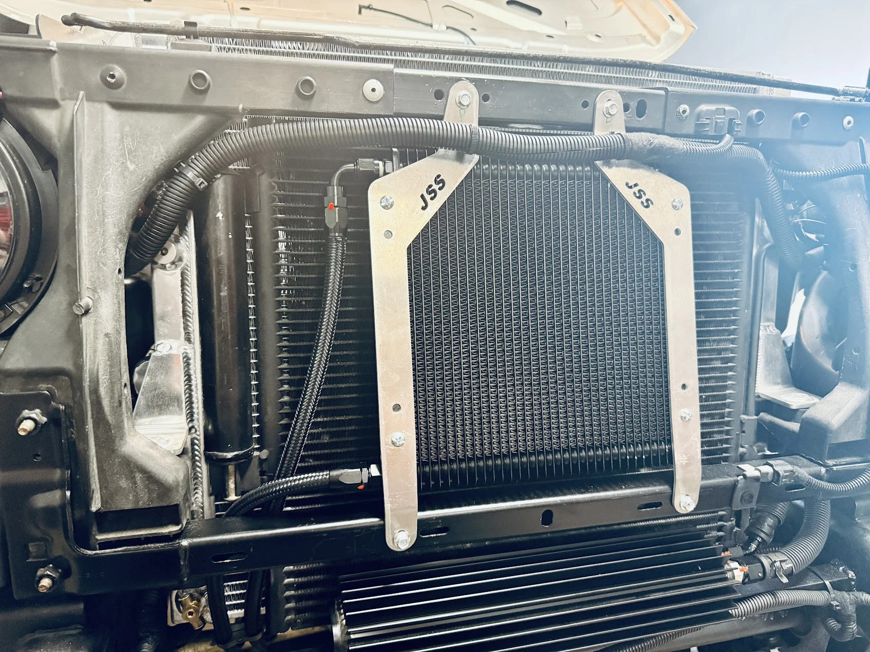

The JSS Trans Cooler mounts have arrived, as has the Hayden 689 Plate Cooler and a bunch of AN hose and fittings. Time to knock this out so I can fill with ZF fluid and then finally connect the lower radiator hose and fill with antifreeze (leaving the lower hose disconnected seems like it will make it easier to work on these trans cooler lines).

- Test fit the Motobilt Rear Fuel Tank and skid ✅
- Bring MB skid to powder coater ✅
- Bolt the t-case back up and install the driveshafts ✅
Getting closer... my gas tank skid unfortunately didn't get finished this week, so I've been knocking out some other things on the to-do list that aren't necessarily related to the test-fire, but need to be done anyways.
I got the OEM 392JLU trans cooler lines modified (basically cut them off after the t-stat block and flared for an AN fitting). This let me wrap up the Hayden cooler install thanks to the JSS trans cooler mount.

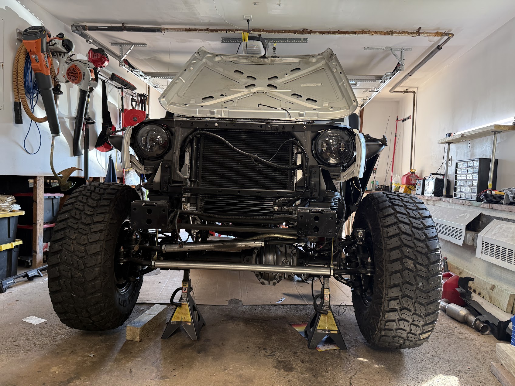

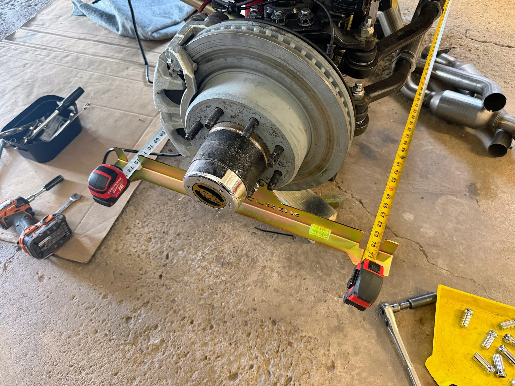

I also spent some time getting my alignment done:
I usually just a few pieces of masking tape but I bought these alignment plates from Metalcloak on a big Black Friday blowout sale. Not as cheap, but admittedly they do make things go faster. Since the gas tank skid won't likely be done until ~Wednesday, I'm going to keep going on the full list of stuff I need to do before a test drive. Today, I will be focusing on checking the torque on all fasteners and cross-marking them with some paint/crosscheck. I also need to swing by the hardware store and see if they have any insulated hose clamps with a ~10mm hole inside instead of a 1/4" for use on the trans harness and fuel lines...

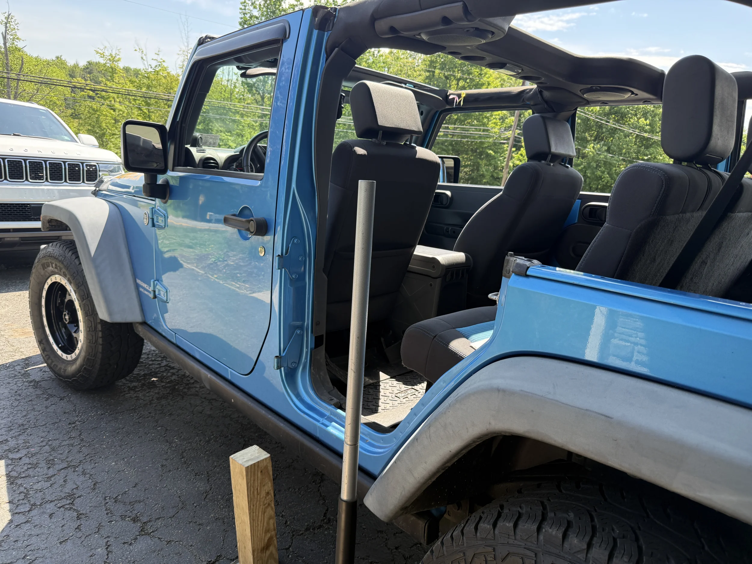

Been busy getting some work stuff done and preparing for our trip to Chicago, but my boy and I were able to finally get the soft top installed and tested out. We even threw the Bestop soft doors on for a quick drive around town running errands. I forgot just how dark a black softtop makes the interior (not a bad thing!) but will say that these modern softtops are incredibly quiet and smooth at highway speeds compared to my YJ and TJ days.
I was worried about the soft doors rattling around but they're quiet...
I really need to do something about the fender flares. They're ugly as can be and kill the look (not that this thing is winning any car show). I am contemplating throwing on a 2.5" AEV Lift with correction brackets before the summer ends and going with some 35"s. I have a spare set of KBD flares and my concern is that with the lift + KBD flares, that 35"s are going to really kill the proportions of things, but I suppose it's better than it is now (esp with that huge front bumper).

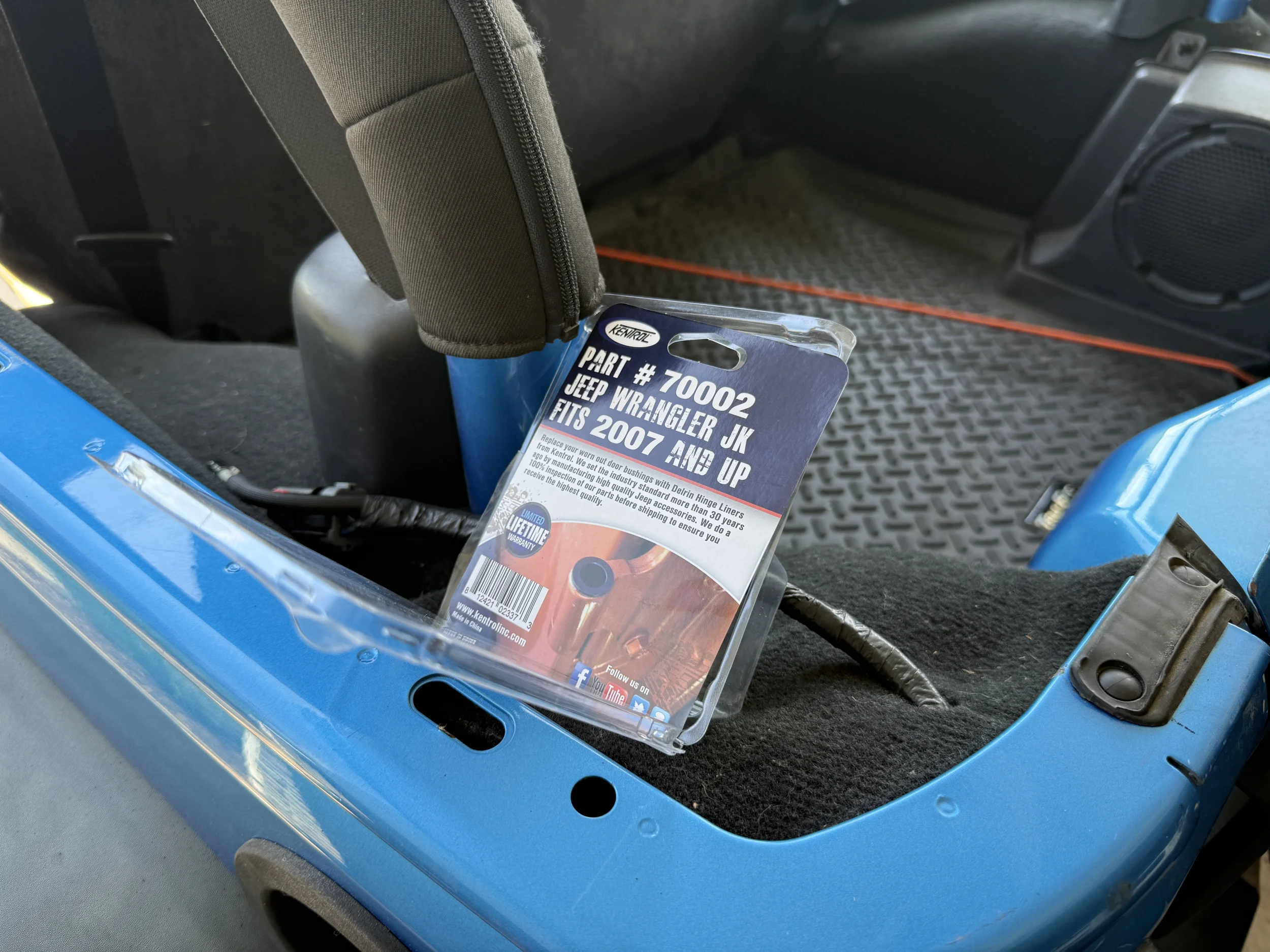

In cleaning the Jeep out, I found a little rust hole in the driver's side floor (about a 6" circle). I'm not sure if this was there before and I just missed it, but it's something I'm going to need to address for sure. Everything else seems fine, so not sure why a very small portion of the driver's floor rusted completely out, but it's unexpected for sure.

With the coolant overflow out of the way, I was able to fill the system and burp it as much as possible (and check for any leak issues). For anyone doing a Gen III Hemi swap in an earlier year JK, remember that the VVT Hemi's all take OAT coolant, not HOAT like the 2007-2011's. Next up was the fuel system. I finally got the gas tank skid back from powdercoat and began installing everything. The instructions and parts kit from MB uses 7/16" nuts and requires a hole to be drilled in rear of the frame rail. I didn't want to deal with 1) a funny sized socket and 2) deal with fishing a small nut and washer through a frame home with my sausage-link fingers, so I bought some M12 bolts that matched the sway-bar/front mounting point bolts, and make some nut plates that sit on the inner frame rail.
I generally like Motobilt stuff, but their instructions are usually wrong or missing information, and sometimes their parts kits are incomplete - or in my case - basically worthless. For example, their instructions only cover the later year JK's (although they have small "notes" for earlier JKs) but the real world installations often are a mix of "do what works best" and "ignore all the random parts you got". For me, my tank came with a ~1-3/4" radiator hose and two 1-1/2" to 1-3/4" aluminum couplings. It also came with a roll of 3/8" fuel hose and some 3/8" plastic evap hose...
First, the evap hoses on the JK's are all 5/16" (regardless of year), so whatever the included was basically worthless. This is especially so given the fact that the gas tank vent nipple and overflow nipples are both 5/16", requiring me to run to the store to get a few feet of 5/16" emissions hose. Second, thankfully I didn't do any cutting per the instructions before I took a deep look into the fuel filler neck. Not only did I not need to run any silly adapters or radiator hoses, I was able to do everything with the OEM parts! I used the fuel filler neck and trimmed it up as long as possible on the vertical "drop" coming out of the filler. On the tank side, I used the OEM hose and pipe that was about halfway down to the OEM tank. Some trimming of the pipes and some hose clamps and it fits and fills nicely (ignore the rust, I cleaned it up after cutting to size and then painted with some Eastwood Rust Inhibitor Paint).
With the gas tank installed, I routed the gas line from the fuel rail, down and across the back of the engine (without touching the engine!), and secured to the transmission with some rubber insulated Pico clips. Once the hose followed the trans and was "pointing" to the rear, I move the line to the body, just above the frame rail, and secured with some more Pico clips. There is an "S" in the line, which will accommodate driveline vibrations and twist, preventing the fuel line from having a bad day under some serious twist or flex!
A half dozen other small things done, I figured it was time to crank this bad boy up and see what happened... after two separate 20-30 second crank sessions (to get enough fuel into the rail and injectors), she roared to life!!!!
I was excited and relieved that she sounded so smooth - I have a few more things to do now, the main one being figuring out the exhaust. Unfortunately, the Ram downpipes and cats simply won't work for what I need. Even if I cut them up into pieces, they're going to cause issues (they're also 2.25", not 2.5" as they were advertised to be!). I reached out to Jeep Speed Shop to see if they'll sell me some downpipes and it looks like they will. With any luck, I can get those in the next week or so and be able for a test run down the block...
