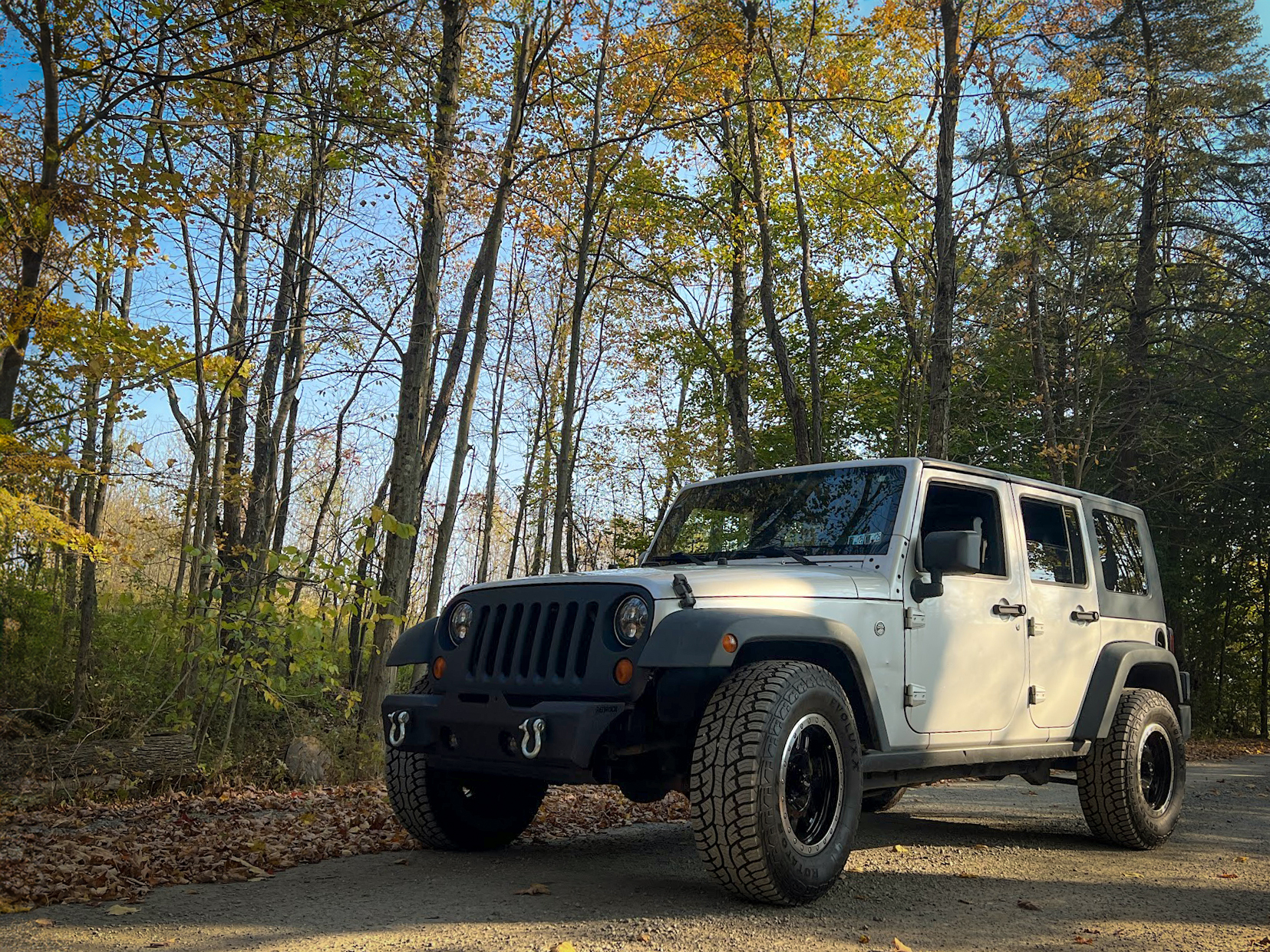

Currently mid-build - swapping axles, engine, etc... but here are the basics:
Current Mods:
  • 3.5" MetalCloak Game Changer Lift
  • 37" Delium M/T's (40"s are planned for)
  • UD60 Front Axle, Eaton E-locker, 4.88's
  • GM AAM 10.5" Rear, Richmond PowerTrax Grip Pro (helical LSD), 4.88's
  • Mopar J8 Brake Conversion
  • Fusion 4x4 F-ton Steering Linkage
  • PSC Big Bore XD Box w/6.75" cylinder assist
  • Red Rock Attack Stubby Winch Front Bumper (chopped bumper planned post Hemi swap)
  • Warn Zeon 10-S Winch
  • Alpine iLX-W670 head unit with Alpine HCE-RCAM-WRA backup camera
  • AEV Tire Carrier (modified to fit 8x6.5")
  • Mopar Rubi 10x Anniversary Rear Steel Bumper
  • Mopar Performance 345 Crate Hemi
  • 8HP70 ZF 8-speed Auto conversion
  • Adam's 1350 shafts
  • Motobilt Aluminum Rear Mounted Gas Tank w/relocated EVAP
  • Bed Rug w/butyl matting on floorboards
Future Mods Being Considered:
  • 4-link the rear
  • Possibly a "cage style" roof rack (e.g., Gobi Style)

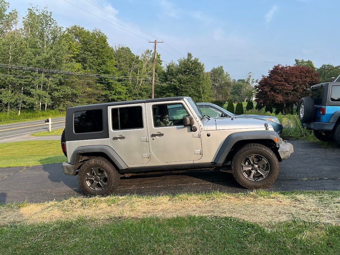

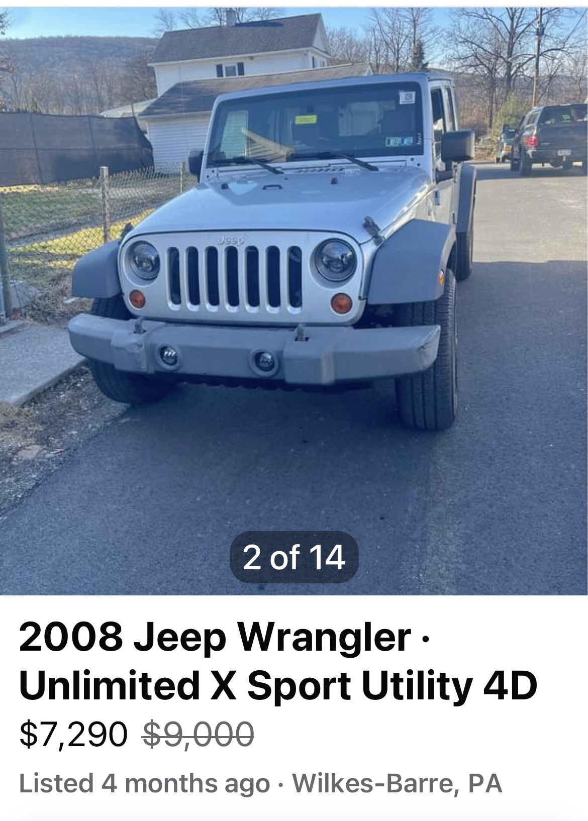

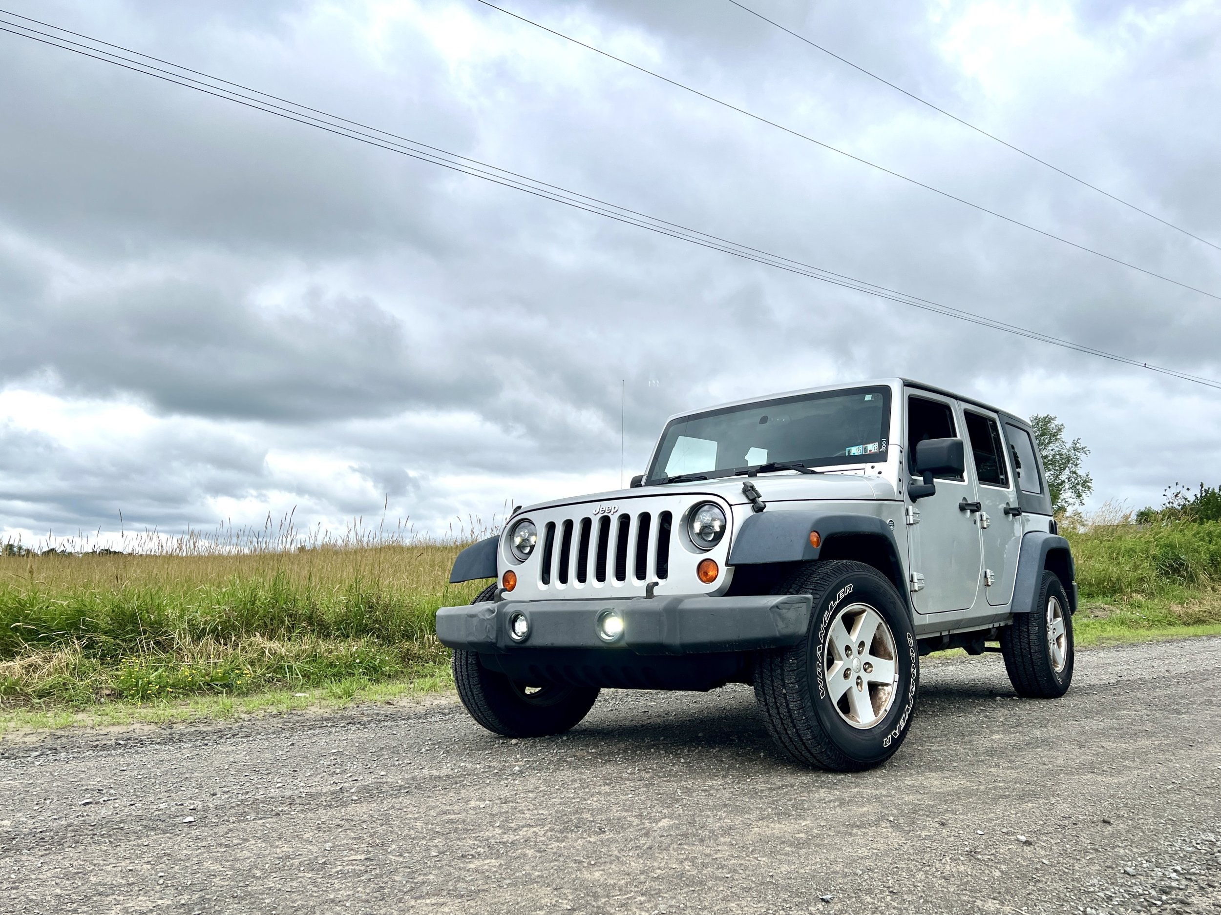

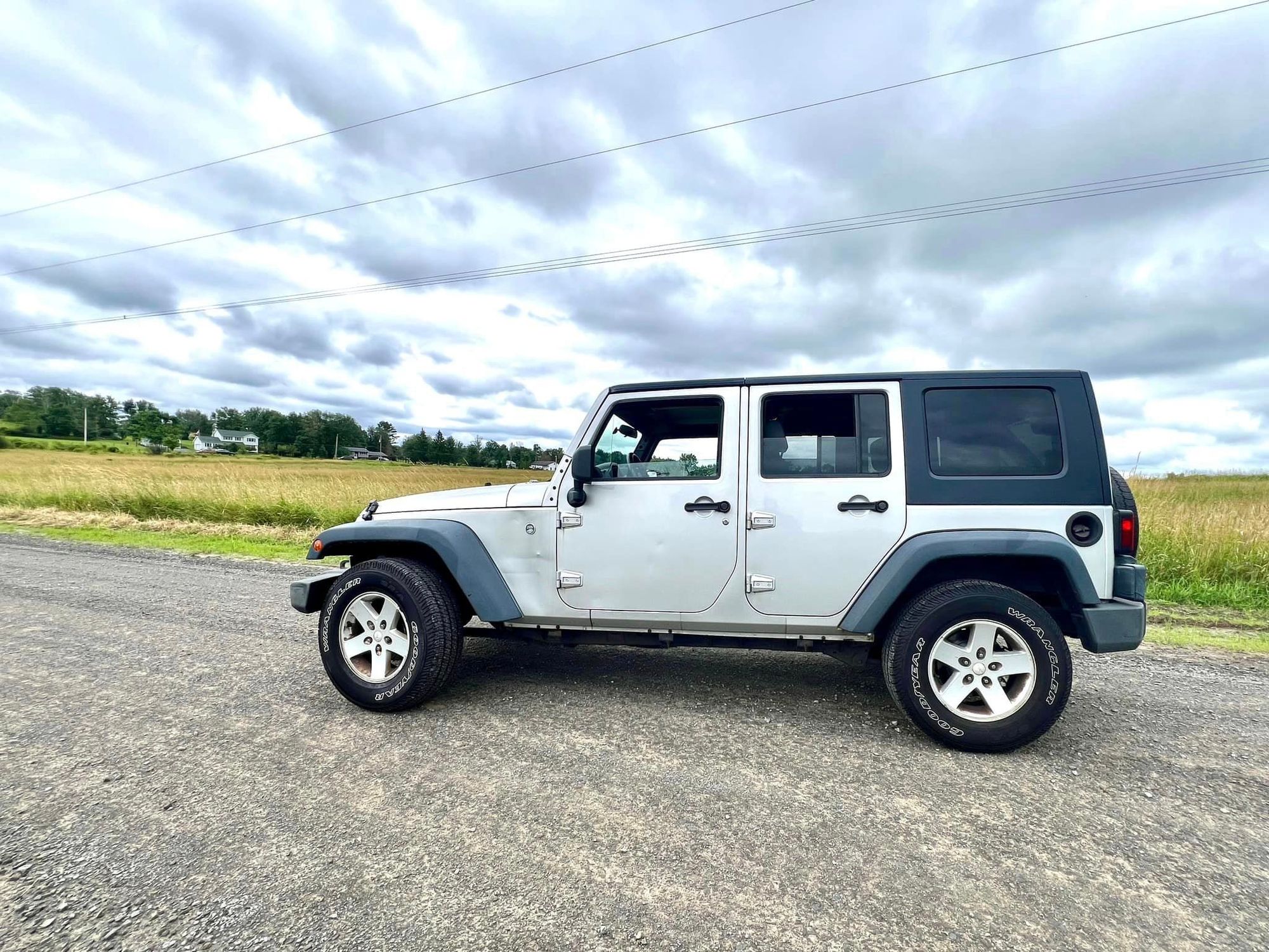

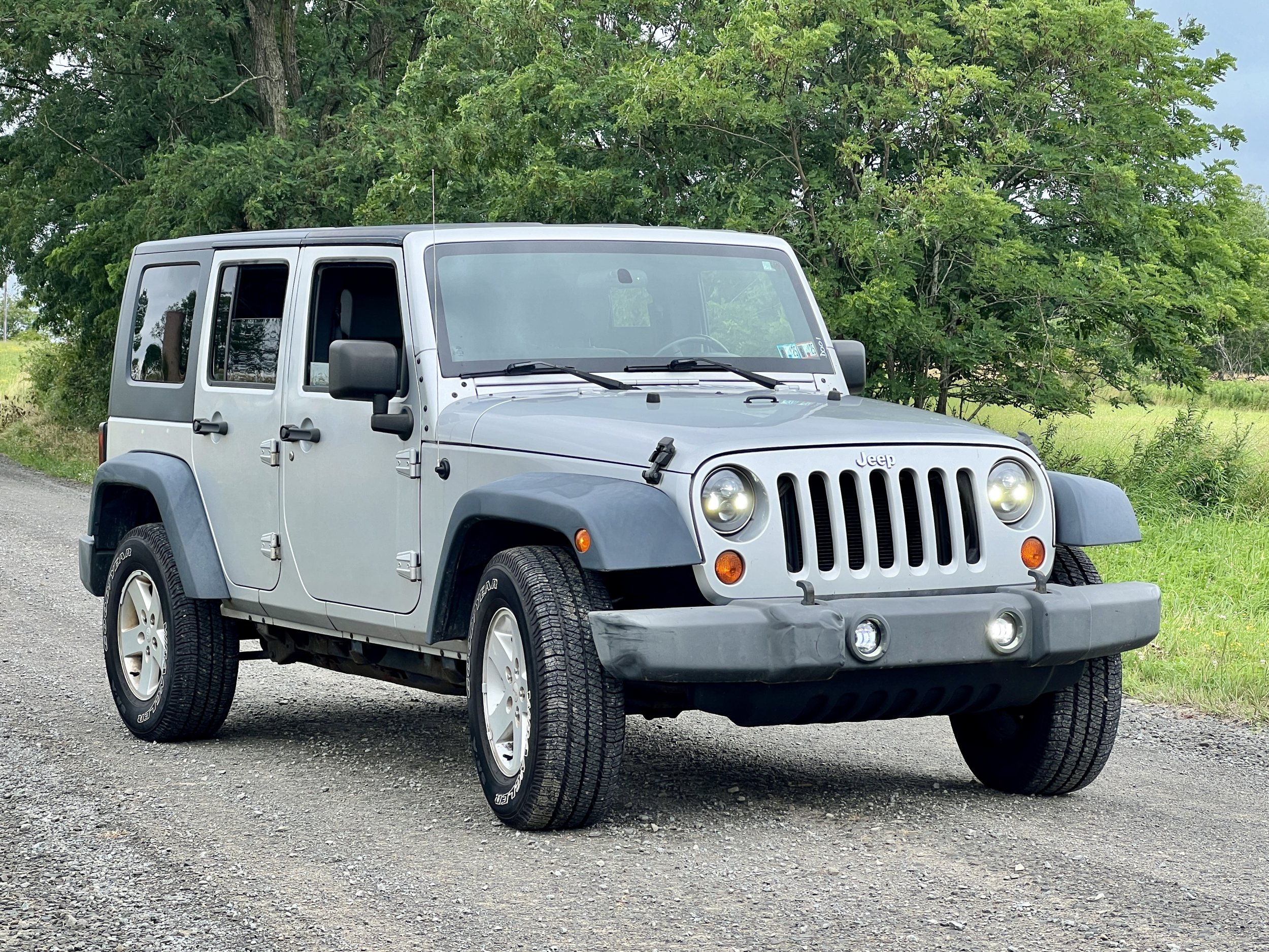

Left with the need to replace the LJ, I was up in the air about what to get. I was looking at getting a new Ram Power Wagon, hoping that CJDR would bring back their 0% interest rate again to help with their massive overstock inventory. It would be a comfortable, but still a "practical" decision, since we also live up in the country and having a pick-up is handy for a number of reasons. However, the Power Wagon didn't have much of a "fun" factor, at least not like a Wrangler does. Getting the "itch" to replace the LJ was growing strong and I did some late night looking around on Marketplace and ran across this...

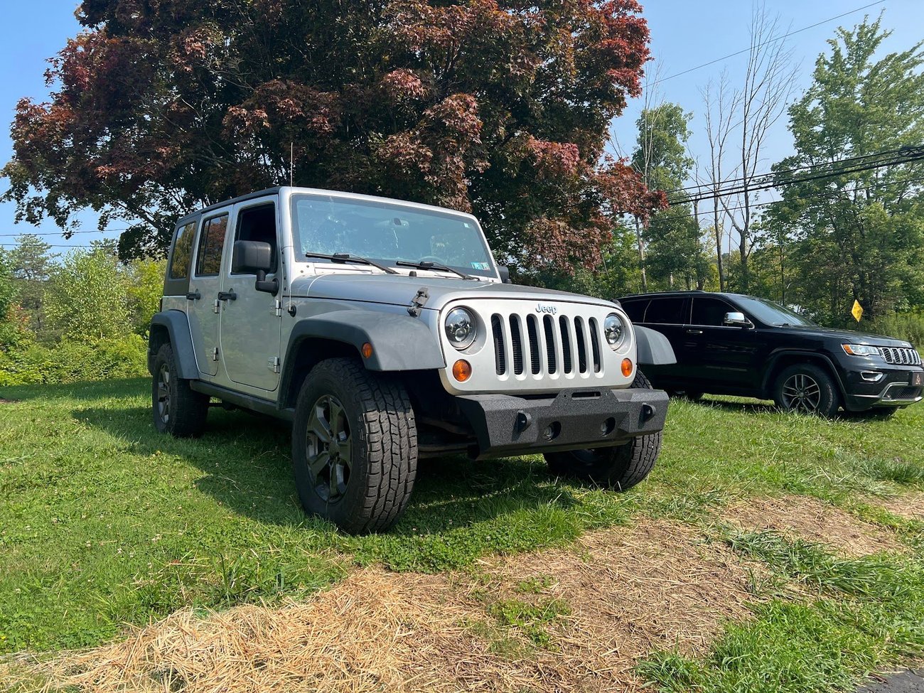

Three days later, I met the seller for a test drive. Other than a small dent in the driver front fender, and the absolutely filthy interior, the Jeep was in good overall condition for being 16 years old. Before I could even make an offer, the seller said that the absolute lowest he would go would be $6500. Knowing what the market was for these at the time, it was ~$2500 (locally at least) below what he could have gotten, had this thing had an oil change (or at least had the oil light cleared!) and gave the interior a decent cleaning. Needless to say, I drove my 209,000 mile, bright silver, 2008 JKU back home that afternoon.
Originally from Florida, with zero rot and just some mild surface rust on the frame rails, it seemed like a killer option for me to have a little fun with a new build, while still getting the space and practicality I needed. Here are some photos from the day I brought it home...

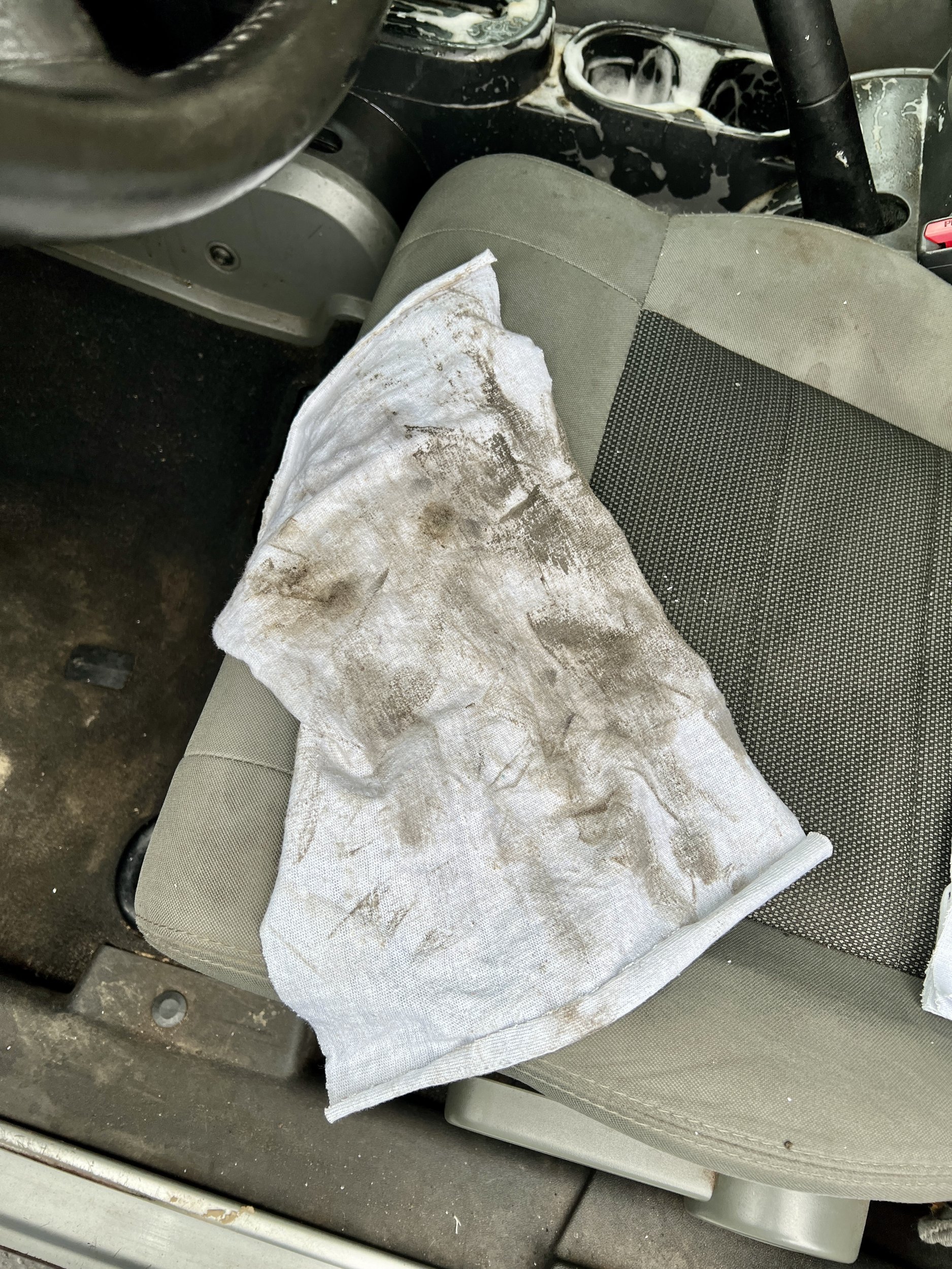

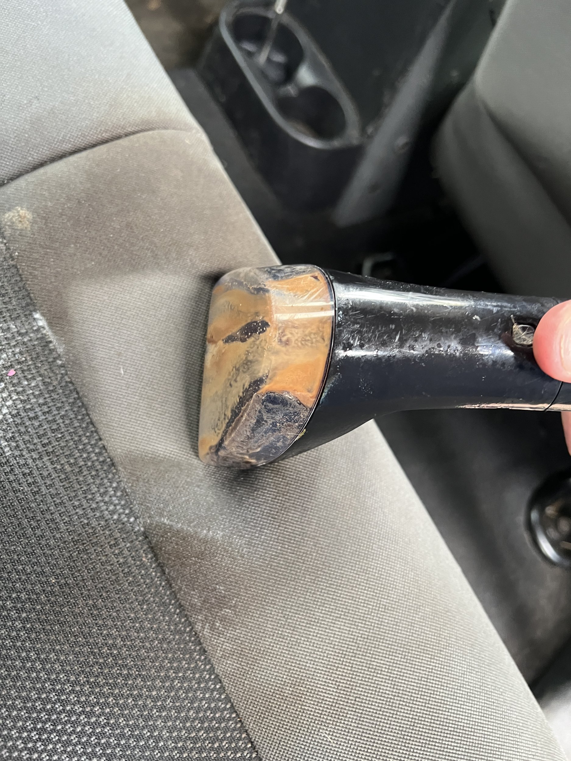

The filth on the inside of this thing would have made a lesser man vomit. I don't know how this guy, who bought this for his wife, actually intended her to drive it. This filth was just from the driver's door that I wiped clean so my arms and shirt wouldn't get stained... I don't know how some people live to be honest!

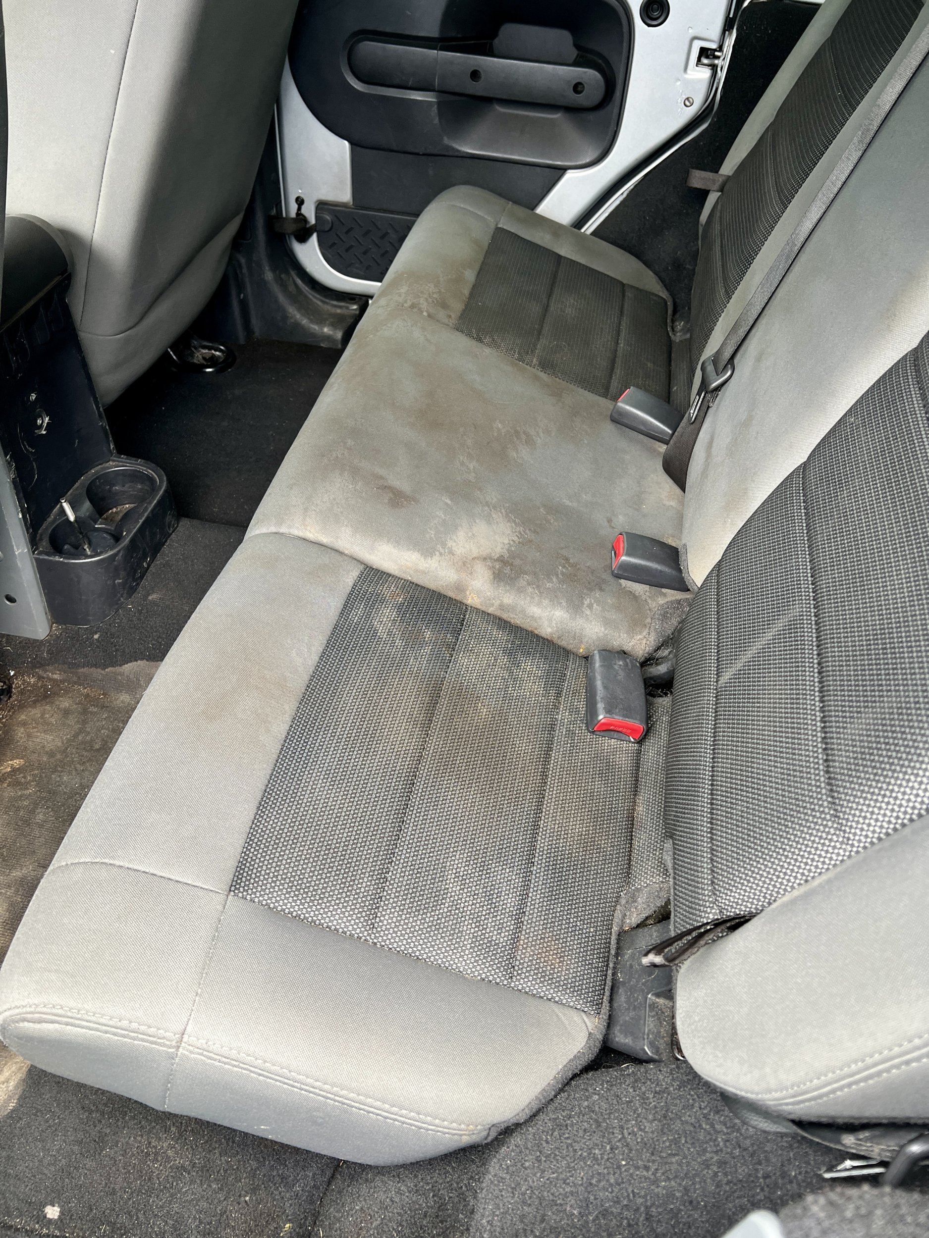

The seats... oh the seats. I don't know what the stains are from but they were disgusting. The saving grace with this Jeep was that despite the lack of cleaning, there weren't any atrocious smells.
With some Bissel "heavy stain" treatment, everything cleaned up nicely even after only a single pass.

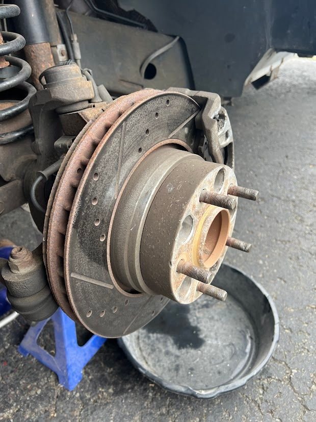

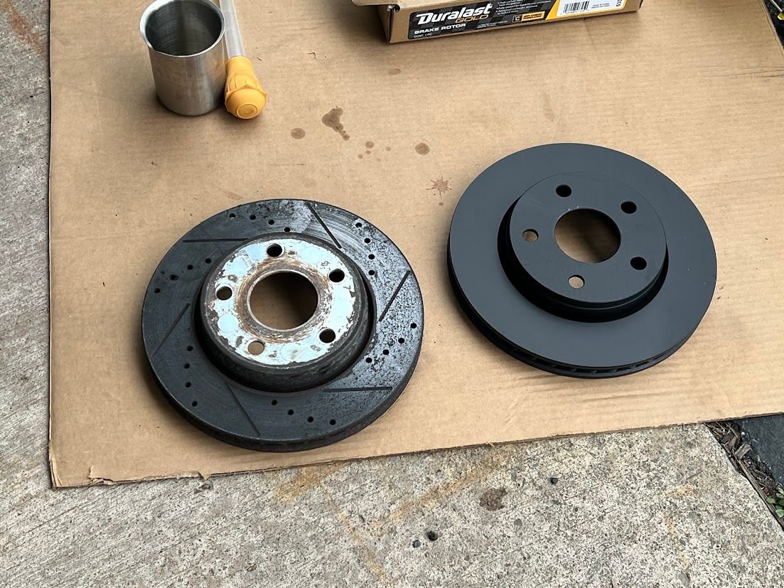

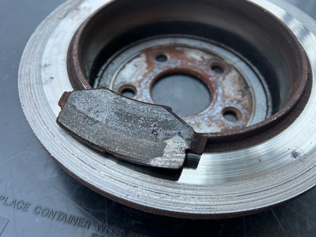

Same thing for the rears. With some fresh caliper-pin grease and new pads and rotors all the way around, the braking wobble went away completely. I turkey-bastered the brake fluid reservoir and put fresh DOT 4 inside, then proceeded to bleed the front until fresh fluid came through.

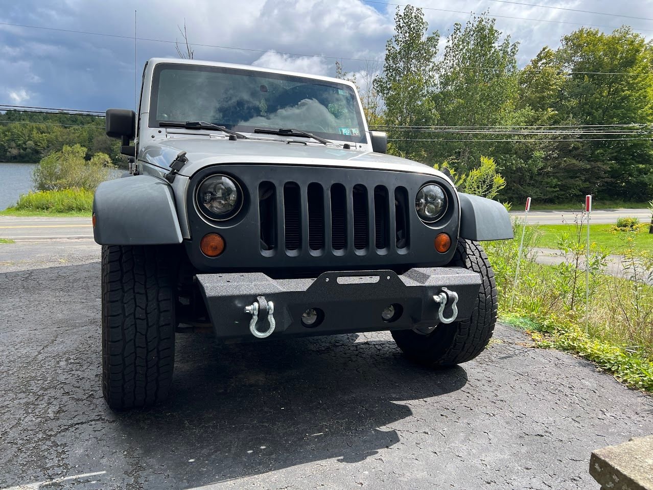

In a stroke a good luck, I found a guy not too far away selling a set of Rubi Recon take-off wheels with near-new Cooper Discoverer AT3 - the same tires my wife has been running on her Grand Cherokee for a few years. These are excellent in the snow an as you can see in the photo, really helpful for our driveway. For $600 they were a good deal and fit well into my short term plans - they even came with brand new TPMS sensors. The seller also had a bunch of stock components - all low-mile take offs from his Recon build. He let me pick through what I wanted and I got a replacement set of UCAs to replace mine for pennies - win!!! On the same day, I met a lady who had a set of take-off Rubi rock rails for $100.

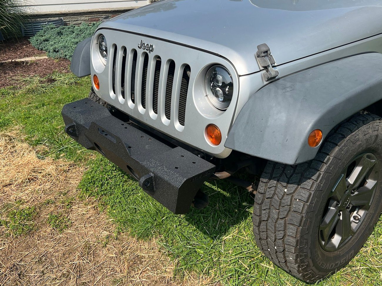

I figured if nothing else, the Rubi rails were better than leaving the surprisingly sharp and rusting remains of previously installed steps.It's amazing what some decent looking wheels and Rubi rails will do. Turns this from an old lady/man/mom car into something that isn't totally embarrassing in the parking lot.

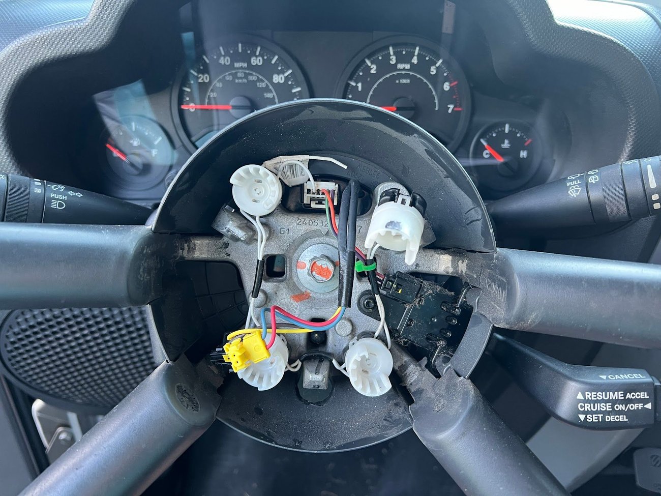

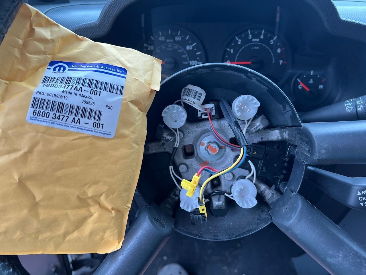

Next up was fixing the non-functional horn. When I first brought it home, the horn only worked when the alarm was going off, and it was a junk "air horn" style that sounded like it had a squeak toy stuck down the pipe. After ripping that out and replacing with a low-tone "highway blaster" from AutoZone, I attempted to start diagnosing why the horn didn't always beep when I pressed the horn button. Starting at the top and working down, the logical step was to make sure the fuses were first good, then check to see if the switch was working. Thanks to YouTube, I figured out how to remove the horn pad/airbag and lo and behold, as soon as I did, I quickly realized the likely culprit. The white wire was broken off and resting above the connector. A quick $90 on Amazon got me a Mopar replacement and all is well:
It was $94, but a necessary evil. I wish I could get the keyless entry going next, but looks like I'll need to dig into that a tad more.

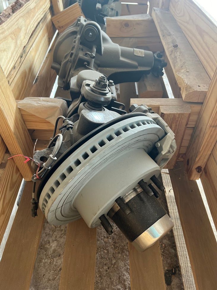

With the above build plans in mind, I've started collecting parts to make it happen. I found what I believe to be the last remaining "Mopar Performance" Dana 60 crate front axle in the U.S.. For the price that I paid for this from Jegs, I literally couldn't build a SD60 of equal performance. The MP60 is the same exact axle as the UD60, except it says "Jeep" on the diff cover, instead of "Dana". Heck, for an almost $4500 savings, it could be powder coated pink and say "Powder Puff" for all I care!
Some people aren't huge fans of the UD/MP60 axle, though most seem to run these fairly hard without much issue. I believe that there were some historical QC problems (loose spindle nuts and poor welds being the most common), though for my application it made the most sense overall. The 69" WMS keeps me wide enough to run up to 40" tire widths with ease, while still keeping the rig reasonably narrow (going back to the "inspection friendly" bullet point above). The brakes are OEM Ram 3500 parts and the speed sensors are OEM Jeep - meaning that it uses off-the-shelf replacement parts - a win for my build theory.

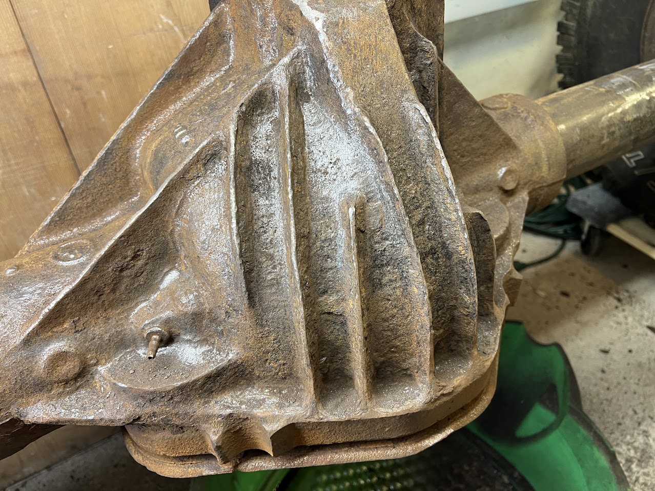

For the rear, I originally ordered what I thought (and what Jegs said!) was the last remaining Mopar Performance D60 in the country, but after having my ETA bumped back for 6 weeks, the order was finally cancelled as Jegs was told by their distributor that there weren't any options left. Not the end of the world, as 14B/10.5" AAM axles are easy enough to build, though I do wish an e-locker was an option.

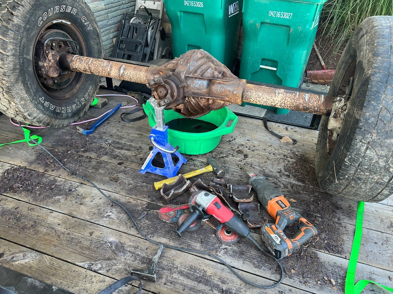

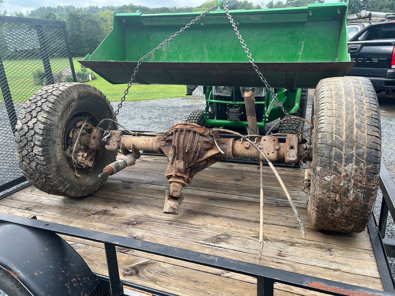

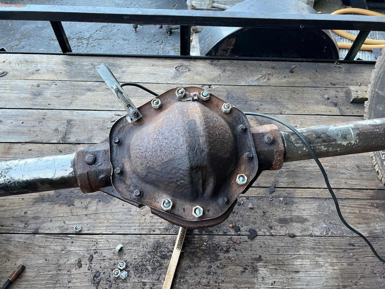

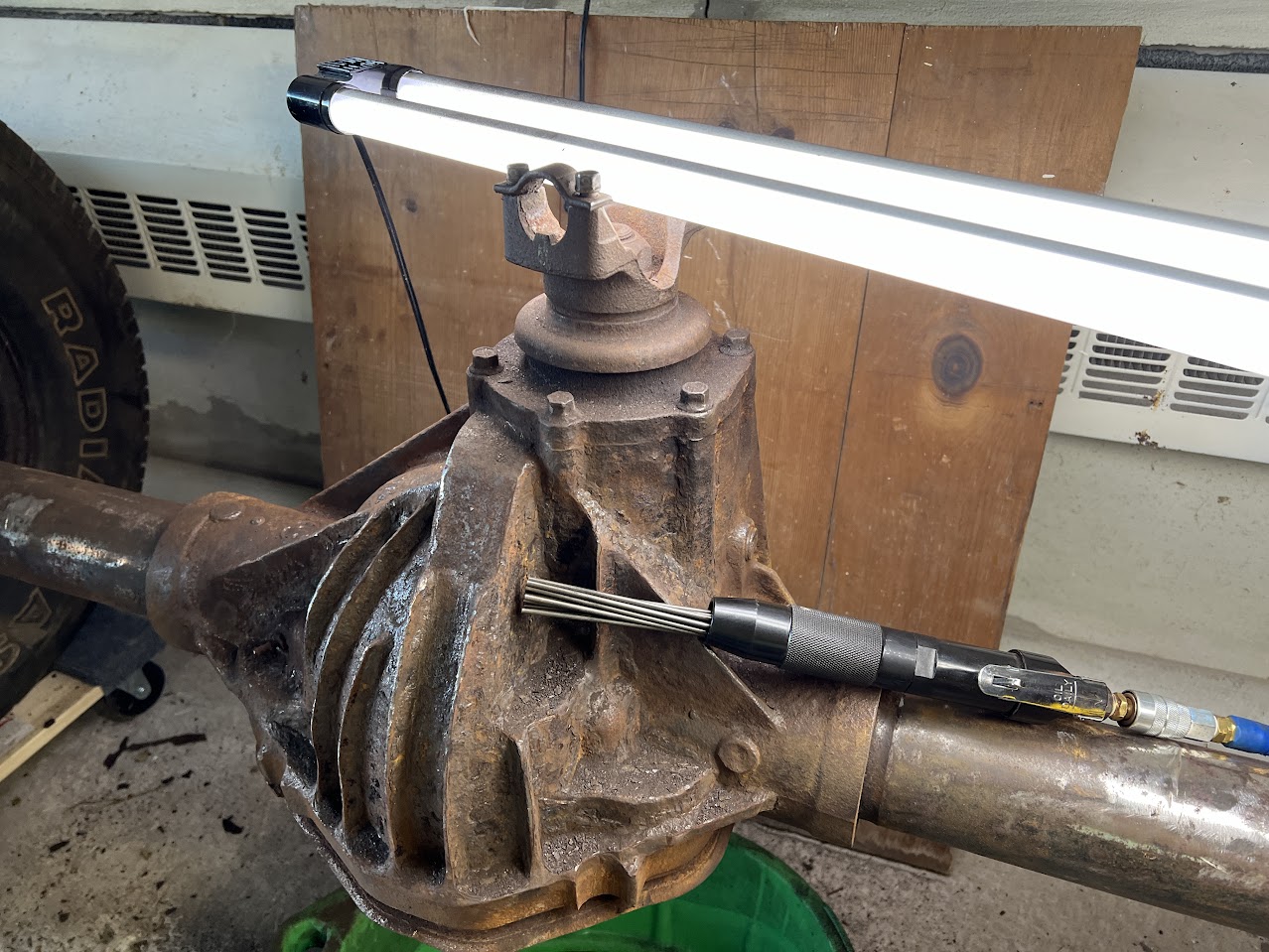

I sourced the least rusty 10.5AAM I could find and made the trip down to pick it up. The axles have gone up in $$ a bit (I used to find them for $80 on "half price Tuesdays" at the Pick-N-Pull places), but such is life. At $450, it was still a cheap option. One thing I miss about AZ was that nothing had scale on it at all. This has a bit that I'll need to deal with, but should still be manageable.
A few minutes with the grinder and carbide saw blade, and the brackets were off (which also knocked a bunch of scale off in the process!).
I ground down all the bracket welds and got more of the scale and rust off. I have a needle scaler coming this weekend to get the rest of the scale on the center chunk. I wasn't able to get the bolts out of the diff cover as the rust had rounded over the edges, and the ones I was able to get out have AMPLE amounts of Red Loctite on them for some reason. What type of psycho uses Red Loctite on the diff cover?!?!?! Anyway, a trip to the hardware store to pick up some 9/16" nuts gave me enough tries to get the stuck bolts off with the old "weld-on-a-nut" trick.

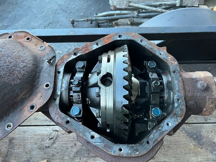

Gears look good (factory 4.10's) and what I think is a Gov-Loc. I'm going to brake clean the inside of the housing out, pull the shafts, and strip the hubs. From there I'll run a tap down each of the diff cover bolt holes and then finish cleaning up the housing and tubes to make it "weld ready" - which reminds me, I need to pick up some weld-thru primer...

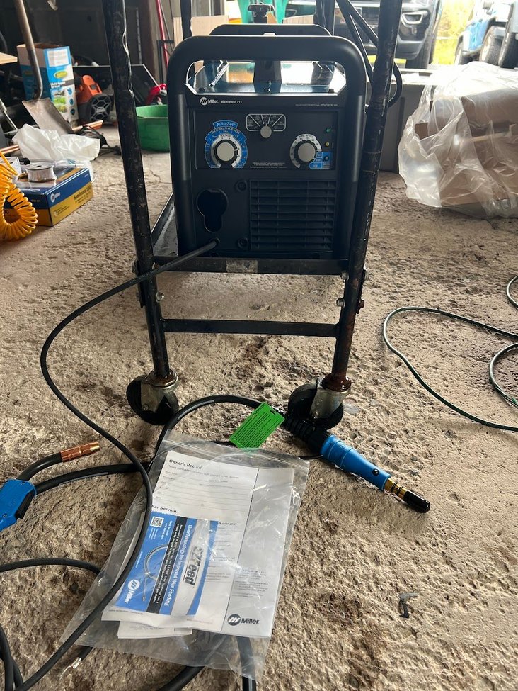

In preparation of the work, I also picked up a brand-new Miller 211. I was undecided on what to do for welder. I found a few okay deals on Marketplace, but nothing close by and the one that was, the guy sold the welder out from under me even though we had already made plans to meet up later in the day. Getting frustrated, I checked the local Airgas shop nearby and they had two brand-new 211's on the shelf, one of which was being offered with a discounted Spoolmate 100 spool gun. They have their "Build with Blue" rebate program going on, so the extra $500 savings put me over the edge to make the decision. I was considering a bigger option, particularly the Miller 252, but having used a 211 before to build axles and engine brackets, it's perfect for what I need and will allow me to tuck it away in the corner of the shop without getting in the way too much. It's also small enough for me to carry it in the basement for some future renovation projects as well.

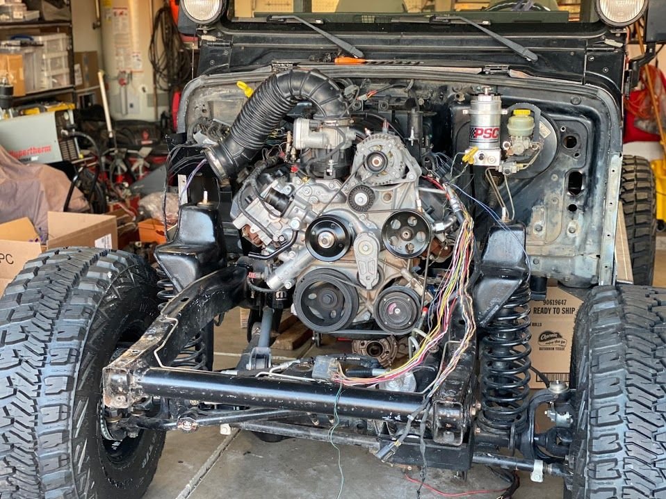

The plan is to find a decent 5.7L Truck Hemi with matching ZF trans to start. From there, if I want a little more, I would build up a core 5.7L or move up to a tuned 392. The reason I want to start with a 5.7 is that all the truck accessories tend to fit better in a JK application, plus I have a lot of experience with the 5.7 truck motors (it's what I used with my TJ-6 build, pictured below):

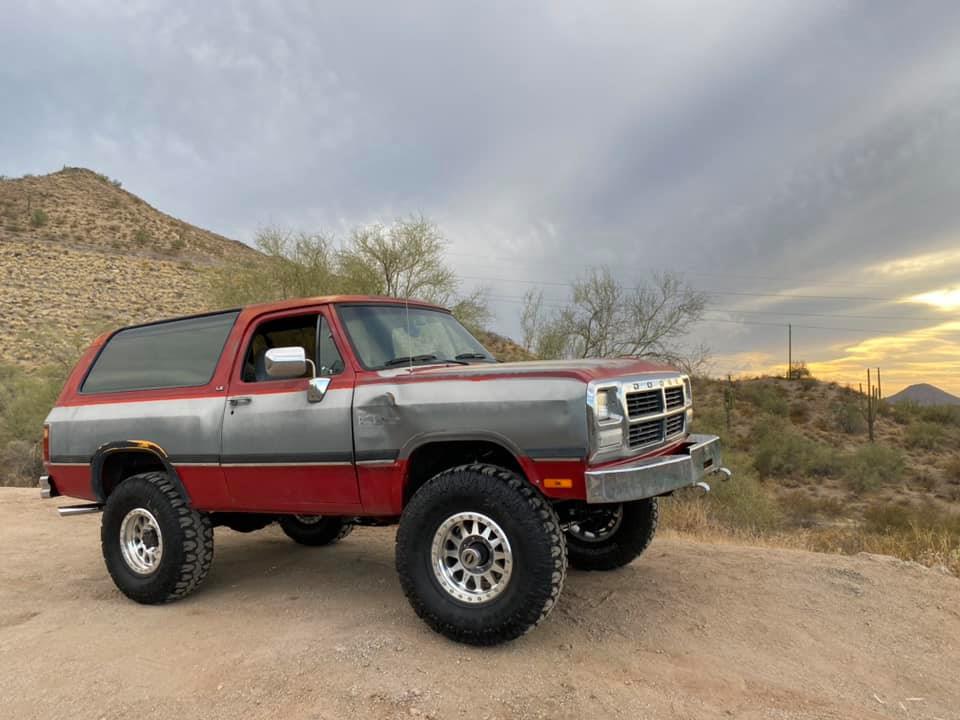

When I was building my TJ-6, I also built a 93' RamCharger as a rescue truck. It was on 37"s, tons, and a had a built 408 stroker motor (about 475hp/550 ft lbs). The TrueTrac in the back was a godsend on the road and had great road manners. I also ran a F8.8/D30 combo in my YJ for a while and it did well, up until you lift a tire...
  • Love
Reactions: tJKrider

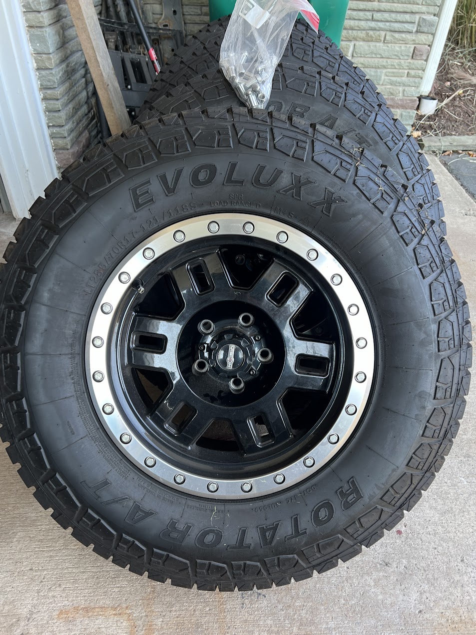

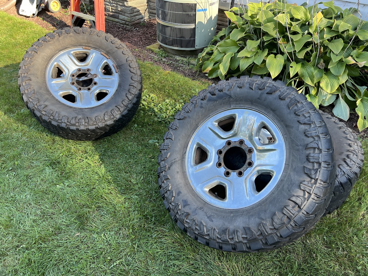

I picked up a cheap set of 18" 4th Gen Ram 2500 wheels with 35" tires on it. They're bald as can be, but hold air and will work for rollers in the garage. A quick hit with the power washer and they are actually nicer looking than I thought. I wouldn't be opposed to eventually picking up a set of 37" A/T tires for winter and running them on these wheels, assuming they clear everything nicely.

The housing on the other hand needed a bit more attention...
About an hour of work with the needle scaler and ball-peen hammer and it's mostly ready for some rust converting paint (the photo below was about halfway through the clean-up). I need to hit up a few more spots and get the flap disc out to get the fin edges nice and clean...

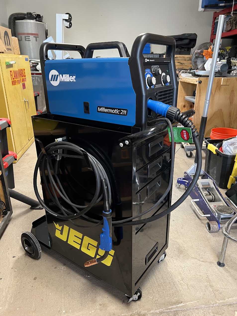

I ordered a new welding cart for the Miller 211 and that should arrive today. I also ordered a 14-50 NEMA to a 6-50 NEMA extension cord, so I can start laying some practice beads. Once I'm happy that it's working as it should, I'll come back to the axle and get the tubes welded to the center chunk. From what I've been told by those that have done it and do it often, the AAM centers take to MIG welding well, as long as you preheat it a bit and then let it cool a little slow (either with some help from the MAPP torch or a welding blanket). Everyone seems to also recommend doing the full circumference at one time, this way it heats and cools as one massive piece.

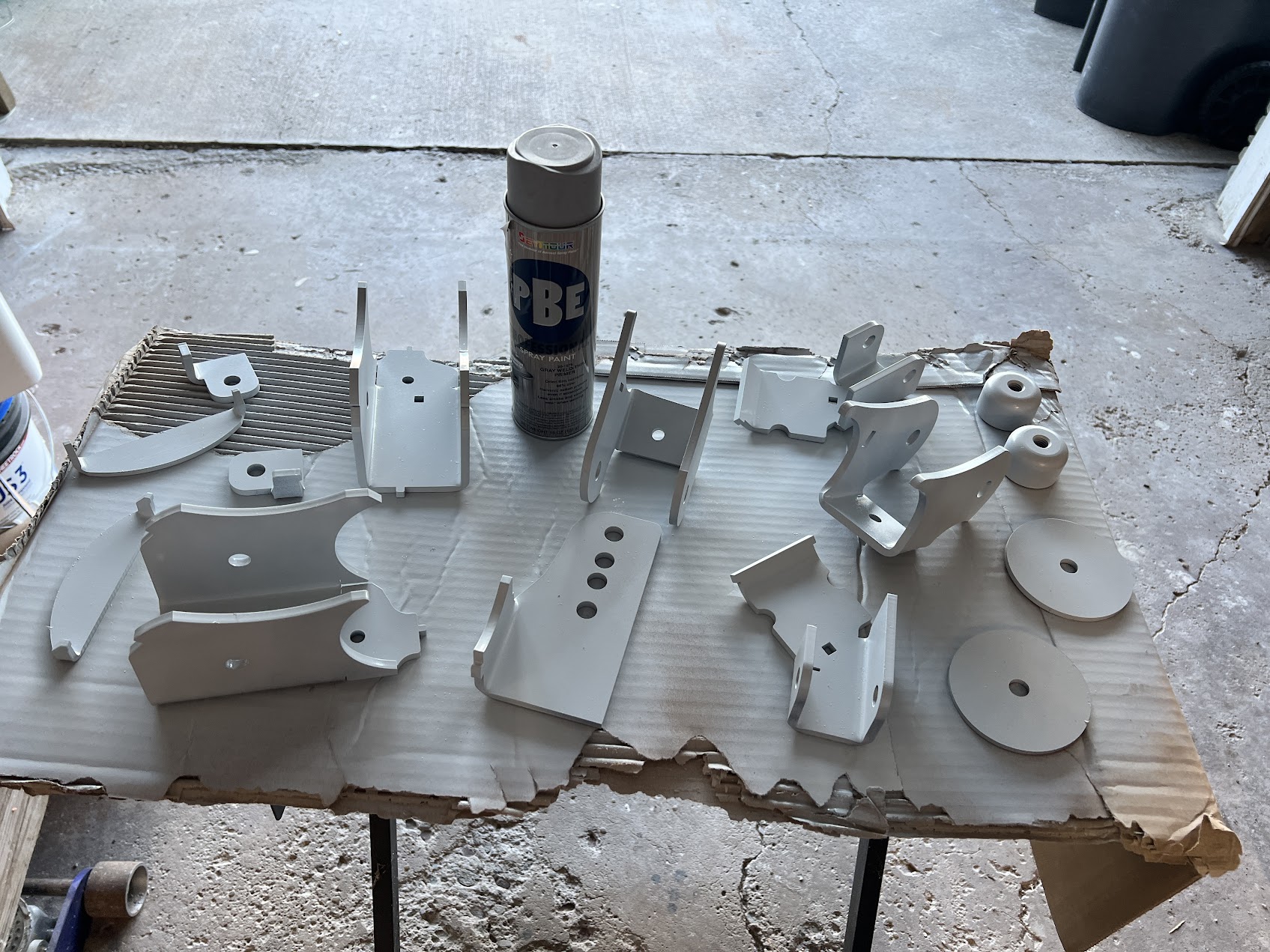

In this instance, I’ll use the rust converting primer on the center chunk, then SBE Galvanizing Zinc “Weld Thru” primer on the tubes. This will give some galvanic protection to the base metal around the weld area, but will still accept the VHT Chassis Epoxy when finished.
As I go through with suspension swaps, engine swap, and more, I’ll do a thorough degrease and coating with 3M Profession Gold Line Undercoating. Same as with the Eastwood, this has never given me an issue and I’ve been using this for 25+ years (since my time working at a body shop in the summers during high school).

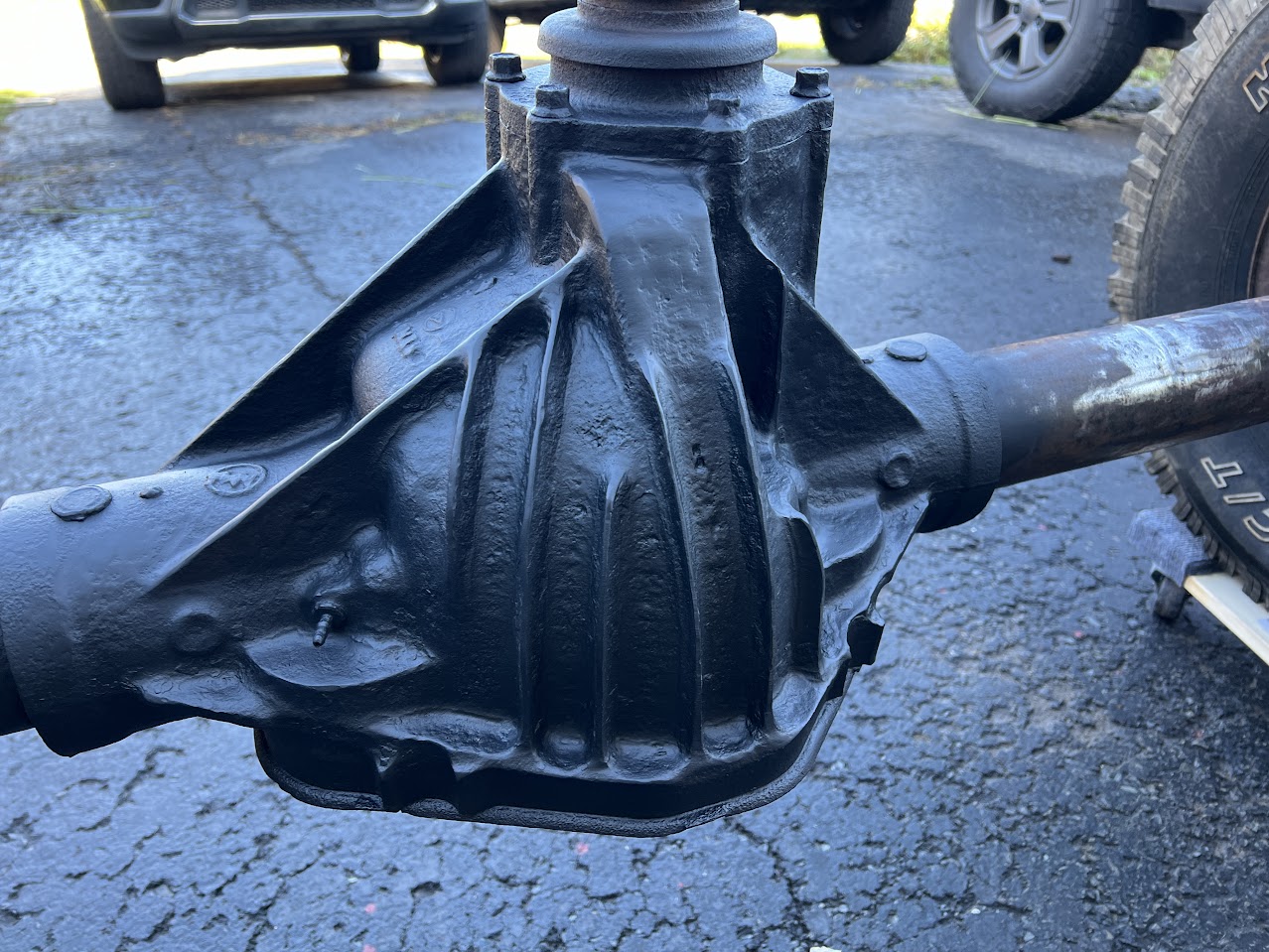

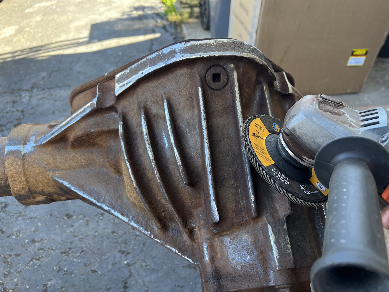

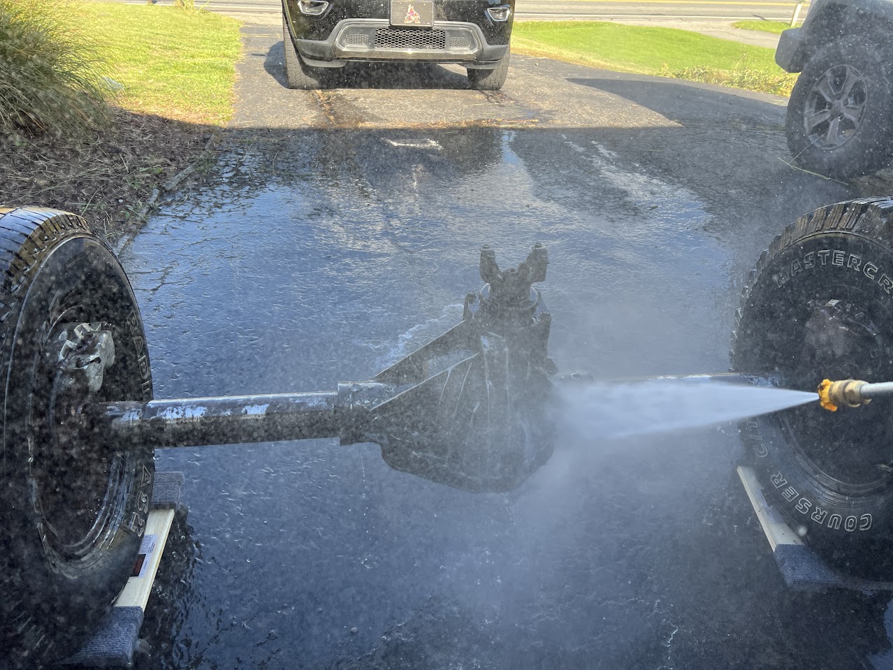

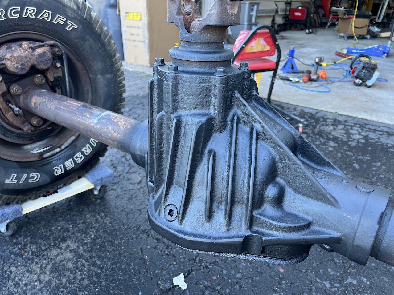

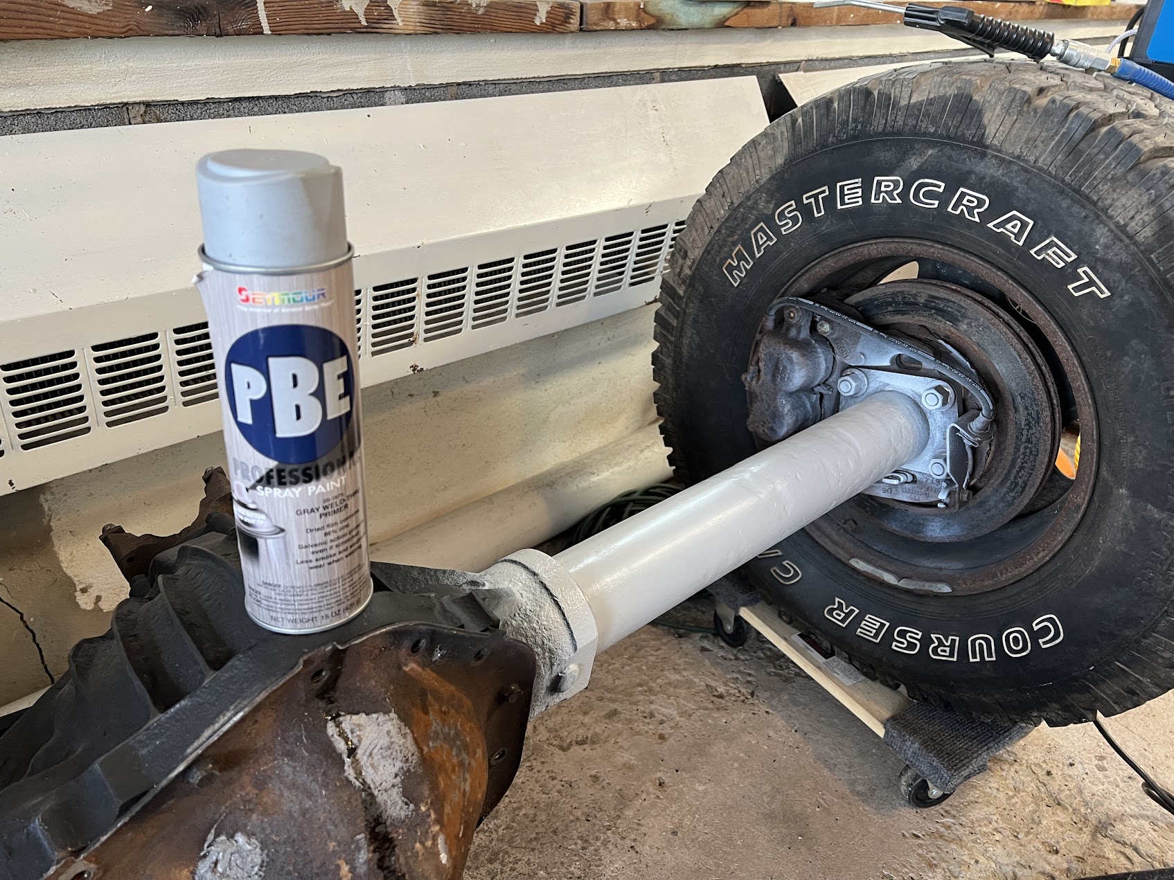

I spent a little more time cleaning up the AAM 10.5" housing, with both the needle scaler and chisel. I got down to where the housing was pitted and nothing was flaking off. It's not pretty, but it's still plenty solid. When the tubes and truss are all welded up, I may come back and fill in some pits (with JB Weld) to help keep salt and grime out of them - and rust from forming!).
After a quick first-pass degreasing, I went back to work with the flap disc, cleaning up some of the "ribs", smoothing out a few nicks and burrs, while also smoothing out the transitions in some areas. Once finished, I hit the rear again with some Super Clean degreaser and the power washer.
A quick hit with some compressed air and a little time in the sun got it dry enough to hit with some Rust-Oleum Rust Reformer:
Again, not pretty but fine for what I need:

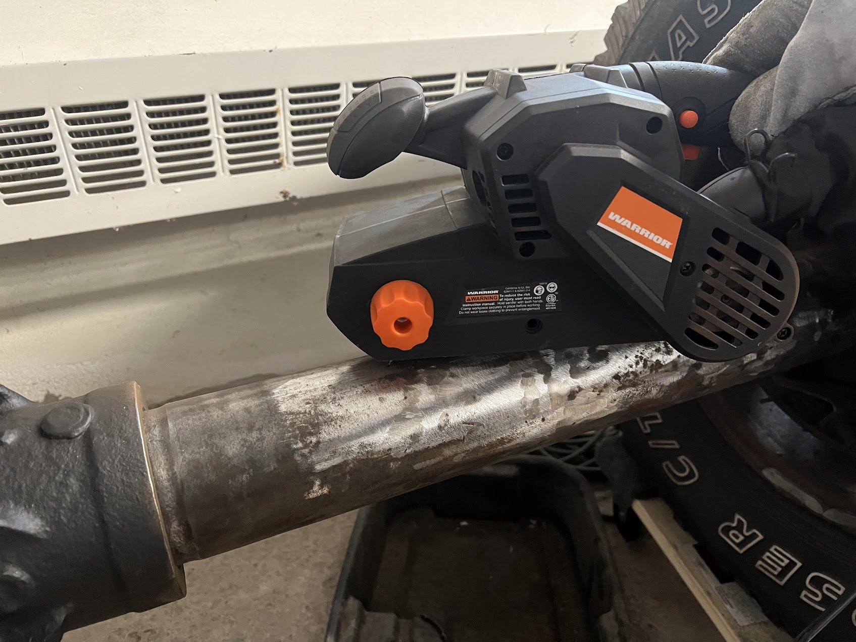

I still need to work on the tubes, so that is this week's project next steps. I'll get them sanded down a bit, then will fill in some of the gouges with the welder that I left by my unhandy work with the angle grinder (while I was getting the factory brackets cut off). It will be a good opportunity to get the feel of the Miller 211 in action on thick metal and see how she holds a puddle.
At that point, I'll come back and clean up the rest of the tubes, wire wheel the tube-to-center chunk area to bare metal, degrease again, and hit with galvanizing weld-thru primer. I need to build a support dolly for this axle so that I can easily rotate it around as I'm welding up the tubes. Once I get those done, I can start working on prepping for the Artec truss and bracketry (which just arrived yesterday).

Welding cart looks nice.
I think the axles are looking great, they don’t need to be perfect if you’re going to use them. You are going to use them…right?:)
Reactions: pc1p
It's quite functional too - the drawers are much better than a traditional welding cart with open shelves. The drawers allow me to stick gloves, spare parts and rolls, etc. in there without worry of getting covered in dust and grime.
And yes, no one installs tons to not use them (unless it's a SEMA build). If I wanted 37-38"s for show, I'd do what 95% of those running them would do - simply slap them on stock 3.73-geared D30/D44 combo and then complain about the lack of power :ROFLMAO:
I'll be curious to see what you think of this... I've been milking the same welder for the last 30 years or so! It was supposed to be a temporary solution but it hasn't failed me... yet... I'm waiting for the day something gives out that I can't replace.

Got the Artec truss/swap kit unboxed, lightly scuffed, and primed...
Also got the tubes cleaned up...
And primed... I also spent some time cleaning the joint between the tube and housing. We are going to take a trip up to Watkins Glen this weekend and swing by a college on the way home, so I won't have time to get the tubes welded this weekend, but at least it will be ready for me next week.

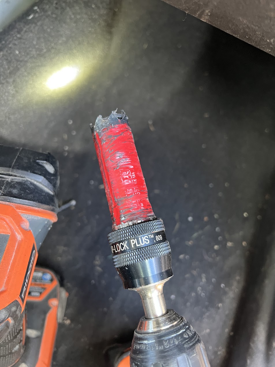

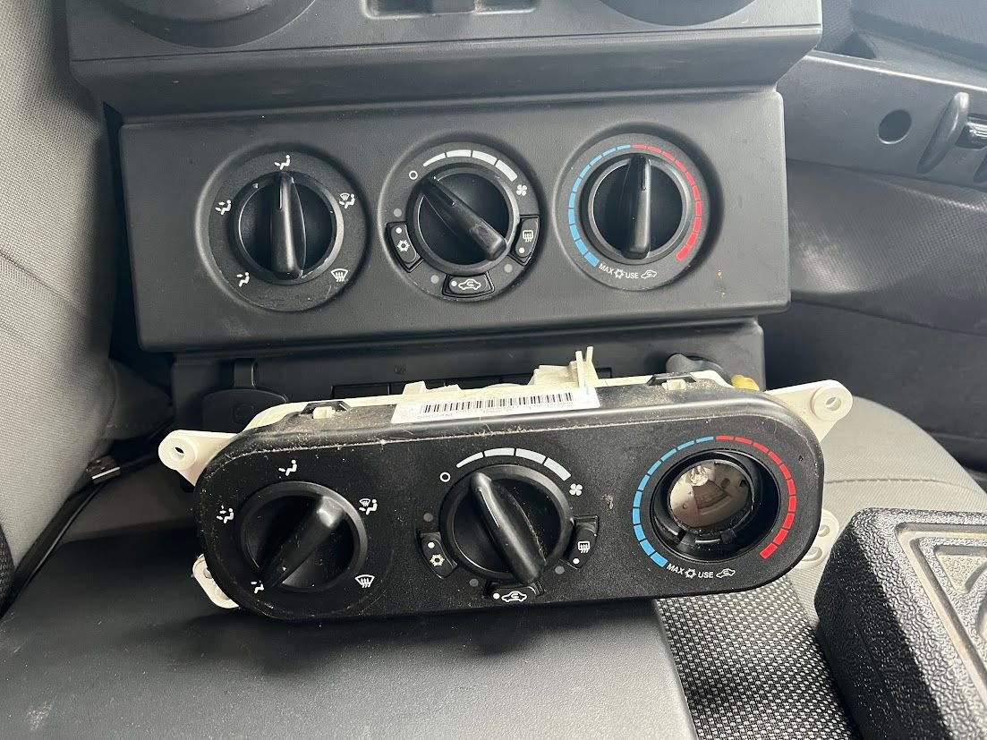

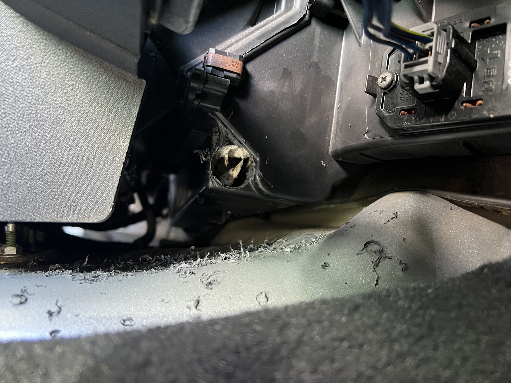

While the weather is nice, but getting cold fast, I decided it was also time to take a break from the axle work to get the heater box cleaned out. A few weeks back, I finally turned the heat on and the distinct smell of mouse pee/poop came out. I stuck my inspection camera down there and found just one area where they must have settled, right at the bottom next to the heater core:

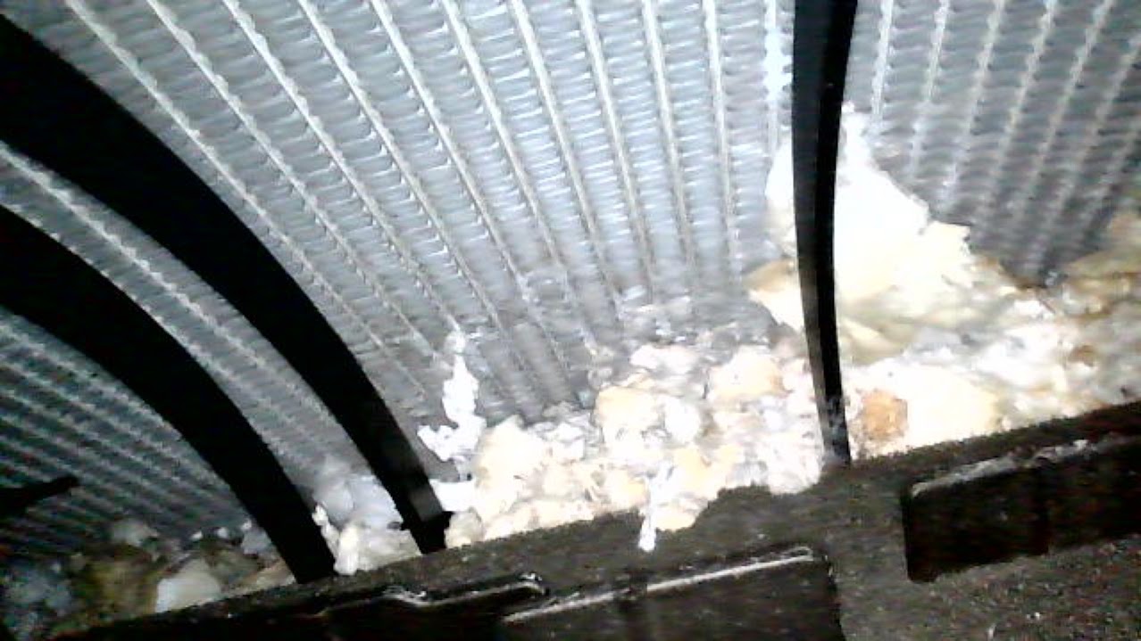

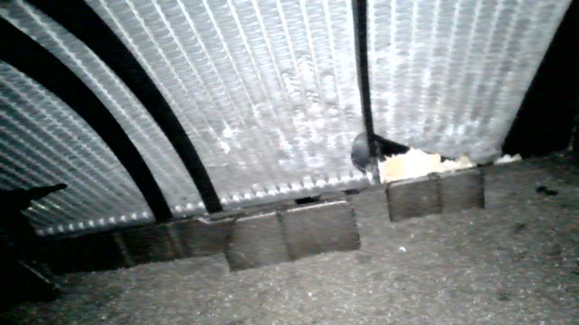

I watched a video of a guy on YouTube that had the same issue and used a drill to make an access hole in the side of the heater box that facilitates cleanout.
I used a carbine 1" hole saw and it worked great, albeit VERY close to the evap core (so be careful if you ever do this, or step down to 3/4" saw).
Using long tweezers, an old AR-15 chamber brush on a pistol cleaning rod, and a Shop-Vac with an old rubber garden hose (the black thing sticking up from the lower right corner in the image above) piece taped to the outside let me get everything out and cleaned. Now I need to spray some cleaned and deodorizer inside there and seal up the box before winter.

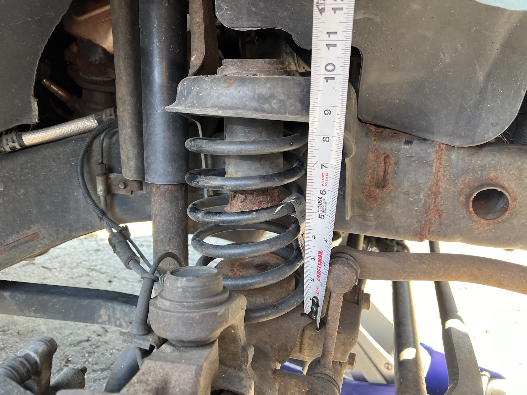

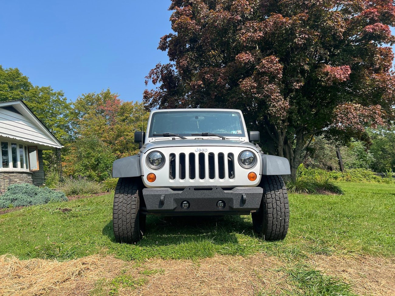

The front end constantly banging when going over bumps is getting old and also more prominent. The shock bushings are heavily compressed and nearly gone. The jounce bumpers in the front are also missing, I think because of the heavy spring sag - based on what I've seen online, this is about 1.25" of sag.
Rather than waste money on short-term shocks, I'm just planning on installing the 2.5" MetalCloak Dual Rate kit with Rocksports in the next few weeks. I was toying with the idea of getting some decently priced 33"s to throw on after the lift so it doesn't look like I skipped leg day, and I finally got lucky. I found a real nice set of wheels and barely used tires about 10 miles away.
I got all 5 for $1000 - the tires have less than 1000 miles, there are even some "nubs" on the tread blocks. The guy even threw in some brand new polished splined lug nuts and the TPMS sensors are brand new. I can sell the Recon wheels and tires I bought for $700 or so, so for $300, these will work well until spring time rolls around. And if I get lucky and my daughter isn't able to take her Jeep to school next year, I'll throw them on her Islander!
They look good, albeit a little "stuffed" inside the wheel wells, but they ride nice and quiet, even compared to the Coopers I have been running.
