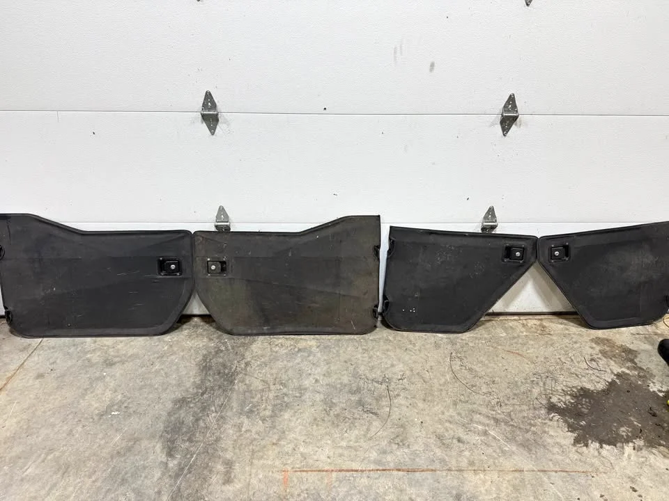

eBay is probably going to be your best bet for this. I ended up with Bestop core doors because of sticker shock with the OEMs.
finally getting the full doors off has finally inspired me to start looking for some OEM half-doors as well for summer driving...
I haven't thought about eBay, I just assumed shipping would be remarkably insane (even more than what people are getting for these half doors!).
I have seen a handful in my area go up for sale... with the rust eating Jeeps out fairly aggressively for those that don't maintain undercoat and clean during the winter, you see a few sets pop up from time to time. I am not so worried about getting ones to match the paint. Now that I have the sandblasting and powder coating place I like and can trust, I am sure I can find something he can use (even if just a semi-gloss black) to make me happy...
A quick look at listings shows about $4000 for two doors and two tops. Shipping varies to included in price or about $100 per door. I'm assuming these all come unassembled as well.
By the way, I was mistaken; I have the Element doors and shells, not the Core. https://www.motortrend.com/how-to/1707-bestop-jk-element-door-review
I see a handful of sets in the $3500-4000 range (this is for 4 doors, not 2) but very few sell. The ones that I have followed and that have eventually been marked as sold or deleted are in the ~$2200-2500 range. For 4 clean doors with keys and latches that work, I'd be willing to spend that much, especially with tops. Anything more than that, and I'll just use the Quadratec "bar doors" that I got with the Islander. Speaking of doors, I should probably look at getting some of those wall-mounts for them...

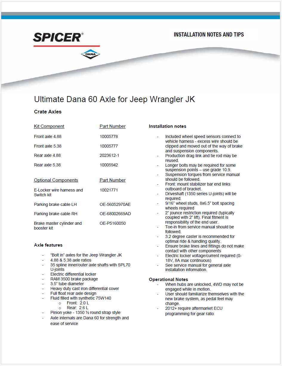

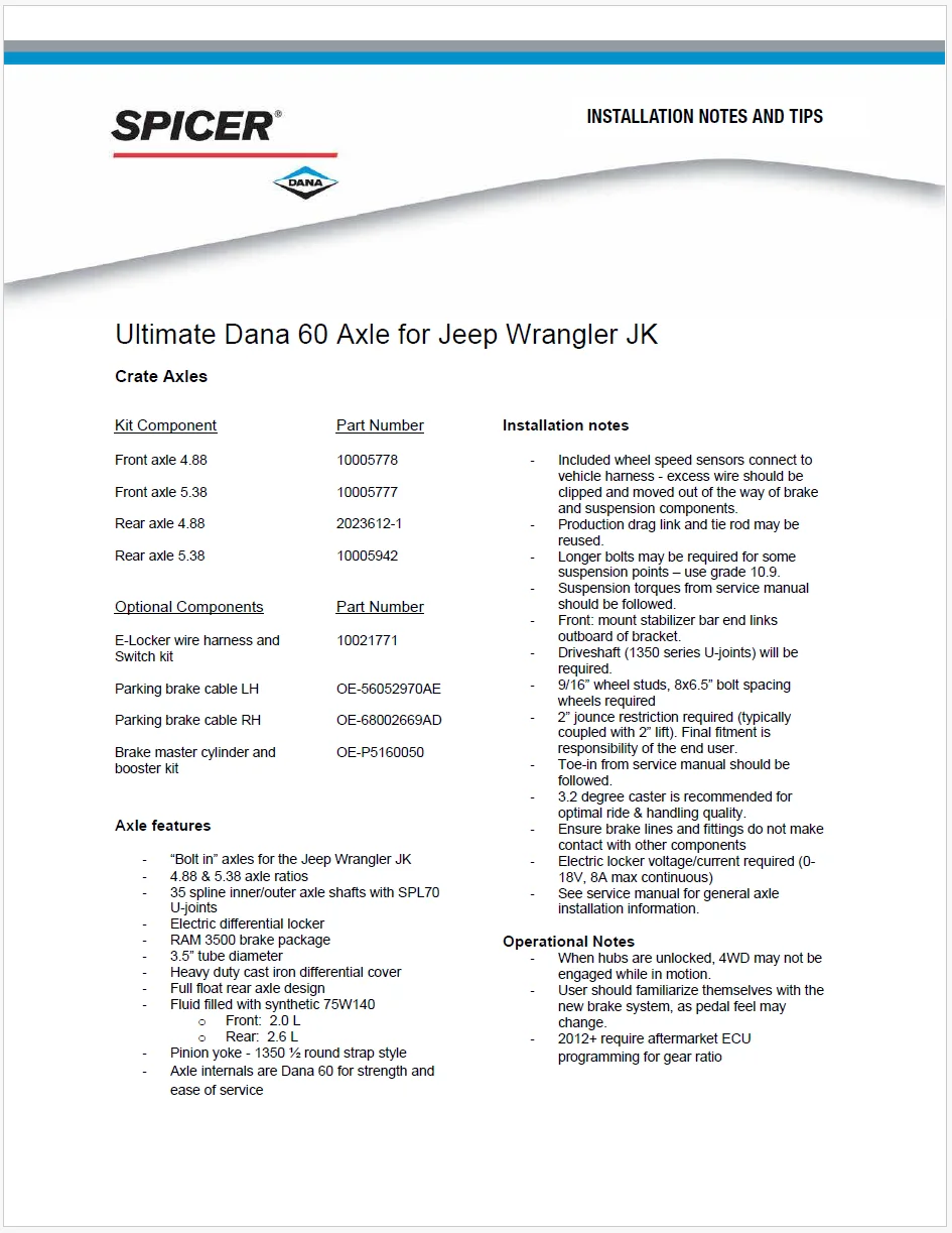

Before I built the 14B, I originally ordered both the UD60 front and rear axles together. While the UD front showed up in just a few days, the rear axle was "backordered" for week and weeks before eventually getting cancelled. However, in the time that it was still on backorder, Jegs very confidently told me numerous times that it was "on its way!", so I went ahead and ordered the Mopar-designed e-brake cables to go with said UD60 rear axle:
Unfortunately, Jegs eventually cancelled the order and I started working on the 14B instead. Some time ago, I noticed that the brake cable ends weren't going to work and I did some work to see if I could modify them to accept the Jeep/Mopar style "hook" end, instead of the GM loop end. After some Facebook back and forth with others, I ended up making a video about it:

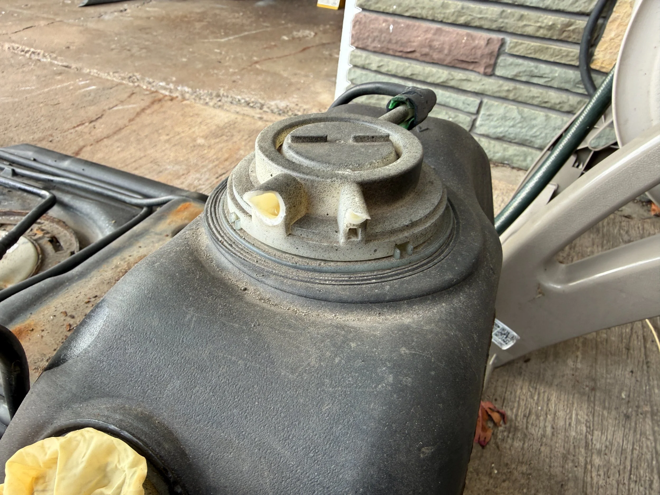

Speaking of decisions, one was made for me. As I was attempting to drop my gas tank (I was tired of the rust from the bottom of the skid plate constantly falling into my eyes when I was down there), I ended up snapping off not one, but two of the vent fittings on the tank. What gets me was just how absolutely careful I was being while I was dropping this - knowing just how fragile these are - and still broke two of them 😵‍💫
I was a little on the fence about my justification for going with something like the GenRight or Motobilt Rear Gas Tank Conversion to support future rear suspension modifications, but this sealed the deal for me. Looks like I'll need to message my buddy Steve at Offroad Elements soon and get the tank shipped out (I'm not sure if there's a lead time or not).
At least now with the gas tank out of the way, I'll be able to run the wiring down the side much easier for the rock lights. One I get the engine bolted in place, I'll be able to get the battery tray installed and can start working on the rest of the auxiliary wiring.

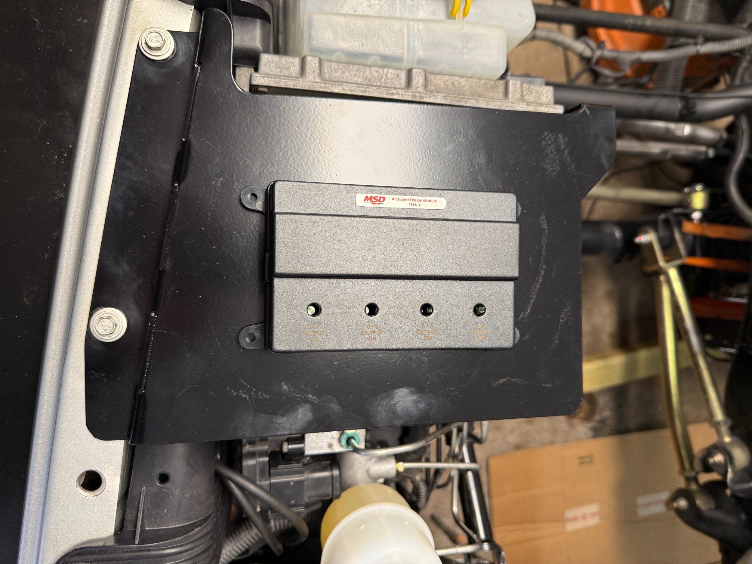

I really like how low and sleek the MSD relay box is

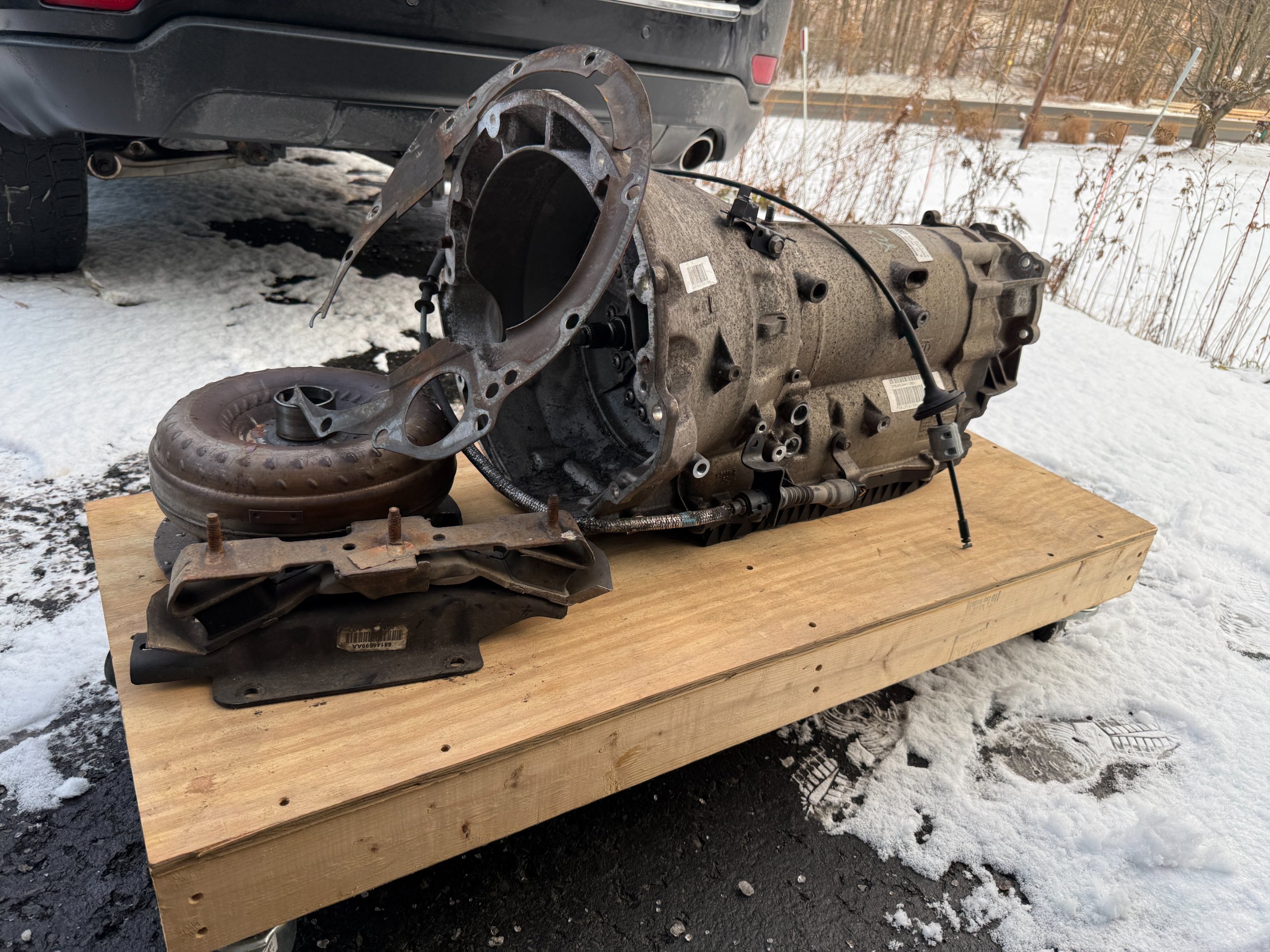

Oh, and I found a spare 8HP70 that came with a lot of parts necessary for an 8HP + Hemi swap... you know, just in case I get an itch to make the Islander more fun :)

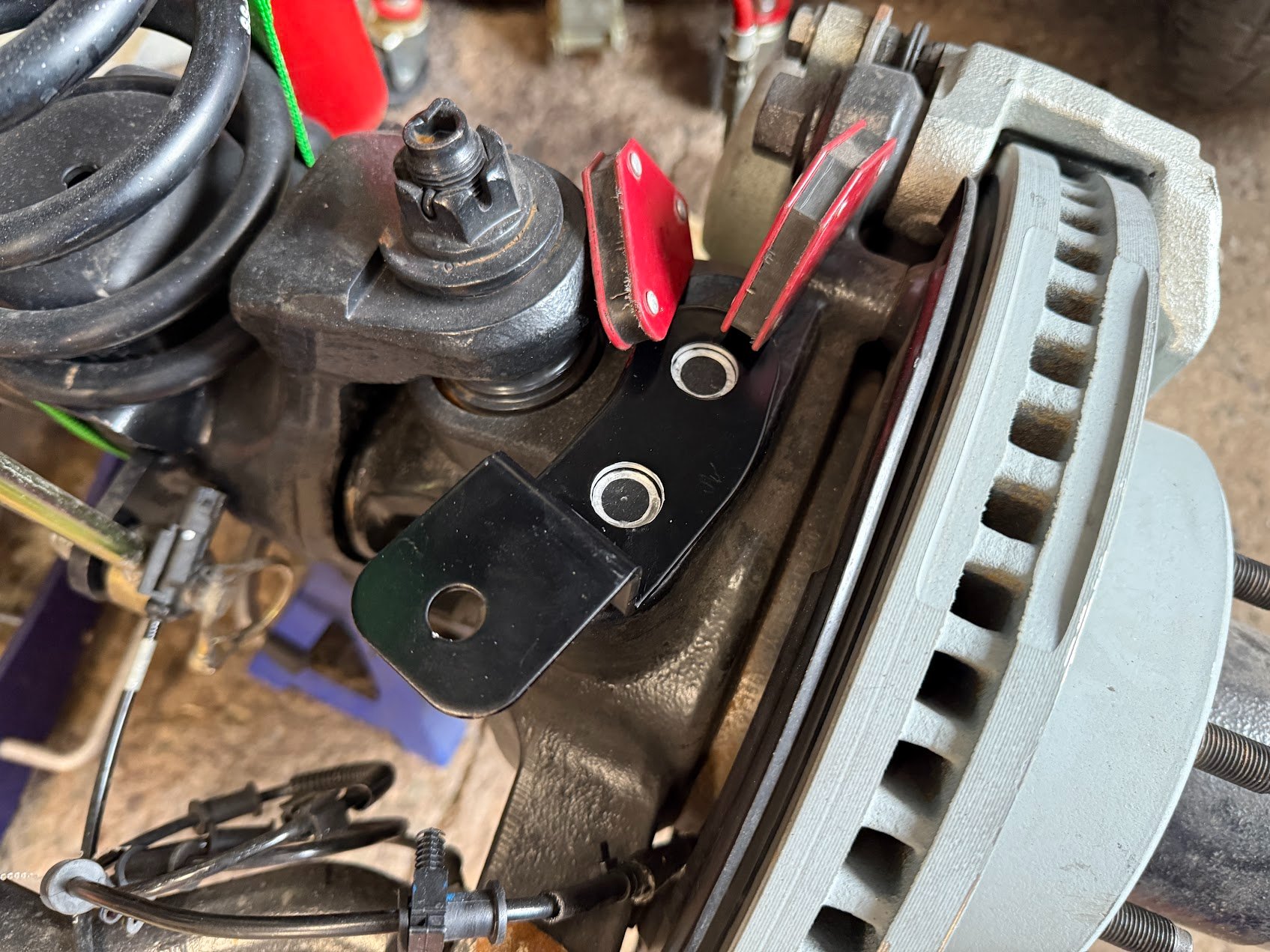

Gatekeeper Offroad UD60 Knuckle Pod Bracket Install
I'm waiting on some other parts to arrive for the engine swap, so I'm getting done what I can. I ordered these Gatekeeper Offroad Steering Arm brackets a few weeks ago. I was on the fence about them for a little bit, as they seemed a little "gimmicky". However, everyone that I talked to that has them absolutely loves them. When I saw a set on a plow truck not too long ago, the light output seems to be in the perfect spot for hunting/nighttime trails. I decided to take advantage of their holiday sale and got a set.
Their shipping was quick and the brackets were nicely packaged. I had some free time yesterday and I got to work on getting them installed. The passenger side is easy for the UD60 application; you simply unbolt the steering arm nuts, put the bracket down, and then tighten the nuts back up. Gatekeeper doesn't provide a torque spec, and there's nothing in the UD60 literature that gives a torque spec, but based on some other aftermarket steering arms using identical bolts, I went with 90 ft lbs.
The driver side takes a little more work. You can either tap the knuckle and install bolts, or simply weld them straight to the knuckle. For future ease of maintenance, I went with the drill and tap approach...
Tapping cast steel for 1/2-13 bolts is bit of a pain, but it went smooth enough. Once I get the engine fully in place, I'll get the wires run for these...

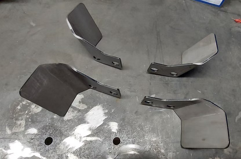

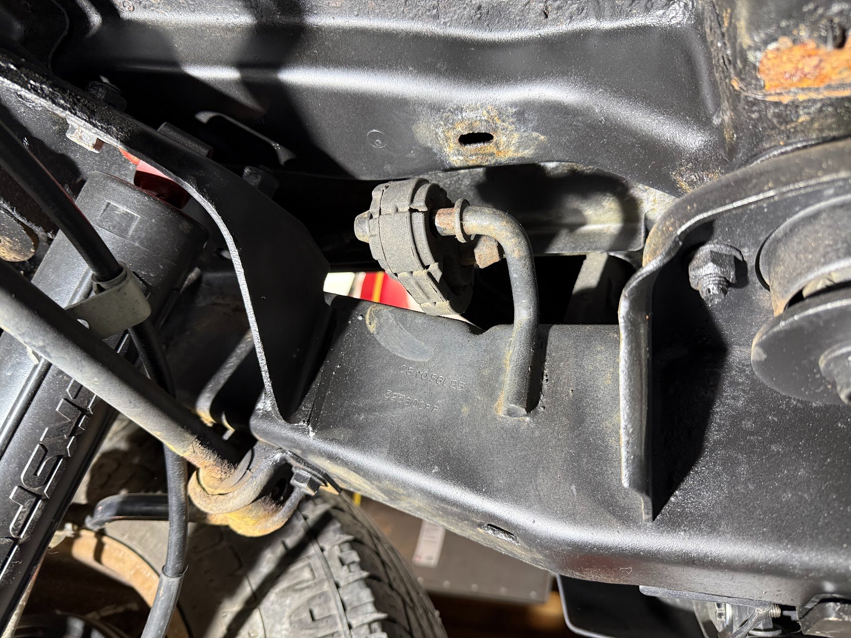

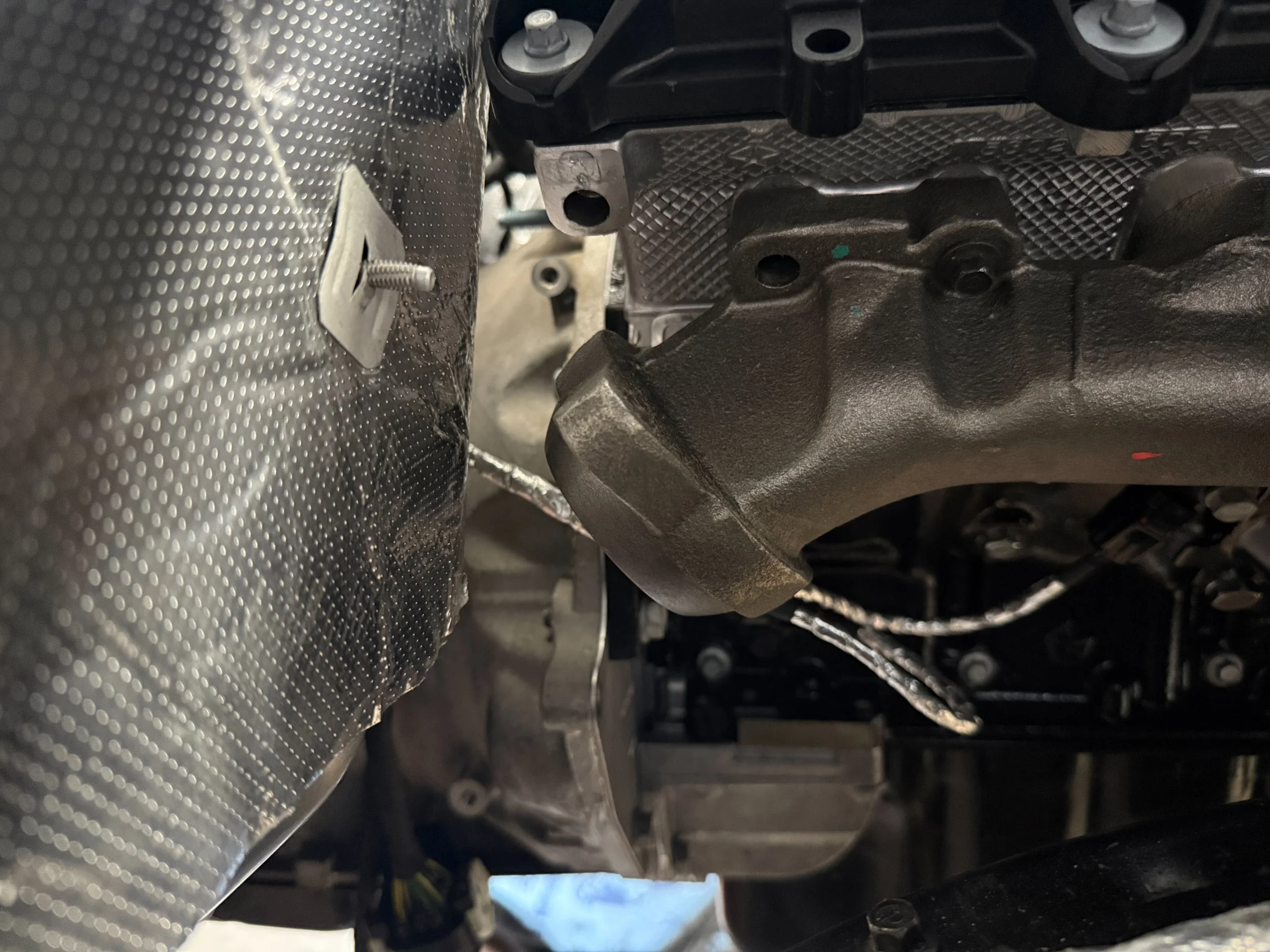

I'm still waiting on some parts before I can drop the engine and trans in place, so I'm working on what I can. In preparation for the Motobilt Rear Gas Tank, I went through the installation instructions from their website. I haven't ordered the tank yet, simply because I don't want to be tripping over it. However, once I get the engine and trans dropped in, I'll be able to clean up a significant portion of the back of the garage and will be able to order (and store) it then.
Anyway, the instructions state to cut off both exhaust hangers in the rear (for the OEM muffler). The process was easy and only took ~10 minutes for both sides. The original plan was to use a cut-off wheel, but due to the angle and location, I ended up using a Diablo metal cut off blade on my reciprocating saw.
Ta da! A quick hit with a flap disc got it smooth, then I hit it with a short shot of primer and paint.
I did the same with a broken exhaust hanger bracket on the frame near the T-case. I'm not sure if the JSS Headers + Exhaust kit will use that hanger, but it was literally just a stub, so it wasn't doing much at the moment anyways. After I was done working on cutting the stub mount off (which also was easier with a metal cut off blade instead of a cut-off disc), I started marking where I need to clean up the frame so I can weld the OHF Frame Reinforcement Brackets on:
There's BARELY any thread engagement with the OEM bolts, so I need to get some longer ones before tightening them down (so I can weld them in place). My mounts are fine, but a lot of folks have issues with the brackets cracking, especially with a V8 and skid plate whacks, so I'm proactively tackling these before they become a problem.

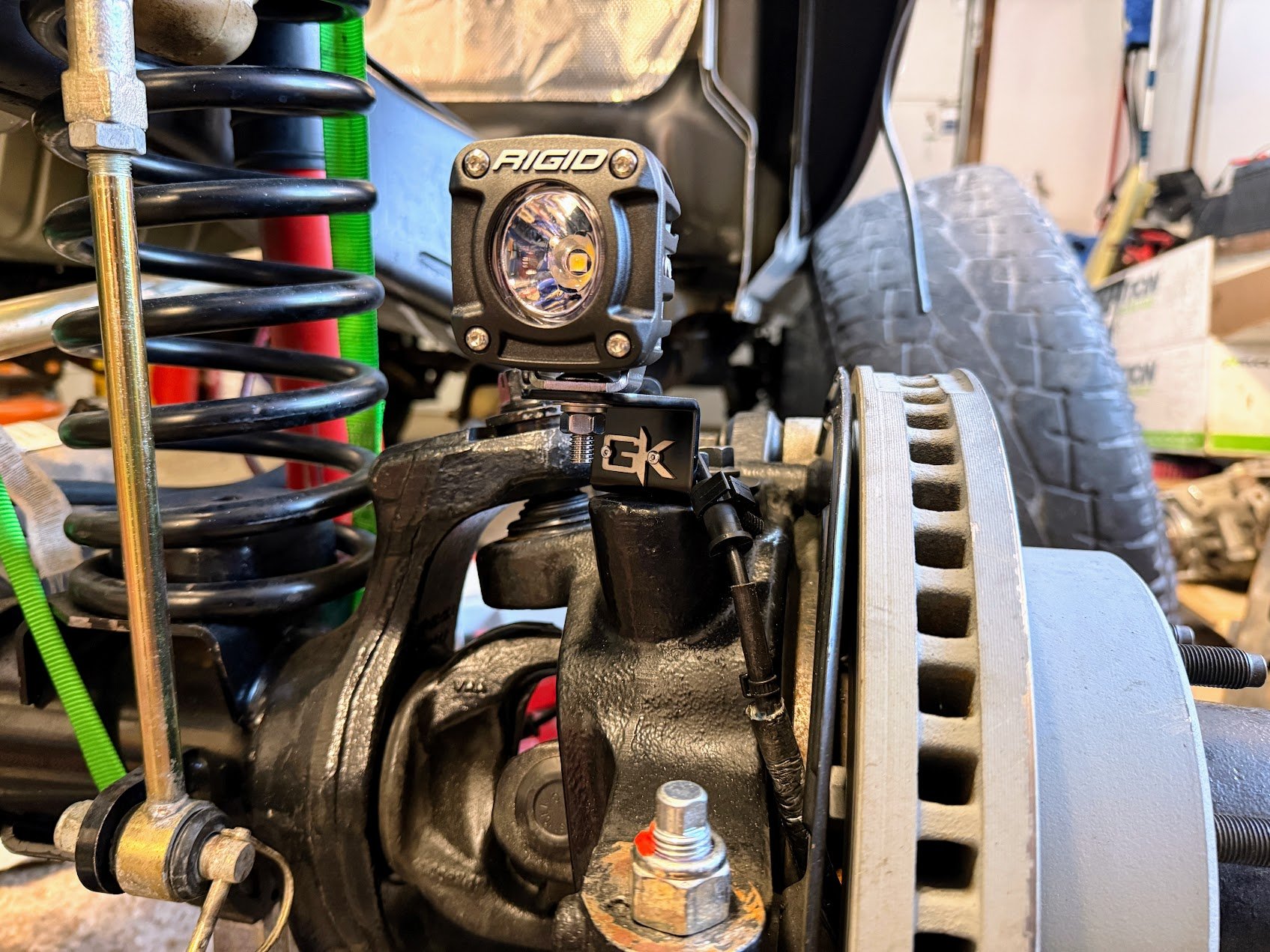

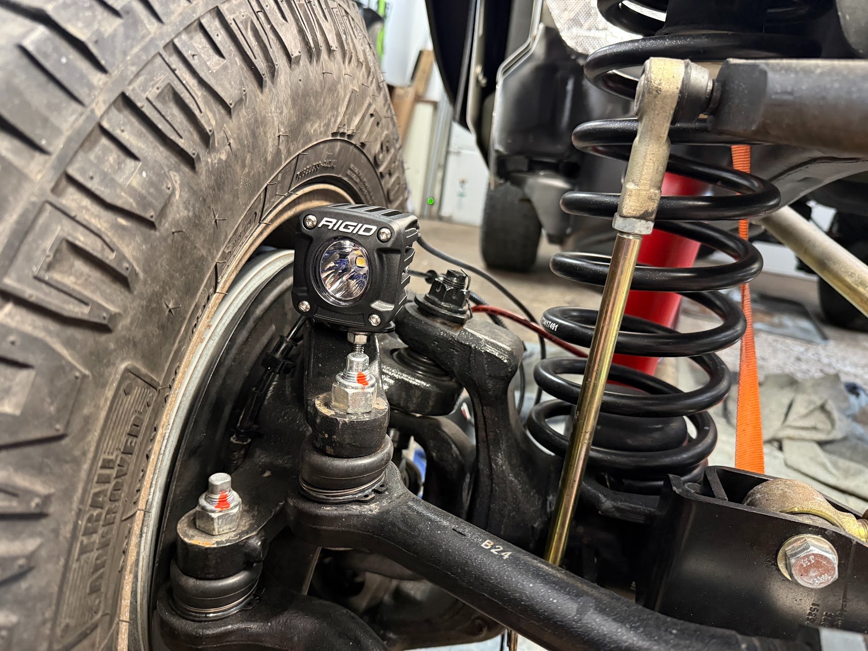

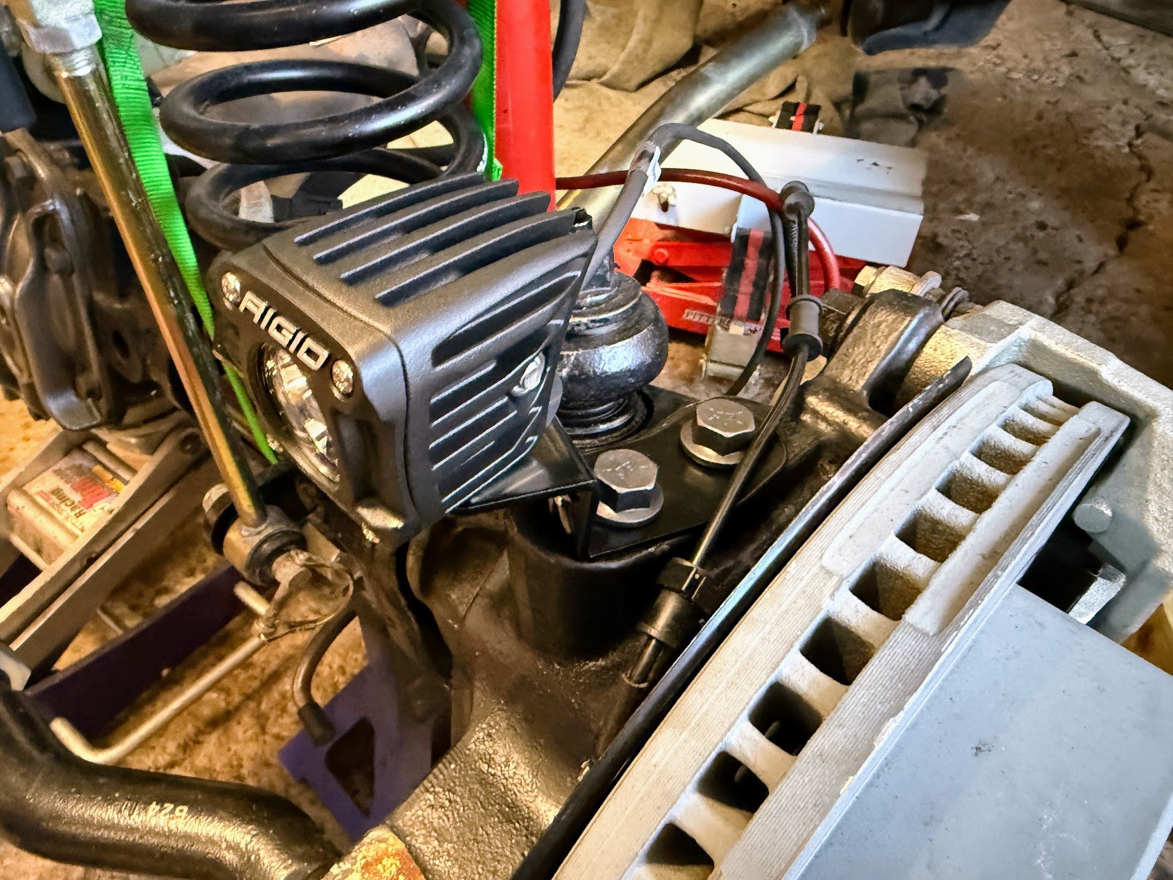

Turning back to the front end, I got the Rigid Pod Lights (on the knuckles), front ABS sensor wires, E-locker wiring, front axle vent tube, and brake lines secured and bundled together. I just ordered some USA-made PVC covered 14 AWG/2-conductor wire and will get the wires run to the relay box shortly. My plan is to use a few DT 2-pin connectors so they can be quickly disconnected for service and deep cleaning...

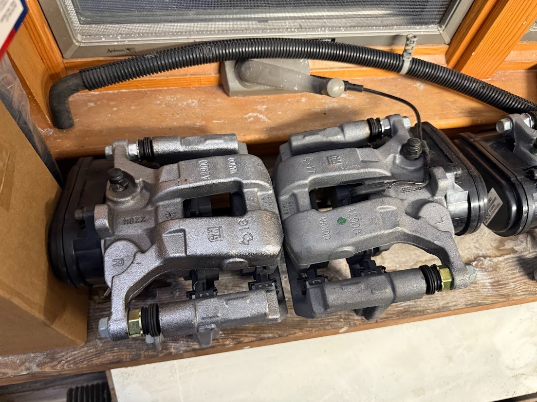

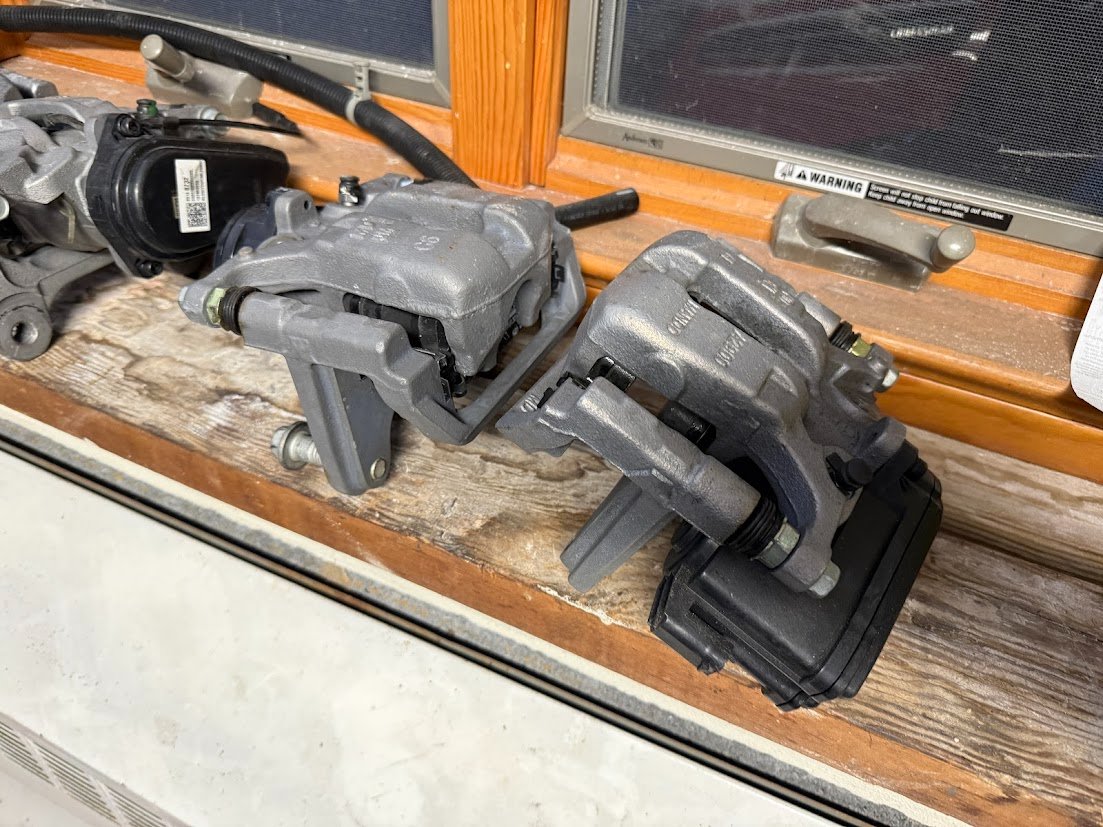

As I was coming back from Philly a few weeks ago, I forgot that I picked up two sets of GM rear calipers with Electronic Parking Brakes. I have been talking with the guys at Range Industries about their 14B EPB Kit. Turns out, they're reworking the design a little, specifically to work on JKU 14B swaps. I'll give them some time to work up a new design and have offered to help beta-Test it for them.
GM has two very similar EPB calipers, one used on SUV's and one used on the 1500-series pickup trucks. They're essentially identical, the only difference being where the brake hose attaches. I got a set of each from a guy that runs a shop in Philly, where many of his clients install Brembo kits. Both of these sets are like new with less than 100 miles on both!

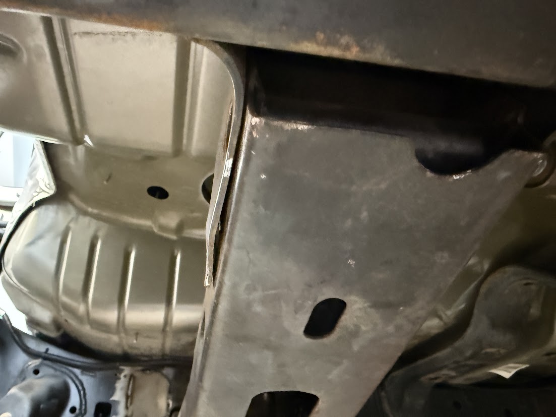

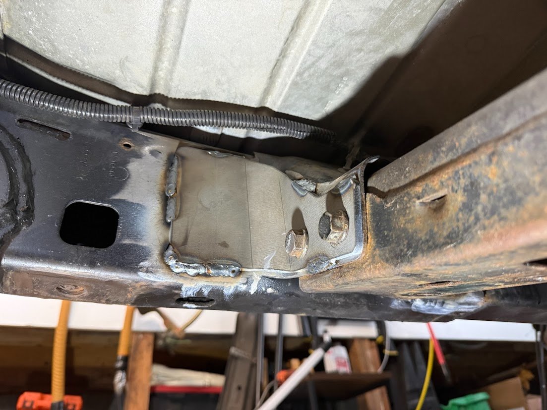

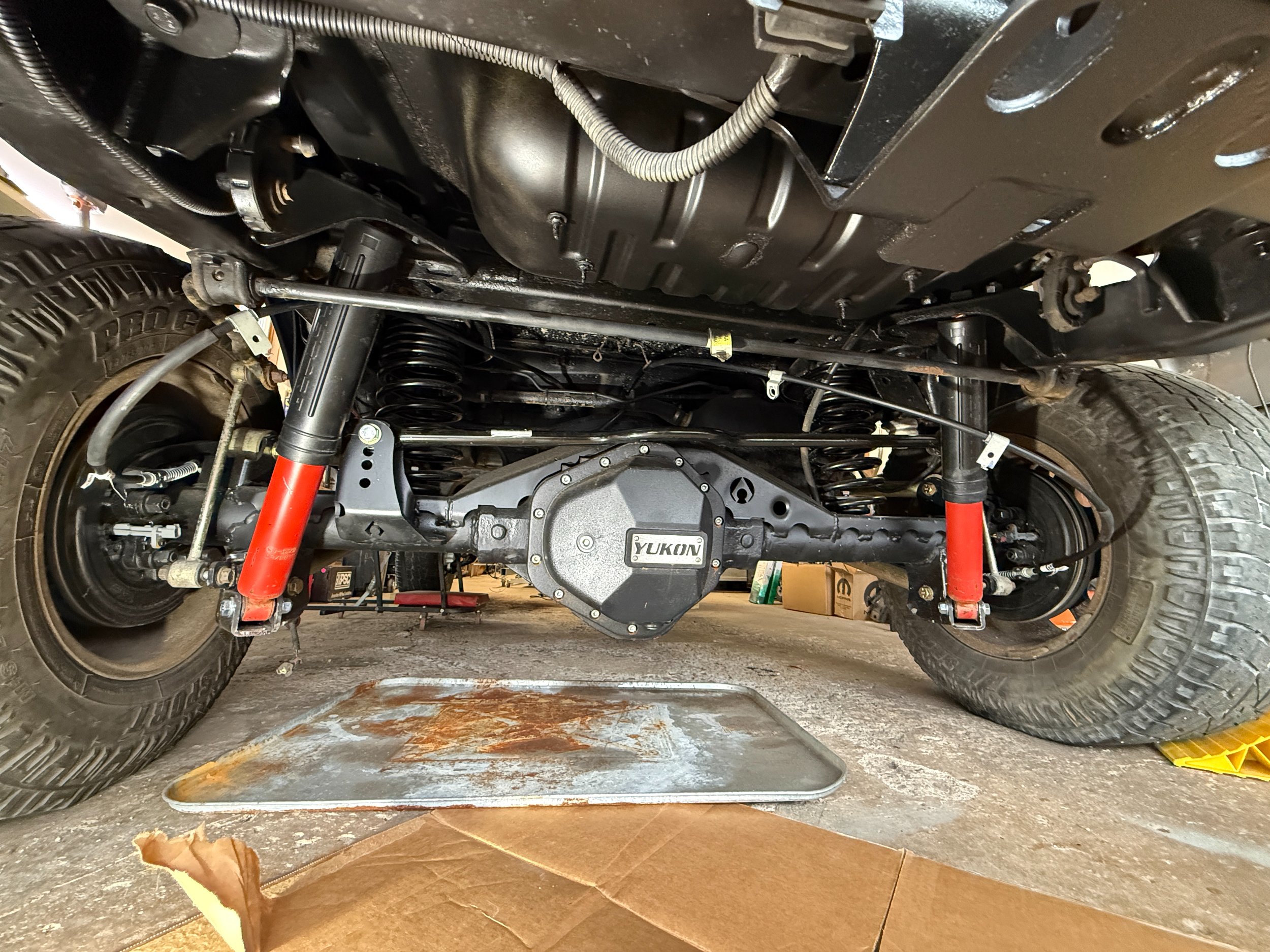

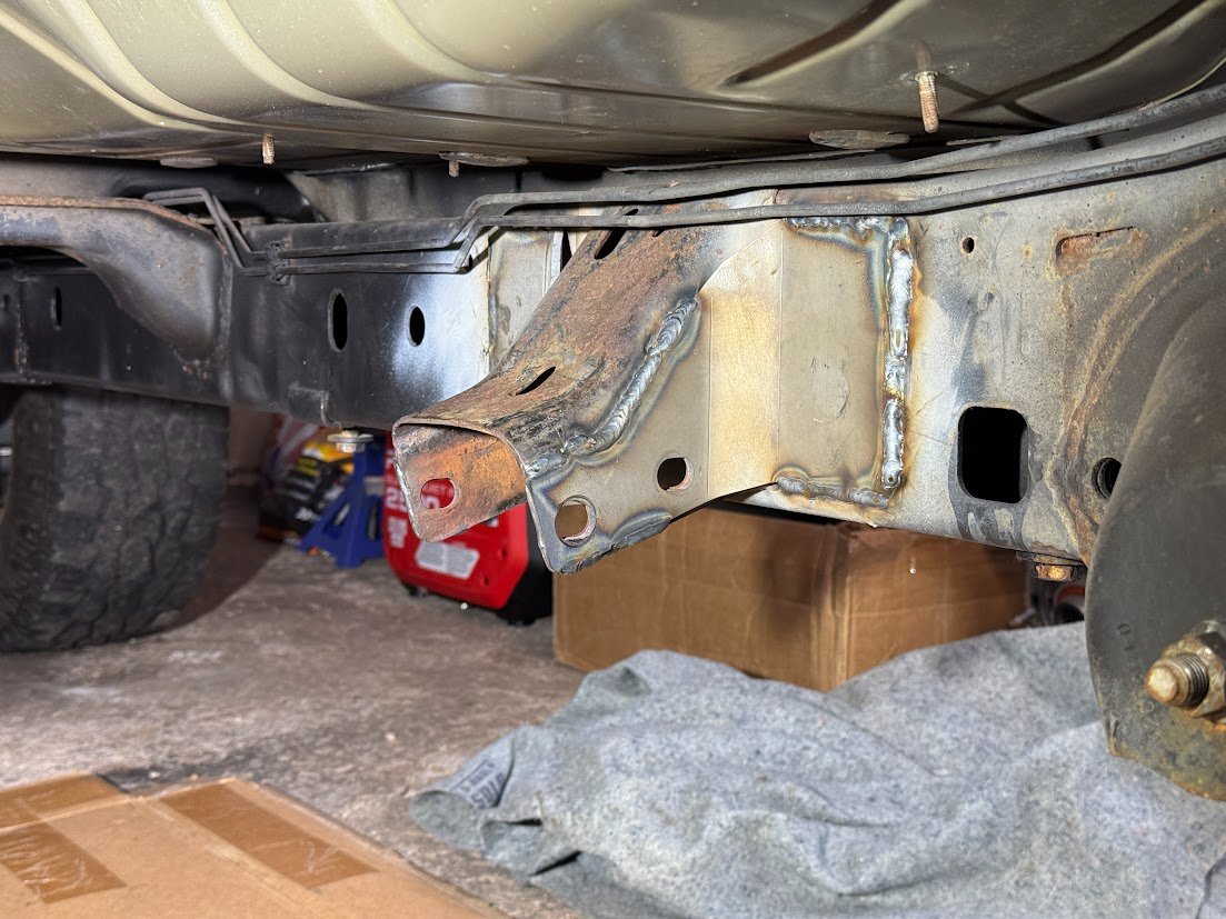

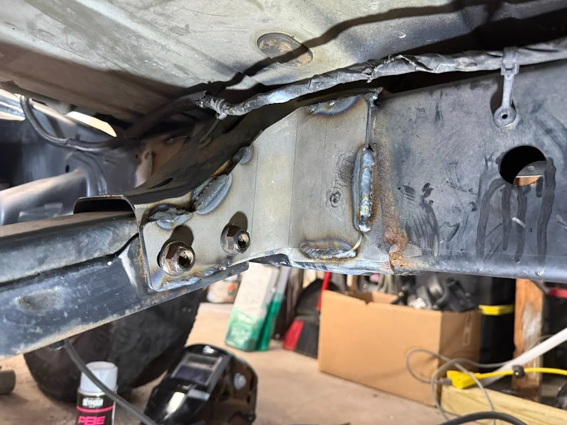

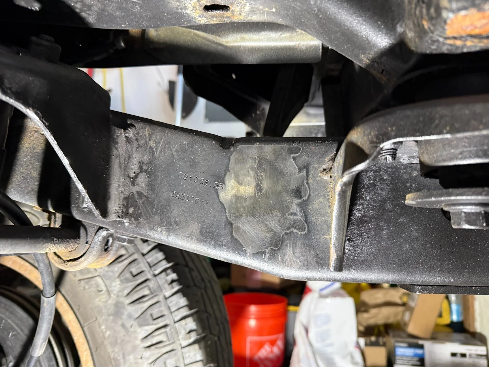

Despite the single digit temperatures outside, my garage is a balmy 56 degrees. I cleaned up the OHF crossmember reinforcement brackets and gave them two thin coats of Seymour Paint Thru Primer, before fitting them up. Like I said in an earlier post, my crossmember mounts aren't cracked but even on a stock rig that doesn't appear to ever had any serious wheeling done, the OEM brackets have a slight bend in them:
I took my time and straightened them out as much as I could, then installed the OHF reinforcing brackets to give as much leeway as possible to get the bolts centered. Overall the process was easy, especially with the engine and trans out of the way, but it's still not an easy spot to weld while you're hunched over underneath the tub.
Knowing how thin the frame on the JKU actually is (~1/8"), I took my time and did some stitch welds around the perimeter of the brackets. In some spots, even with the bracket completely flush against the rail, there was still some raised edges, due to the factory welds and joints. I smoothed all the high spots out, but the low spots required a couple of passes to get enough build up of material in the joint to get a proper weld to the bracket. I could have beveled the edge of the brackets a little more than I did, but I was still able to get it done just fine, despite doing "Welding Yoga" underneath.
Everything welded up and cooling down! When I'm back in town later this week, I'll hit the high spots with a flap disc and hit everything with some Eastwood Chassis Satin Black. Overall, I thought these were going to be more of a pain in the a$$ than they were, but I only had about 2 hours into the install. I'm sure if the trans was still installed, or if the insulation was still there that it would be slightly more of a pain, but even still, these aren't too hard.

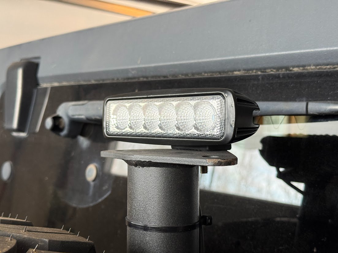

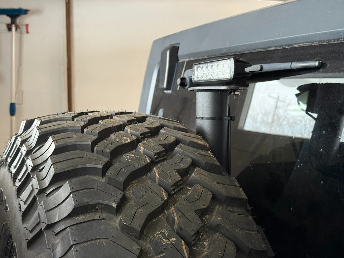

I've been going back and forth about what light to try on the rear AEV carrier. Not wanting to buy another set of lights that ultimately won't work, I found this single light at Harbor Freight when I was picking up a few boxes of nitrile gloves. For $22, it's essentially a knock-off copy of the Rigid SR, and will let be figure out how I may want to mount/modify a Rigid (or if one would even work well here!). Again, this isn't a back-up light, more like a rear mounted work light, letting me throw some light on a trailer or campsite. I'll be running some wires back here this week, once my PVC coated 14AWG wire shows up!
Obviously the tire will block some light, and especially so when I go to 40"s, but this will give me an idea of how much and how I may need to modify. I'm already thinking of some options for that post, potentially making a basket/solar mount for up there. Either would give me some real estate to move the light rearward and let me angle it down more (if needed).

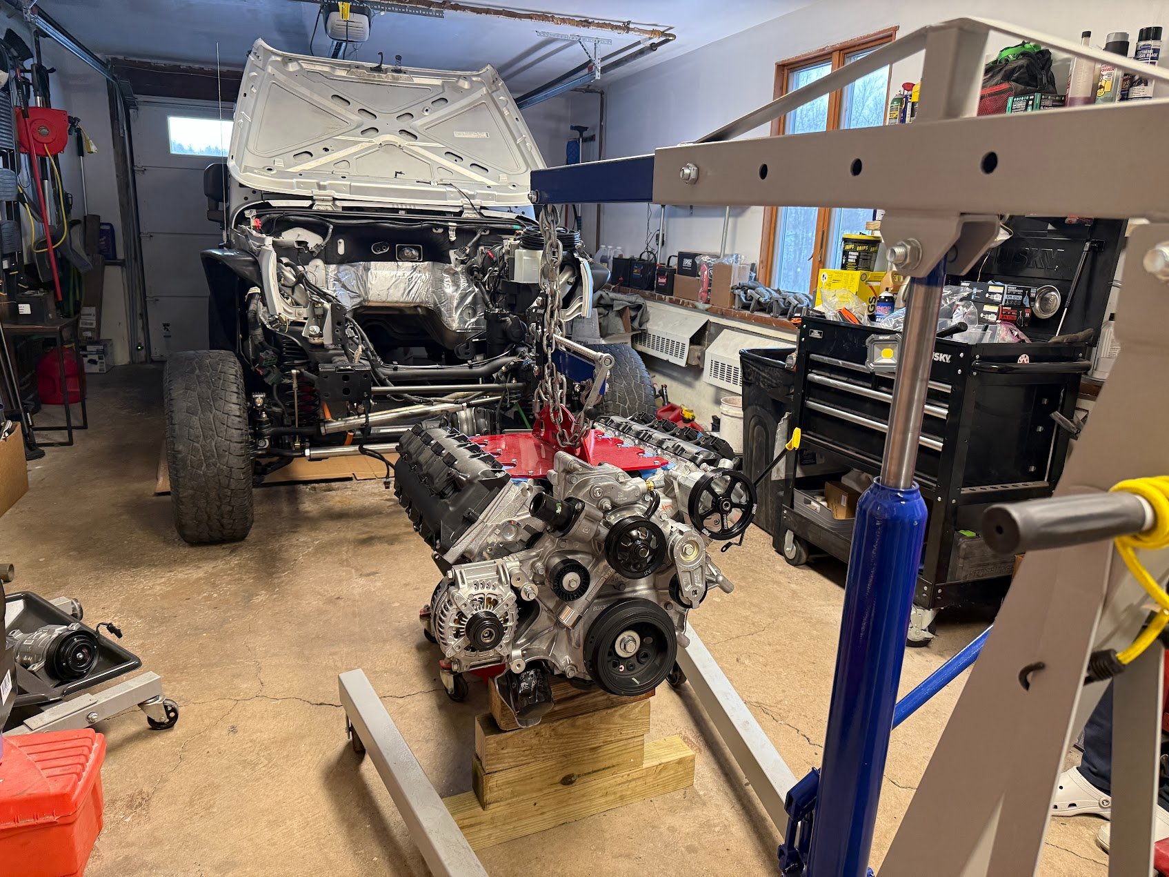

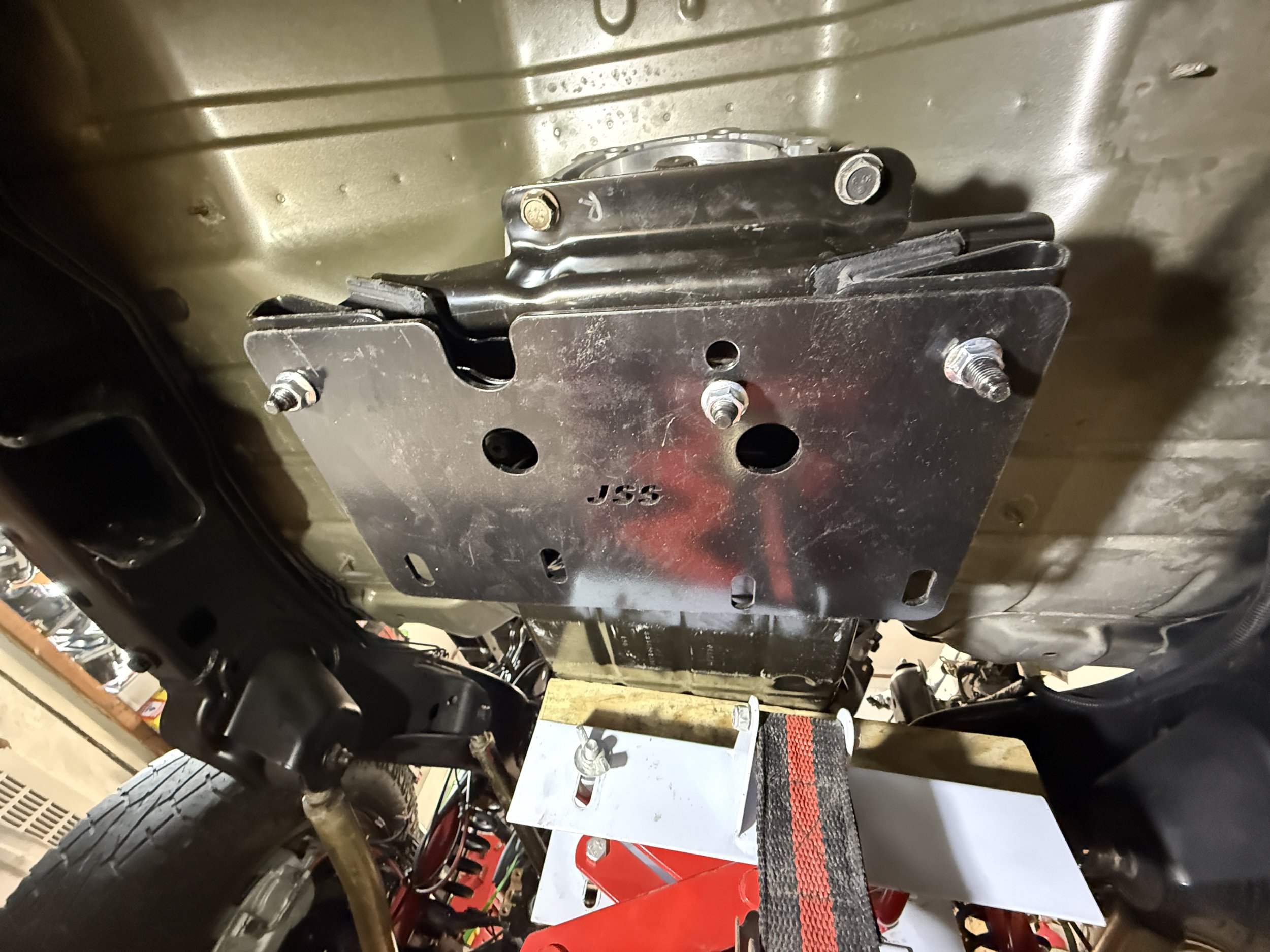

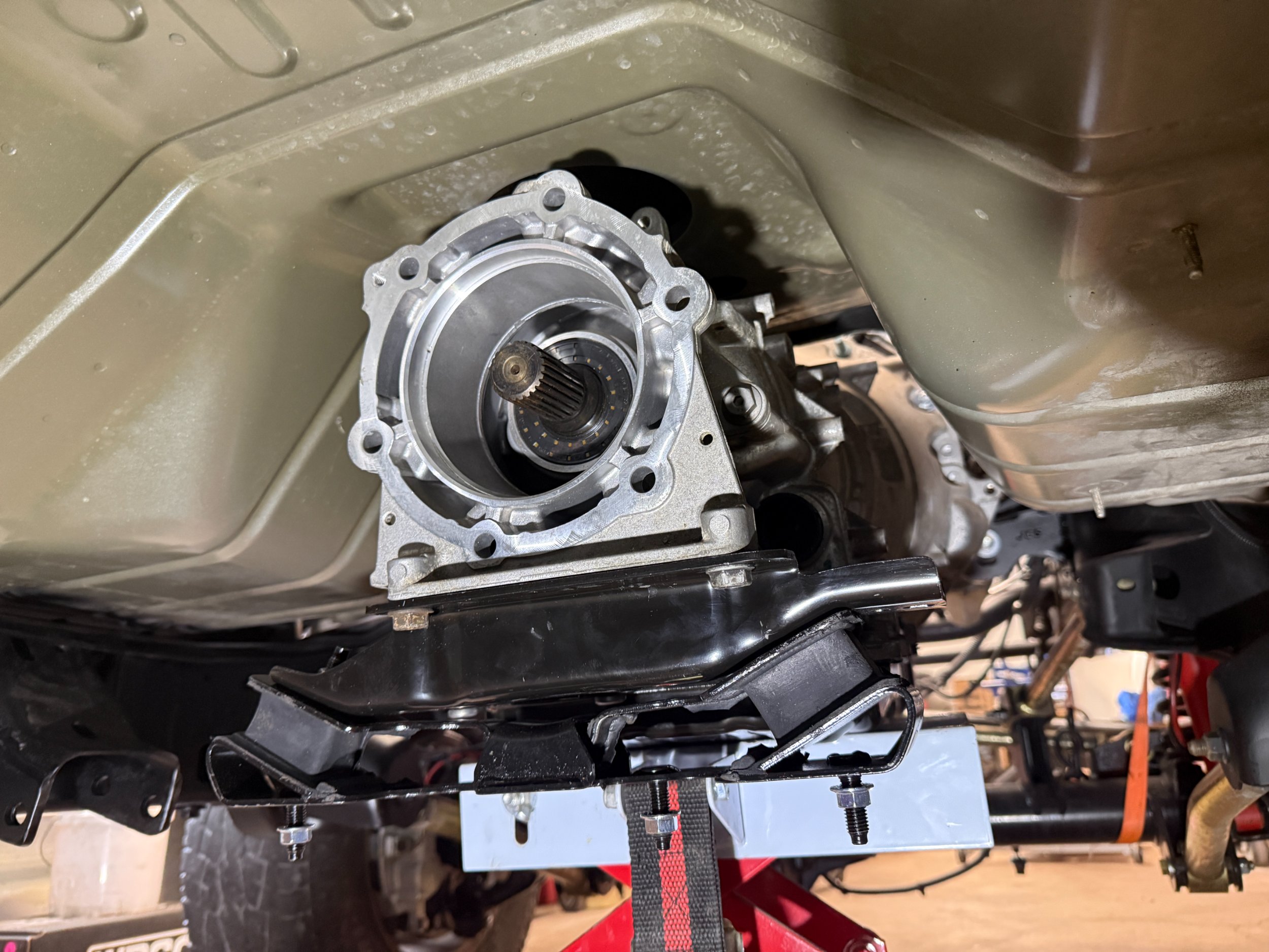

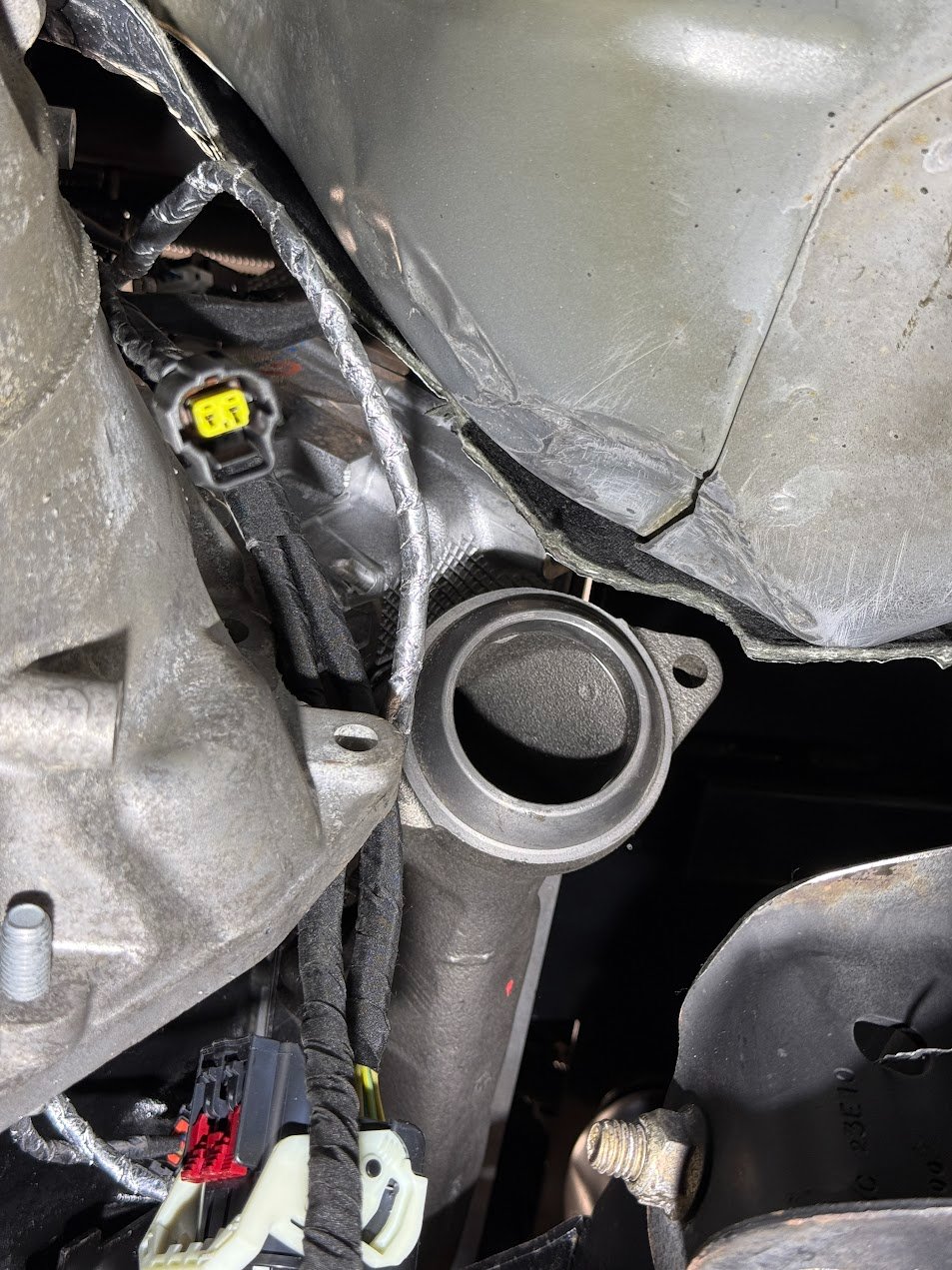

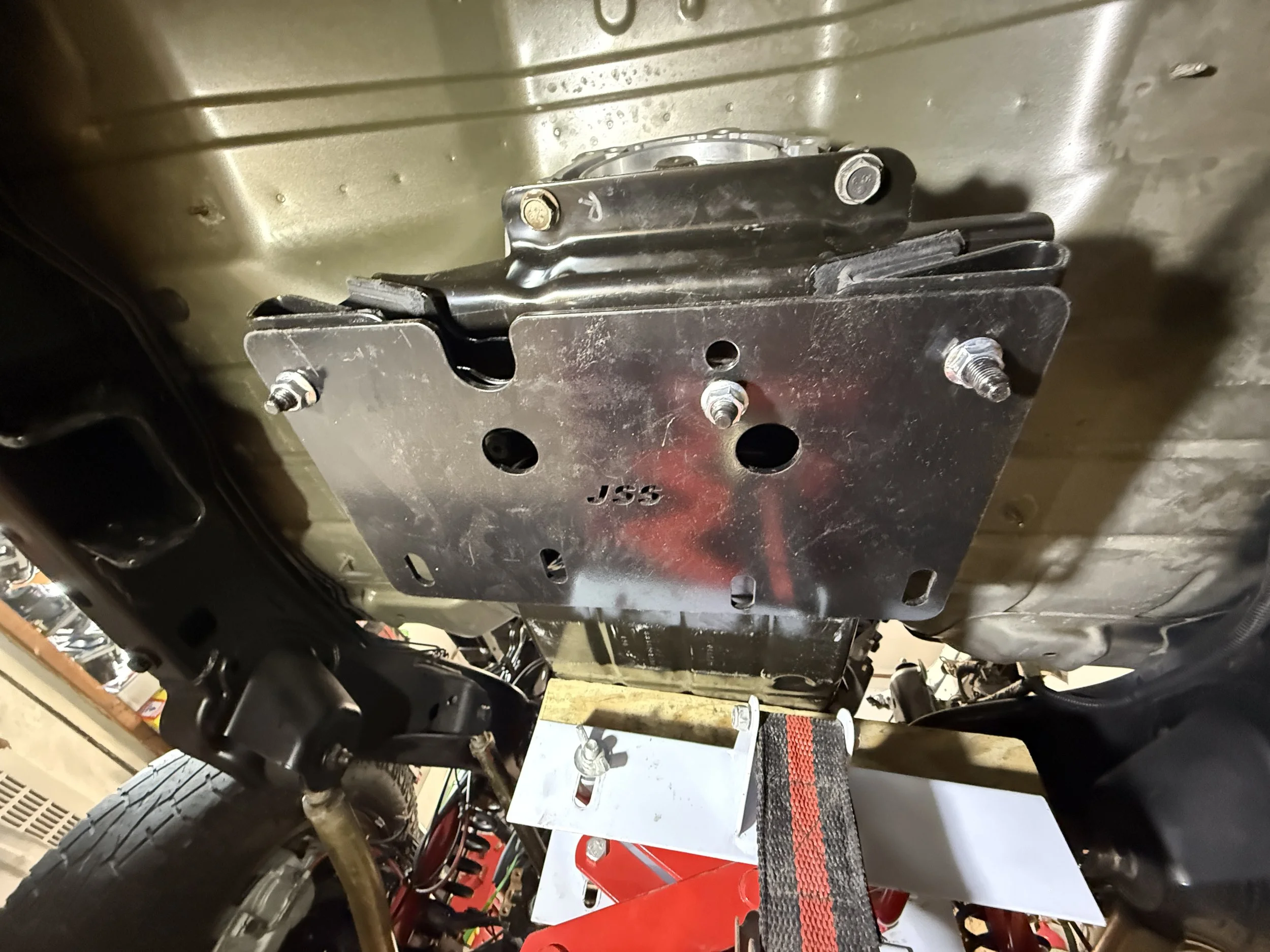

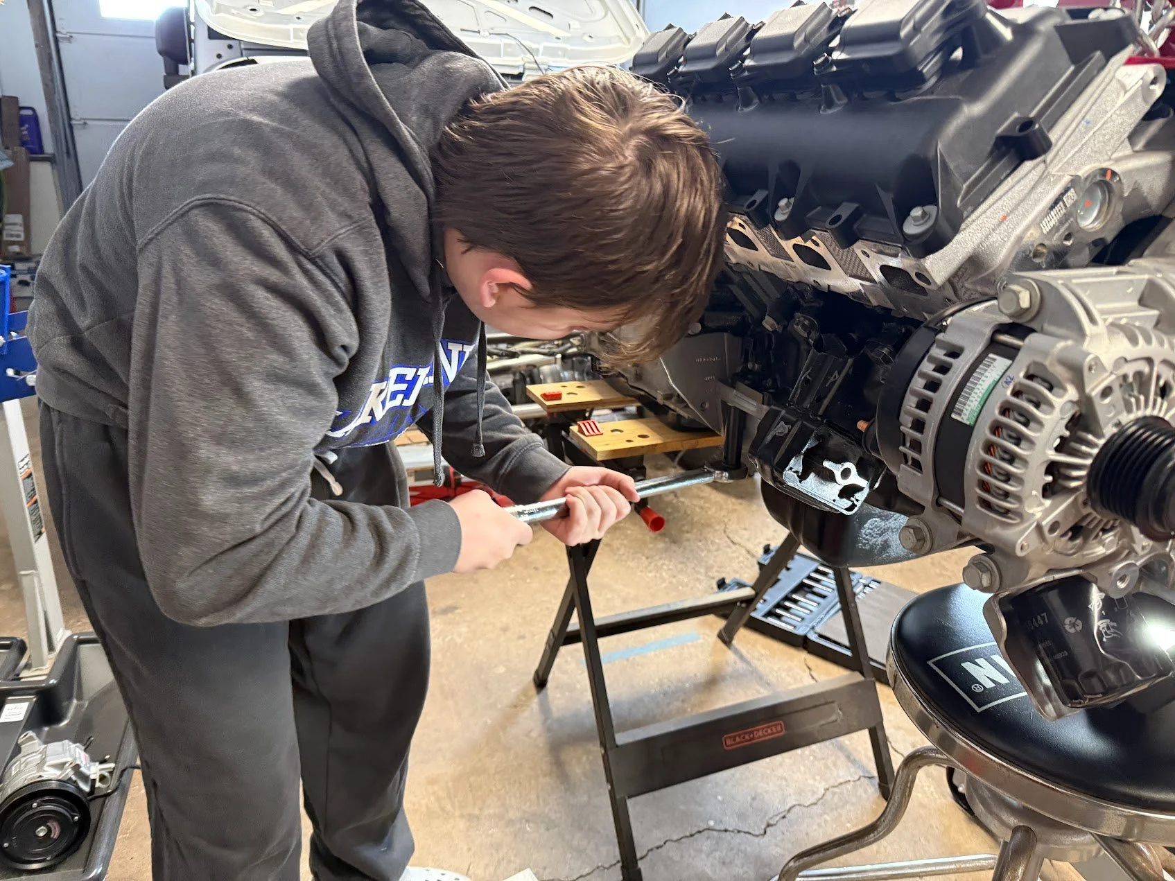

Getting the engine and trans completely in place... The JSS kit for the 8HP70 uses an OEM Ram trans adapter (the black bracket bolted to the trans) and the OEM Jeep rubber isolator:
All of that gets bolted to the JSS transmission plate, which then gets secured to the OEM crossmember:

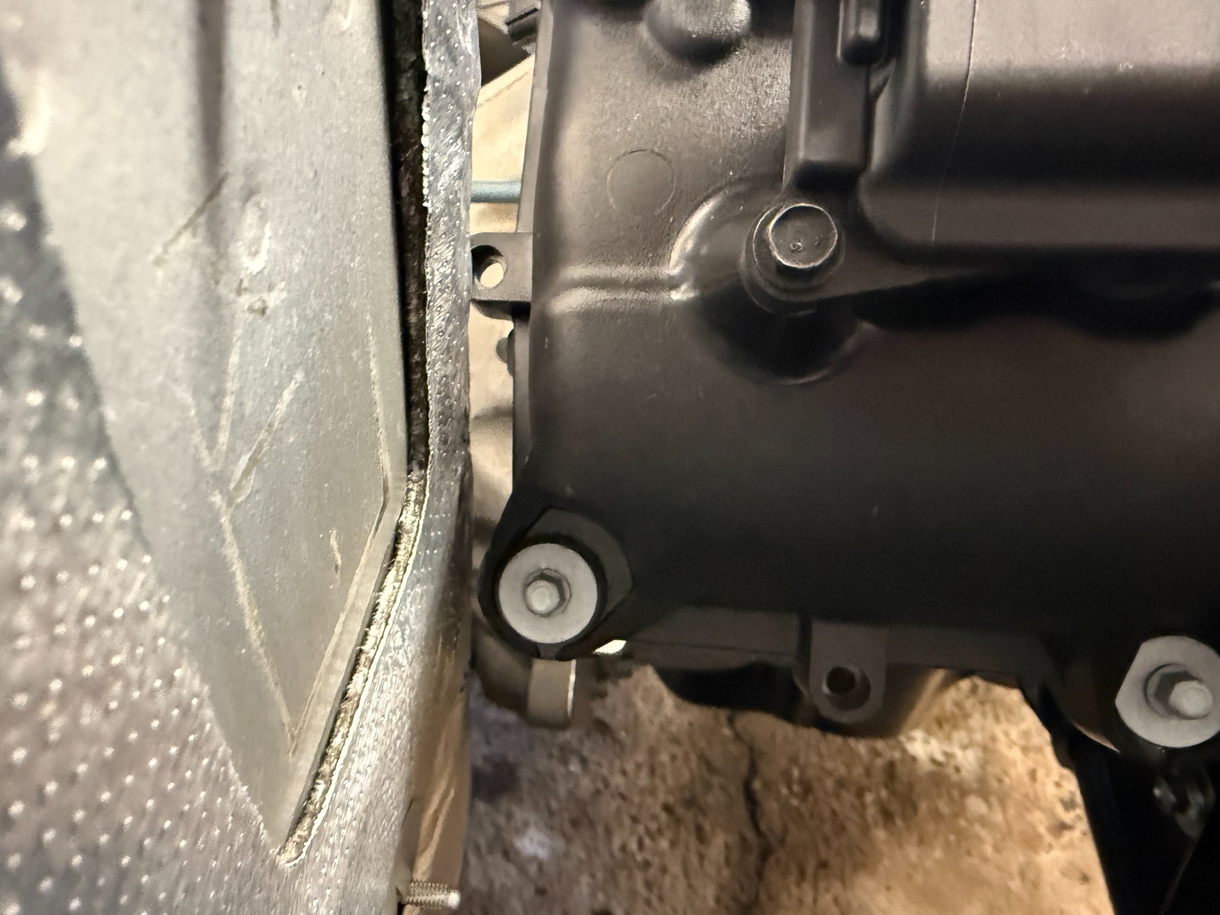

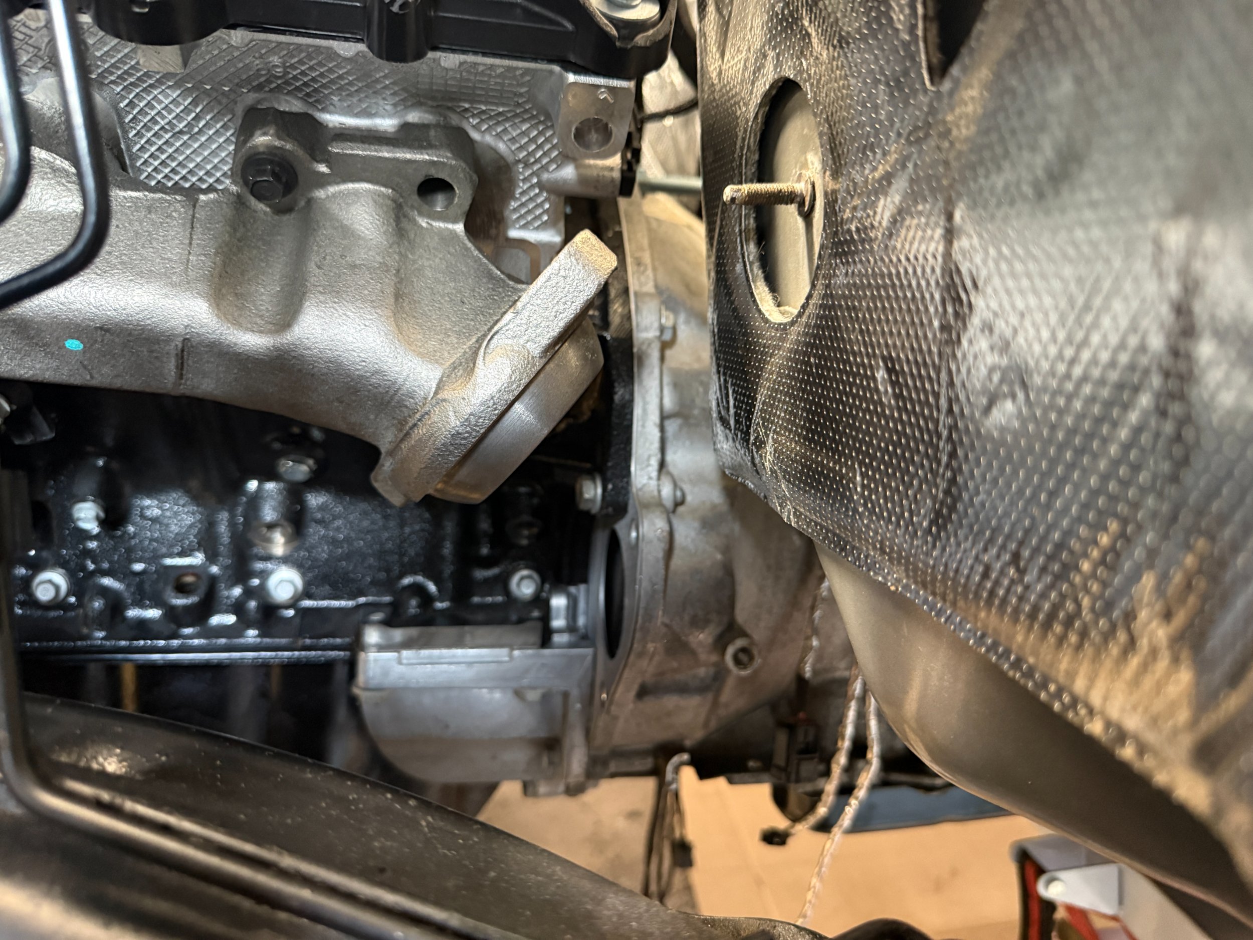

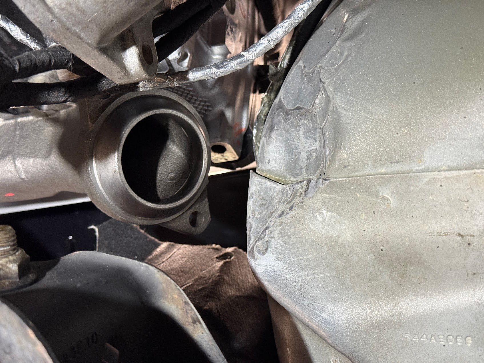

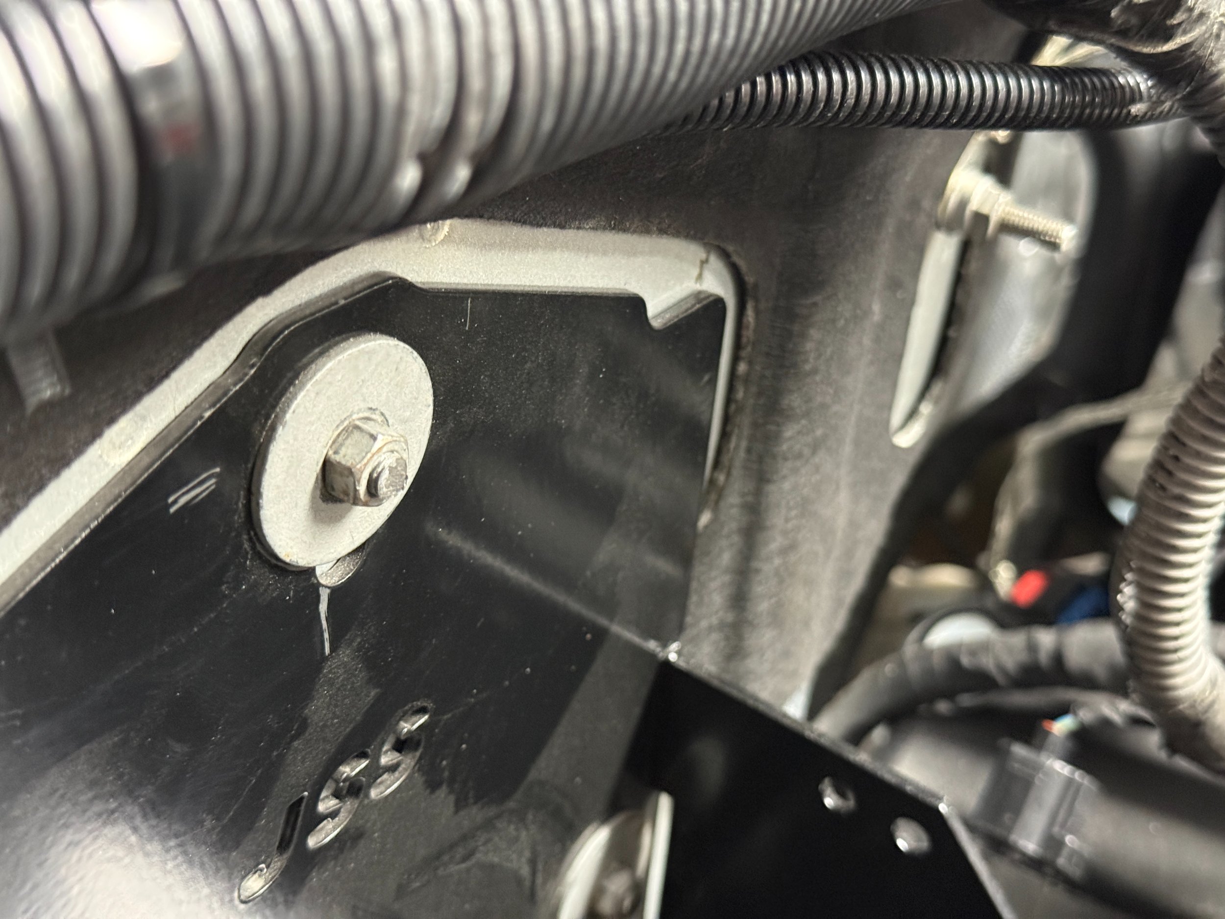

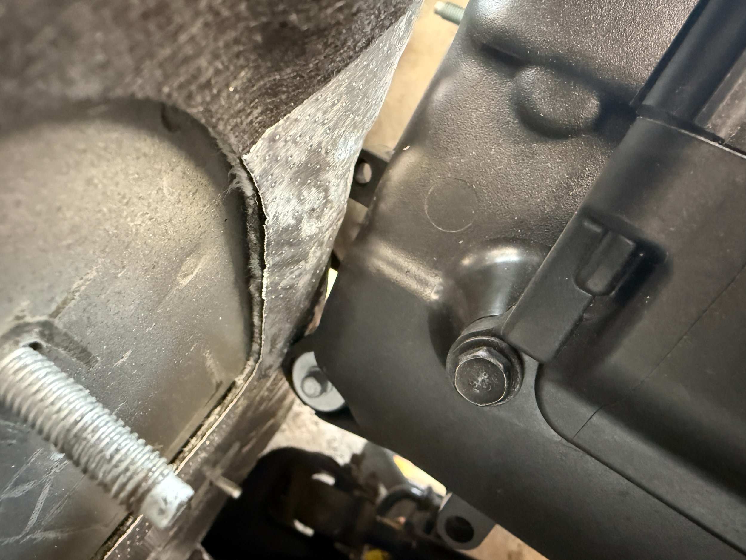

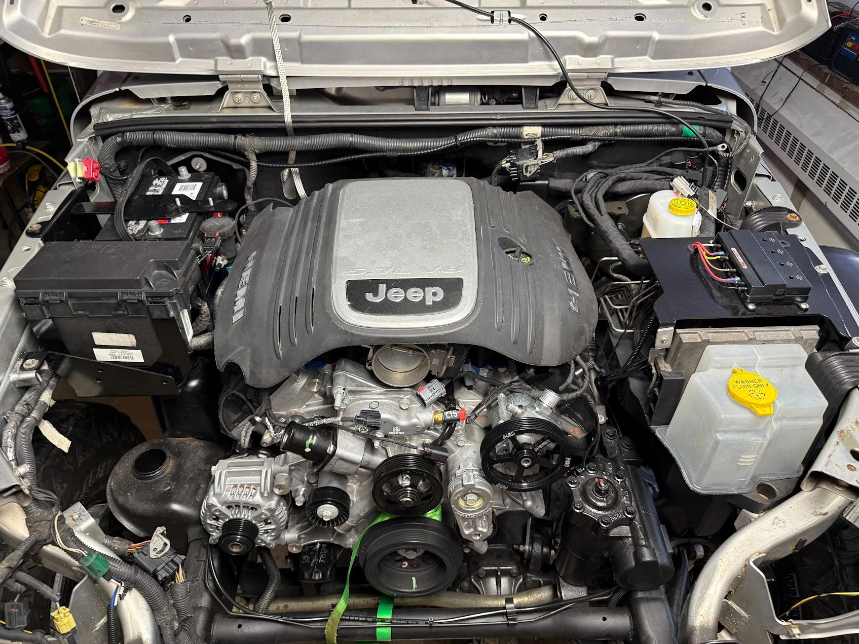

My intent was to use the "top" bolt hole on the engine frame mounts. This makes it REALLY tight at the firewall, and also really tight on the trans tunnel (specifically the vent nipple)...
This also causes the motor to be tipped up in the front. This is a good thing in that it gives as much clearance for the axle and suspension underneath, but I'm really going to need to smash the firewall back to clear the passenger side valve cover.
Rather than mess with that for now, I decided to drop the motor down into the lower bolt hole (lowers the engine down 1"), allowing the valve cover to comfortably clear. I'll see what I'm dealing with for clearance in the front once everything is in, but it looks like with the UD60, it may not have limited much, since the housing will be hitting other stuff before the UCA's start hitting the engine mounts.

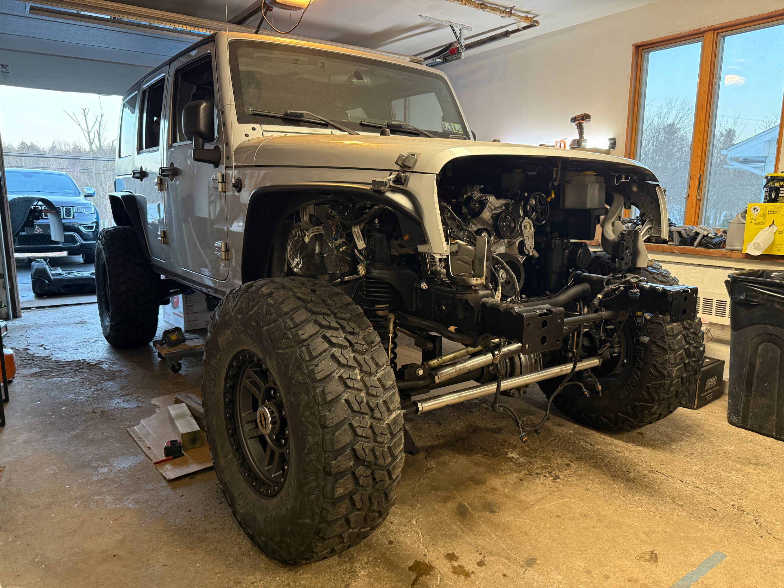

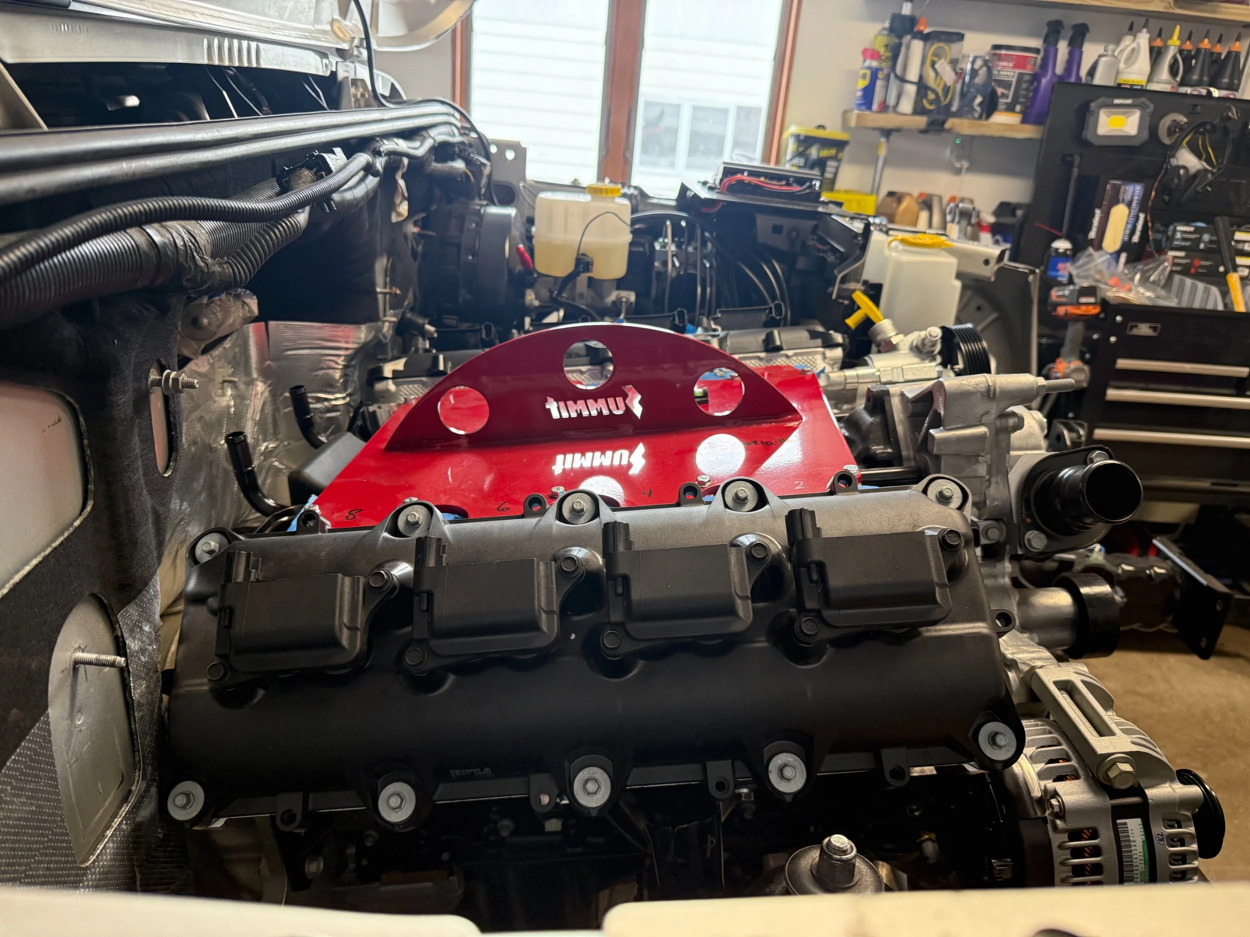

I threw the 37"s back on now that the engine is in (will make it easier for me to work on while I'm under there anyways)... I'm really liking the stance and look, though still want to go with 40"s when I work out all the bugs and trim up all the body panels.

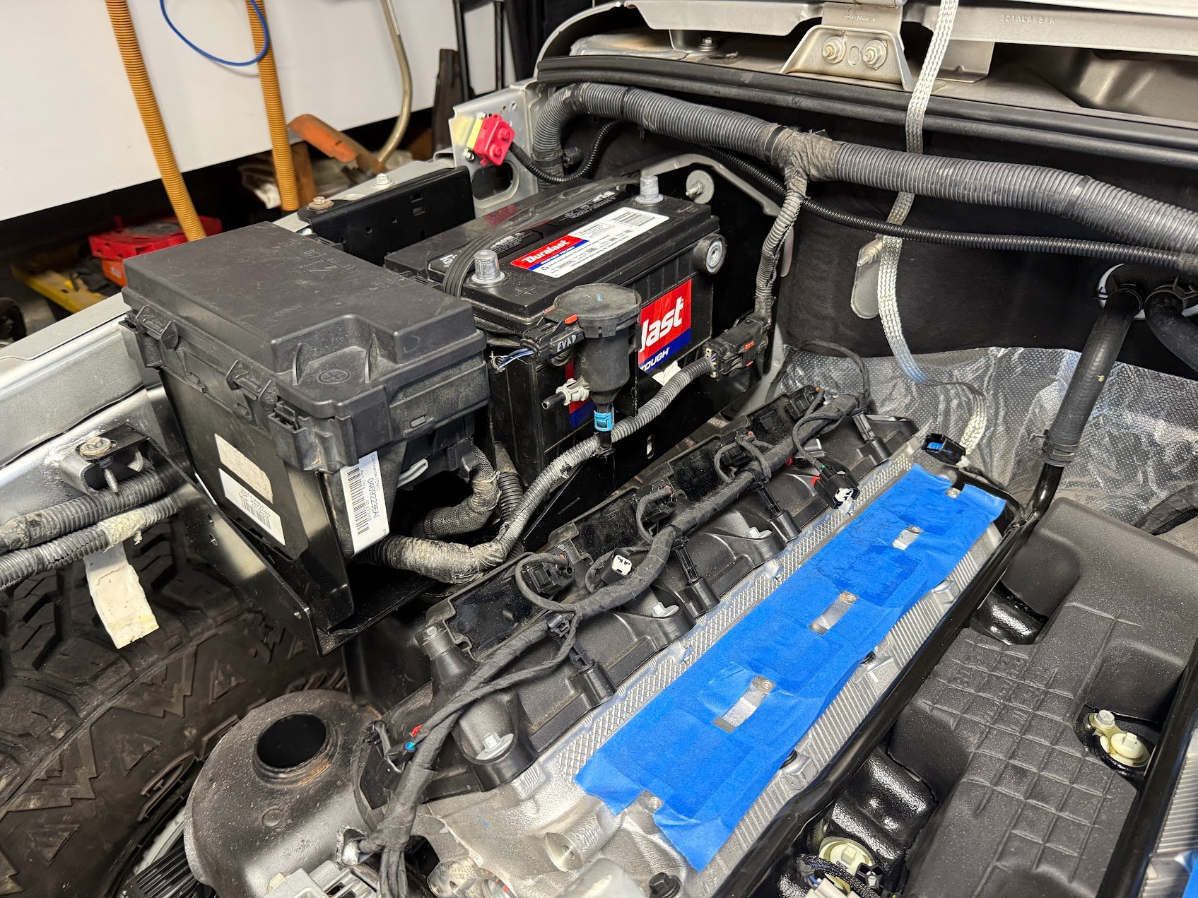

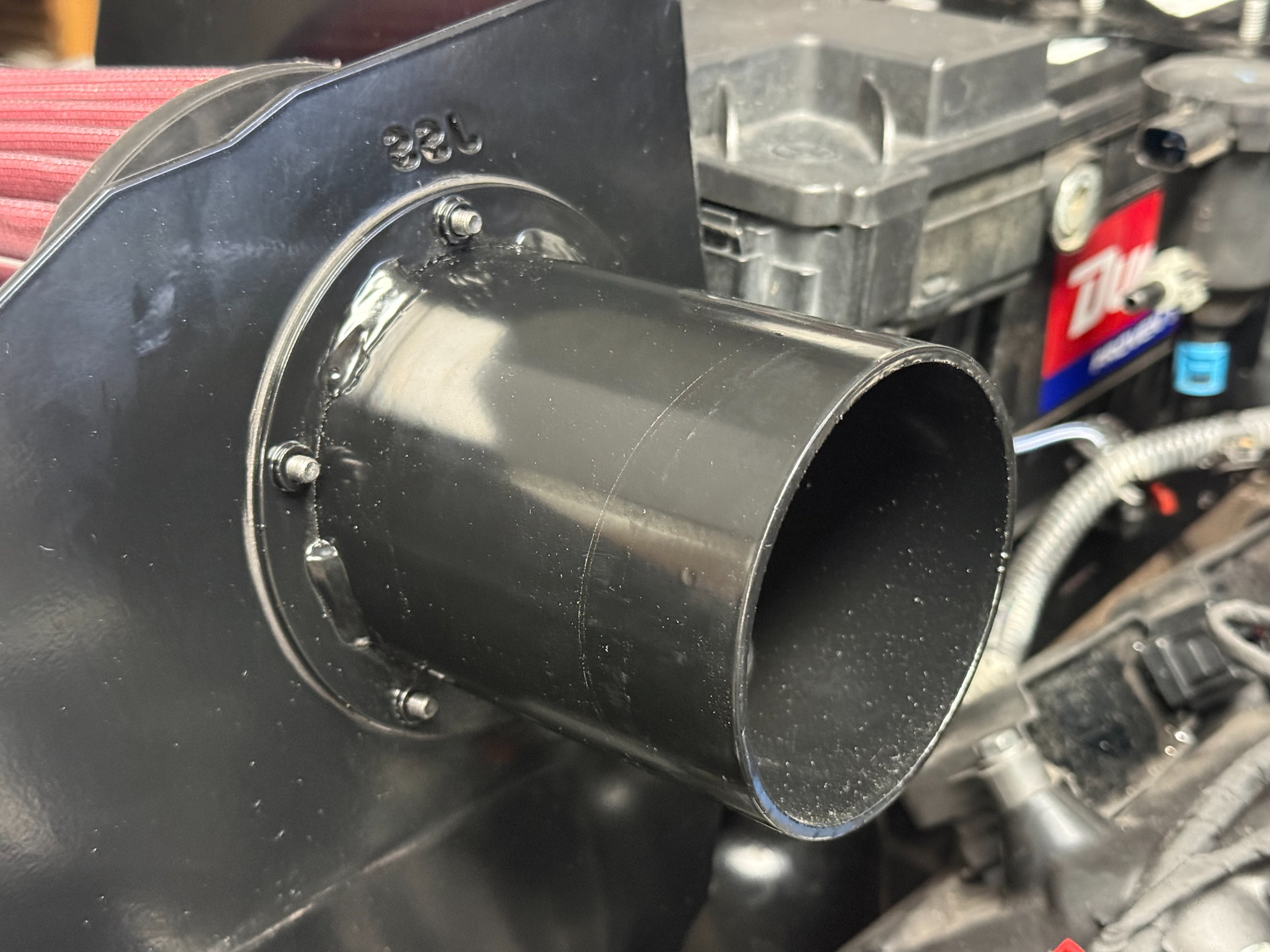

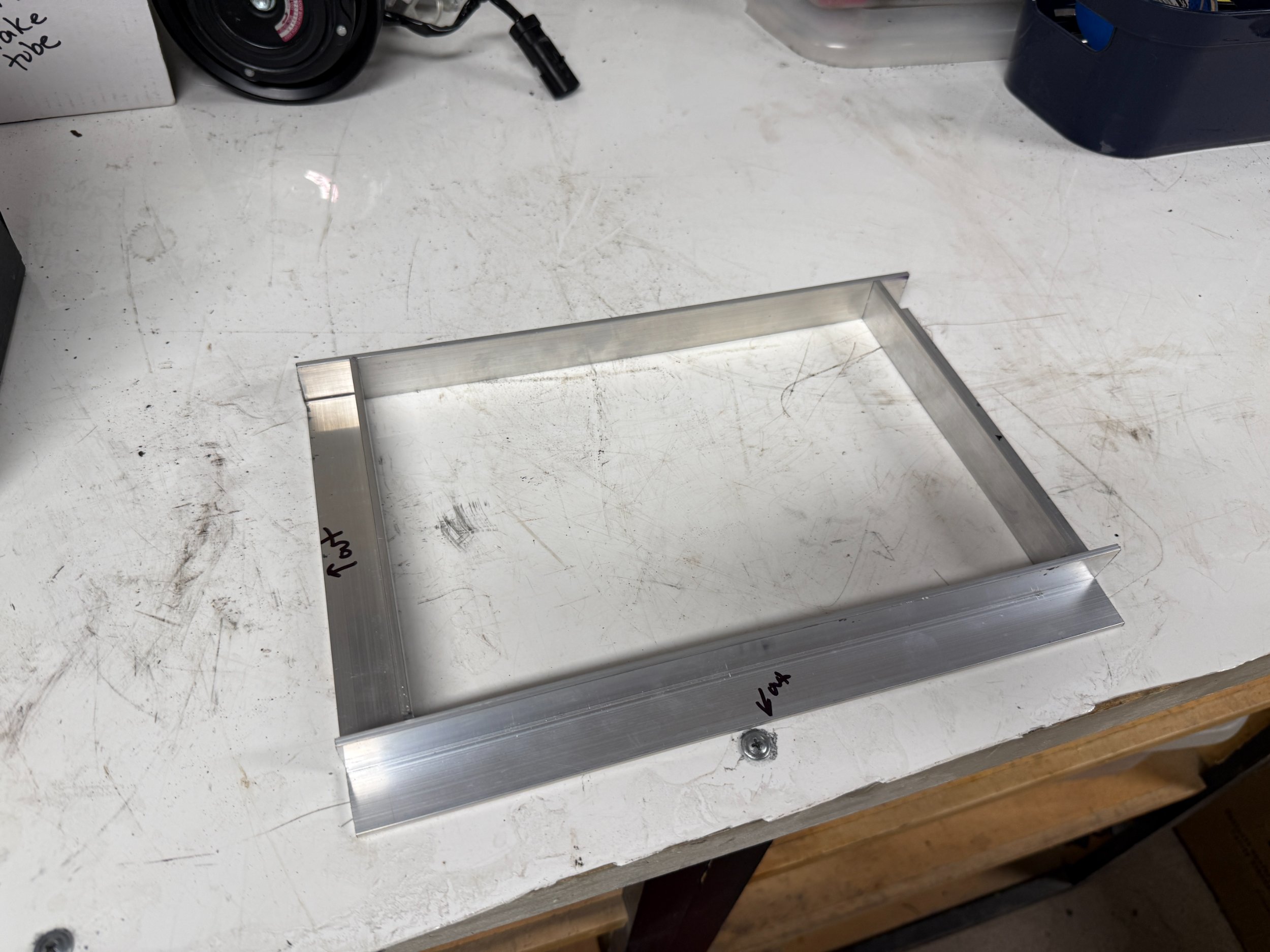

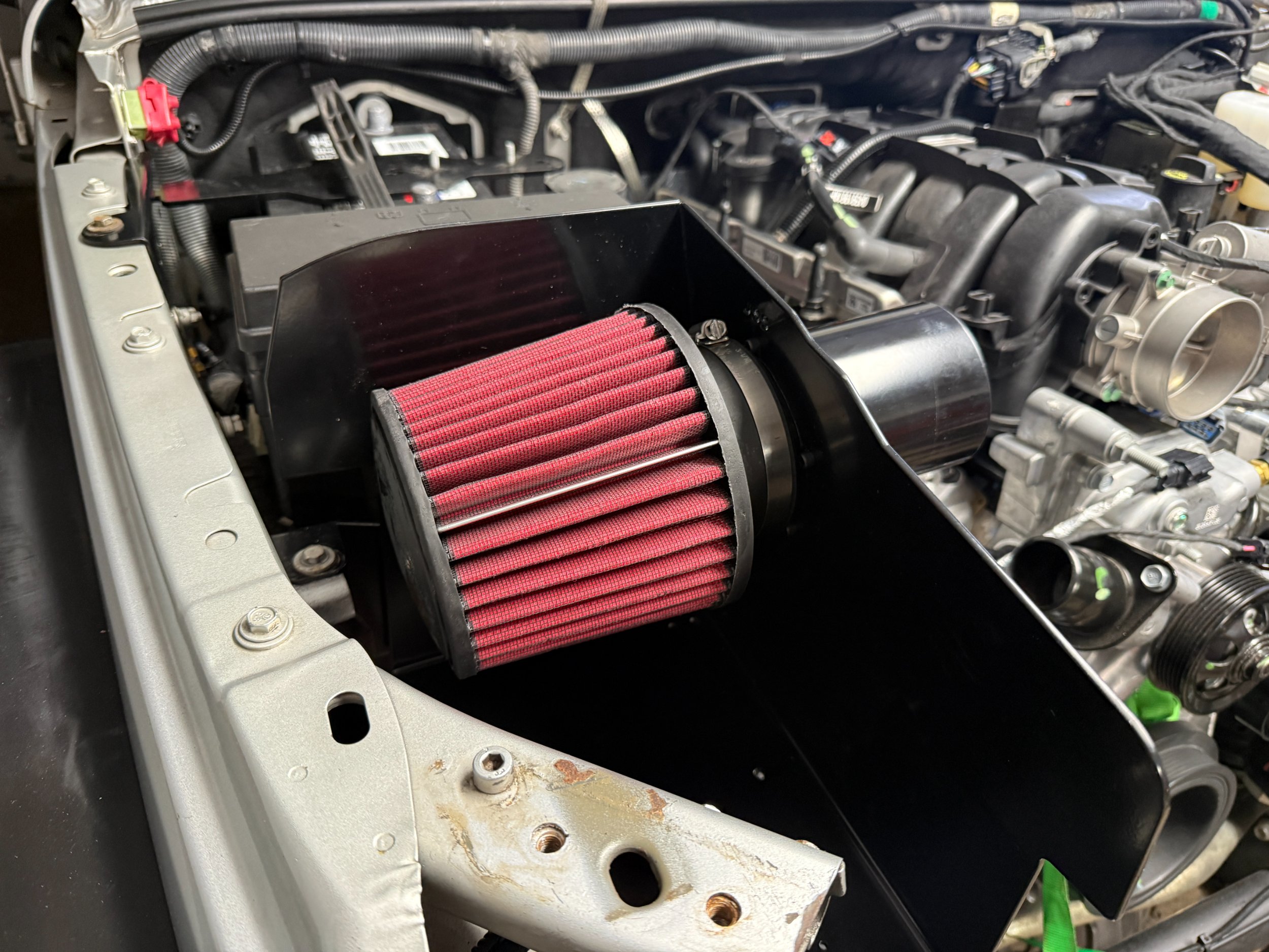

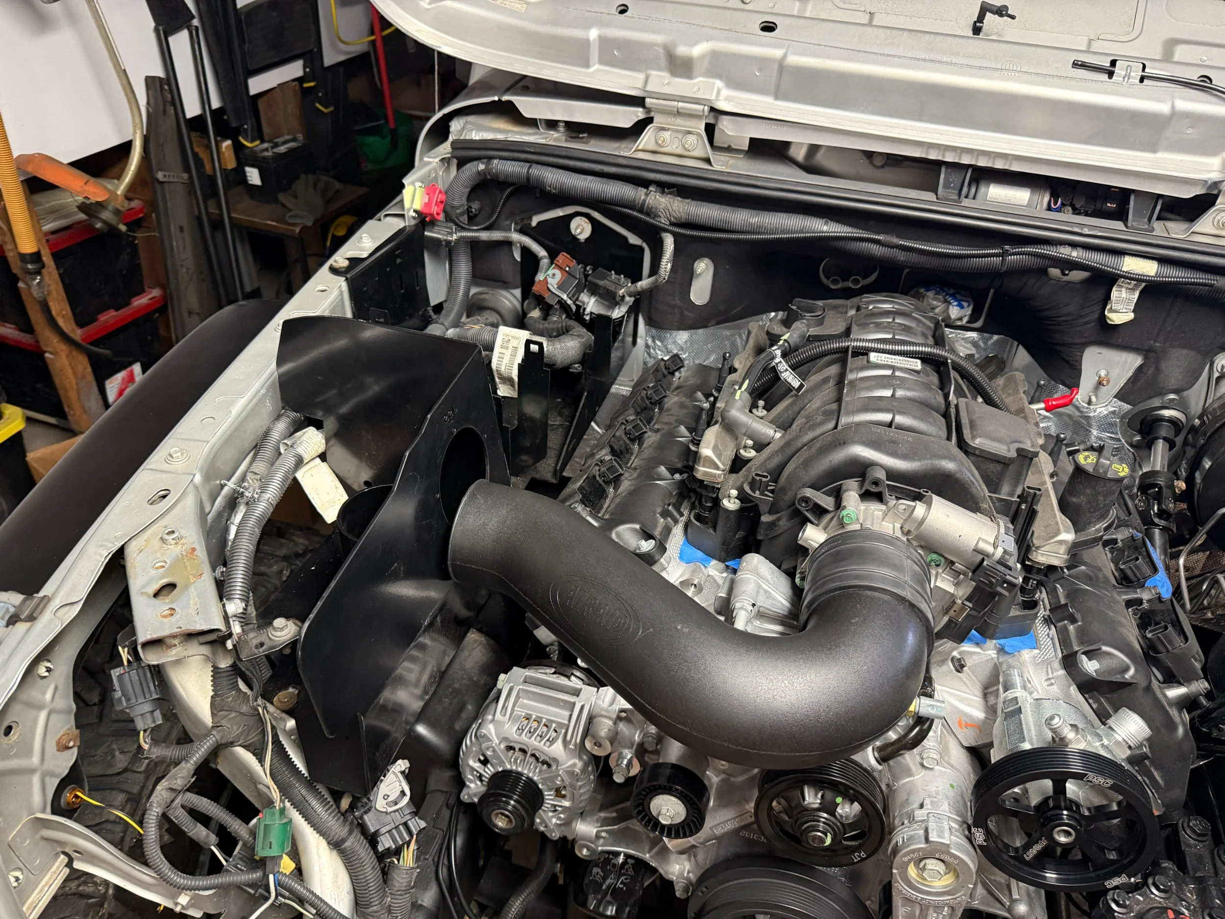

I threw the intake on (just sitting there, not bolted in) to see how the battery box and intake box fit. I'm guessing I'm going to need to modify the AFe intake tube some, or maybe just modify the JSS air box. I haven't decided what would work best yet...

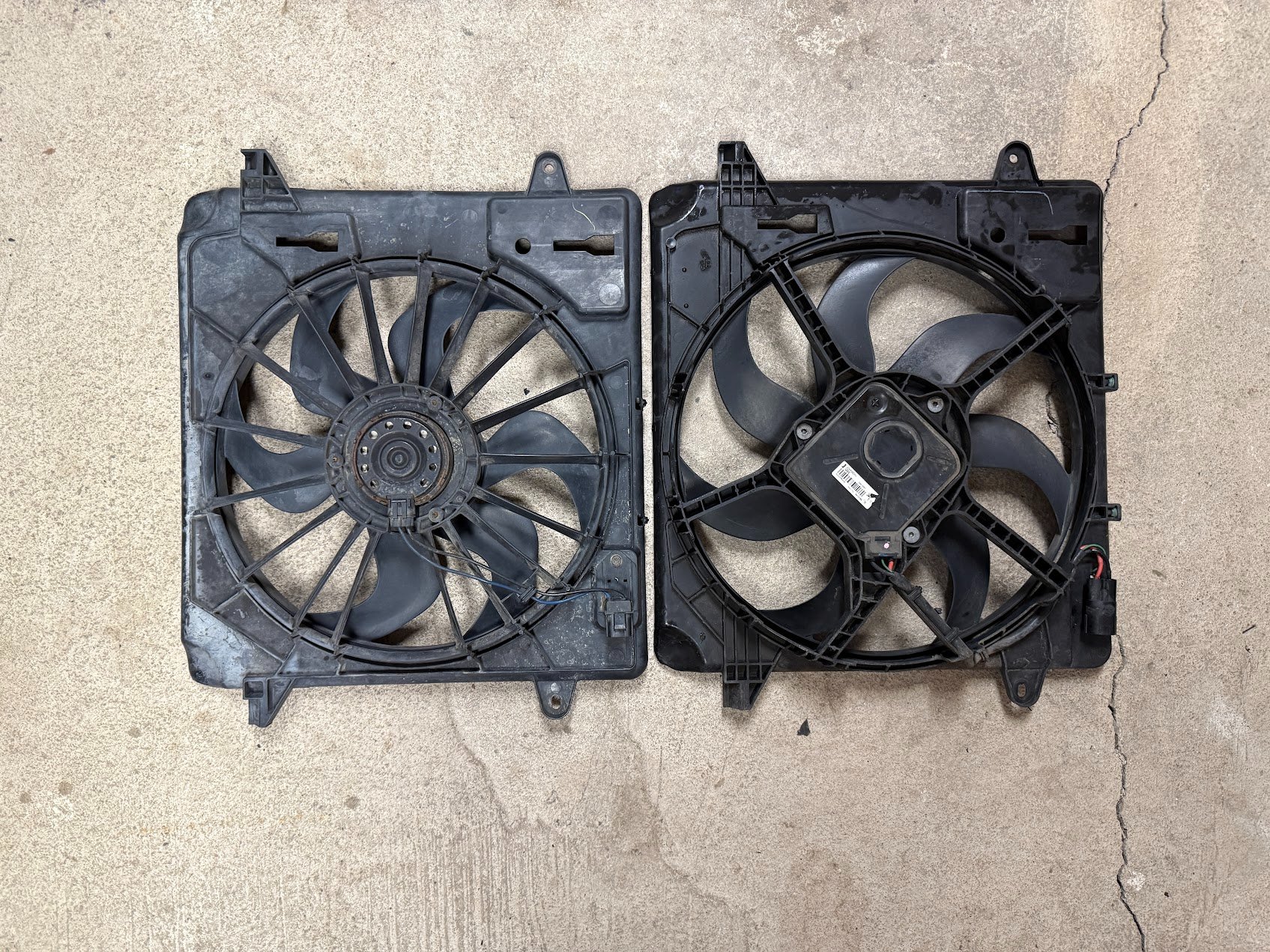

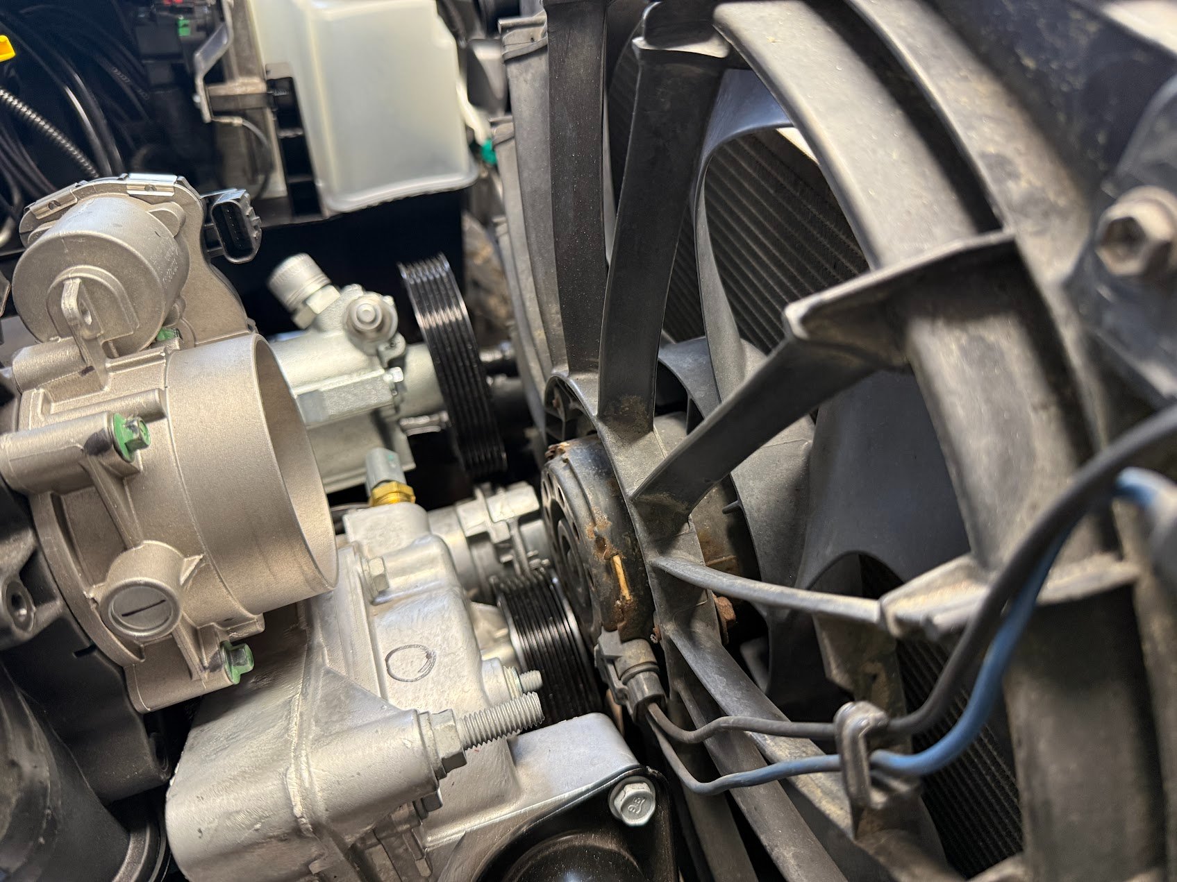

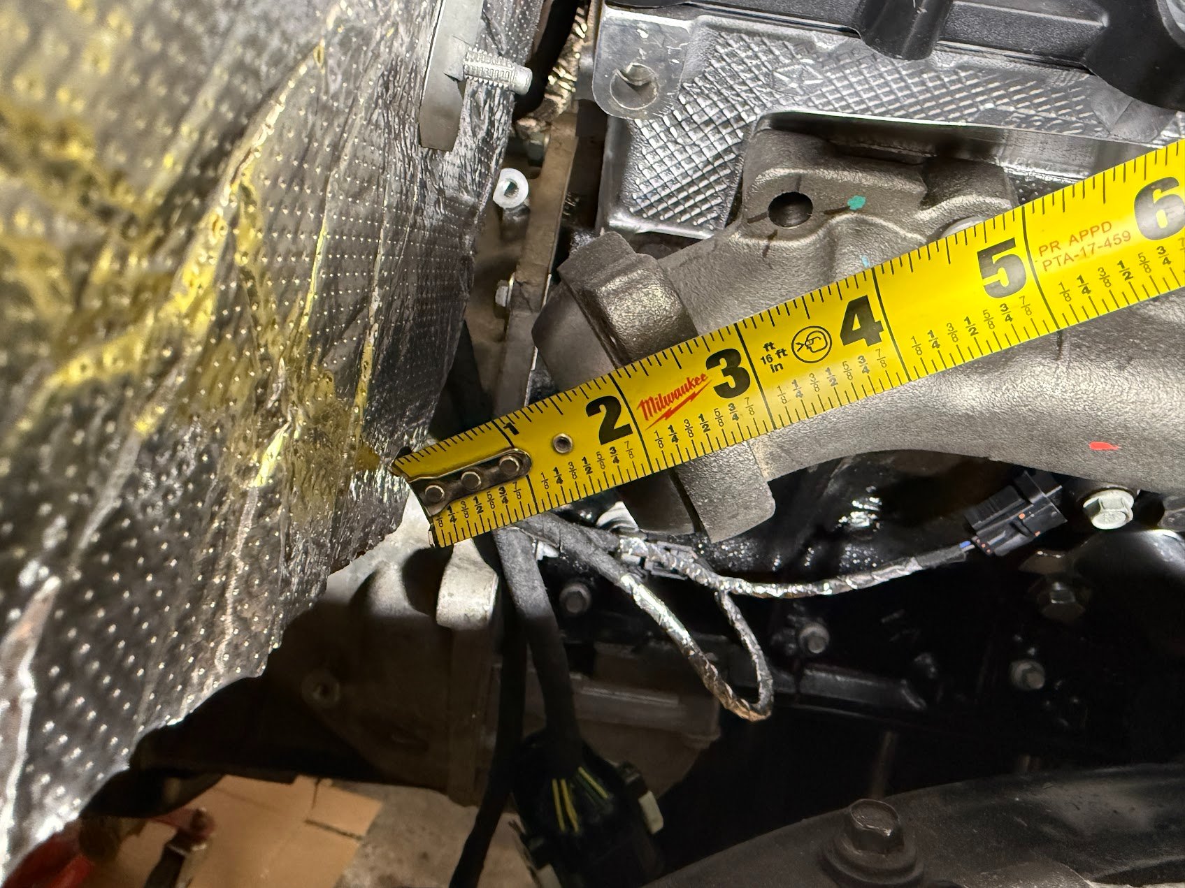

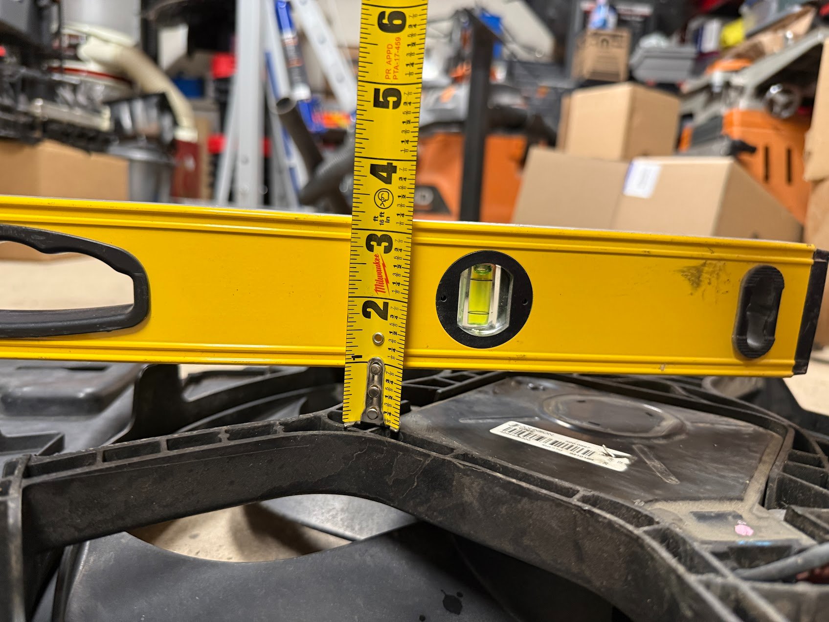

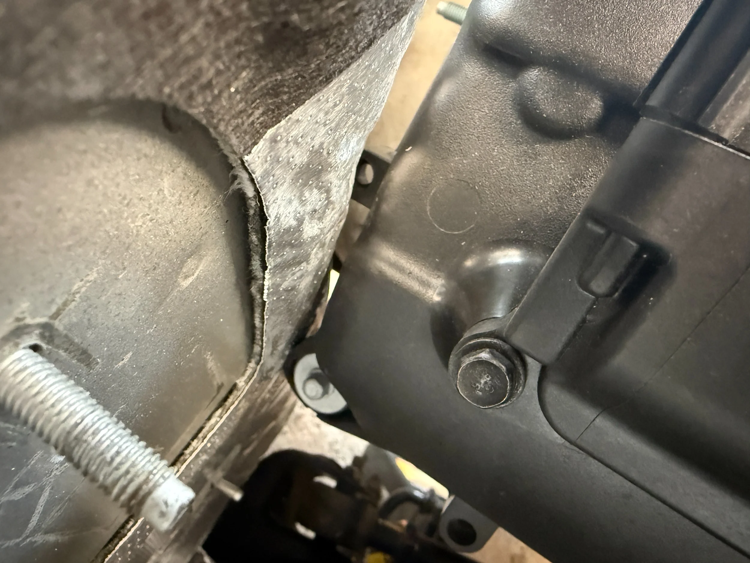

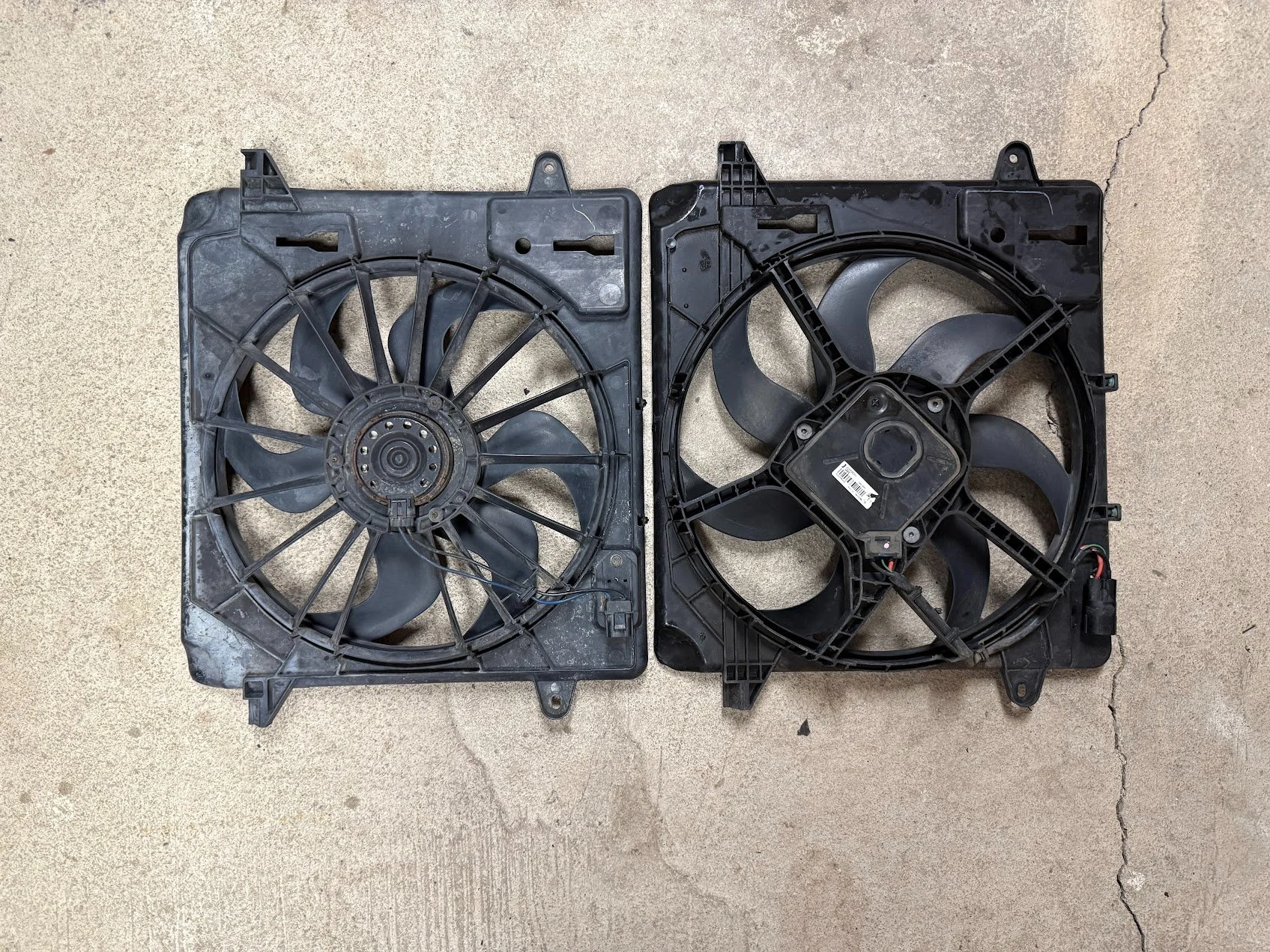

I threw the front end back together just to check on fan clearances. As expected, the 3.8L fan is too thick to fit in place with the grille in the normal location. I already ordered a (used but like new) 3.6L "Pentastar" fan off of eBay. I got a low mile take-off because everyone locally wanted crazy money for their filthy part-out fan, or they were 3+ hours away. For $80 shipped to my door, I figured it was the best way to confirm that the Pentastar fan fits with enough clearance. If it doesn't I'll be looking at the popular "Camaro" fan option.
Some people choose to push the grill forward a little bit. I'm not 100% opposed to it, but I prefer to do what I can to prevent that. It kinda looks funny, though most don't notice it. However, once you point it out to someone (or see if yourself), you realize it looks terrible (plus has some other considerations, but reducing clearance to your bumper/winch, etc.). Regardless of the fan I pick, I'll need the updated wiring harness (the fan pulls 50A!) and will also need a PWM controller for the fan. I could choose to go with a newer TIPM (for 2009+ model years) and control the fan that way, but the logic isn't great and people struggle to keep cool at slow/trail speeds simply because the fan is always playing catch up (or alternatively, always running at 100%, which on the Pentastar fan, sounds like an Boeing 747 turbine!). Neither is ideal, so the small expense of the RPM Extreme controller is money well spent IMO.

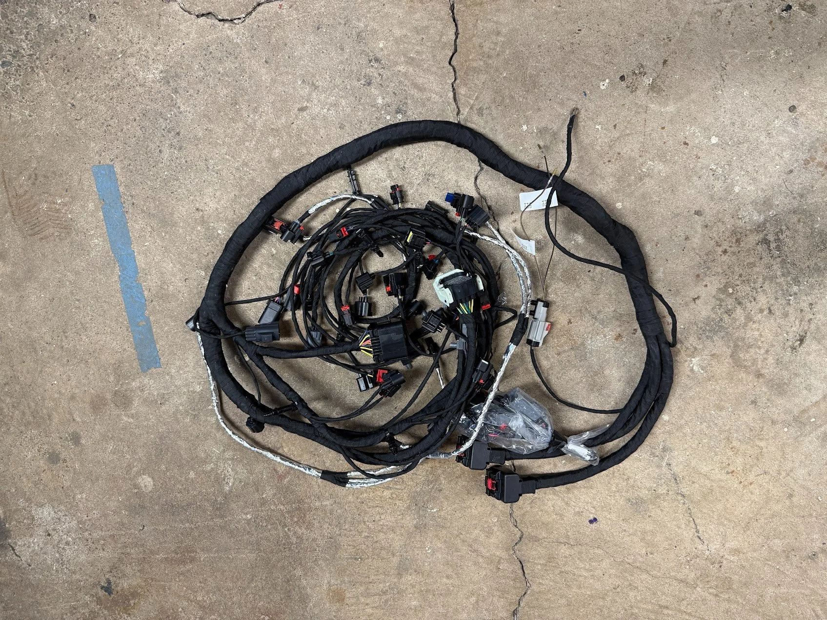

Speaking of wiring, my Jeep Speed Shop Hemi harness showed up! Nothing too complicated here, I simply started with the #1 injector and coil pack, and then worked the harness around the engine, trans, and firewall. The clips aren't labeled, but the connectors fall in place where they should so you'll eventually figure it out. I have some "unknowns" in the rear of the harness, but I believe these are mostly related to the transmission use. Since I'm going with the 8HP70 swap, I'll have a separate trans harness that will integrate into this one. I wish JSS had better instructions, labels, and/or diagrams, but I feel like I have a good handle on the 8HP TCM/Controller wiring, so once it arrives, I'll sort the rest all out and tape/bag up what I don't need.
Given the cost of the harness and ECM, I do wish JSS made them truly "vehicle specific". Having a handful of (large-ish) connectors hanging off the back of a engine isn't "professional" to me. Heck, even if they charged a small premium to do a "depin and delete", I would have likely paid for it. Granted I'm sure it makes their inventory much easier to manage for them (and for many installers), but when I used to build my harnesses (and harnesses for others) I used to eliminate any circuit not necessary. Once my swap is all done, I may go ahead and depin what I don't need. The harness is nicely wrapped, so it would be a shame to cut that open, but I'm anal and I know a 545RFE connector flopping on the side of the transmission will eventually annoy me...

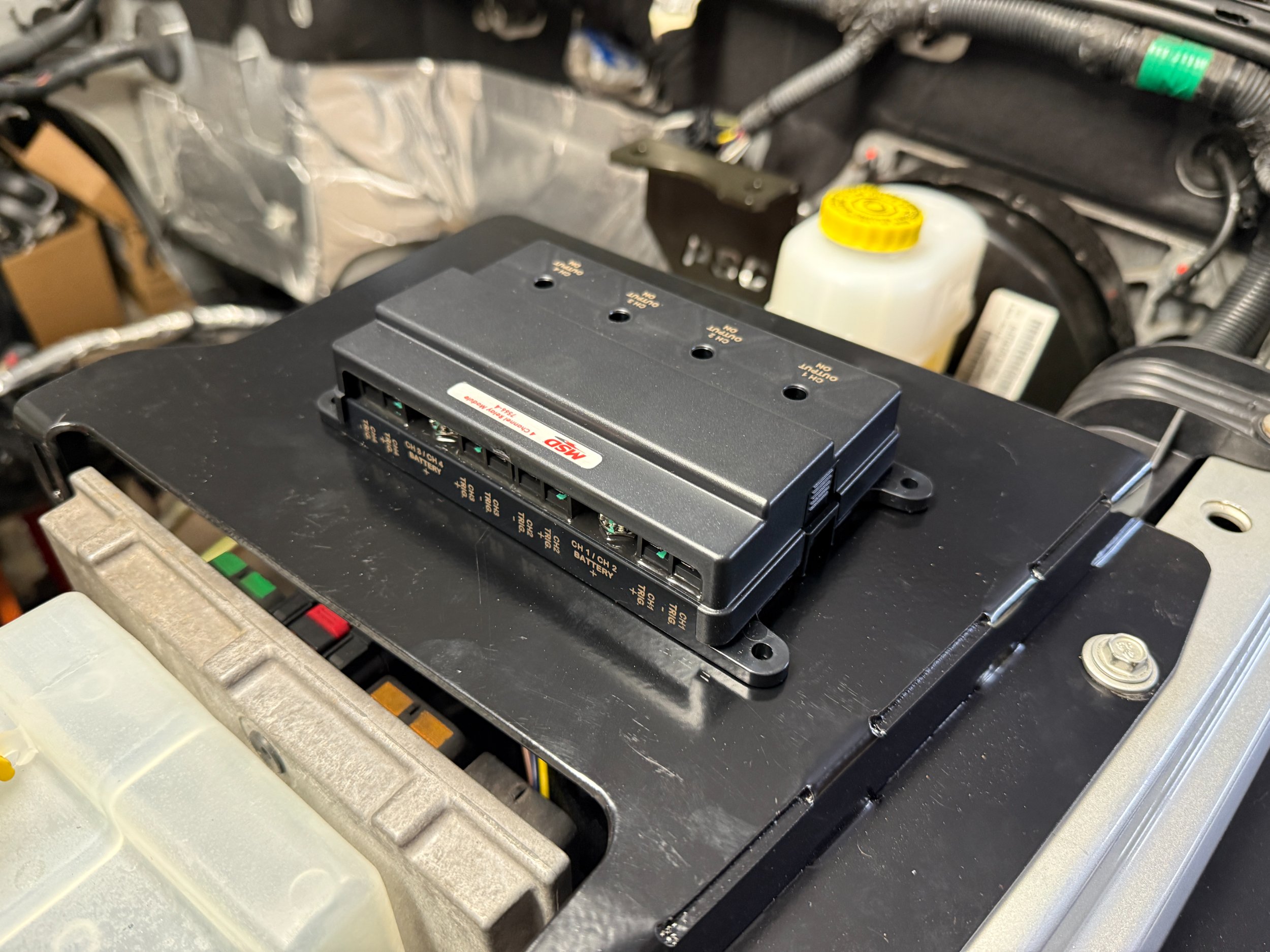

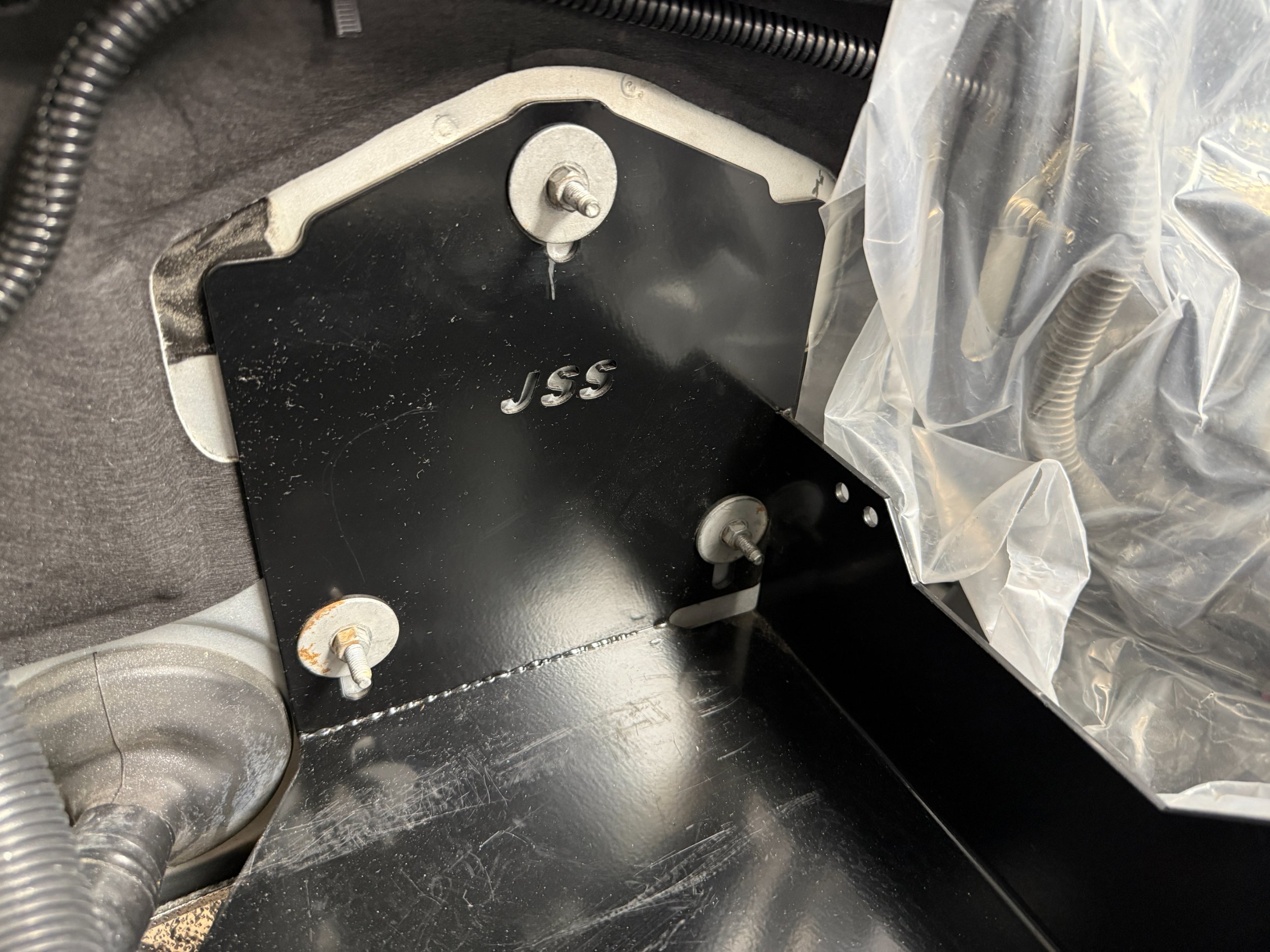

With the engine harness in place, I got the TIPM and battery box buttoned up. I ended up cleaning every harness connector with some hot, soapy water. Despite power washing everything well, the exterior of the connectors (where the "cams" are) were still dingy.
I was curious to see if it fit - it will need some trimming, but I'll be able to use the Jeep "Hemi" cover after all. I was a little skeptical since it started getting really tight in there but only a few minor spots will need to be trimmed up with a hot knife. That's a project for a much later time, but at least I know and can now stick it in a far corner of the shop.
