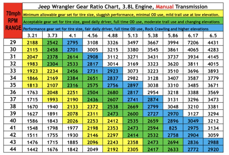

Don't you dare go against anything @Jeepguy1 is saying, he'll post this regurgitated "gear chart" :ROFLMAO:
So the OP has a 3.8 in his 2017 Jeep Wrangler? As in the same 3.8 that makes almost 100 HP less than the 3.6 that should be in his 2017? Or is it just that 3.8 in Canada is the same as 3.6 in the U.S.? :rolleyes:
Anyways, I am butting out of this thread now, but I'll leave it at this: When in doubt ALWAYS gear deeper. If someone gives you a choice between 4.10 and 4.56 and you think that 4.10 would likely be fine, but you also have the choice between 4.56, you always want to go with the deeper gears.
