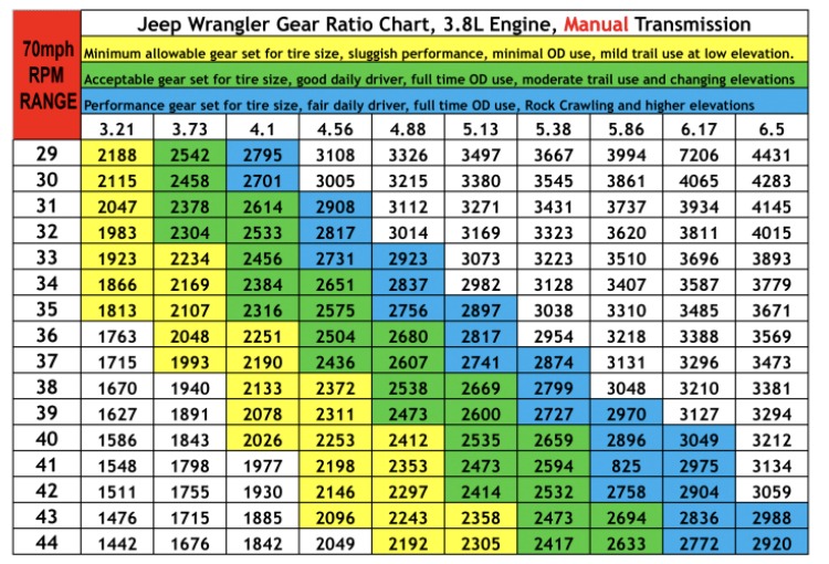

There are really three major differences when picking gears:
is it a '07-'11 3.8, or a '12+ 3.6 engine. Two different charts
is it a manual or automatic transmission. Again two different charts.
What is the tire size you want to run.

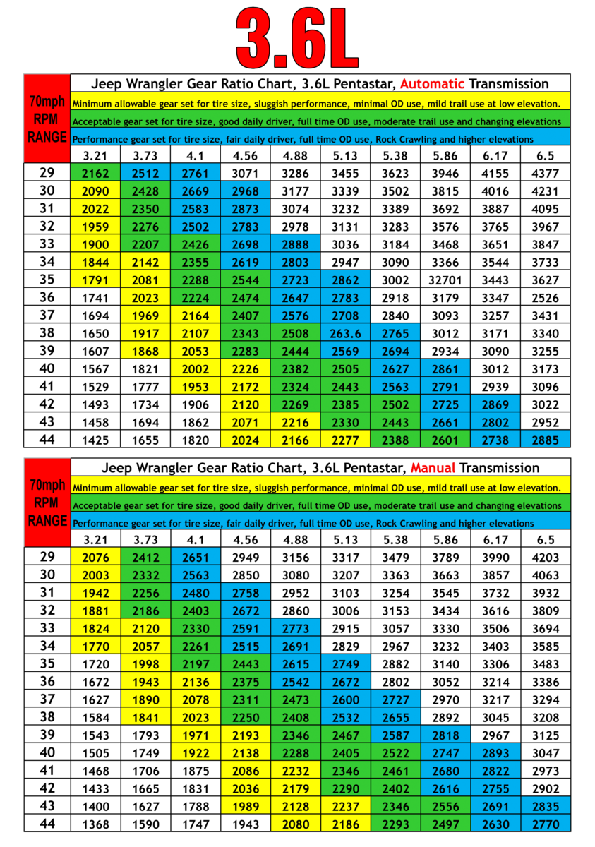

For a good daily driver with some overlanding/hill climbing, you'd want to be near the middle/upper end of the green.
So for your 3.6 manual transmission here is the chart:
On 4.10's, you're close to the "sluggish on hills" yellow category.
On 4.56's, you're close to the "trail rig" blue category.
IMHO if you have any hills or do any overlanding, I'd go with the 4.56's on a manual transmission/3.6L/35's combo.
You could also easily run 37's on the 4.56's if you ever upgrade the front axle from a D30 to a D44.
