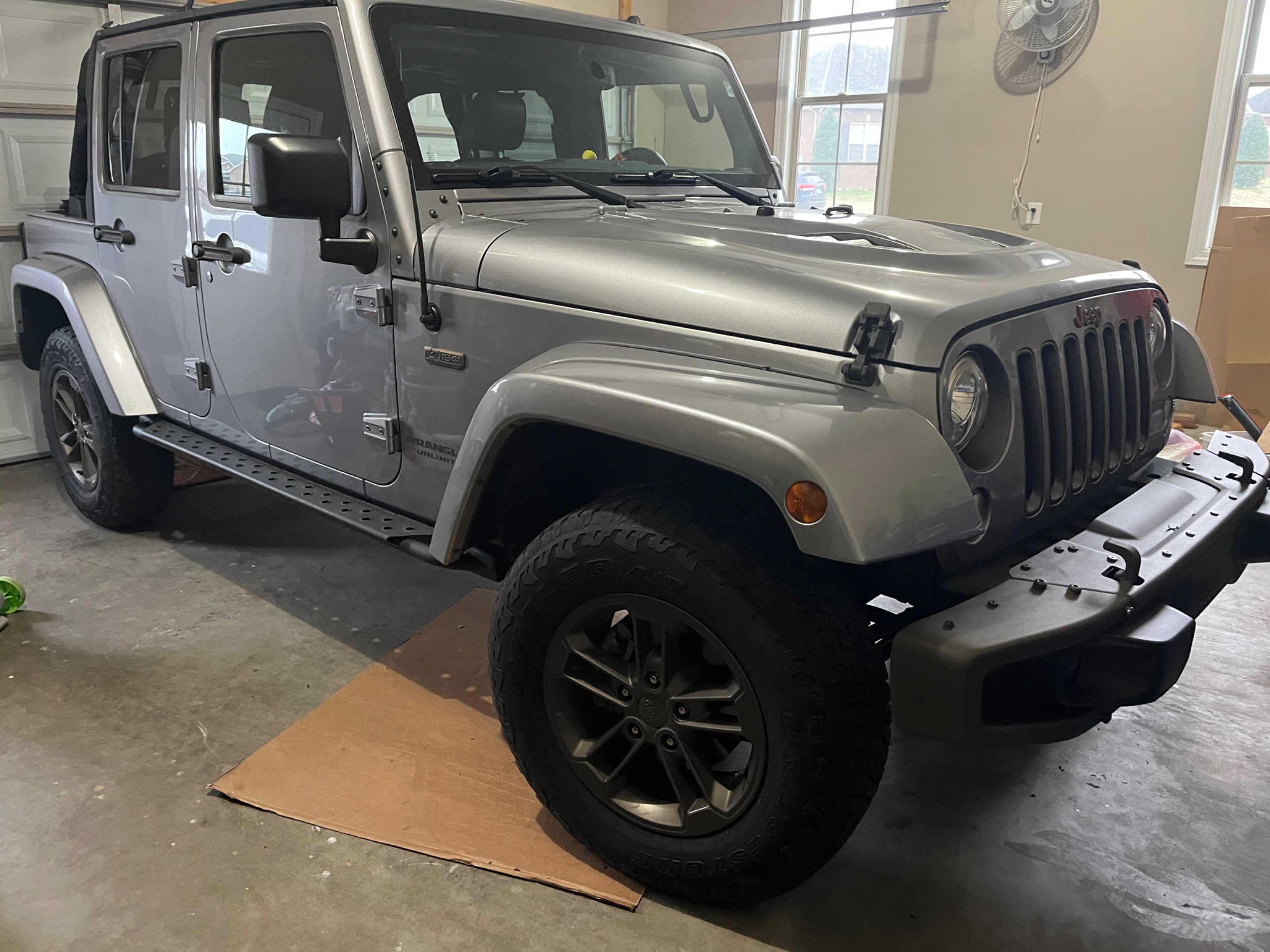

Here ya go. It’s a soccer mom special. Completely untouched.
made a deposit and scheduled my regear to 4.56. I went back and forth between so many different ideas I was getting nowhere slow.
While some say that Dana 30 will fall to pieces the minute it’s used, I’m okay with taking the risk.
Also ordering tires. Going with the Falken AT4W in 35x11.5r17

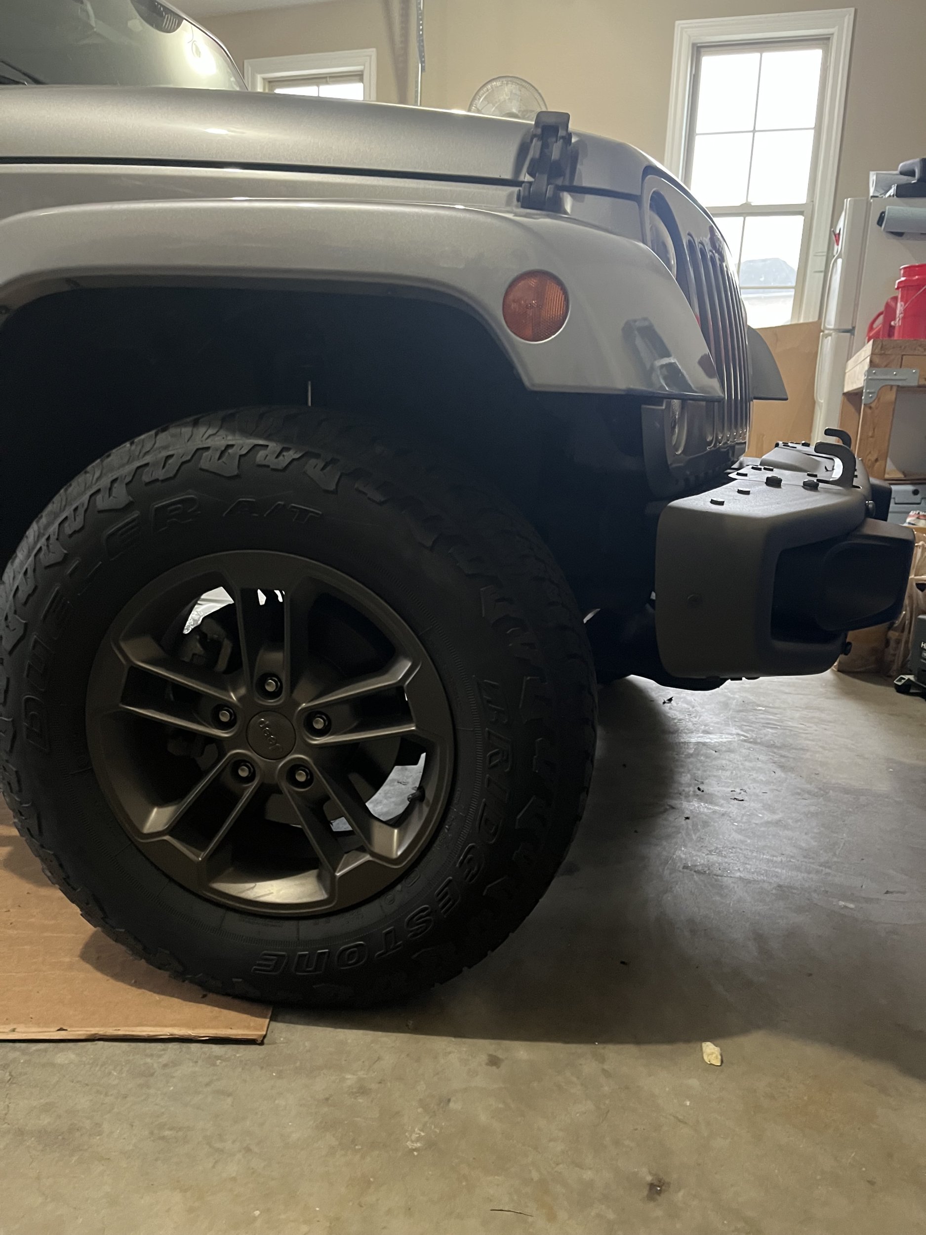

I really like my 75th anniversary bronze wheels so that means I’m stuck with spacers. I don’t like the idea of spacers but I like the wheels and so that’s the tradeoff. I may splurge on some of the Quadratec replicas that have a more friendly backspacing but not today.
No lift yet. Waiting to see what rubs with this before doing anything. I’m thinking the AEV 2” spacer lift. Currently my Jeep has no rake to speak of and all the lift kits seem to have an adjustment for rake. Unless I find a different spring lift solution going to with that spacer lift.
Going to be mall crawl ready by spring.

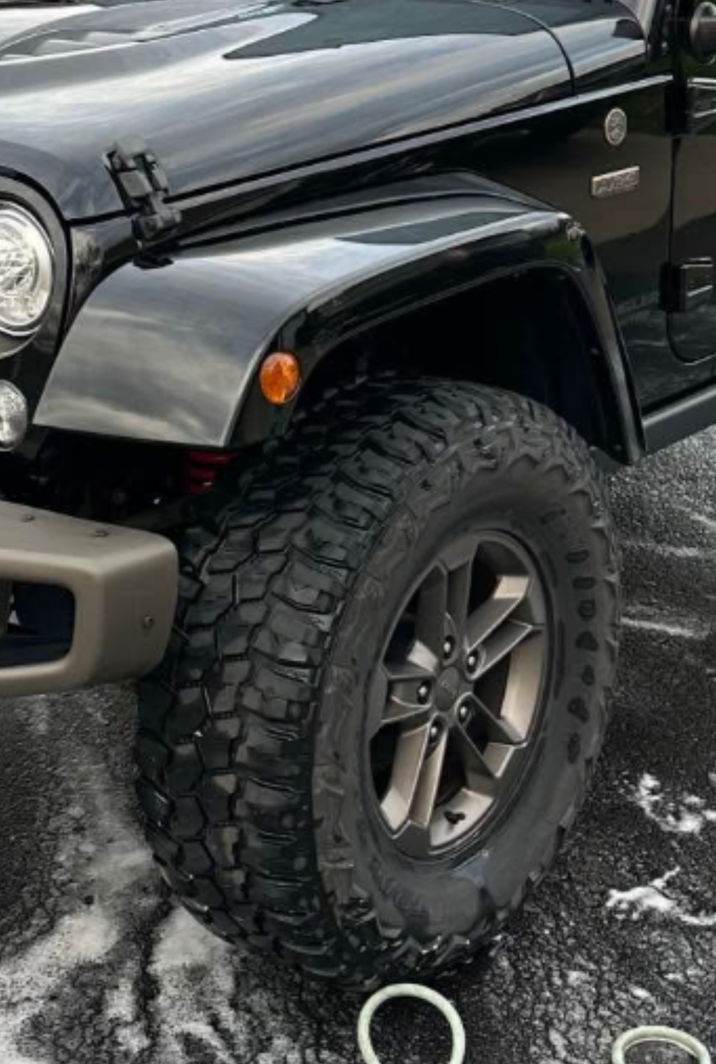

I can't wait to get my 5.13s installed at the end of the month. I'm also going up to 35s with Mickey Thompson Baja Boss ATs. Your wheels look awesome.
