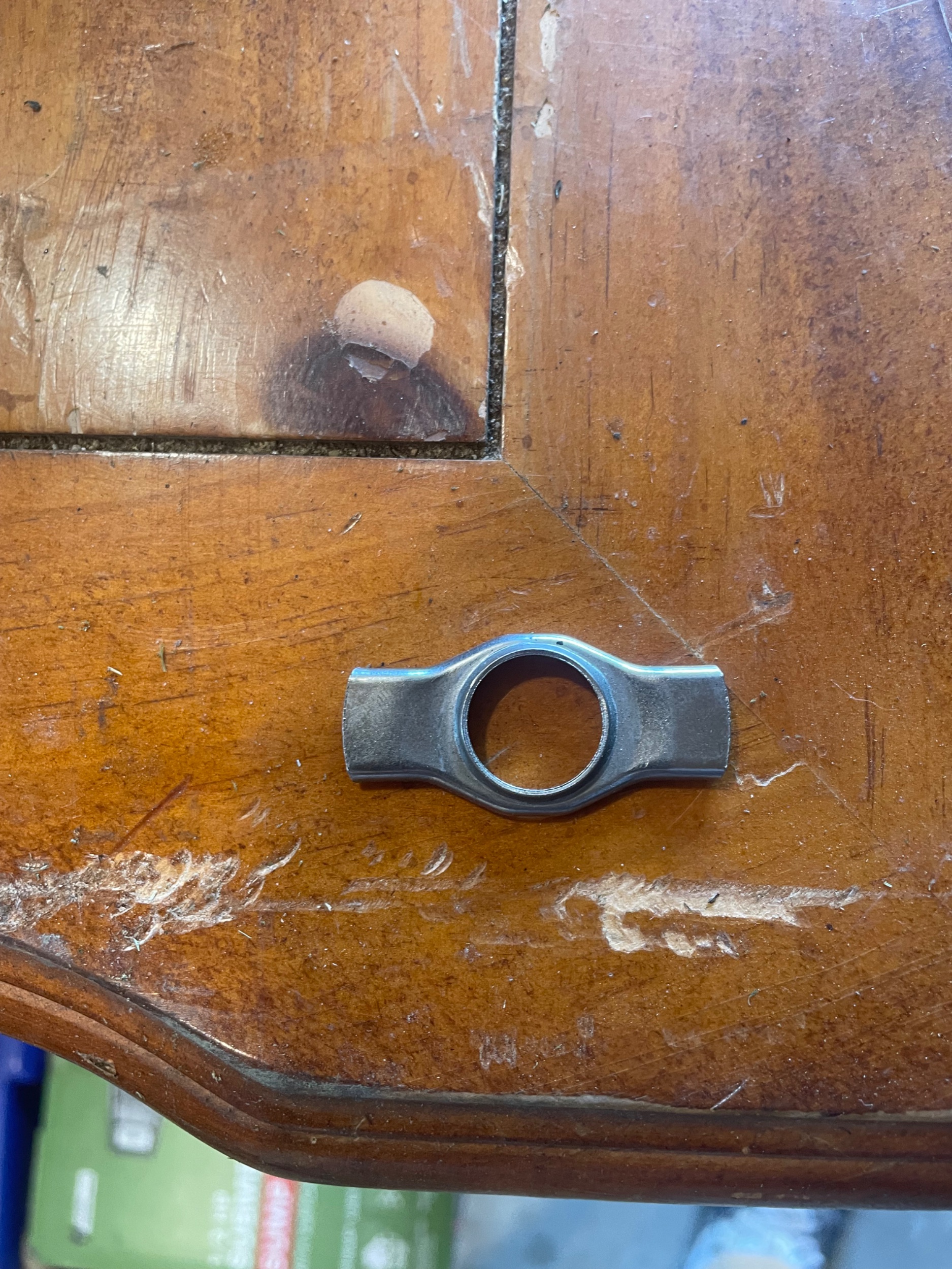

Here’s the guy I found in the radiator

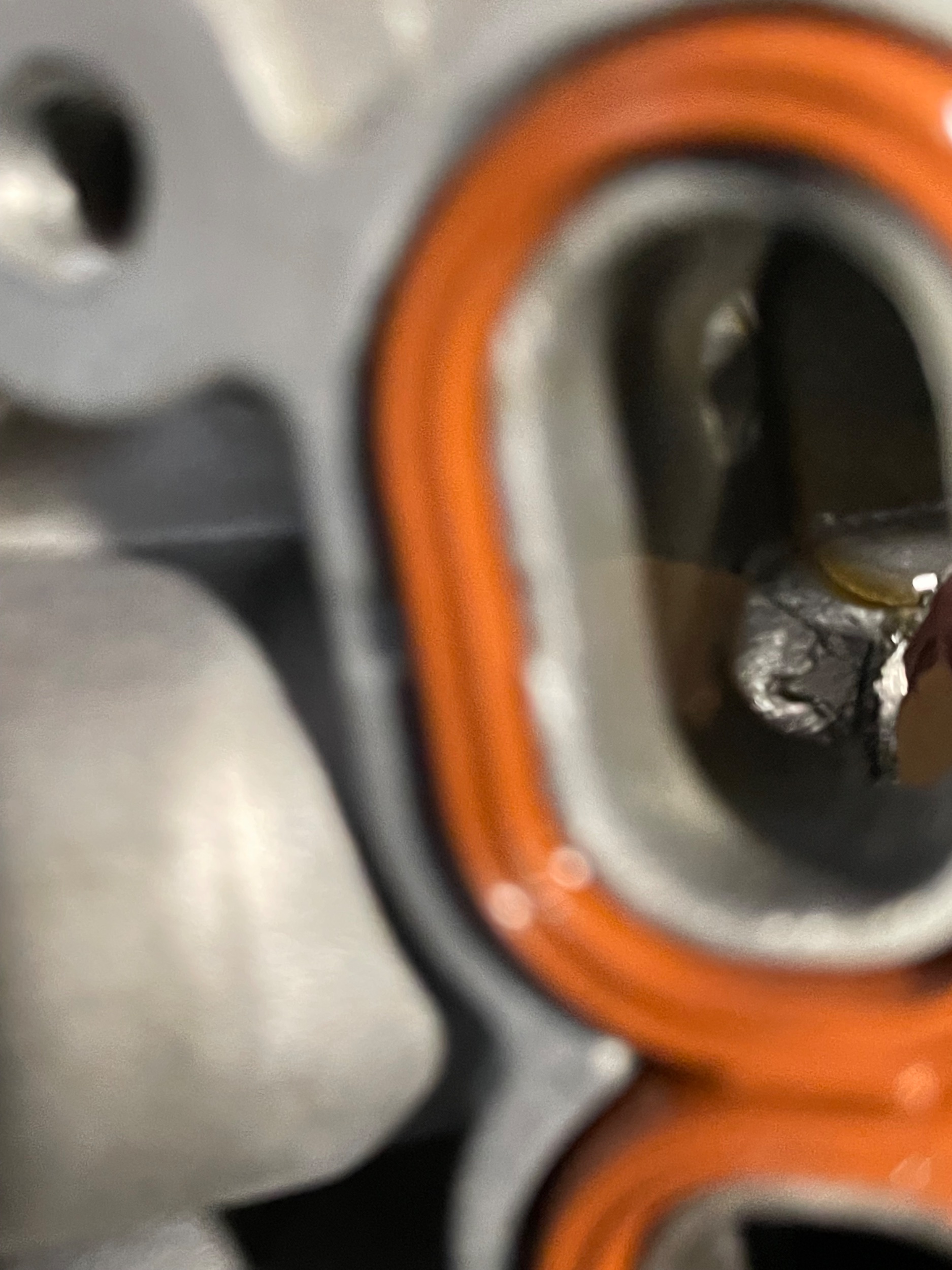

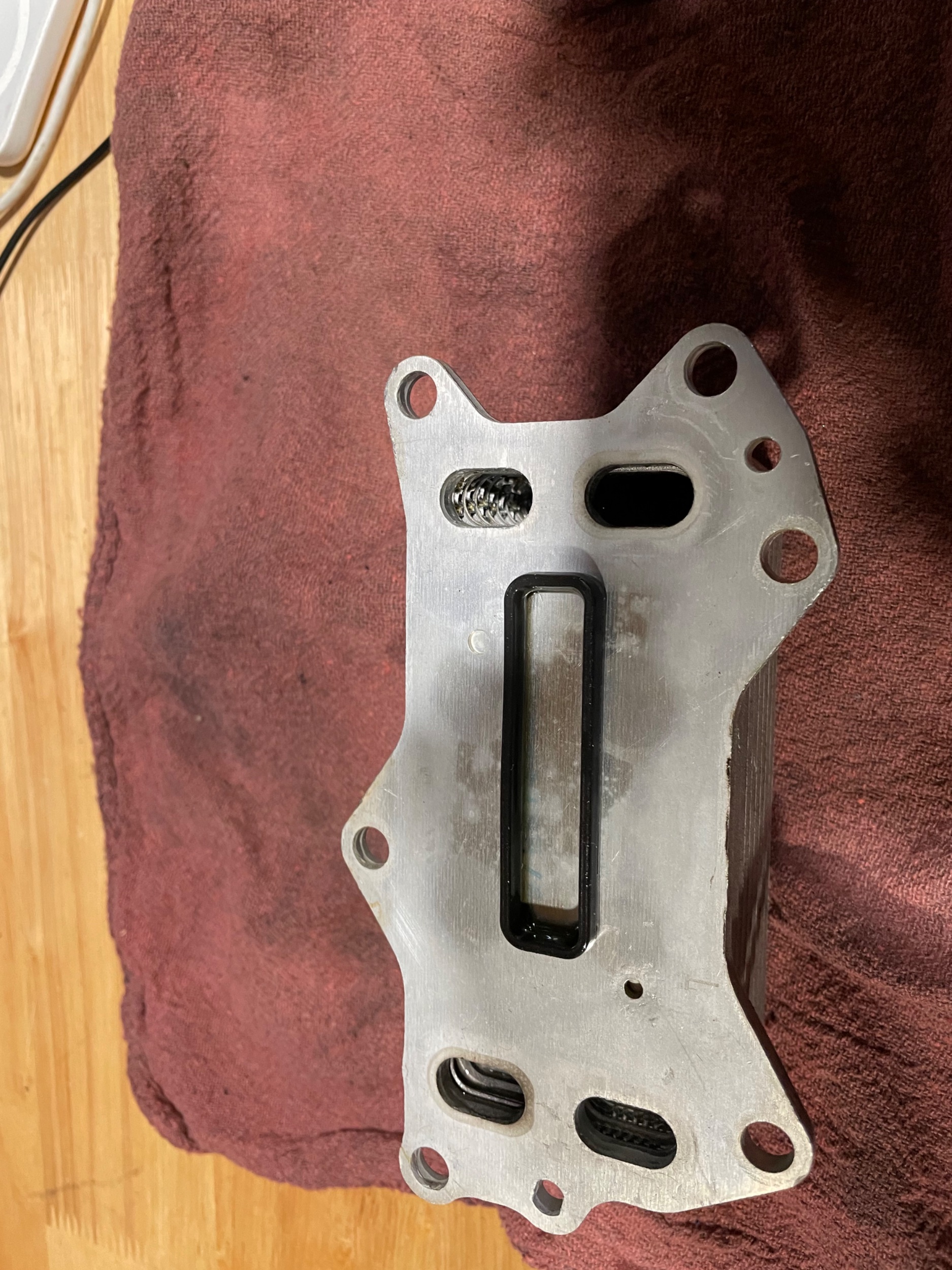

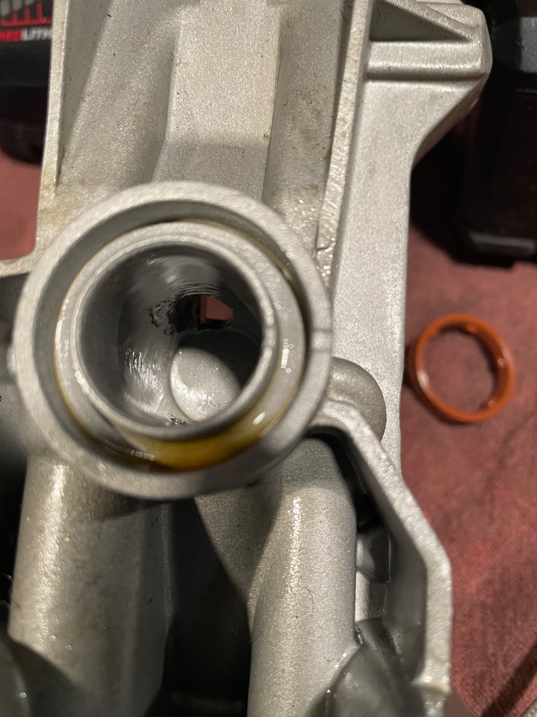

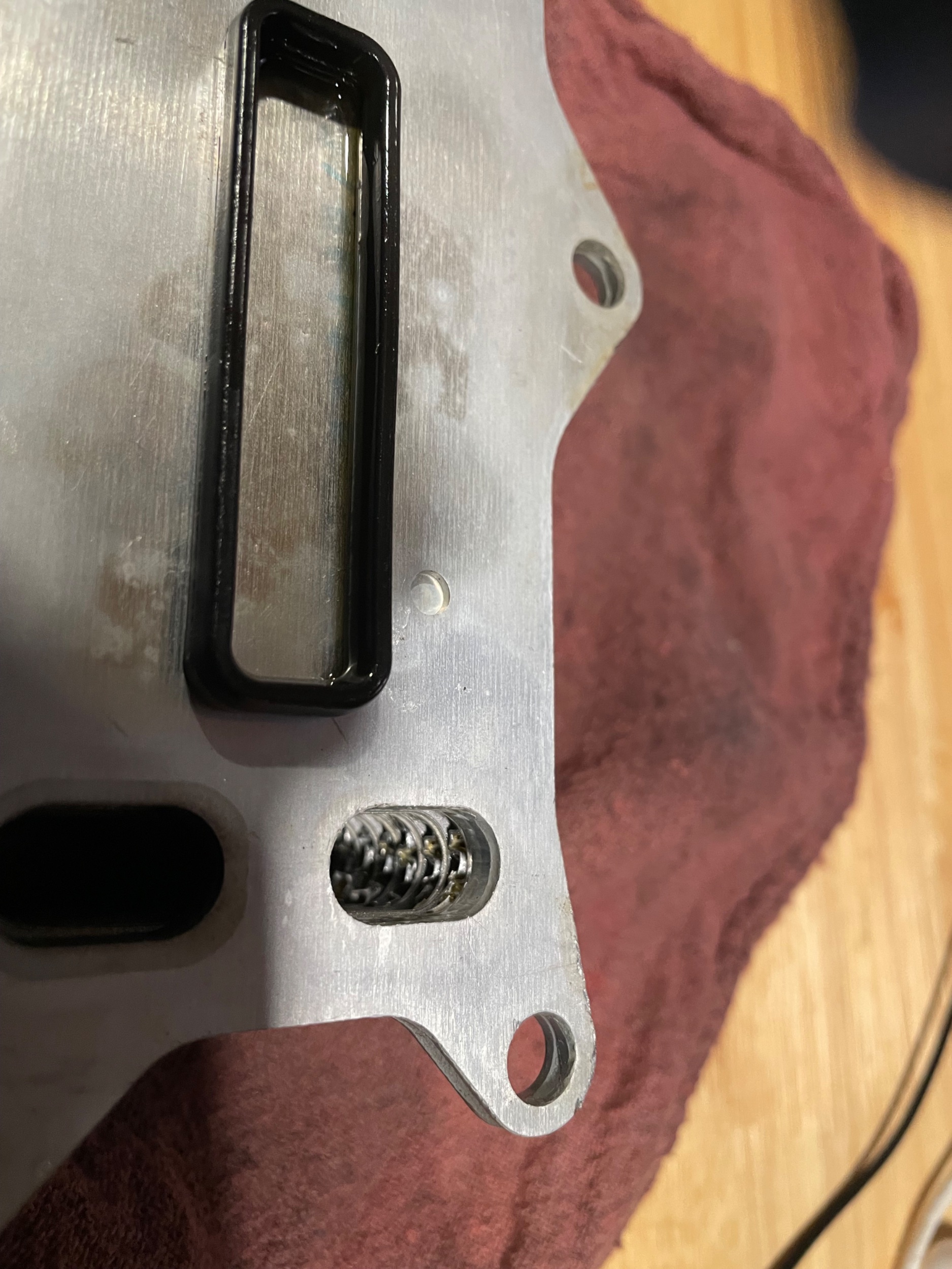

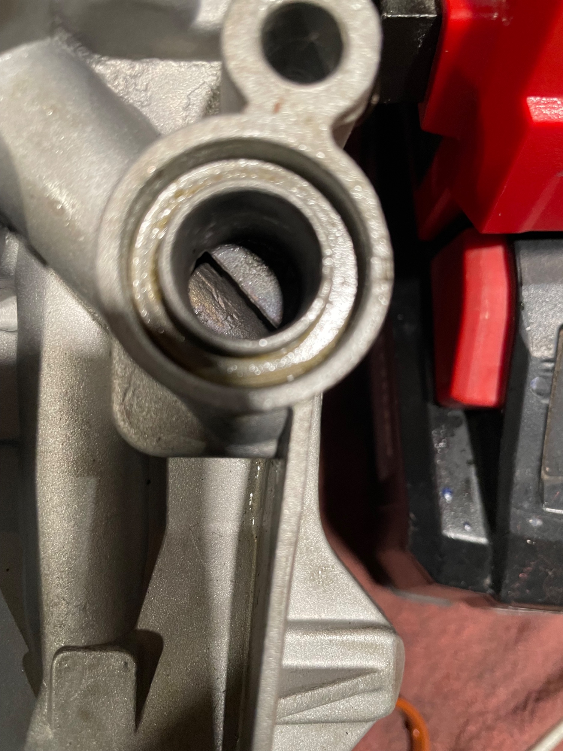

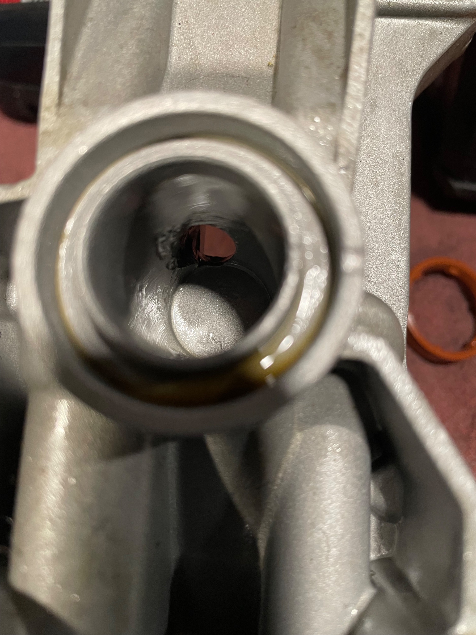

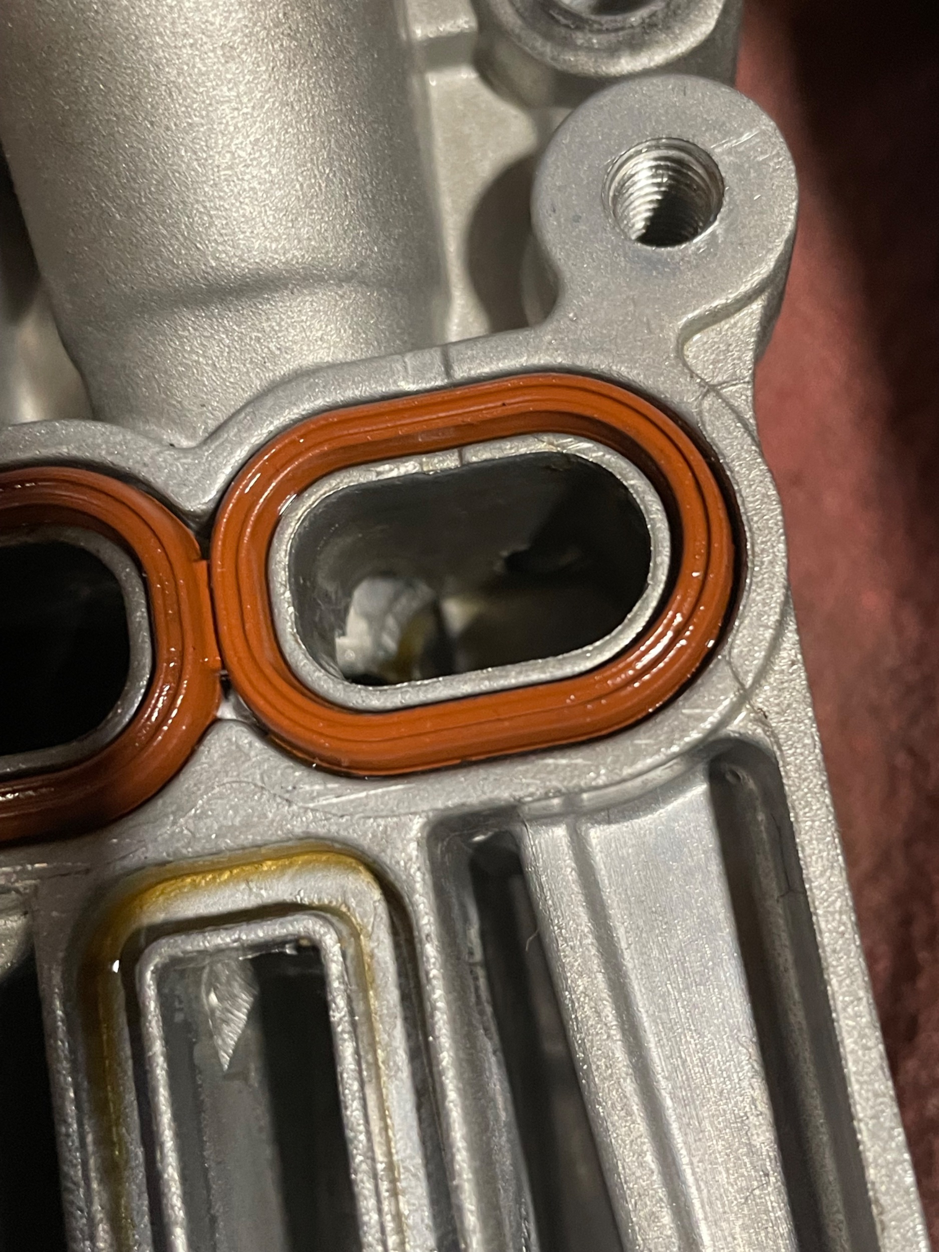

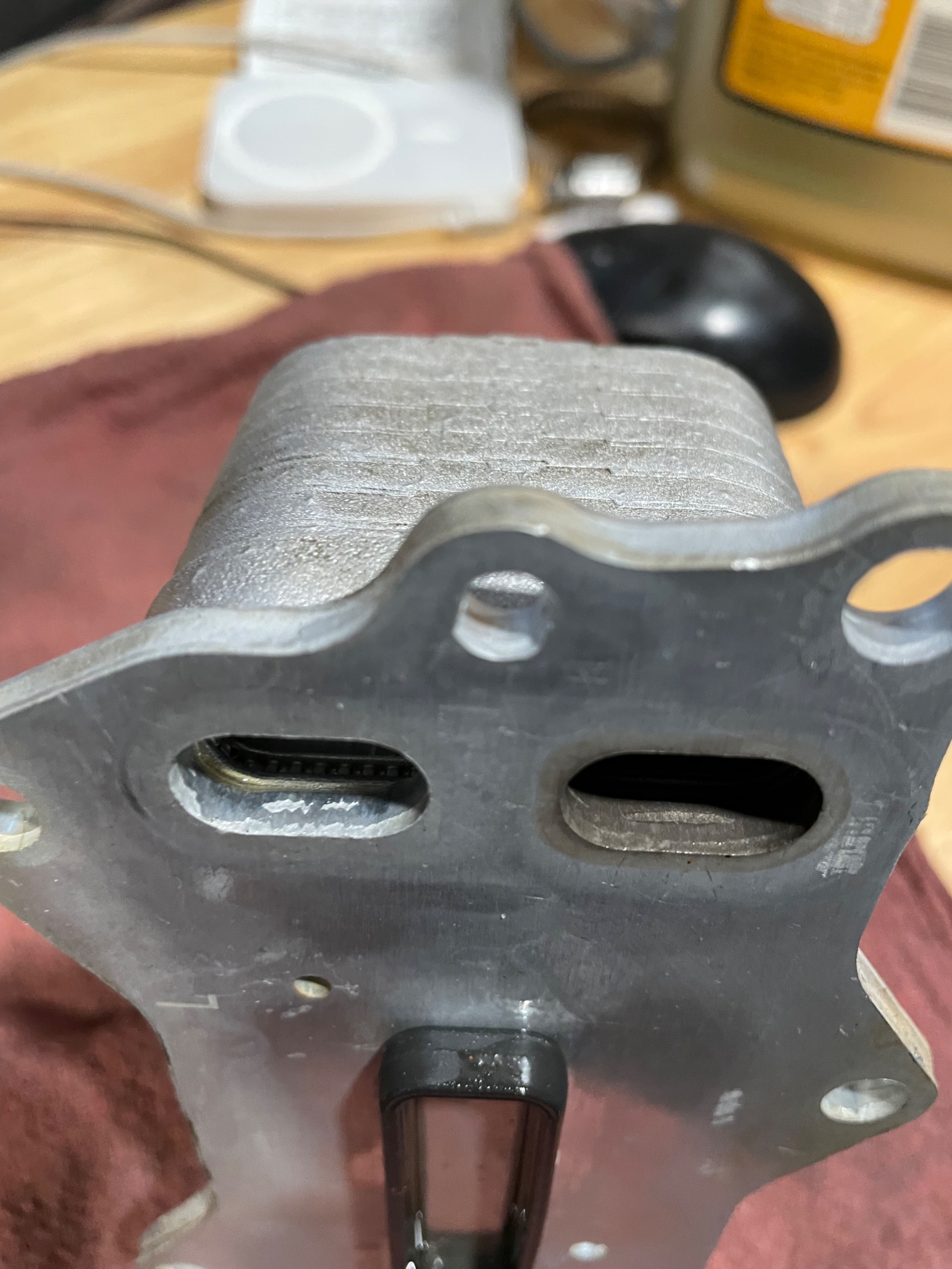

So here are the pictures of the oil cooler. I’m almost a 99% certain it was internal.
There was zero evidence that it had been leaking from the bottom where the gaskets meet the valley. It was bone dry. I believe it was leaking/mixing inside the exchanger itself.
The quality of this cooler is atrocious the machining is next level bad. I ordered the Dorman it should be here next Wednesday. I also ordered the oil pressure sensor and temp sensor, fel-pro intake manifold gaskets and I’ve heard people talk about using mopar gaskets on the Dorman oil cooler; thoughts?
Also anything else I should replace I currently have 58k on the odometer.
Also any tips on getting the oil out of the cooling system and antifreeze out of the oil in the engine would be greatly appreciated!
Fill, cycle, and drain several times. For the oil fill you can add a quart of ATF which has a higher level of detergent in the chemistry and will help to purge the remaining coolant. Drain everything, change the oil filter, add oil and coolant. Drain and repeat. You don't have to run it long the first go through - only let it run 10-15 sec. Second time let the engine come up to temp. When you drain the second time take note of how the oil looks. If there is any hint of a milky consistency you'll have to do it again. I would do the oil at least twice, regardless. The coolant will probably be fine with one cycle, just depends how anal you want to be. Definitely do two on the oil, though!
