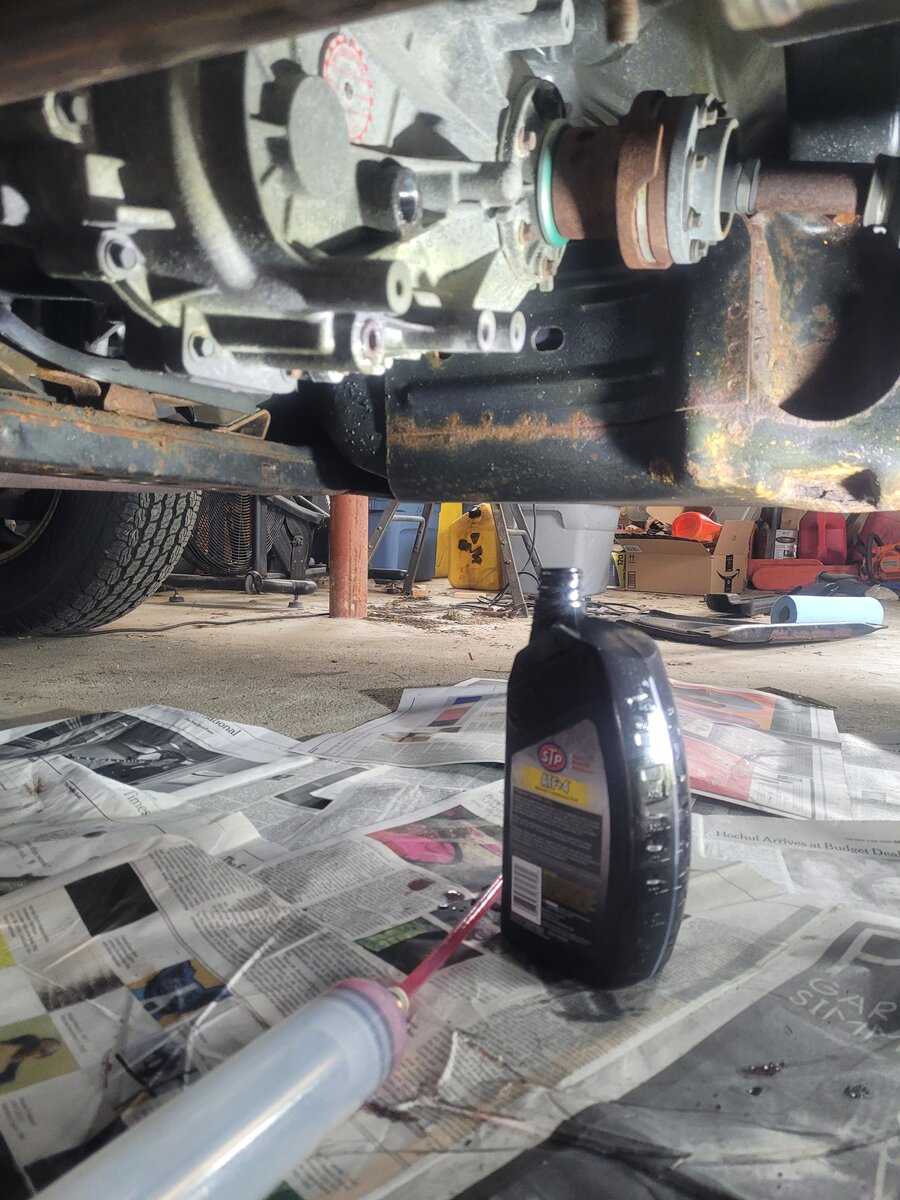

It takes 2 US quarts. Just fill till starts seeping out fill hole.
There is no dipstick or pan on the transfer case .
It is a separate component behind the transmission .
It’s what allows you to use 4WD.
To access drain plug just unbolt 4 screws that hold on skid plate . Gives complete access to drain plug . Also to fill plug . Just make sure you have a tapered fill attachment for your fill bottles otherwise your looking at a mess .

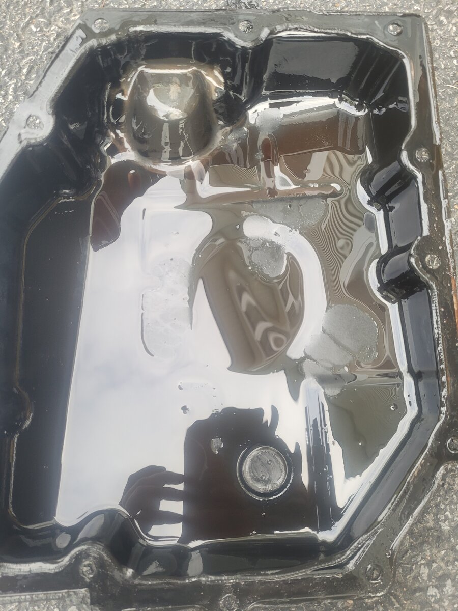

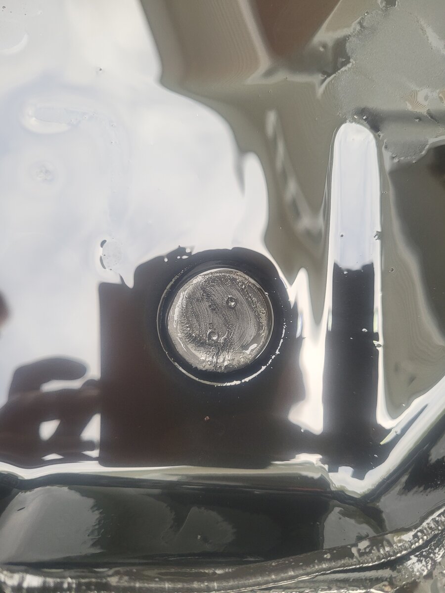

Did my transmission fluid change this weekend finally!! Other than breaking a bolt on the skid plate (had to ask thr local mechanic to get that out for me. I would have died on that hill and he even broke the welded nut getting it out that's how bad it was. ) I changed the transfer case fluid too. Little corrosion on those 2 10mm hex screws which took a little convincing to get out. When removing the pan there wasn't any big curly metal bits just some fuzz on the magnet which I took as a positive sign. But if you're looking on content and advice look up this video
ESPECIALLY the part about jacking up the transfer case to get at the back 3 bolts with the exhaust pipe in the way. I used a long 10mm swivel socket and that did the trick jacking up that section an inch or so. I used lube locker gasket which so far seems to be working great
