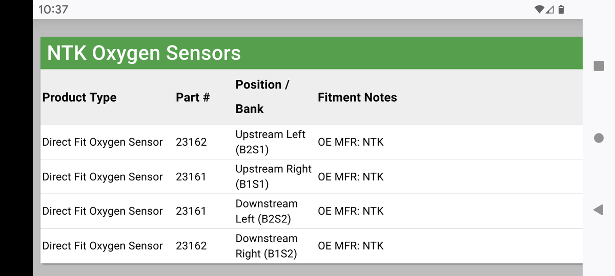

According to Advance Auto's website, the 23161 is able to be used in both up/downstream and right/left. So it's interchangeable. Based on your parts list... this is correct... right? The 23161 is on the up and down and right and left... So why not just use the one part for all four??
2013-2018
NTK #23162 - Upstream Left
NTK #23161 - Upstream Right
NTK #23161 - Downstream Left
NTK #23162 - Downstream Right

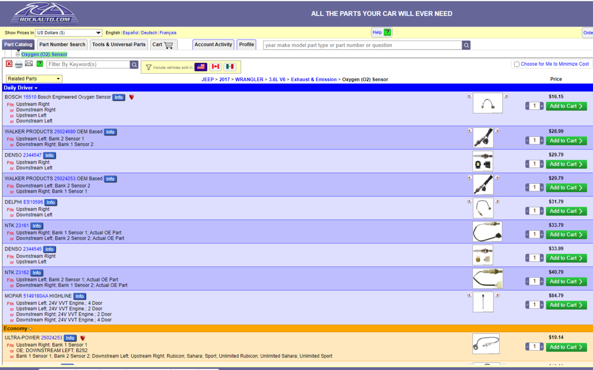

I wouldn't trust the database from advance, AutoZone, even Amazon... (especially Amazon), that's why I linked to the OEM website. The chart below is for a 2016 which is kind of interesting and reinforces what you posted.
This shows a sort of cross compatibility but not an all compatibility. Jks are extremely sensitive to what sensors are used where. I would only go by the Mopar number or the OEM number like above from the ntk site. My opinion, obviously. ;)

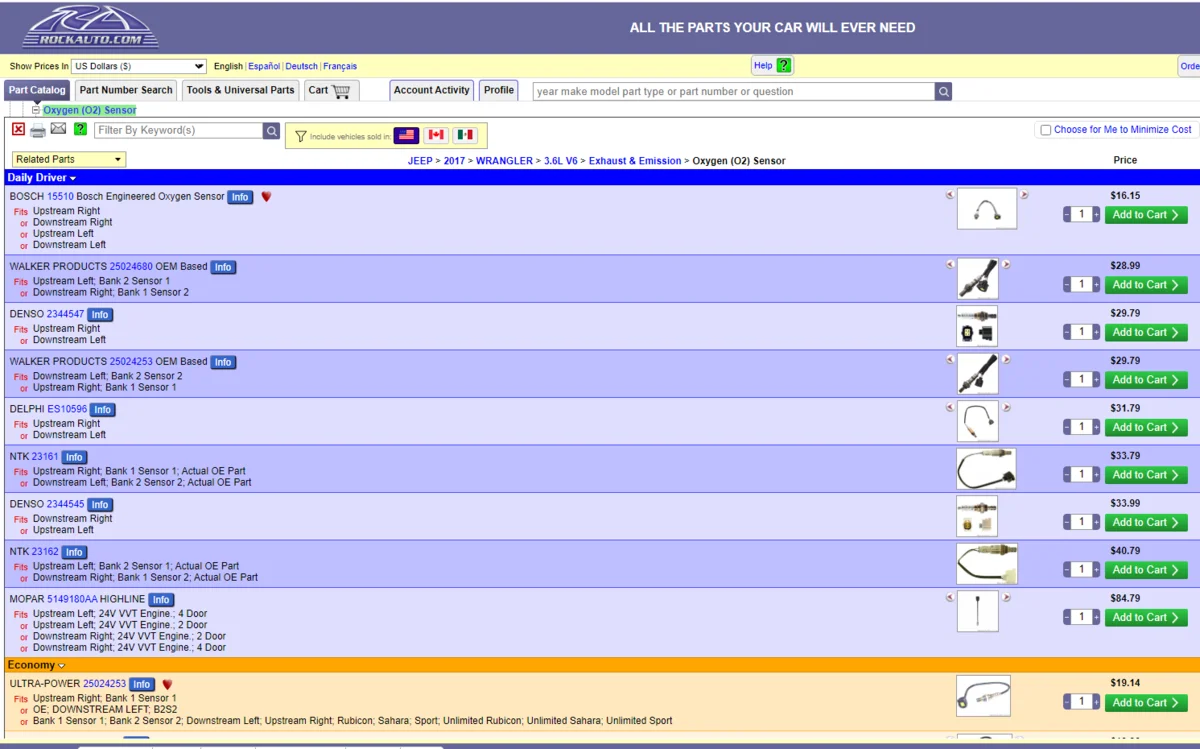

I wouldn't trust the database from advance, AutoZone, even Amazon... ( especially Amazon), that's why I linked to the OEM website. The chart below is for a 2016 which is kind of interesting.View attachment 124607
So what is the difference between the 23161 and 23162?? They appear to be exactly the same part that can fit into the same spaces... So why do I need two different parts? I'm trying to understand why I need to spend MORE if the one part will fit and work the same in all spaces... It doesn't make sense.
2015 Wrangler Sport JK with 133k miles
Reactions: Speartip
Looks like harness length. If you look up those part numbers on the ntk site, and then look at the specs, the 61 is 14 inches in length and the 62 is 10 inches in length. I don't know if there are any electrical differences, but I doubt it. If you are handy with a soldering iron, might work to extend the harness.
Reactions: Speartip
Okay. If that's the only difference then the 14" ought to work all around... right? lol My other car is a 2010 Mini Cooper, I own/operate a goat farm and have a horse boarded and my SO is a fly angler... All expensive things so trying to do things right but as inexpensive as possible is necessary. Thanks for the help
