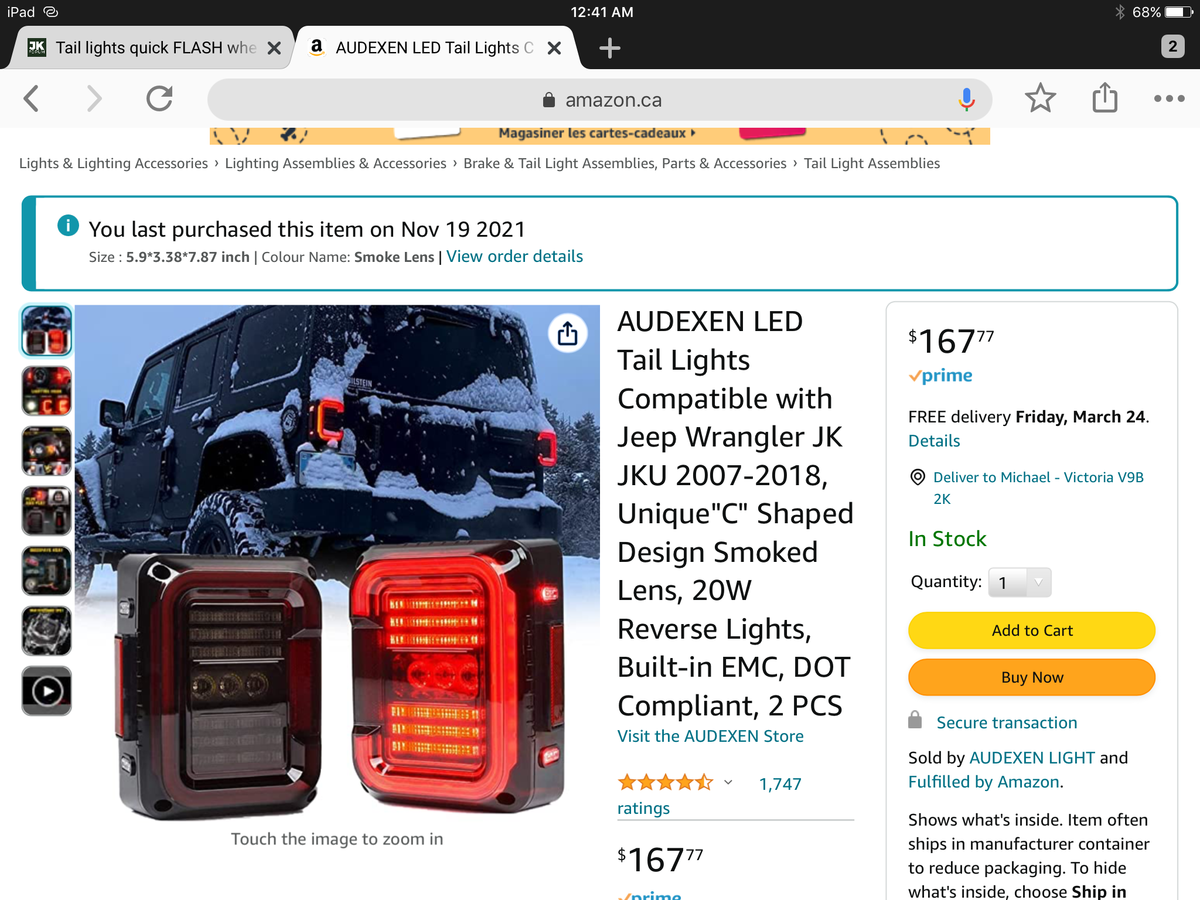

Here are both lights I purchased, tested and do the same flickering (FYI, they both come with built-in or attached resistors which is why they do not hyperflash) :
1. https://www.extremeterrain.com/raxiom-led-tail-lights-smoked-0717-jk.html
2. https://www.amazon.ca/dp/B081RGJSPC/?tag=tjforum-20
I've read that i could get some CANBUS LEDs that simply switch out with the bulbs (i think) but my OEM fixture broke which is why I wanted to switch to LEDs in the first place...

Yeah, these are exactly the ones I am running right now, giving me this issue...
