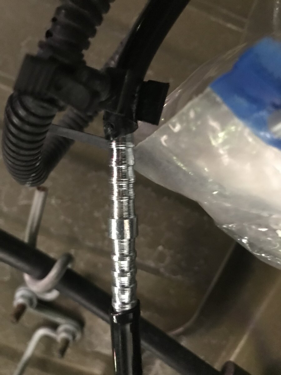

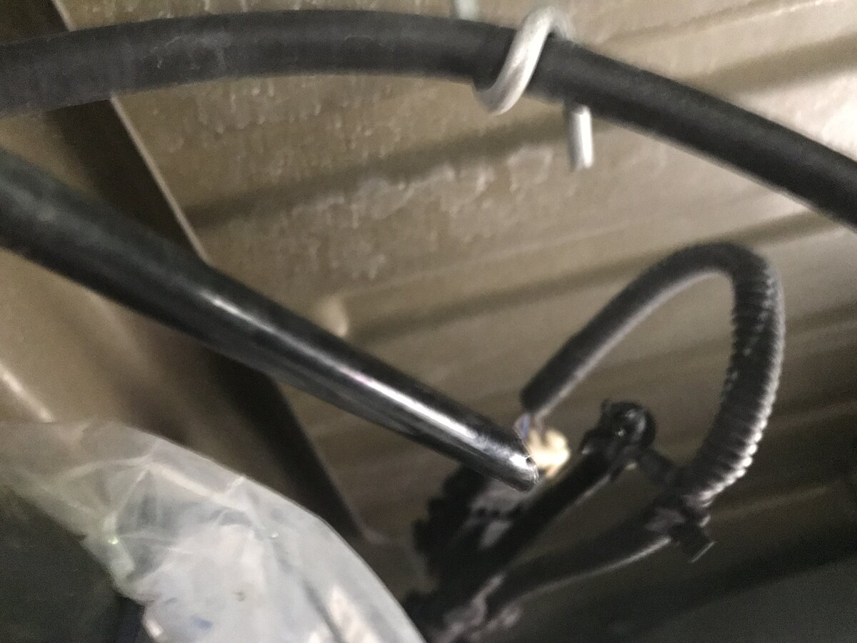

I spliced this hose and it was fine for a while. It just threw a PO 456 code and I’m wondering if the splice is not good enough? I don’t know what the hose is. It’s coming from the gas tank and connects from small hard pipe to plastic pipe with a connection to a manifold then heading up front.
I think I need to replace the entire hose but I don’t know what it is. Help please!!

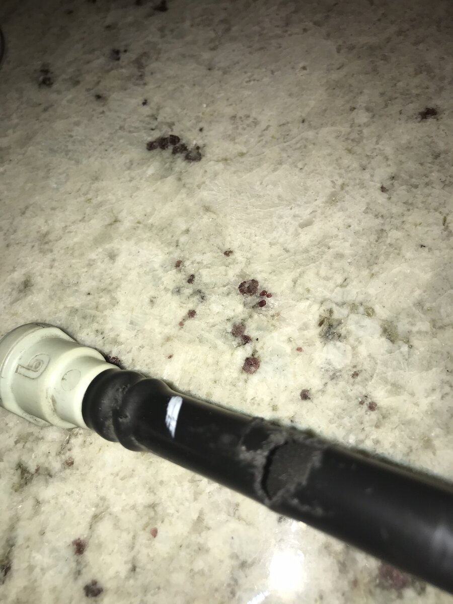

It has not happened to any of my vehicles before but this 2018 wrangler JK Unlimited has had its share of rats or squirrels or whatever destroying the back underneath. Gas line, charcoal canister hose. Gas tank vent hose.

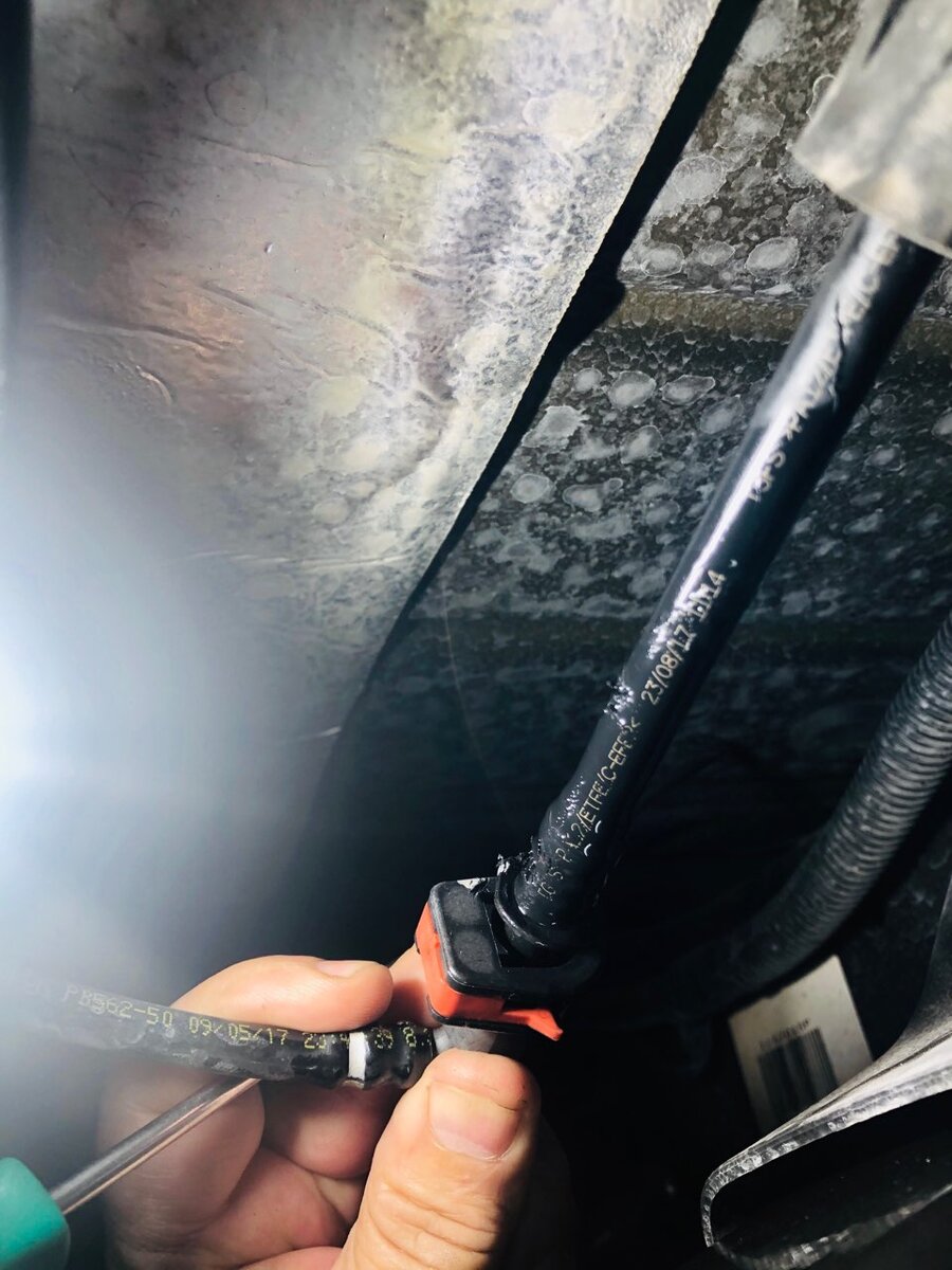

Still trying to find out the exact identification of this hose/tube coming off the gas tank that I have spliced and need to buy and replace. This was the squirrel/rat chewing. I’m attaching 2 pictures.
I answered my own question today when I found the official name of the line.
It’s the : Evap line on fuel filler neck
I ordered one today but will not install until my splice gives way and it throws a code!
