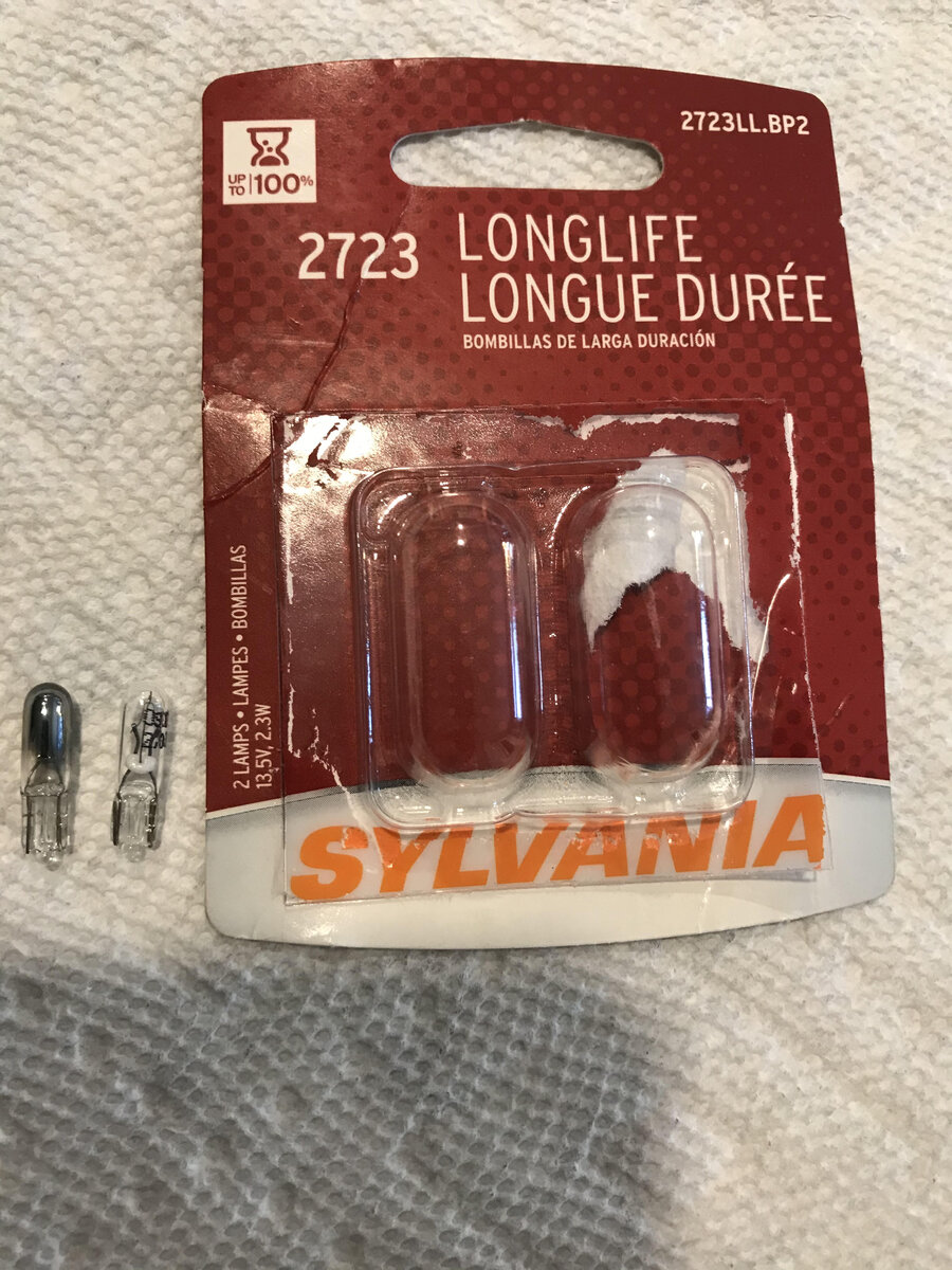

Just did a little research and on the bulb is EWG203 and found that a 658 GE will work. If you could find a LED that would cross over it would last longer. That is if it wouldn't cause problem with the electronics.
Okay, this is the correct bulb for my 2017 Jeep Unlimited Sport. Not sure how many models this fits, so double check your model...
Just make sure when you buy it, get the 2.3 watt, not the similar 1.1 Watt which is actually 0.015 thousandths of an inch larger. It won't fit in the socket...I put my dial caliper on it to verify that.

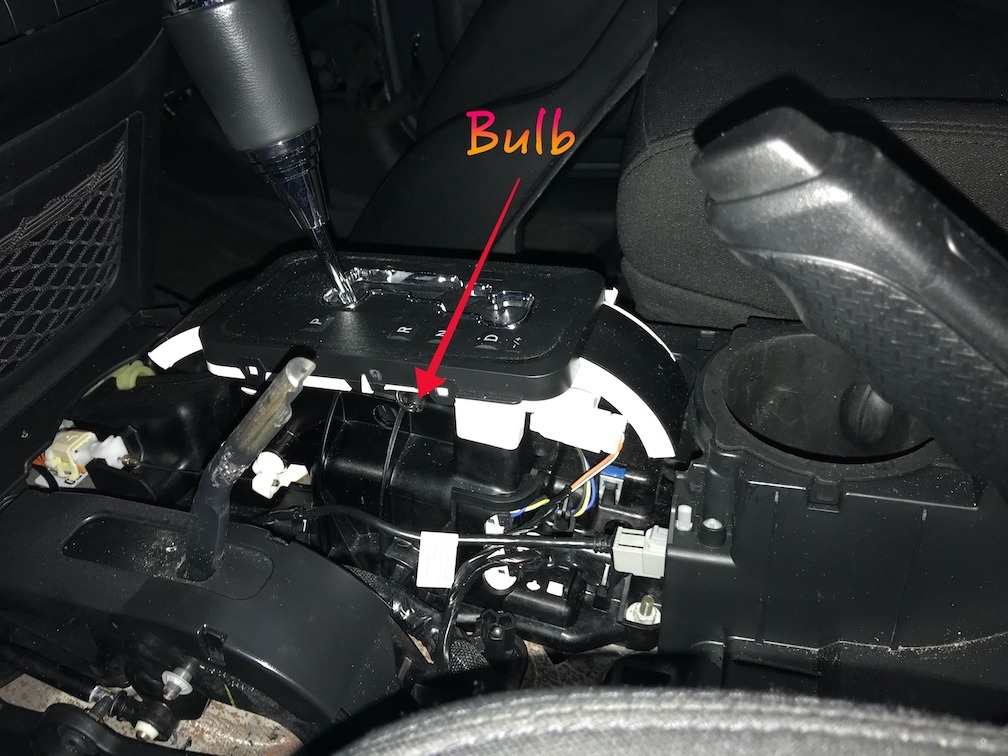

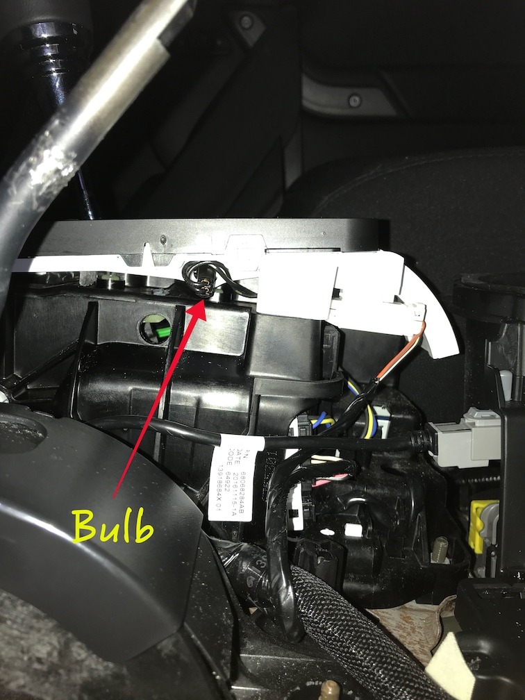

BTW, I got it back in the hole but could not make the twist with one or both hands to lock it on...It is in there and I think the inside of the console itself will hold it in there...But I think I'll just buy another shift knob and rip the other out...I was able to slide the bottom of it down, and used a good plastic/rubber gripping jar opener on it. Pulled the top cap off but the knob is not coming off short of using channel lock pliers on it...! Or I think I'll use my dremmel bits on the bottom of it where it locks to the shaft, add some relief slits...This one is solid, non-slitted, unlike the one in the video.
Finally got the knob off...What did it for me was pulling the shifter all the way to the rear, then I was able to get the proper angle and used my leg as a fulcrum. Pop, off it came, just keep your face back out of the way....;) Takes quite a lot of strength...I should add that the tip of the shaft is shaped sort of like a wide fish hook which protrude out. This is what makes it so hard to get off...! I'm going to change mine out for a Quadratech Knob...

Make sure you pull that shift handle all the way back, so you can get a good angle while pulling on it. It's a bit tough but it will come off...I'm a little guy 6 foot 160 lbs, smaller hands..Even as small as my hands and fingers are, I still could not install the bulb housing. Got it in the hole, but could turn it to lock it in place. Much easier taking the console cover off...!
