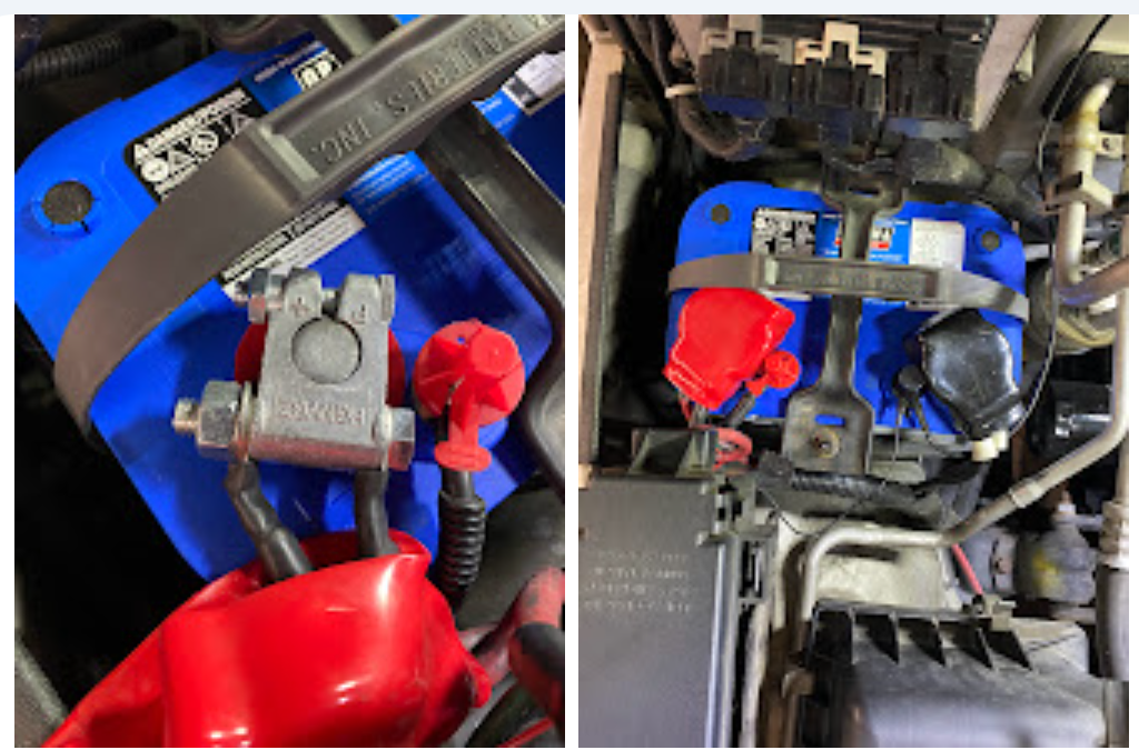

I need to replace my factory battery terminals, as I found out during my winch install that the negative terminal doesn't tighten around the battery post very tight. Plus the issue of not having solid contact with the battery post. I've searched but not found what I'm looking for, so I thought I'd ask those that have done this upgrade to provide the best way to do this. My question is did you cut the two hole bar from the factory battery terminals, or does bending the tabs back on the bottom of the two hole bar release it to be able to bolt it to the new battery terminal? Or is it better to just cut the cables free and install new cable ends on both the negative and positive cables? I do have a hydraulic crimper and battery lugs.

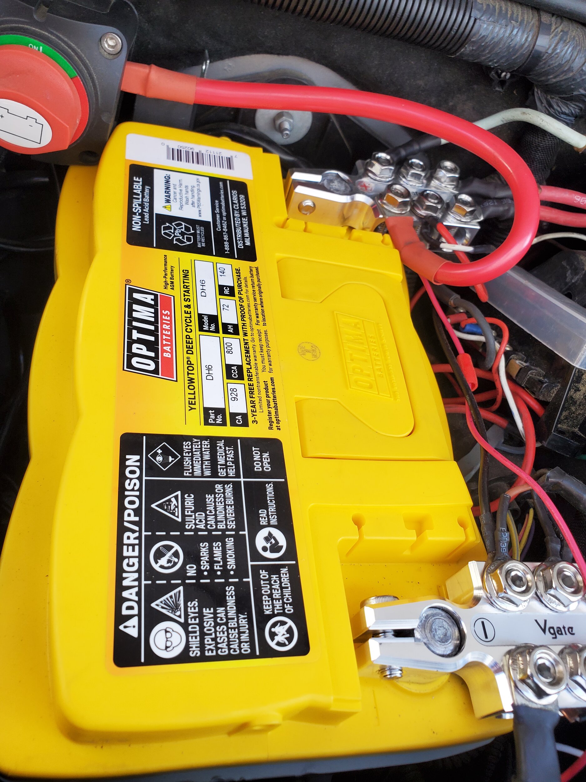

I cut my ends off and crimped on new copper lugs. I also used Vgate terminals. Couldn't be happier with everything.

Looks like time to upgrade the wife’s clamps. Did you get the A12 or the A20? Was there enough cable to install new connectors after cutting the old ones? What size was needed and were you able to simply clamp them on?
I got the A12's. With the positive cable, I cut a slit on the oem clamp that's around the end of the cable. I heated up that end and pried the oem clamp off. This will also separate your positive cable into 2 singles. The negative cable had plenty of room to just cut the oem clamp off at the oem clamp and then install a new lug. I had an assortment of lugs and a lug crimping tool. That made life easier too! The Vgate clamps come with "shims" to fit any battery post. With my Optima battery, I did need 1 "shim" for each post. The Vgate clamps are now stupid tight around the battery posts compared to the OEM ones.

For "extra connections", these clamps work great because the cables are attached using lug-type terminals and they can be arranged on the clamp... And I chose to go with the marine version on the new battery that includes the accessory terminals.
