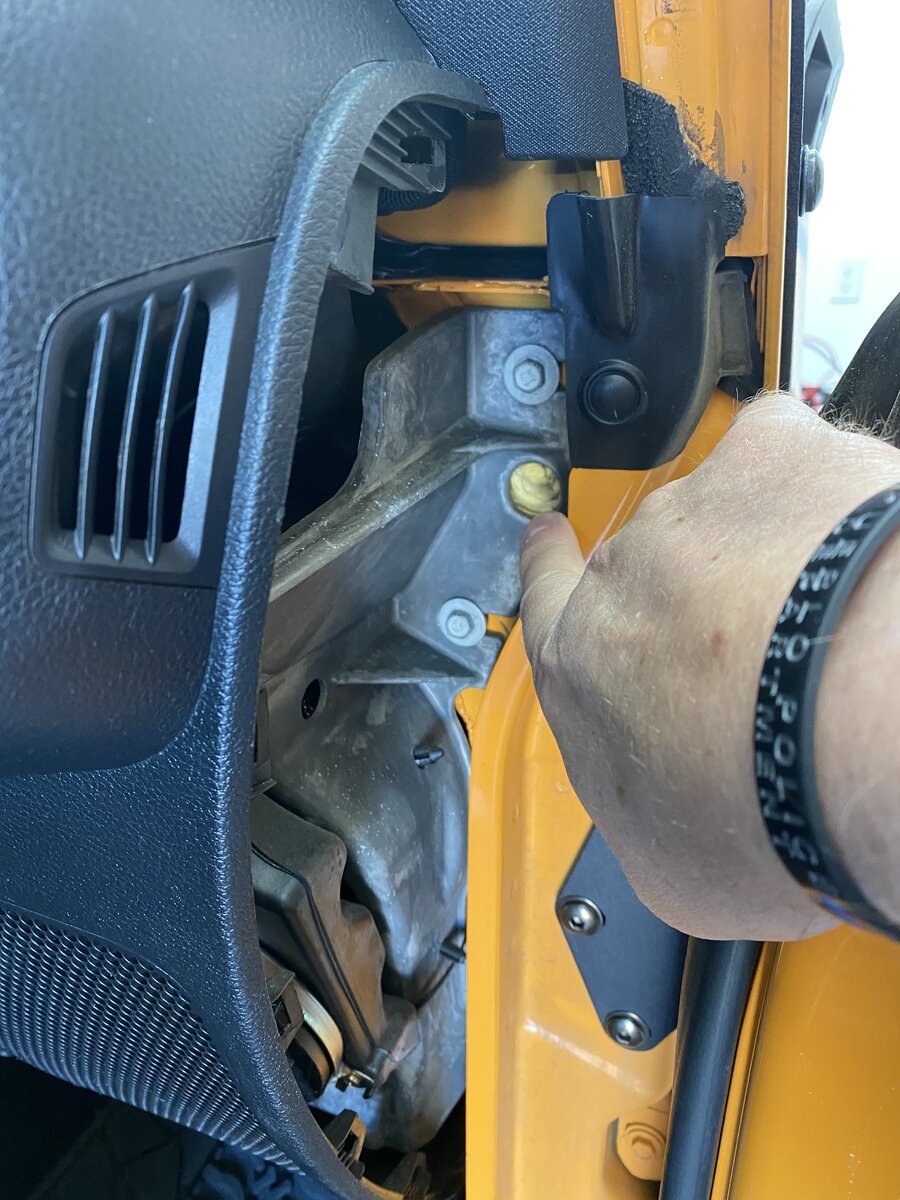

If you remove the side dash panel, you will see a foam-filled passage. This is the passenger side, but it's on both sides. If you stick a rod or some such through this, it comes out right at the top of your battery. I find it a lot more accessible.
Okay that works better. More accessible
