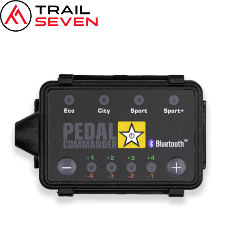

Seriously considering the pedal commander. I picked the Jeep up on Friday morning. Drove it about 8 miles home. Stuck it in the garage, then grabbed the other car and headed to northern Micigan to our cottage. So I haven’t had a lot of time with it yet. From just that 8 mile trip, Im feeling like it needs the pedal commander
Trail7
Nov 6, 2022
9
Frederick, MD
Not a horrible idea at all! ;)
