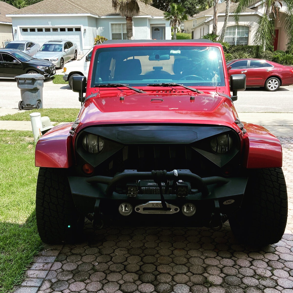

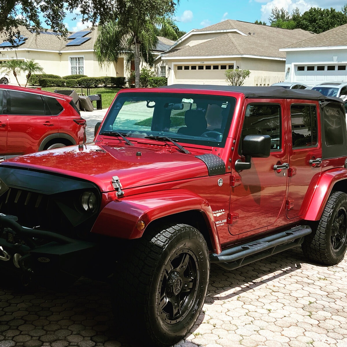

I just purchased my first Jeep a 2012. Previous owner installed new front and rear bumpers, wench, tires and wheels, and according to the dealer a lift kit (doesn’t look lifted to me?).

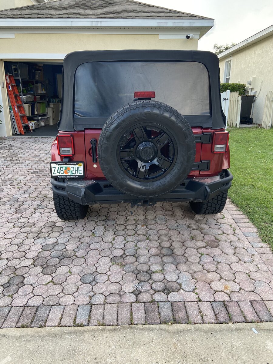

I want to replace the top, as the Velcro on the rear window attachments is not grabbing or holding much (unless there is an easier option) if I replace the top will likely go with a slant back.
I am also thinking about a 4” lift. Haven’t decided on brand but will be mostly for looks (not trying to make a rock crawler) as i won’t see lots of extreme terrain in Florida. Probably will have a shop do the install as it is my primary transportation and need it on the road and don’t want to blow my weekend with the Jeep in pieces. But if the install cost is crazy I’ll do it myself.

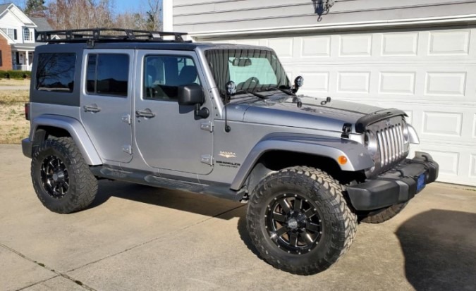

Anyway, that's a good looking JK (not an angry eyes fan) and a minimal lift of 2" or so can be done without a lot of suspension upgrades and you can easily fit a pair of 35s on a 2" lift.
Your Sahara has a 3.73, same as mine. I'm right on the edge of having to regear it due to the wheel size (35) and a 2.5" lift. If you were to go with a 4" and buy bigger shoes, you'd almost certainly need to regear it, which is a fairly substantial investment as well.
Here's mine with a 2.5" lift, to give you some perspective:
