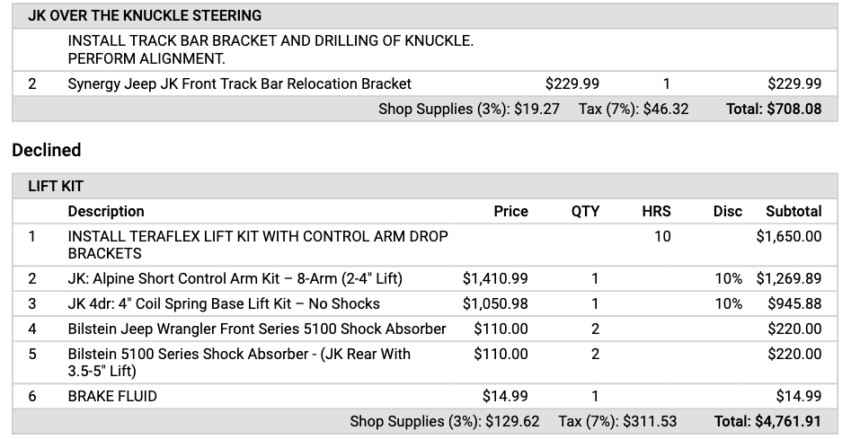

Hi! Looking for some input. I currently have a Pro Comp 2.5" lift in my 2015 JKU that I got back in 2016 a year after I bought my Jeep (budget lift). I'm wanting to upgrade to a 3.5 inch and stuck on which way to go. It's my daily driver and doesn't see much offroad action besides sand, gravel and some washboard roads (I live in South Florida what do you expect?). I want it to be capable of mild to moderate trails, but don't plan on doing any rock climbing or hard core wheeling. Also want to be good on the pavement as I use it to tavel. I did mention the Clayton 3.5" Overland Plus to my shop (trusted hard core Jeepers) which is probably overkill for what I need, and this is what they recommended. How does this setup look (see quote below)? I asked about the steering going to a 4 inch (Teraflex doesn't have 3.5" for JK's) and they mentioned flipping the drag link. This added an extra $700.
The shop first quoted me a Teraflex 3" coil spring base lift kit, front control arm relocation kit, with Bilstein 5100s. This was after me explaining how the Jeep is currently being used and possibilities in the future. Teraflex doesn't have 3.5" for JKs. For some reason the shop really seems to like Teraflex since that's all I've been quoted. But maybe that's all I need. We do a lot of camping which would add weight to the back, plus I have a heavy rear bumper, tire carrier, and 37" spare. I feel that a 3" wouldn't really be a 3" and I would be close to where I am now which doesn't make sense for me to spend the money to look the same.

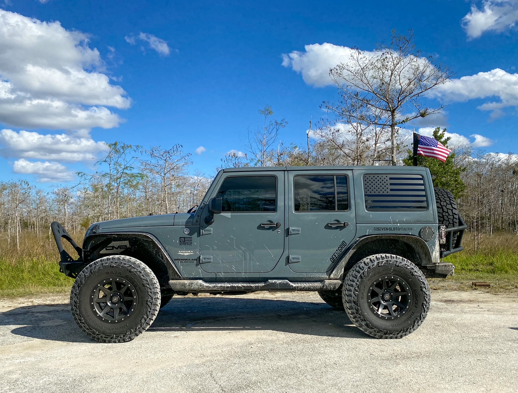

This is what she currently looks like (minus a little sag in rear which is now noticeable)
