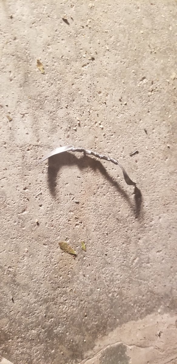

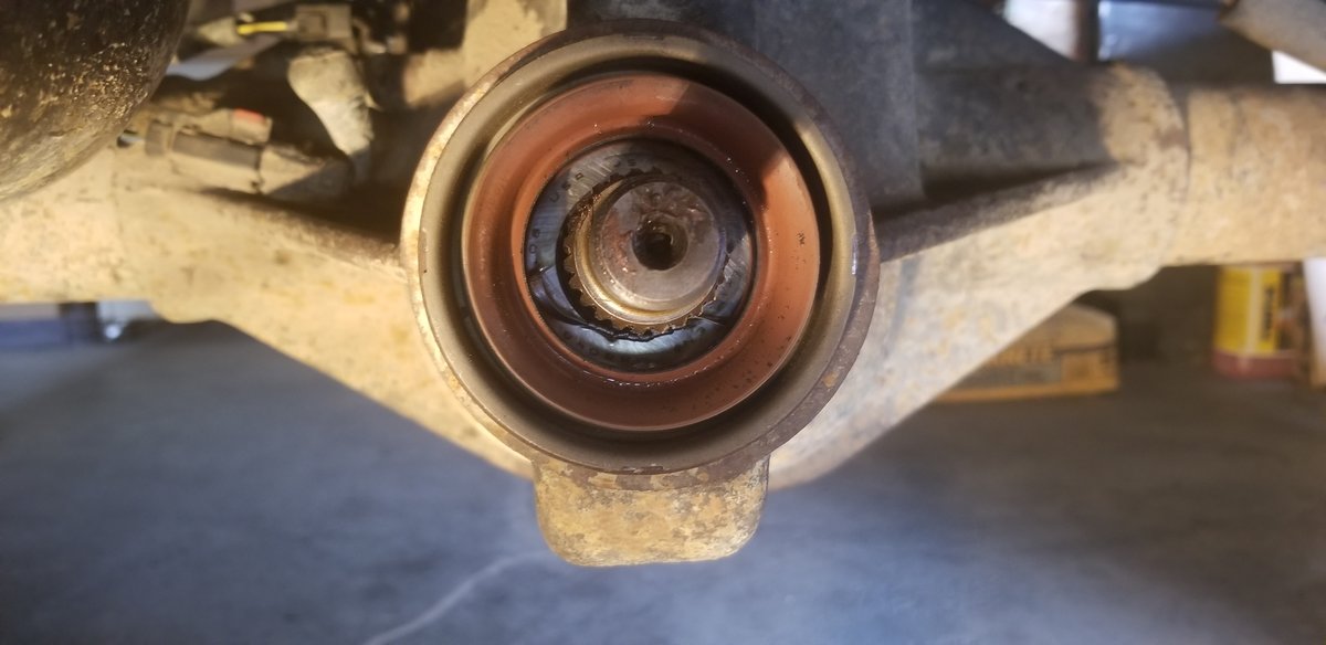

Anyway so now the jeep needs a new rear driveshaft too, well I have lost all confidence in this shop and definitely wont get from them. I order one from somewhere else and proceed to install myself. I am quite handy and have done all the other work on my jeep except the gears. I know its risky changing the yoke but I did it very carefully and followed the instructions to a tee. I even called Adam's driveshaft and talked with them to confirm prior to installing. But when I take old factory yoke off, to my surprise I notice a nice big piece of metal just resting on the pinion (I'll include a picture) that definitely shouldnt be there. So I take lots of pictures, keep the piece of metal, and then finish installing the drive shaft. I figure the jeep still needs a rear driveshaft so I can get back to the shop and I still want to determine if the driveshaft was the cause of the vibration. The new drive shaft drastically improved the vibration to the point I believe all I can feel is the big mud tires.
Since the shop clearly had screwed something else up and the fact that it was about time for the gear check up, I reluctantly decided to bring it back to them.
Of course when I bring it back theres more discrepancies with the invoices that I have to correct, trying to charge me double and yadda yadda, what's new. Anyway unfortunately I forgot to bring in the piece of metal that day and they cant tell what it is from the pics so they say they will just do the gear check up that day and I can bring in the metal piece the next day for them to see. The next comes and they call to say the gear check up is done and everything looks good, I bring in the metal piece and they say it's a Spring seal for the pinion gear and it will leak with out it. At first they try to imply that it was me or someone else but after I politely remind them they were the last ones to touch it, surprisingly they say they will take care of it. So I leave it with them to fix. Now today I got a call from them saying that the preload is all screwed up and I will have to pay for a new install kit and the install again (about $900) and potentially another set of gears. They say they tested the rotational torque and where it should be about 40, it's only 2. They say the bearings and crush sleeve will need replacing. They say the yoke is slightly loose and has a couple thousandths of play it in and if they tighten the pinion nut it will move the pinion away from where they set it. So what I'm wondering is it possible that I didnt tighten the yoke nut quite enough, even though I took all the play out when installing and then went another 1/4 turn past bottom? And then next, if I didnt, would a couple thousandths of play cause the preload to change and change so drastically and cause the pinion bearings to fail so quickly? Requiring another install kit and full reinstall? Or is it more likely that this shop didnt set the preload properly from the start and it was always too loose and are trying to get out of taking any accountability? Based on the fact that they've screwed everything up so far and everytime the jeep was there to have something "fixed", it left with more problems. I have less than zero confidence in this shop's work or word and they have been treating me like an idiot and trying to take advantage of me since the start. Are they doing that now or is there a legitimate possibility of what they are claiming? Also keep In mind the vibration got better with the new driveshaft but didnt go away so another thing I'm wondering is if the vibration wasnt because the pinion or preload was loose from the start and the new driveshaft was just a bandaid masking the actual cause of the issue.
