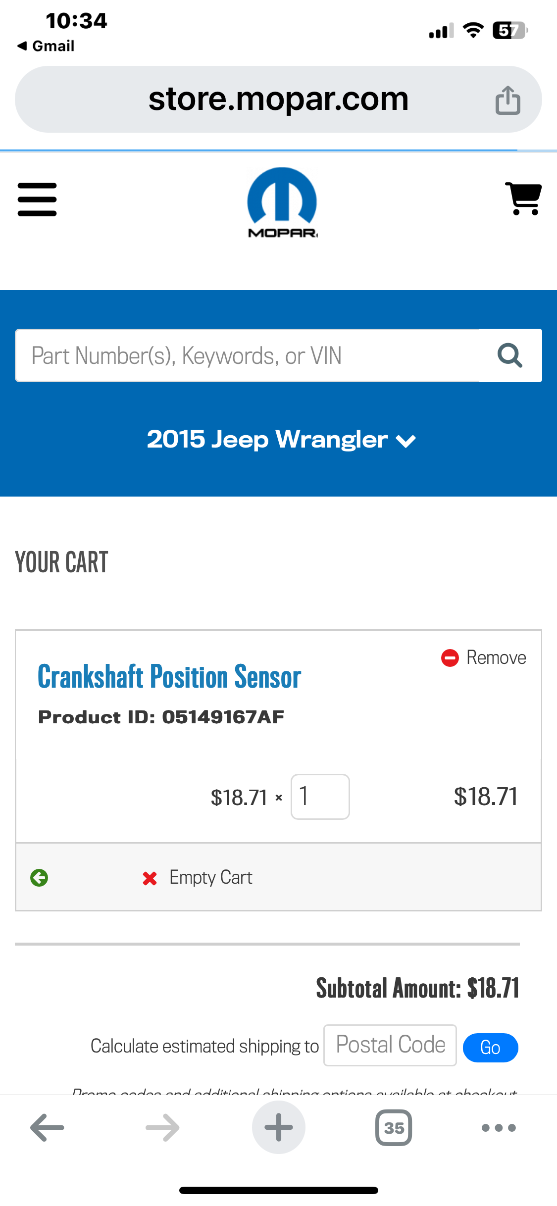

I'm gonna call them and discuss replacing the crank position sensor w/ a MOPAR unit to see if the CEL & codes go away. That's the last thing done and it may be one of the parts that just doesn't have a good aftermarket replacement for. Not much different than an O2 sensor in that regard.
TBH, I'm shocked they didn't mention a transmission service, which is surely due w/ this mileage.
Simply because it is already there, I asked them to provide a cost to replace the CSP sensor w/ a MOPAR unit.
BTW, I can get the MOPAR sensor for under $20, so there’s that.
They did not give me the codes - yet.
I had replaced the CPS a few months ago w/ a Duralast from AutoZone and it seemed to clear up our issues, but it has probably now failed.
