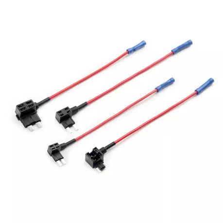

Wire up your DRL wire to that adapter. Find a 15-20 amp fuse. Remove that fuse, but make sure it is a fuse that gets hot when you turn the key on. Then plug the adapter into that fuse location. After that you plug your fuse into the adapter.

I used the wire connectors linked to above. I pulled the fuse, plugged in the connector in that slot then put yhe fuse in that connector. I wired both DRLs into one connector using the buttsplice.

Do you currently have DRL turned on, on your Jeep? Are the DRL on your new light a halo? I've used these in the past to add a wire to my fuse box.
