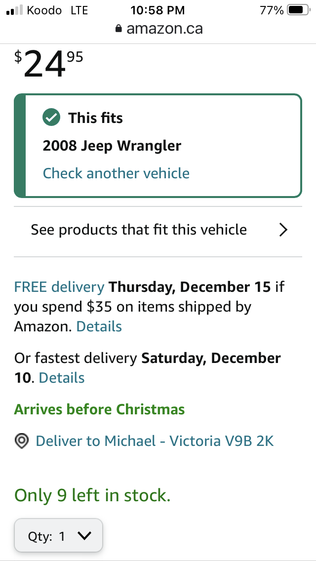

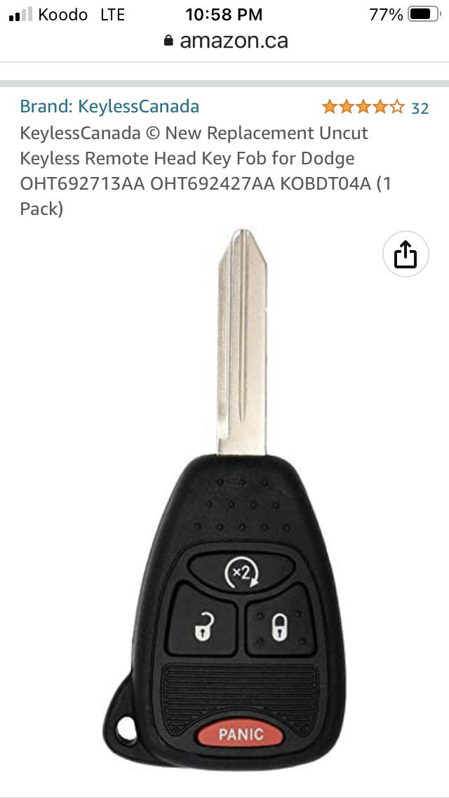

This is the key I purchased in Oct. Lock , Unlock , Auto Start all works . The range is impressive . Haven’t had to replace battery yet . It’s my understanding some fobs go threw batteries fast . Not this one .
Auto start hold 3 buttons down with thumb and BAM starts up .
It’s actually very easy to program using JSCAN . Takes maybe 5 mins , tops .
