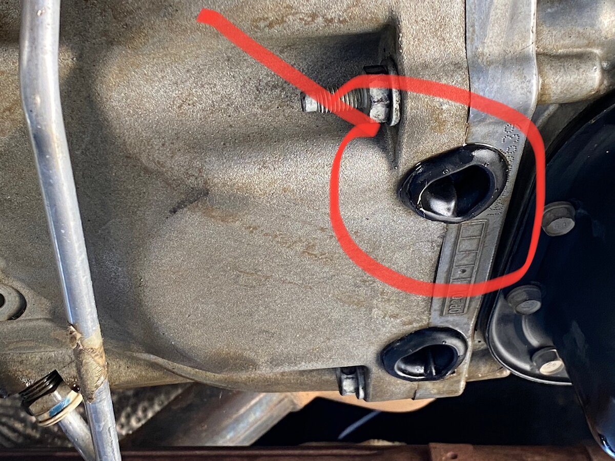

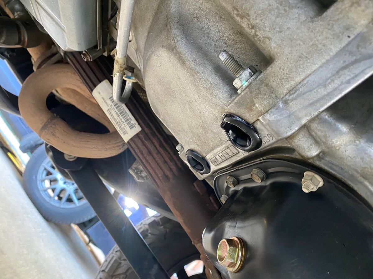

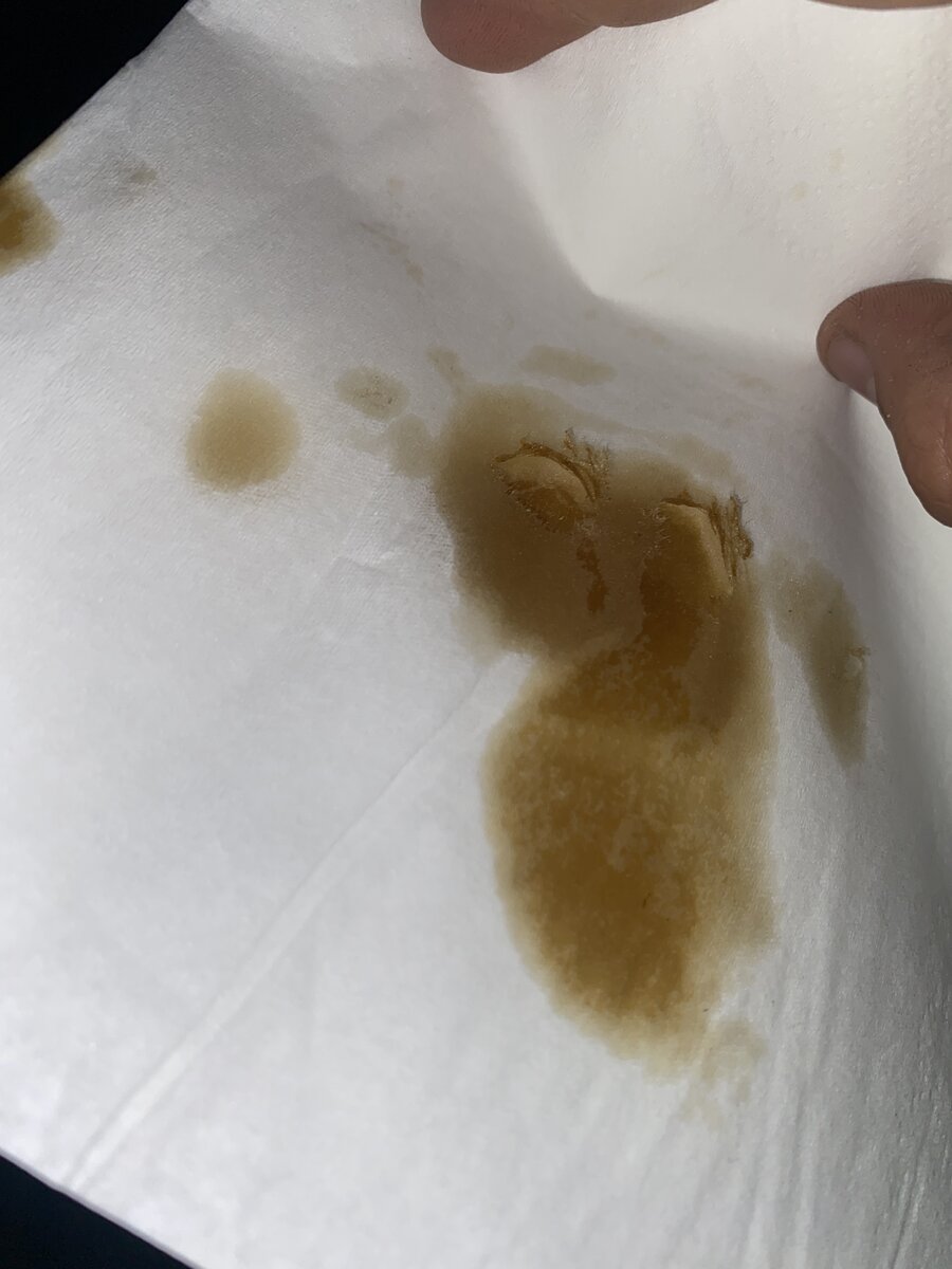

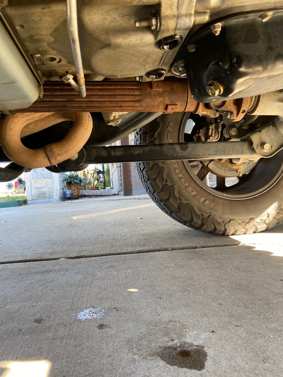

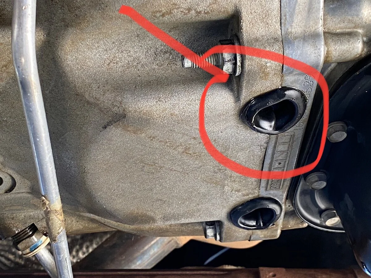

I see you have a auto trans, next time it leaves a spot on the cement take a paper towel and try to soak as much into it as possible and then look to see what color the oil is. Or even try to get some on the towel from the bellhousing area.
BLACKJKU
Moderator
Lifetime Supporting Member
Feb 22, 2020
3,925
Huntington In
Looks like engine oil. I hate to say this but looks like the only way to find out will be to pull the trans back to see where it looks like it's coming from.

We have done everything we can until we get more info about the jeep, my guess at this point would be a main seal if the oil is coming from the inspection holes.
