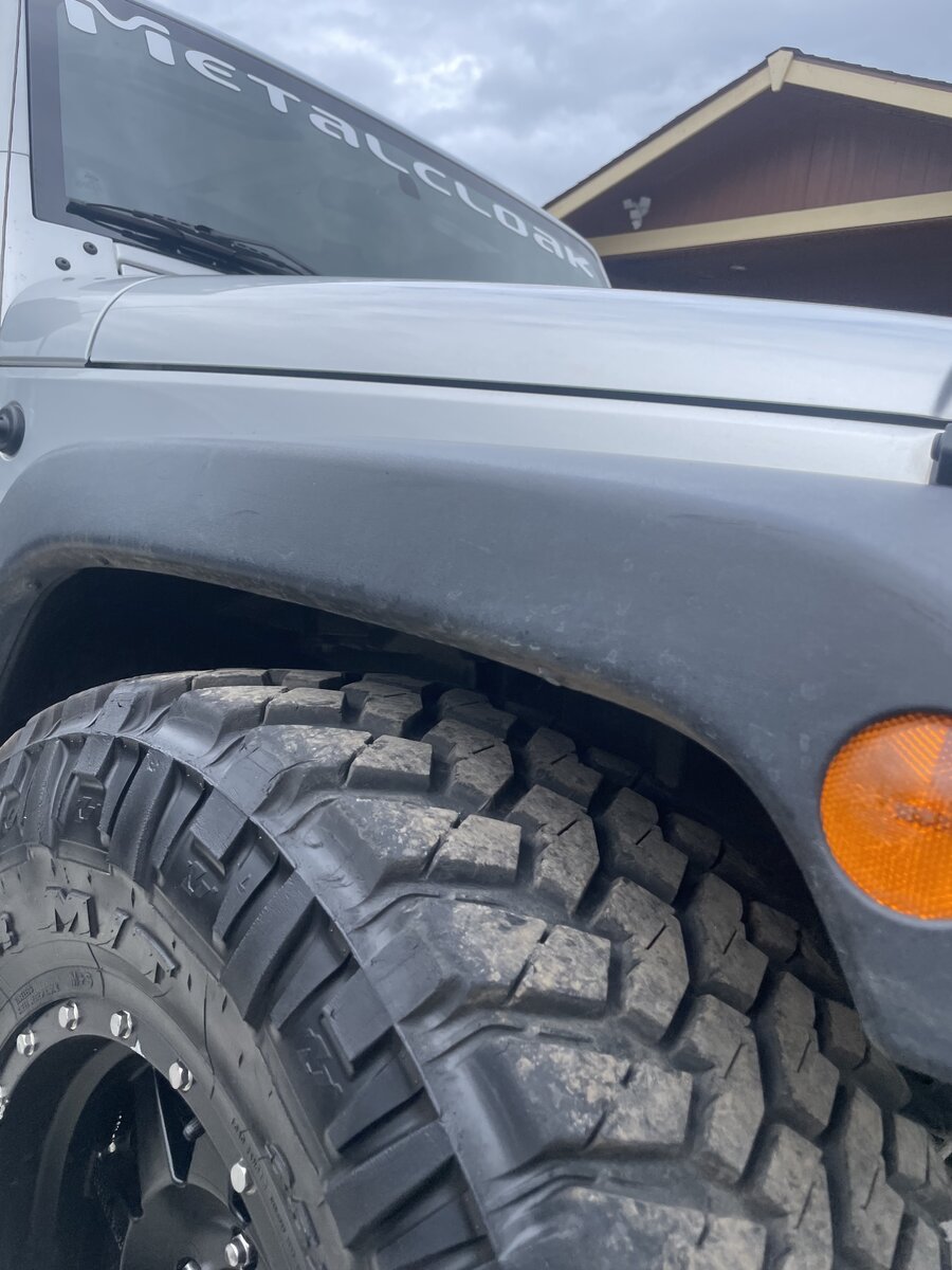

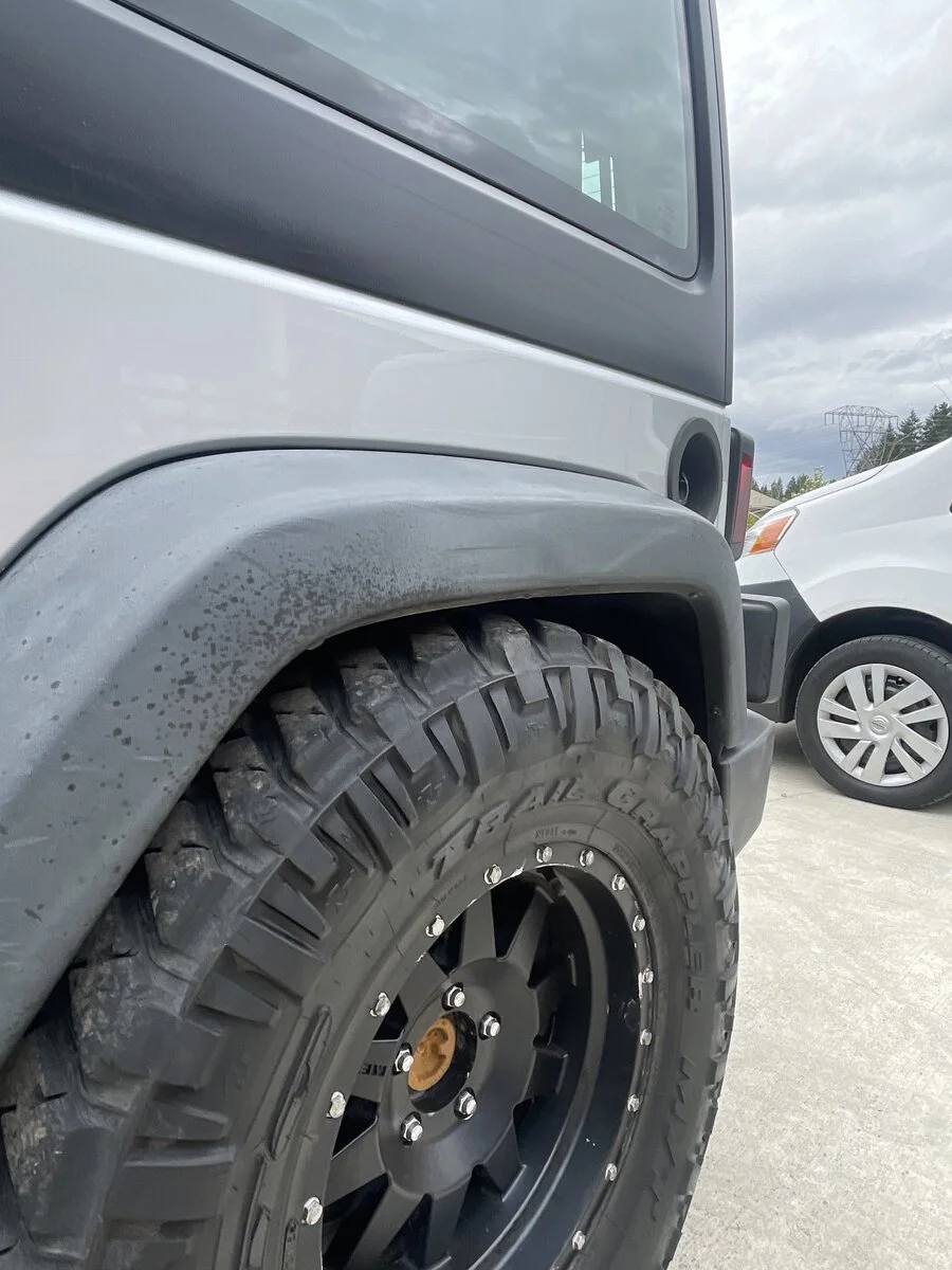

Big Giant UPDATE:

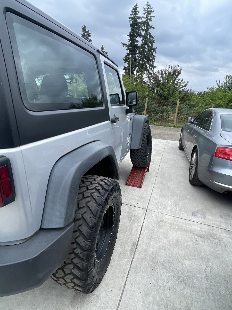

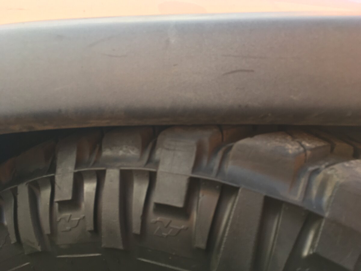

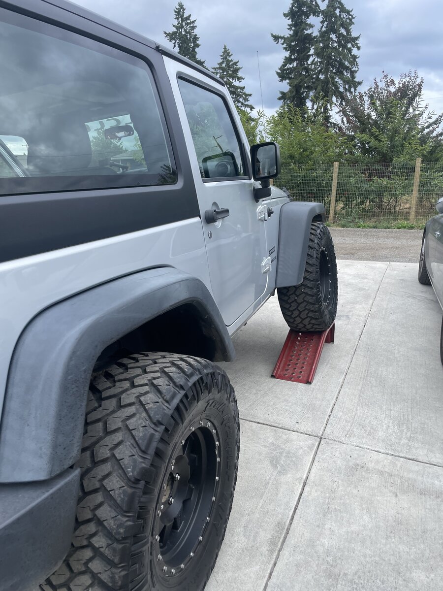

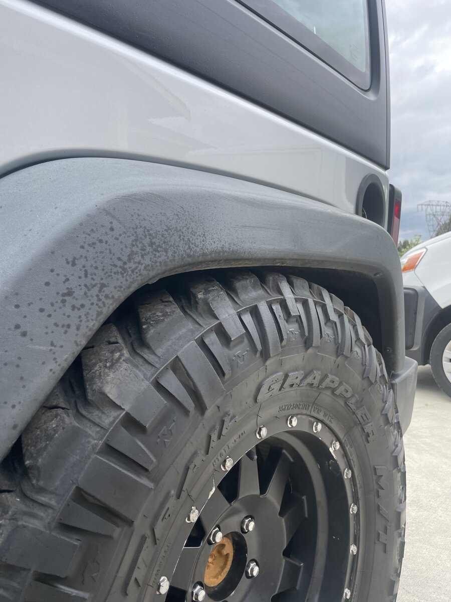

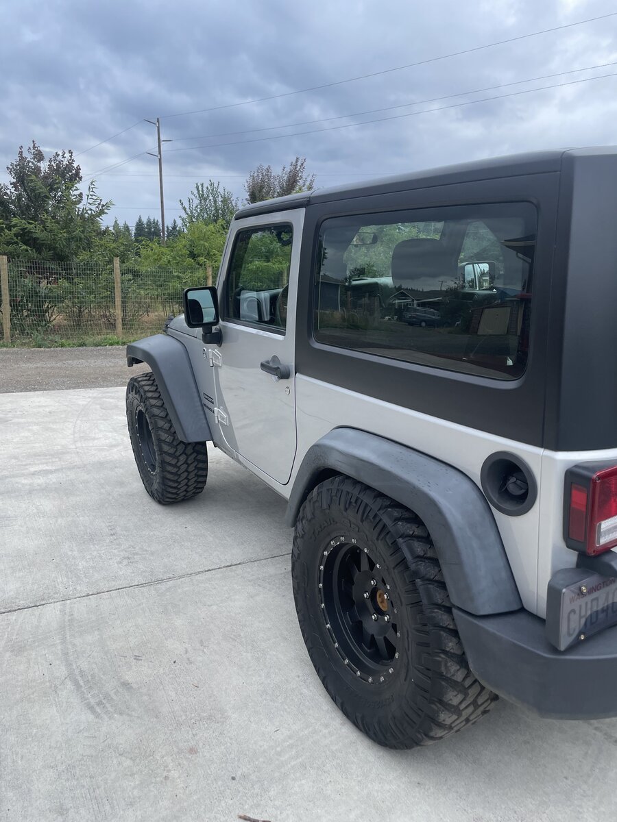

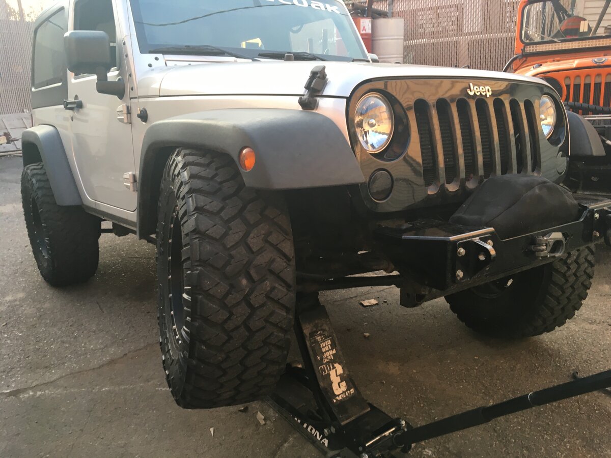

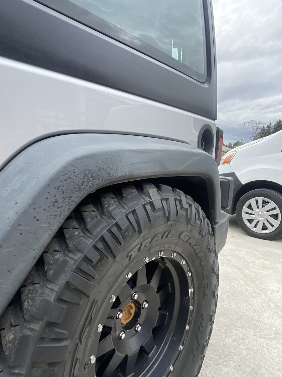

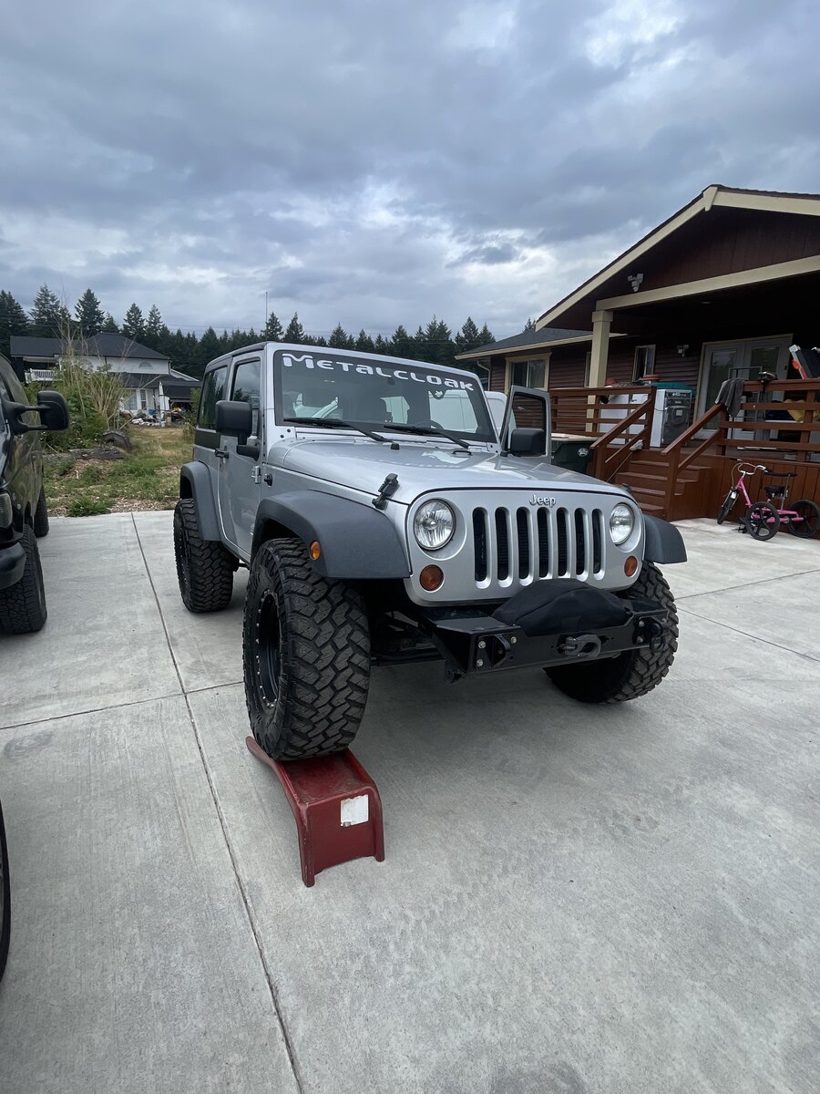

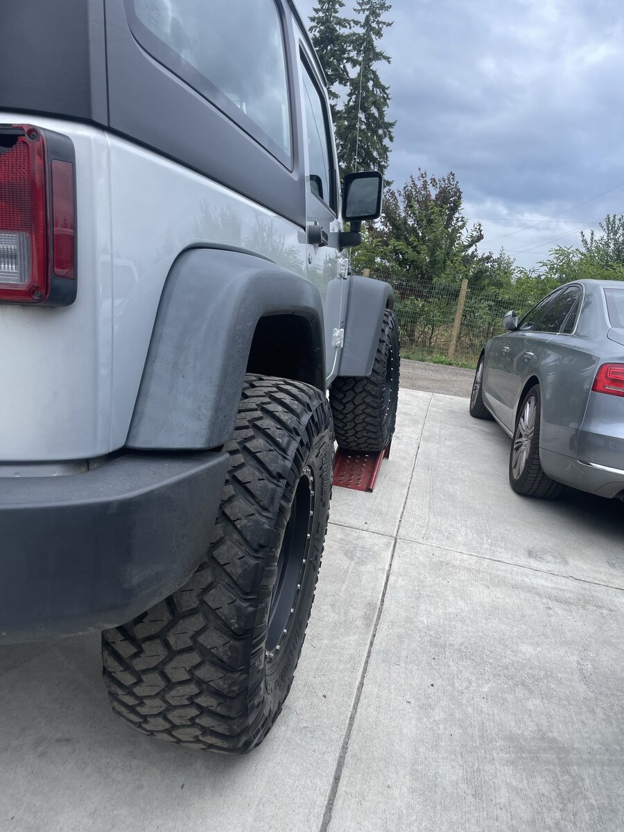

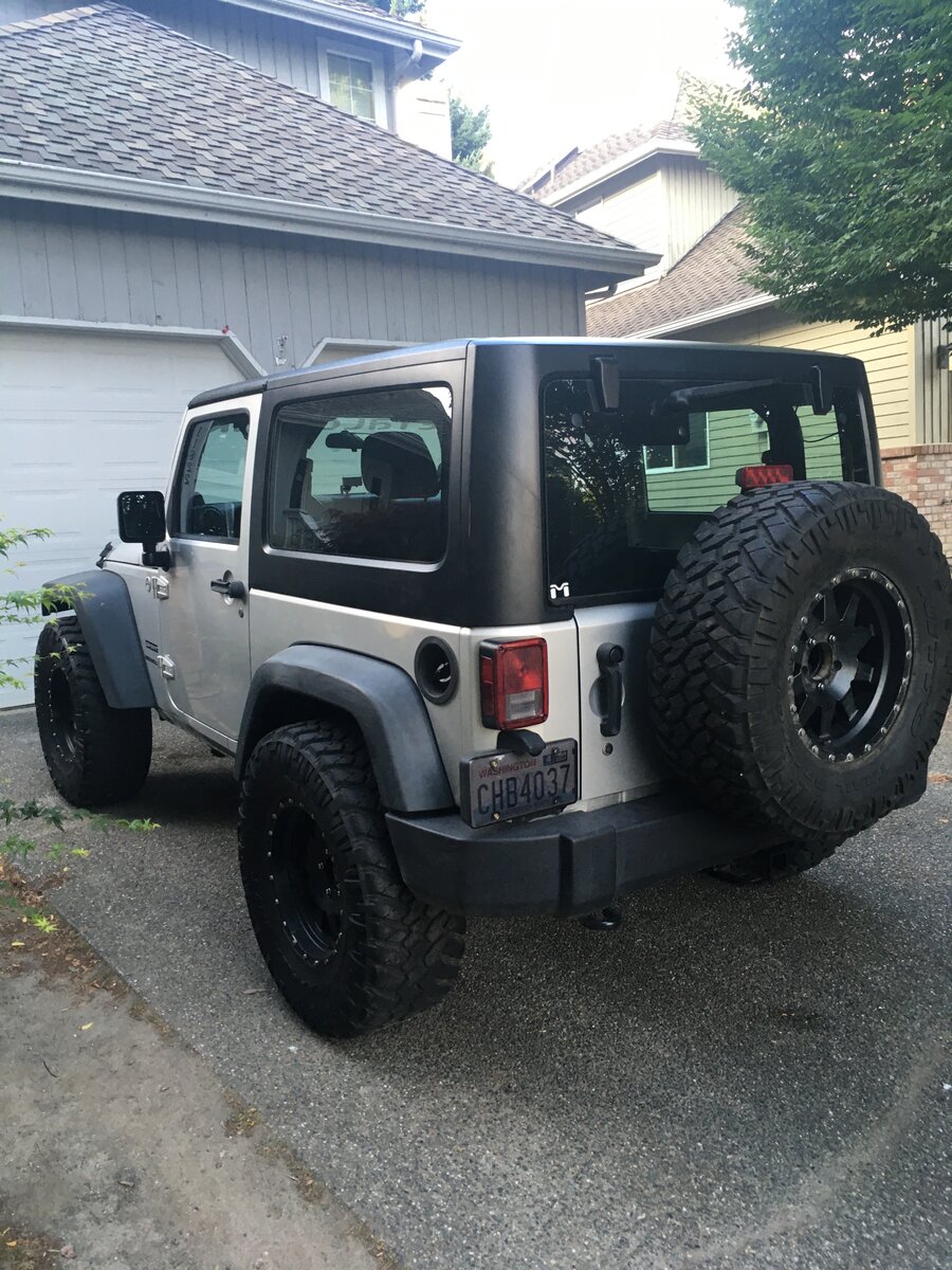

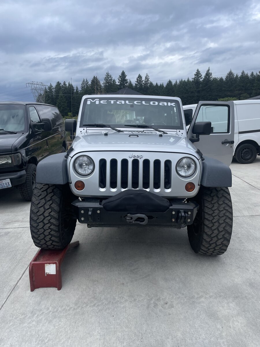

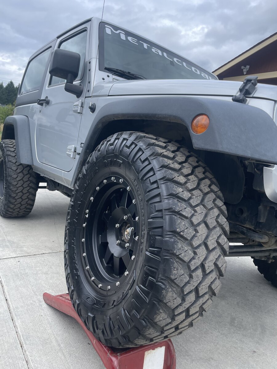

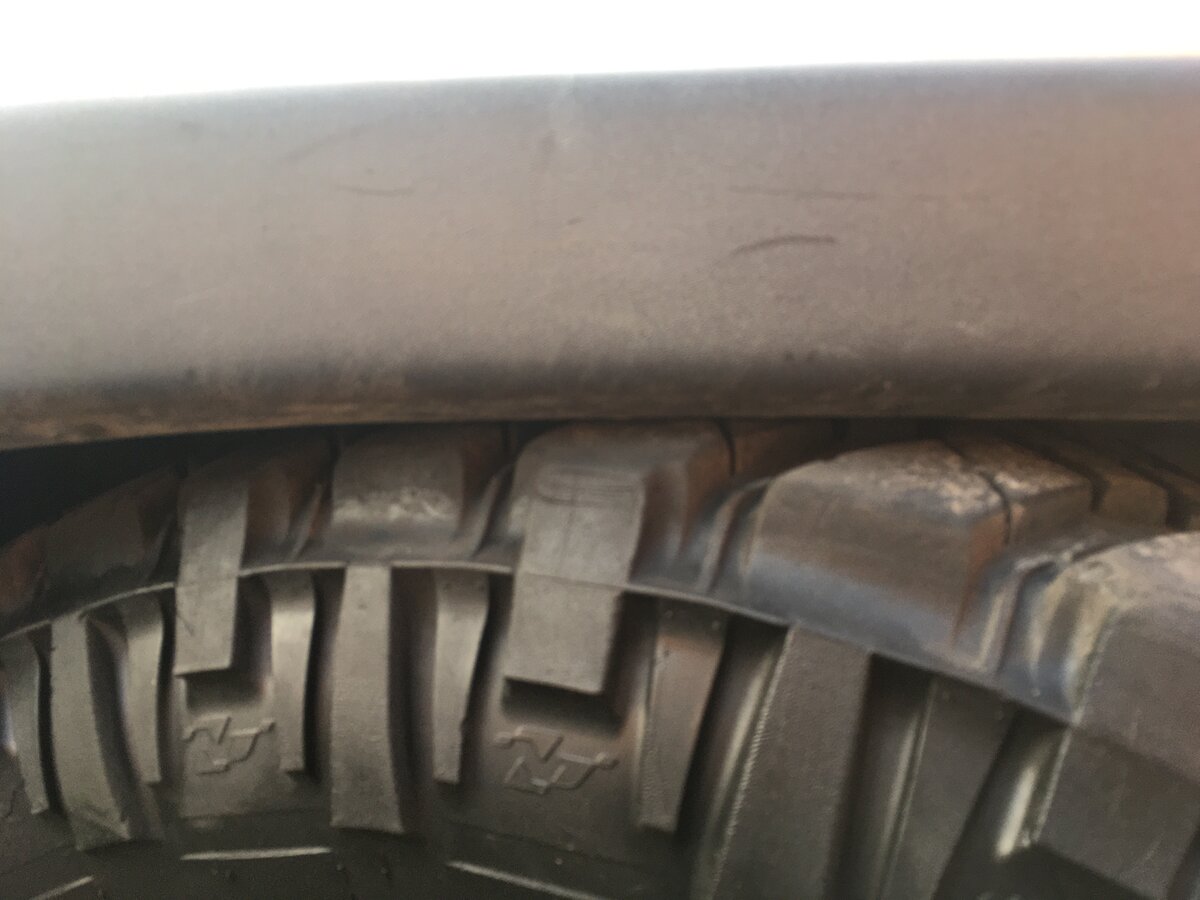

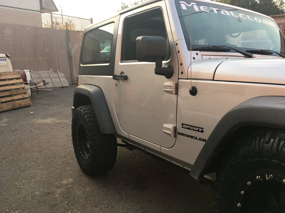

Woke up early morning, and first thing I heard my bro telling that he found a good deal on Facebook (35s Nitto, on method wheels) 6 tires, and 5 wheels, for 500$, jumped to my jeep, went to ATM, and got em, absolutely a good deal, installed them same day. Runs smooth and absolutely love them. I did disconnect sway bar and used a jack, to see how bad it would rub on *flex mode*, it does, but not like it will kill me, yk, now looking at Rancho shocks and some 2.5 inch either lift kit or spacers to put on right now.
Another update:

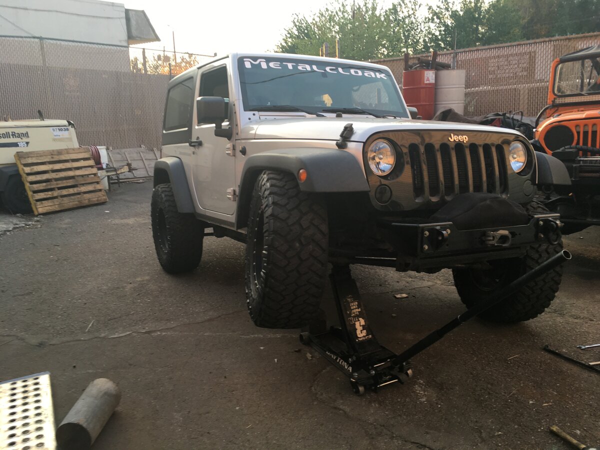

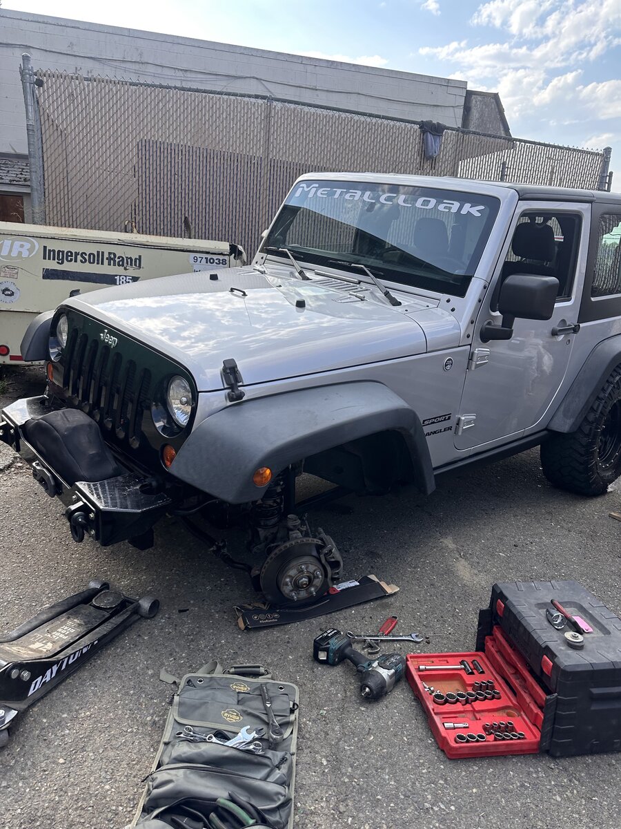

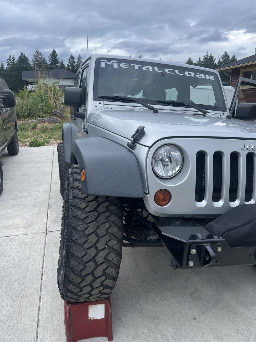

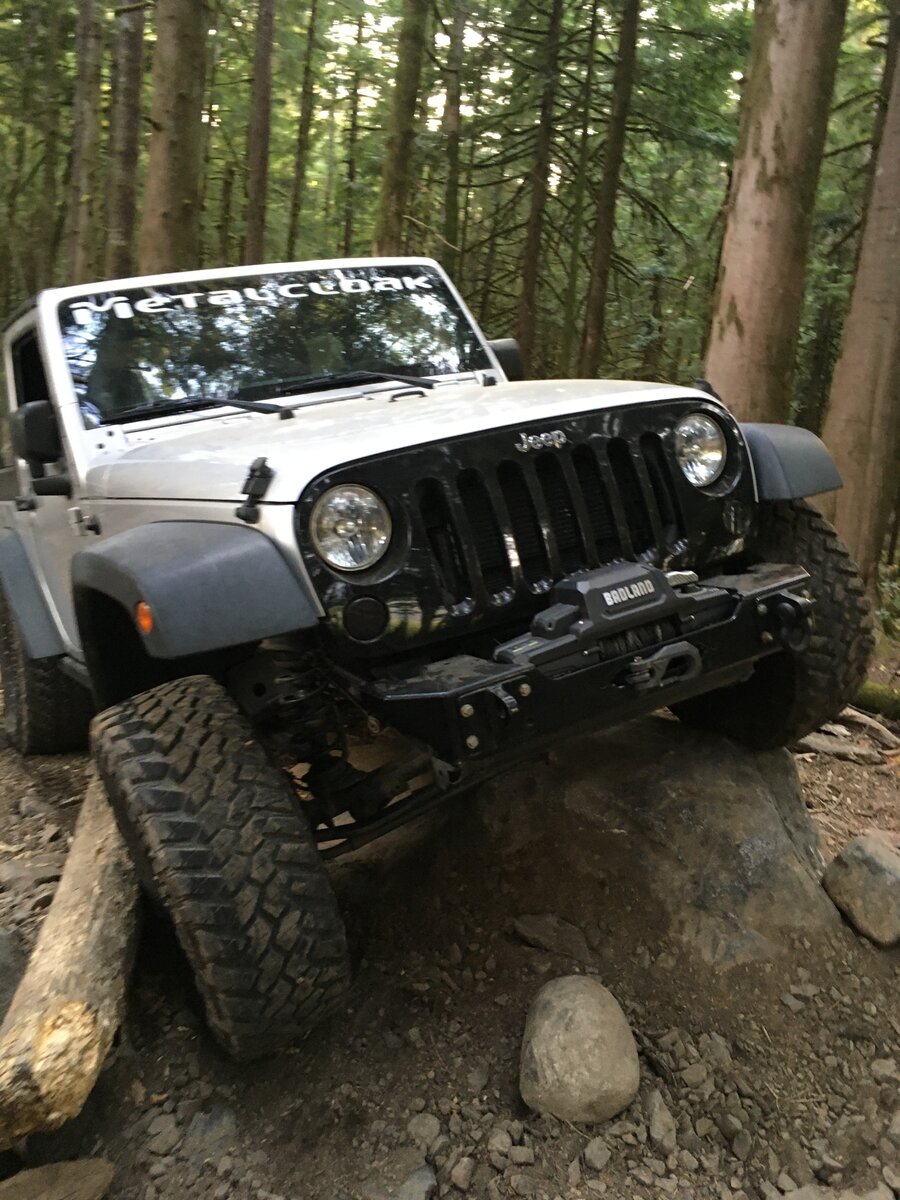

I was trying to save up for a good lift kit from Metalcloak or Teraflex, 3-inch lift kit, and get a full package (which is almost 2k), but after reading few things, that I will have to order driveshaft and few other stuff, I decided, JUST FOR NOW, it is not in my budget due to car payments, and college stuff, so I went out and got a 2.5 budget boost (spacers) for 200$, it will work fine for now, just to get some clearance and have fun on trails. I'm curently saving up for a decent lift kit and both driveshaft's, so I can order them and put them on same day.

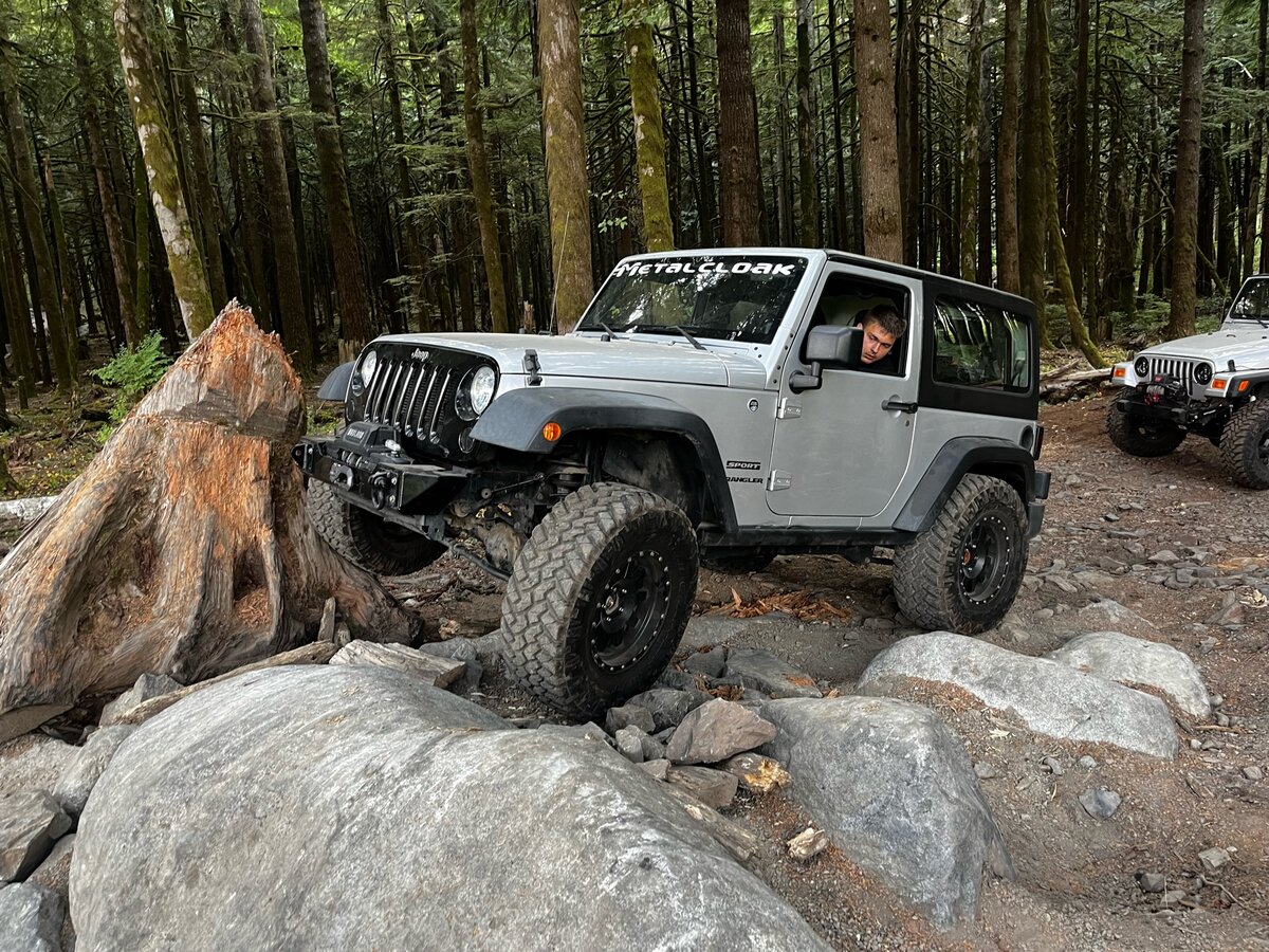

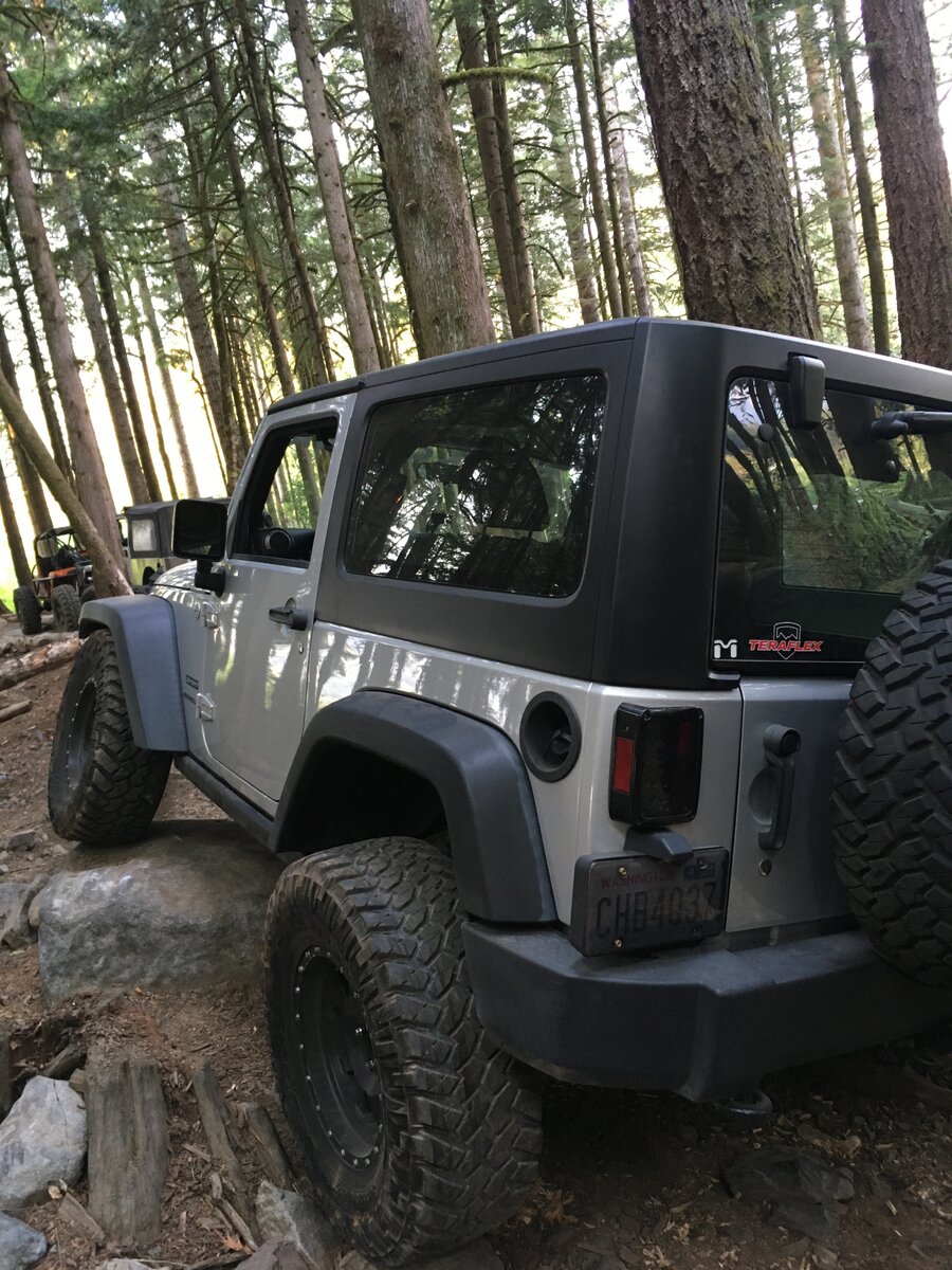

The next day went out to Reiter (PNW trail) and did some rock crawling up there (ish). Here are some pictures. I could see that 2.5 was not enough for me, unfortunately, but will fix that =)

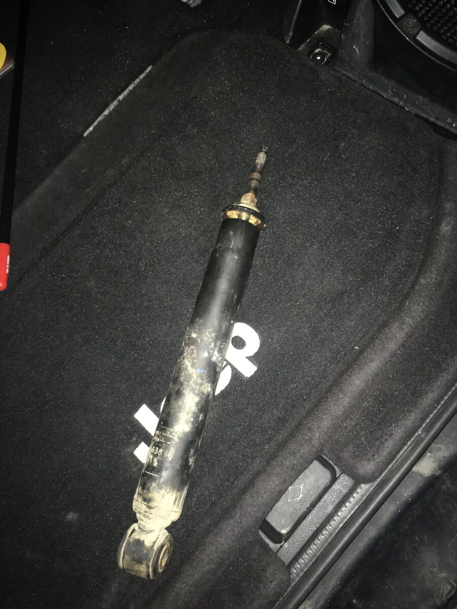

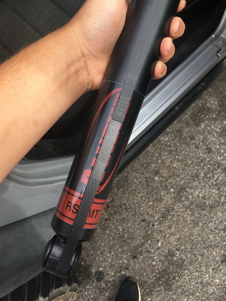

Yes, I just ordered Rancho Shocks ( RS77331 and RS77330). Before ordering shocks, I decided to measure the extended and compressed length, and holy smokes, 2 inch shocks are basically the stock ones, but they say that they are made for 2 inch lift, so I ordered these ones in order to get a full flex and more up travel and down travel, front are 4 inch shocks and rear ones are 2.5-3.0, will test em out this weekend on a local trail.

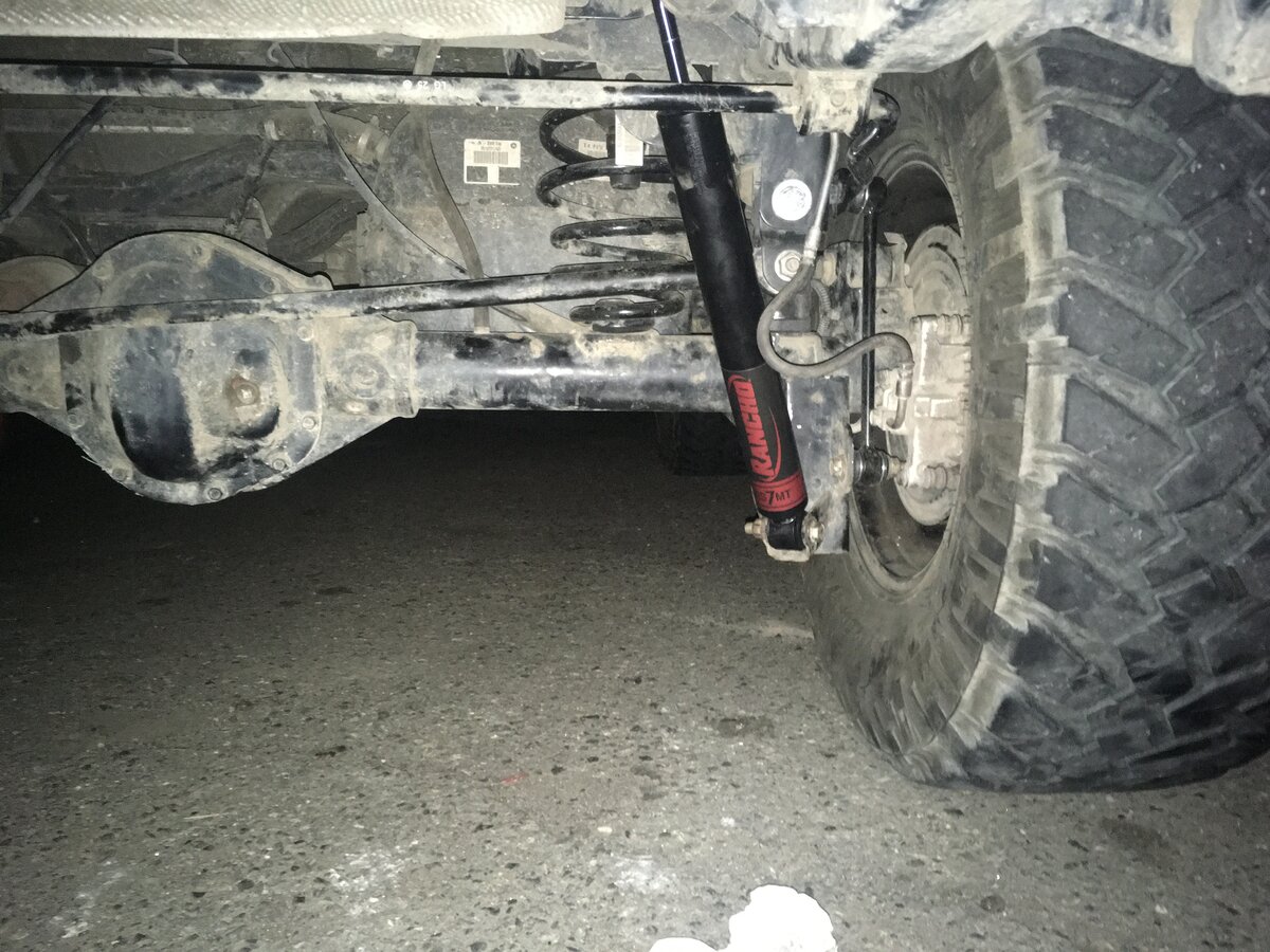

Installed my new shocks that are giving full travel, here is few things that are notice about em:
1. These shocks are made for an 4 inch lift, but, they are giving me an 4 inch downtravel and 2 inch up travel, so I'm gonna have to order an bracket to make it 50/50
2. Shocks are too long, and hitting the frame, not critically but they do, so planning on ordering 3.5 inch lift kit for sure (maybe 4)
In overall, they are decent, little bit stiff, but I'm okay with that, the stock ones (they had 100k on em) were absolutely destroyed and wouldn't even back up after being compressed, so that was worth it, now planning on ordering some brackets in order to get some more uptravel and either order a lift kit (next year) or get an brackets so they don't hit the frame at all (for now solution), Overall, so far so good.
