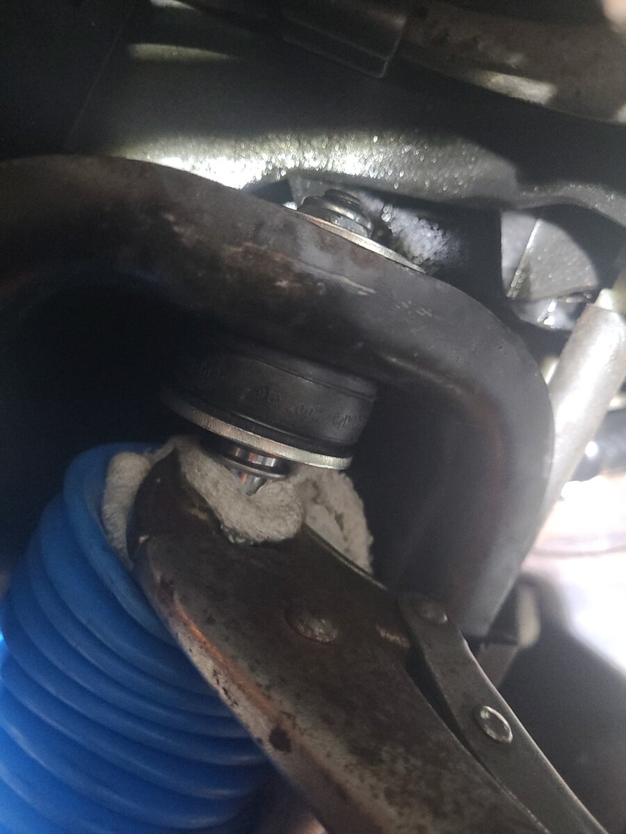

I was able to get the drivers side to work. On the passenger side if you have that honeycomb thing above the fenderwell it basically needs to be cut to get the Allen wrench and boxend wrench in there, along with your hand to hold it. It just takes a lot of patience. When installing the AEV 2.5” lift that passenger front shock was the worst parts of the total install.
