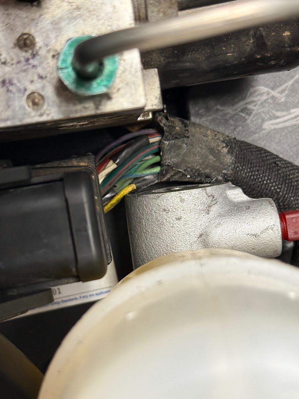

I don't think I'll be able to keep my visit compressor mount. Even if I adapted the mount, I'm thinking clearance won't be enough for it and the relay box I have.

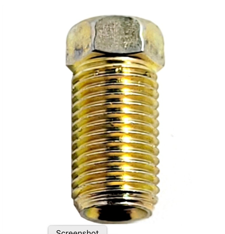

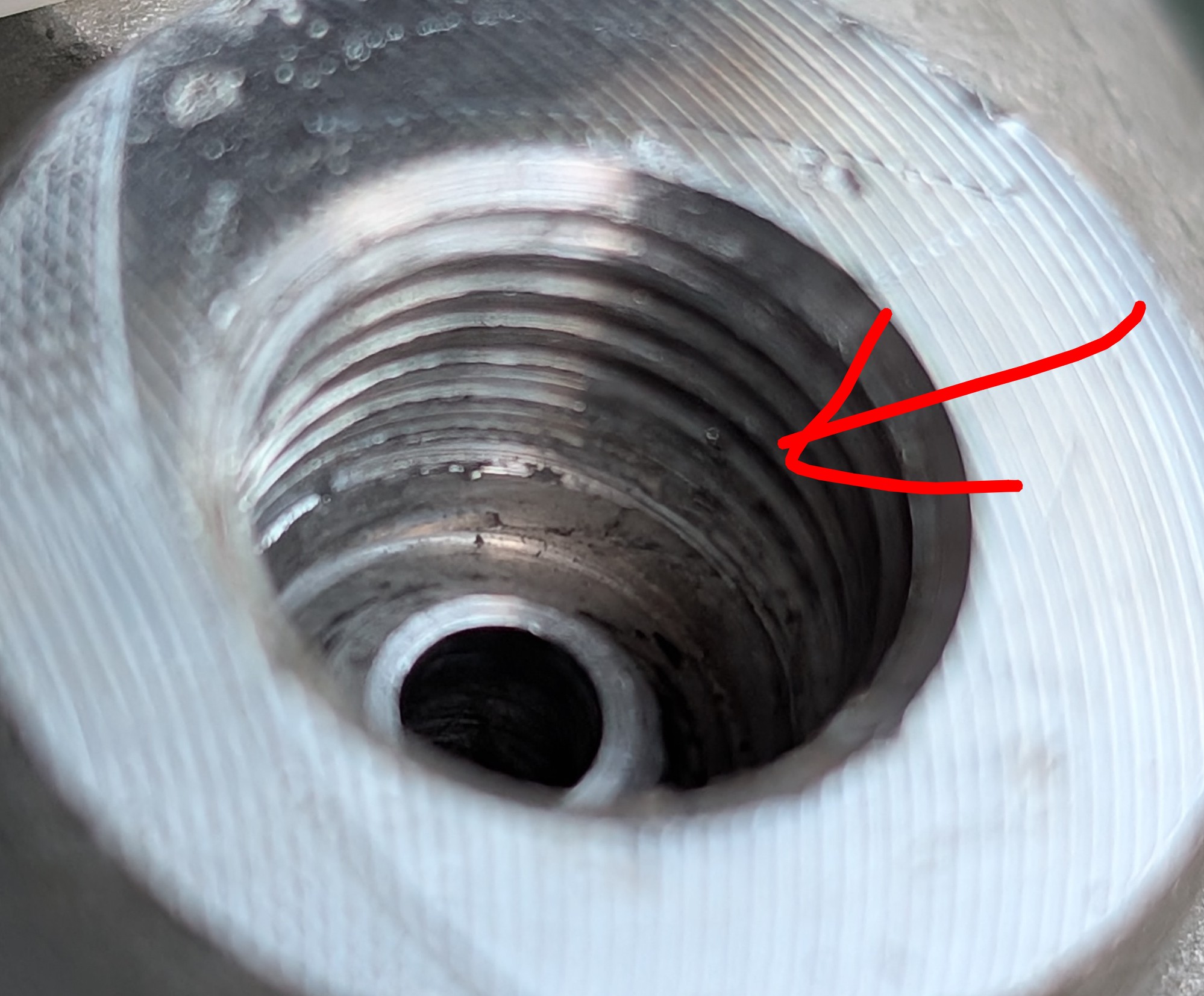

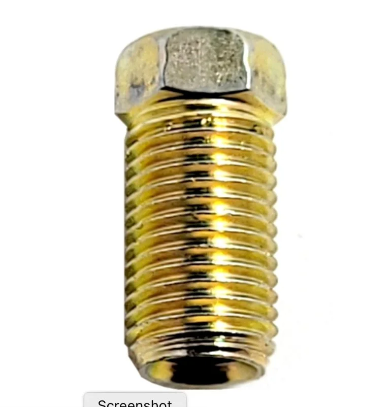

I did not have to do the ABS disable (either time, I will get to that) because I did not run it without fluid, or "dry". The first bleed was very little air, as the bench bleed was solid and I plugged the lines as soon as I pulled them from the MC. I went back over the flare nuts on he MC due to them being a little wet on the bottom, there was my issue, the flare wrench slipped of the nut and rounded it. due to the small leak, I had to repair it. This was interesting. the tube and the thread are SAE, the head of the flare nut is the only "metric" part of it. So I cut about 3/8" off the bad end, put a flare nut with a 7/16" head and re flared it. I would have bent up a new one but the other end is a bubble flare. I do not have that tool. I did however buy 2 bubble flare to inverted flare adapters today at Mc Fadden Dale hdw. So, if it happens again, I can bend up my own for about 15 bucks.
