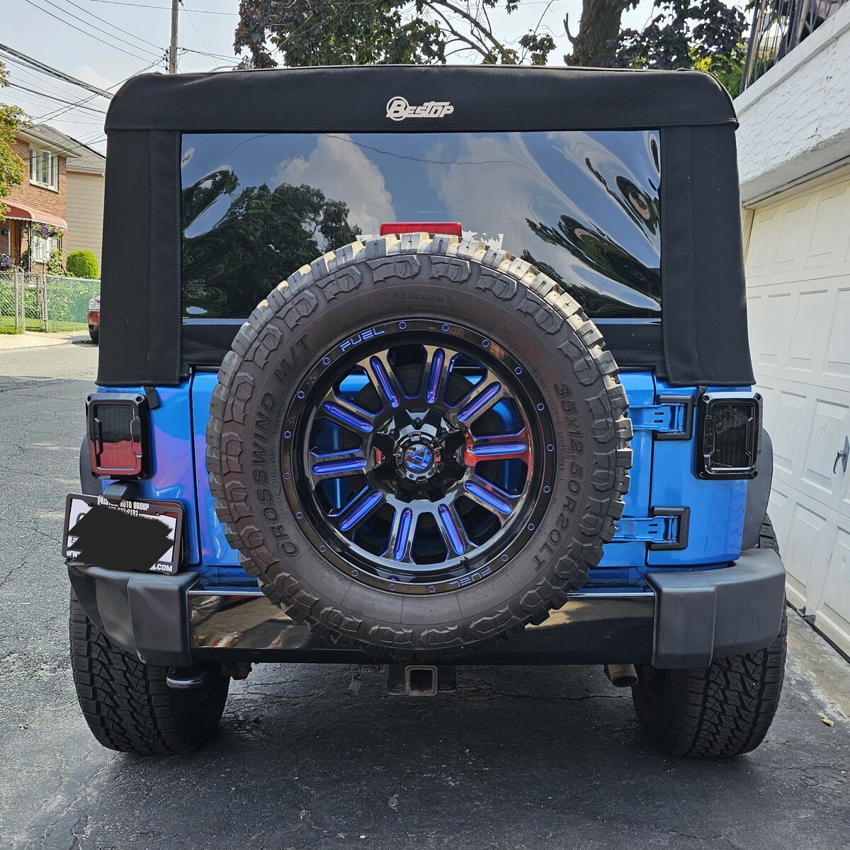

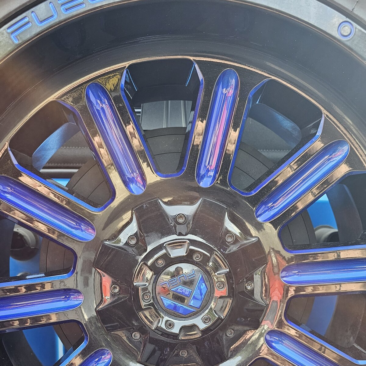

Hey there. Great write up. So i got this system and have yet to hook it up because my wheel spokes dont line up straight to put the camera through evenly, and I have this wide 35 tire on the back which i feel if i mount on top of 3rd brake light it will see too much tire. Plus the fact the sticky part of the rear camera mount cant be put on top of the 3rd brake light because i will end up with a reverse image. Any suggestions?
Reactions: Dirty Dog
The camera can be put on top. Within the mirror settings there are options to flip, mirror, etc. I had to work on them on my wife’s JK till you I had them correct. I made sure before I mounted it.
ok. I guess i will deal with whatever amount of tire shows. Im also gonna install an echomaster reverse cam into the hitch hole to my stinger radio so i have an additional angle for reversing.
As @Danarch said, you can flip the image in the setup. From your pictures, you could mount it on the disk behind your wheel. It wouldn't be perfectly centered, but it would still function just fine.
Personally, I'd probably mount it on the third brake light, but I'd do a test first. Slam the tailgate. If the third brake light vibrates, your image quality mounted there will be garbage. If it ends up mounted there, you can adjust the angle of the image by swiping up and down on the mirror. My camera is mounted above the liftgate. When backing, I often swipe down. Makes judging distances really easy.
Another alternative would be mounting it on your rear bumper, under the tire. The hitch and tire would protect it if you do any trails.
Ah cool. Great ideas. Thank you 😊

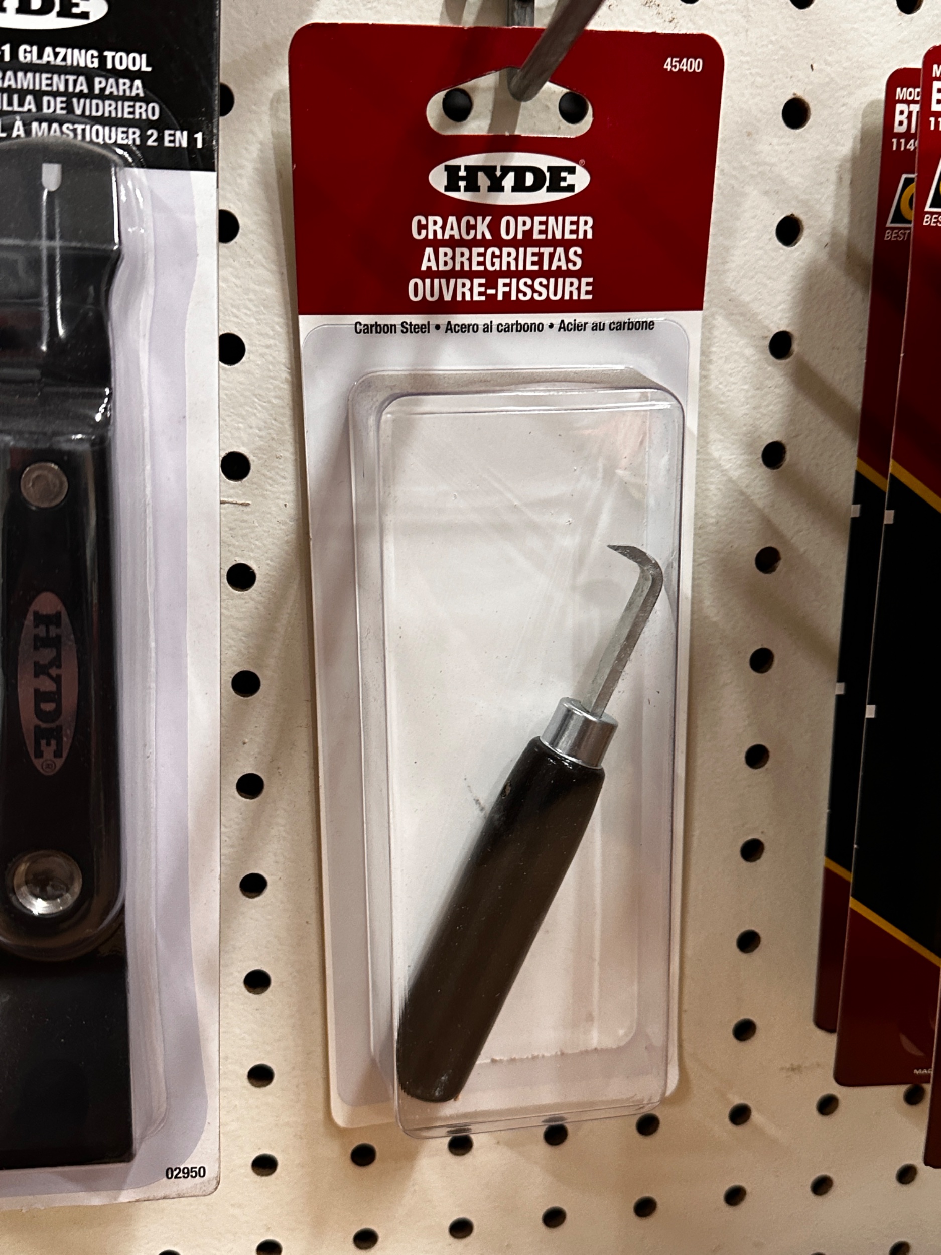

I used one of these around the pillar trim. It works great
That would certainly work. So does a small screwdriver. I use plastic to avoid damage to the trim, but if you're careful there's no reason metal wouldn't work just as well.
