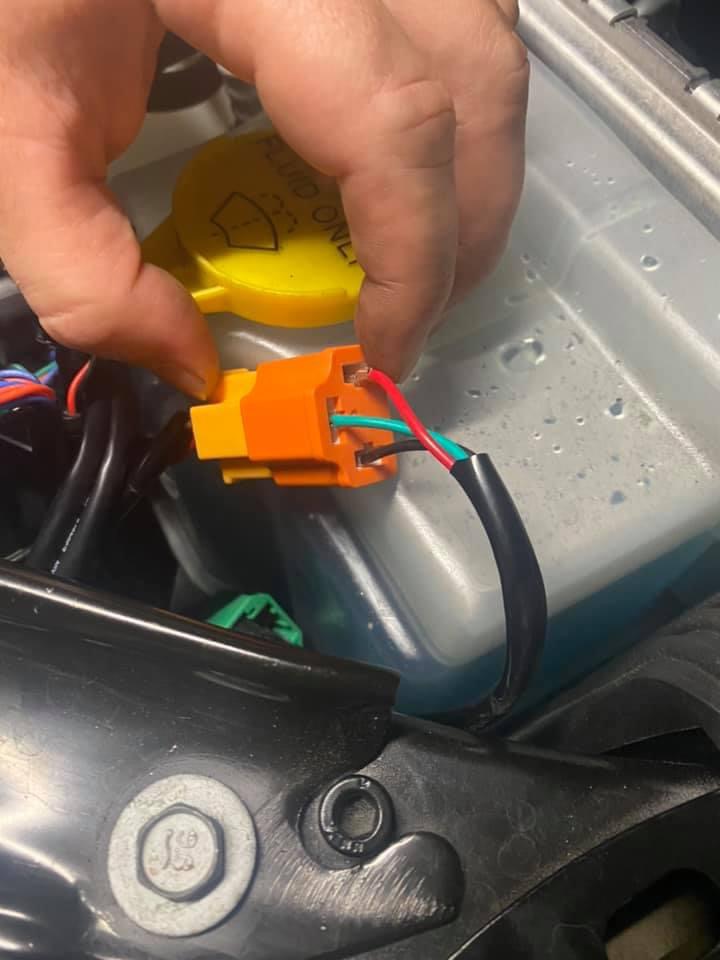

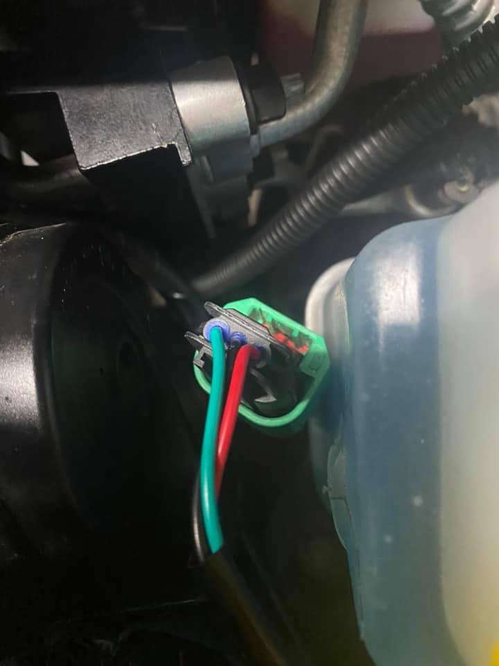

New to me 2012 Rubicon. Previouus owner installed LED headlights. Noted at night everyone flashing me for high beams. Seems the hi-low is reversed. I have not explored this yet, but am interested if anyone else has had this issue and how hard to fix it.

This is a fact that all Chinese made LeD headlights have them reversed. So we will have to change the pins in the light case

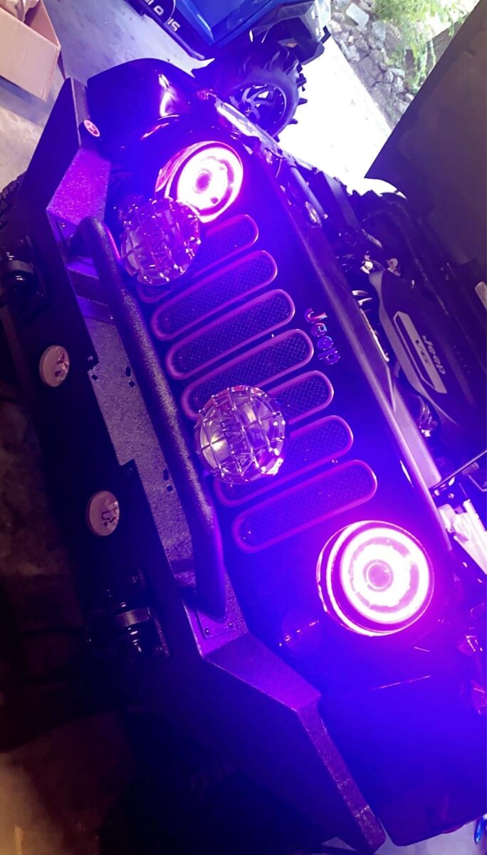

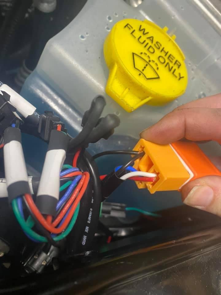

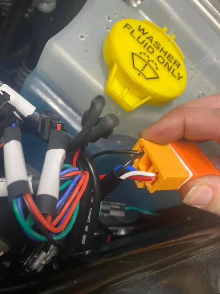

Didn’t have to alter factory wiring on my import LED’s.. For sure had to add a wire for halo to work as DRL. Used JSCAN to turn off factory DRL. .
Ran a couple wires from turn signal to headlight so Halo’s would flash with turn signals. Worked like they should . Had them on since September . . No issues .

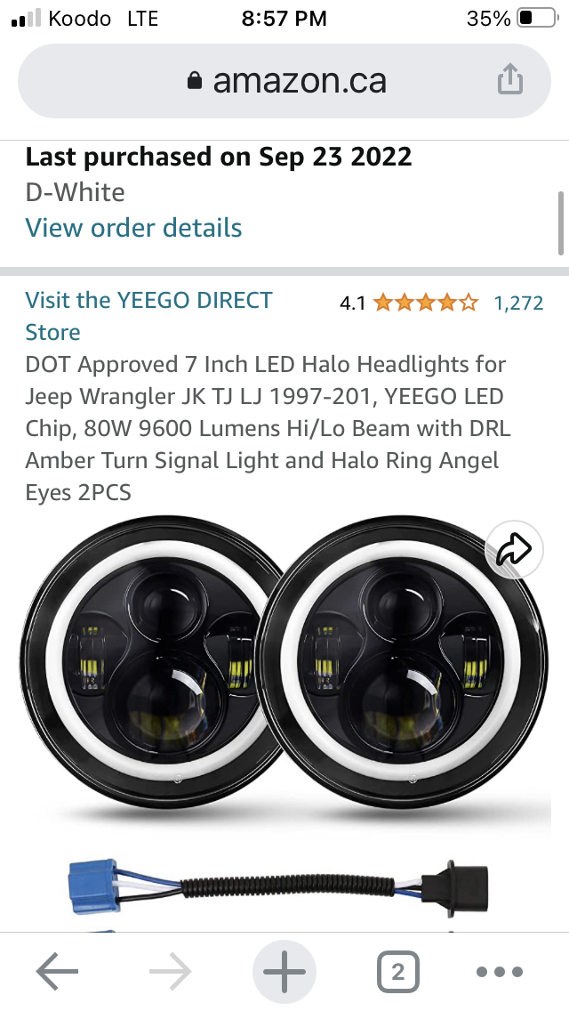

One just has to be selective when researching & purchasing . .As there is some sub par lights and gear out there .
Not everything out of China or Taiwan is junk.
