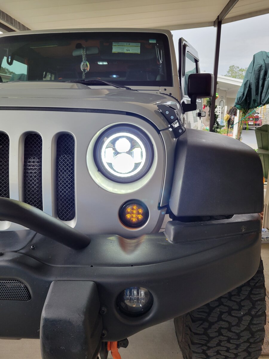

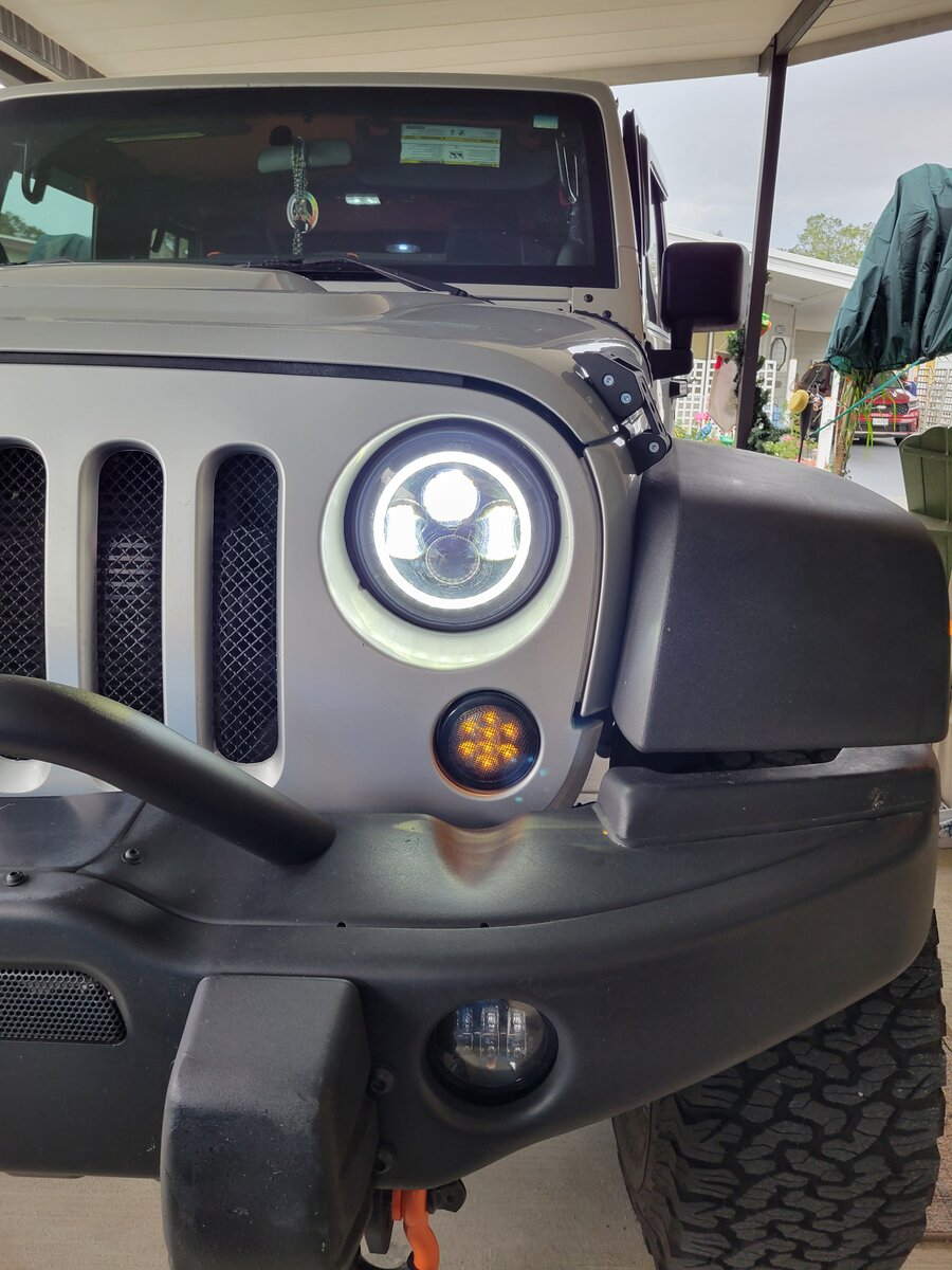

I just checked my ebay lights because I never checked them before lol. They are wired correctly thank goodness. I don't see how mounting them upside-down makes a difference since it only plugs in one way. I attached a couple pics.

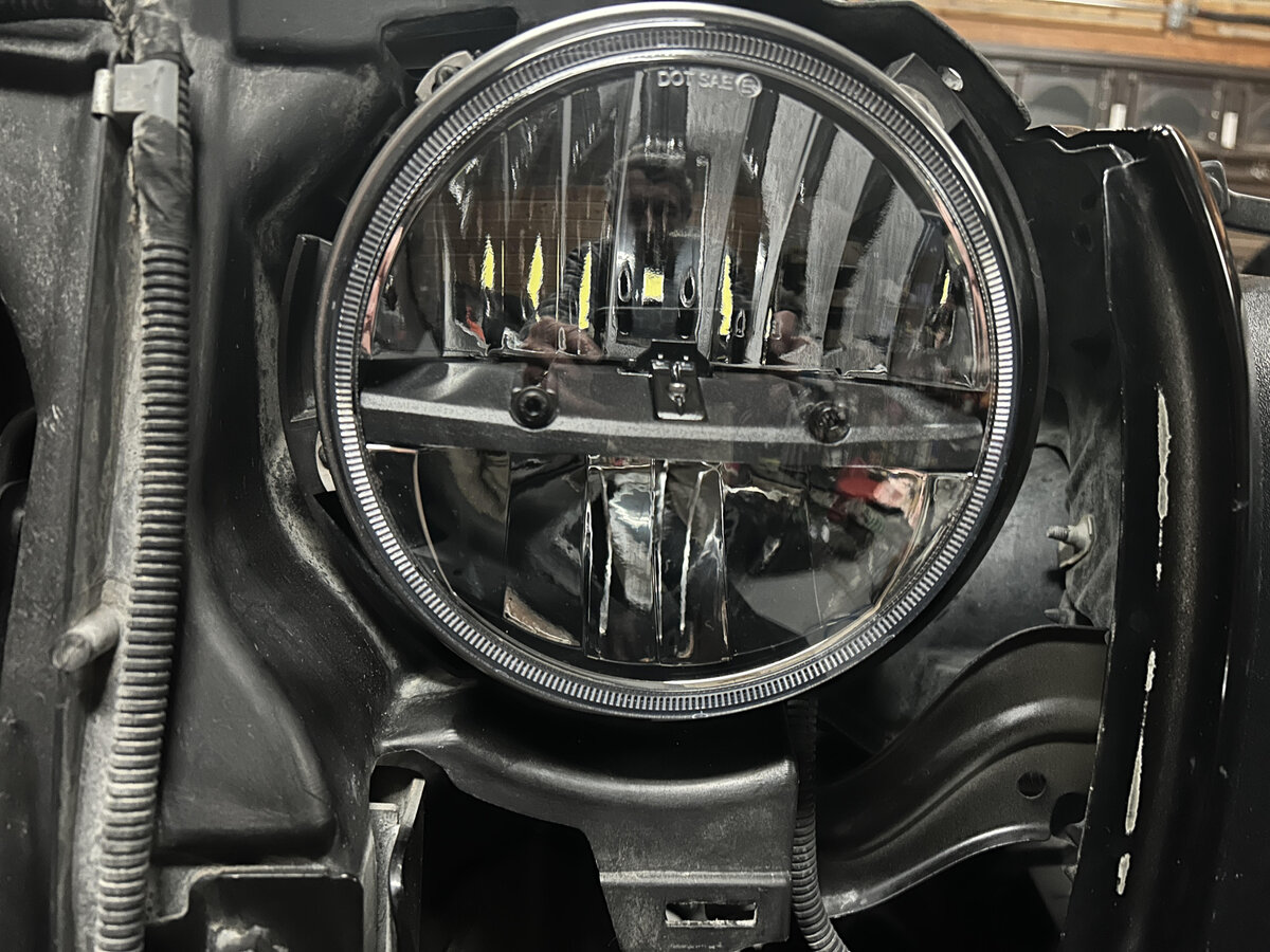

I have the Chinese version of Truck Lites..NVL-HL-002. I think they might be upside down. No Detent for Locating the top. Does anyone know if the Headlight should have the Large half on the top or on the bottom???

Large part on top just like u got it. Just installed a set just like those. Work perfect. That sux🍺🍺
