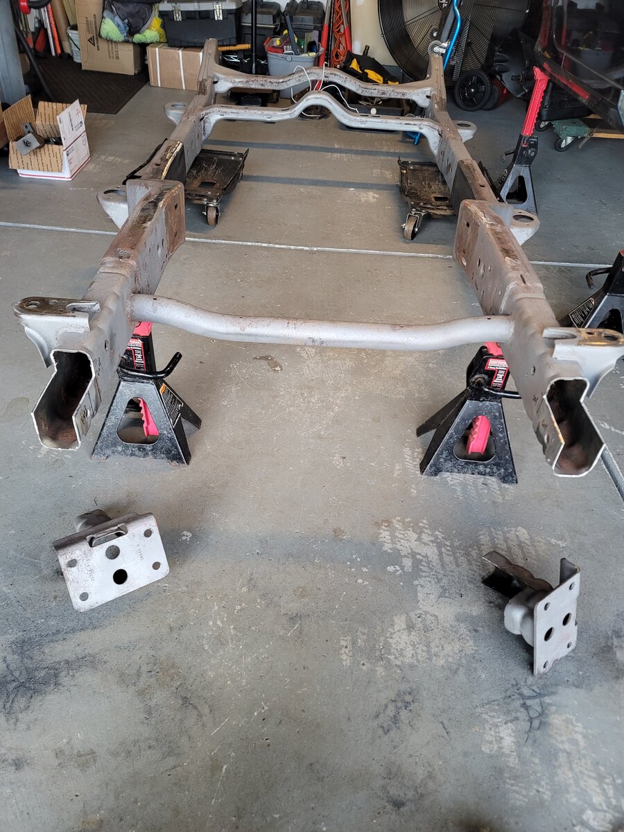

So out of the eight body mounts 4 of them, the bolts needed to be cut off. 1st off the way these things are designed is worthless and ridiculous. Ever see a video where a JK body flies off the chassis while offroading, it's legit.

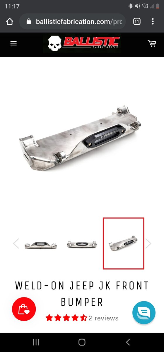

Ordered my bumper. Which is a weld together kit that also welds to the frame. Yes, this is intentional since it will serve as my new front cross member. It was the last one apparently.
I realized while going over my frame that I will most likely be cutting out every single cross member (one at a time, while upgrading etc)

Once that bumper is welded on it should outlast the Jeep.

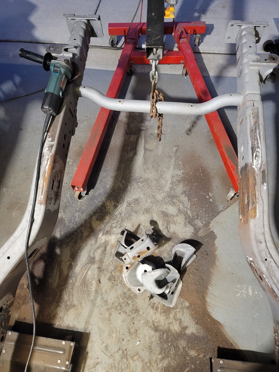

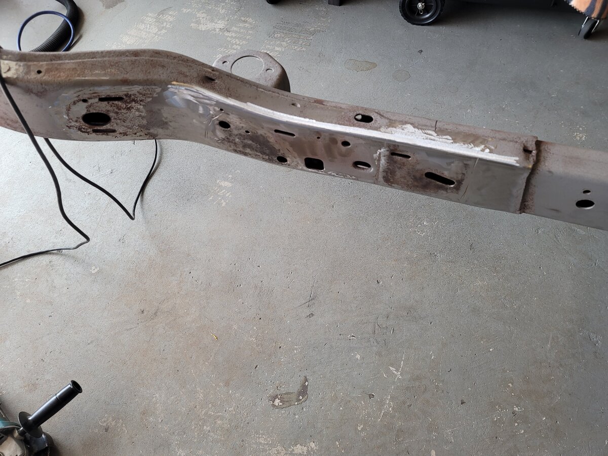

Cutting and grinding like crazy. Got lots of the brackets cut off and cleaned up. I need to order some tubing for the new cross members and start mocking that up this week. If you're wondering how much I took off just look under the front of your JK. 😆
Should make packaging easier! Holy moly!

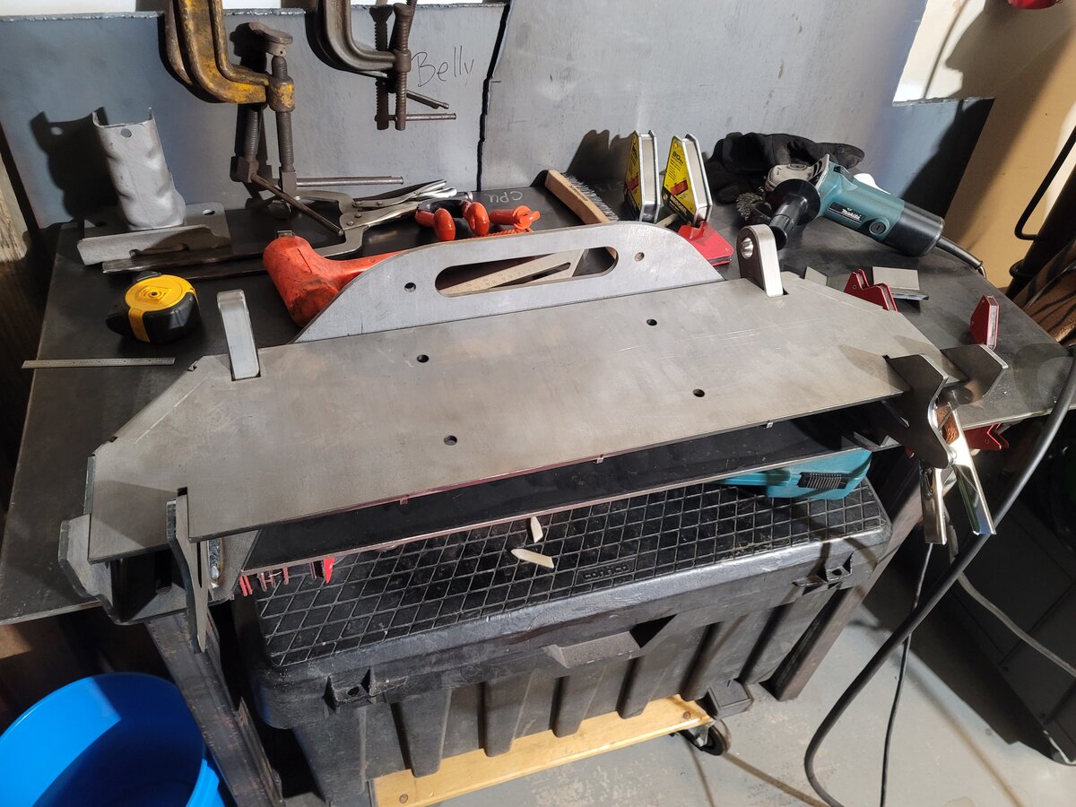

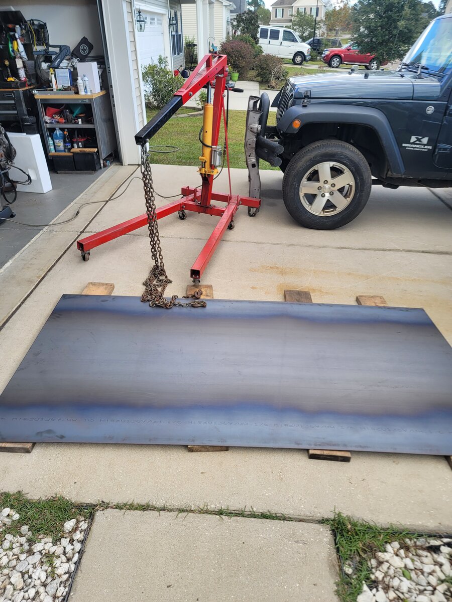

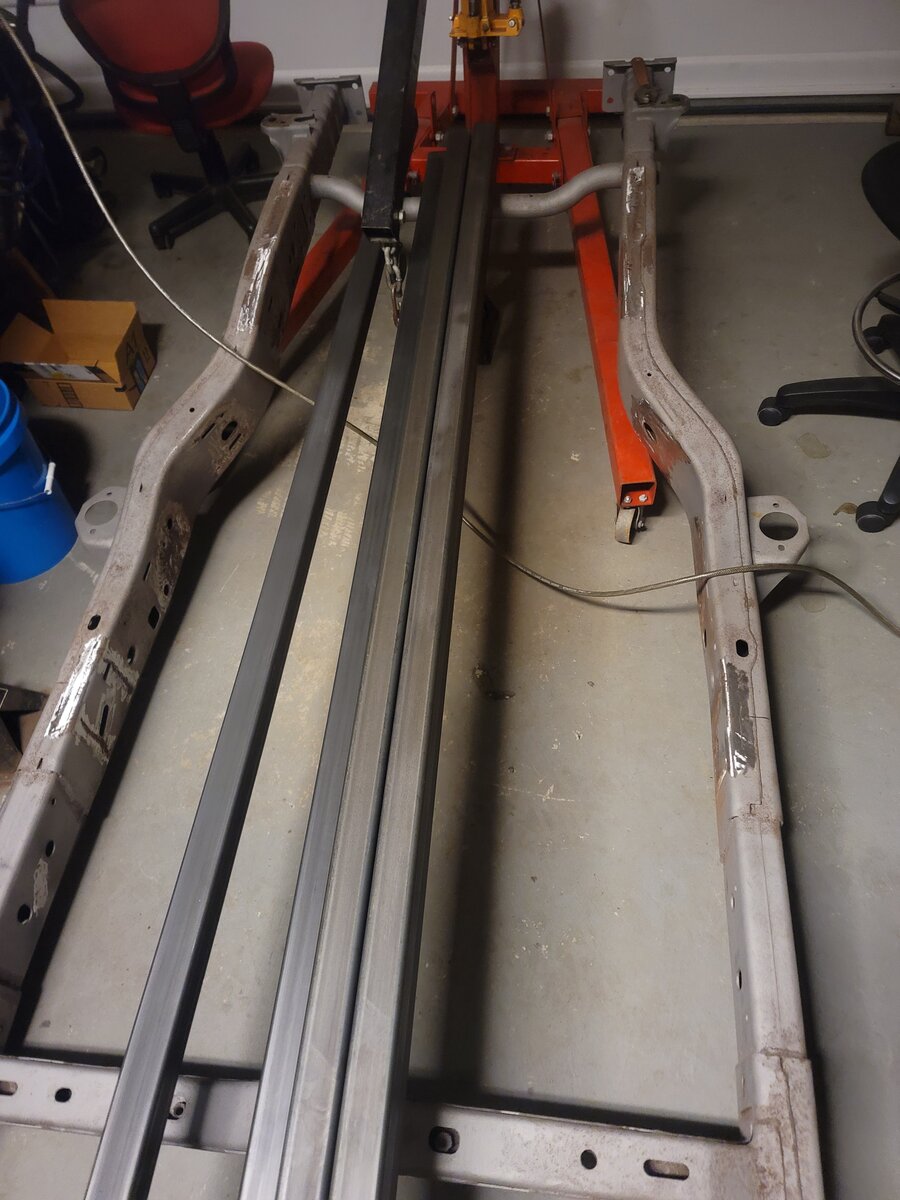

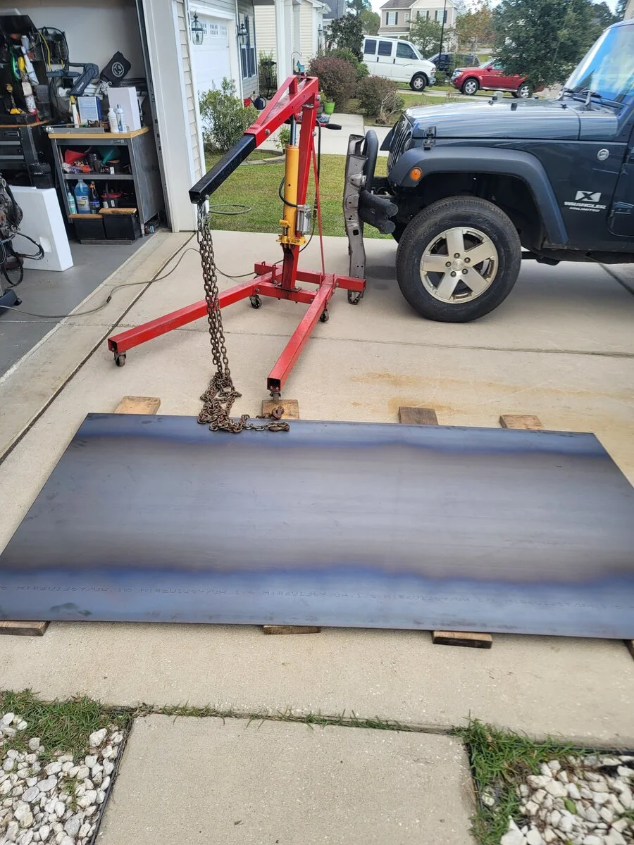

I did pick up steel tubing for my cross members, I have 2x2 and 2x4. Going to order a full 4x8 sheet of 3/16" to cut my gussets and what not from.
I also ordered an inexpensive yet nice looking plasma cutter from the eBoy store. I don't expect much out of it but the YouTube reviews look quite hopeful.
I also ordered some awesome looking brackets from Ballistic Fab. I should get a sponsorship from them since most of my stuff came from there. Yeah right!

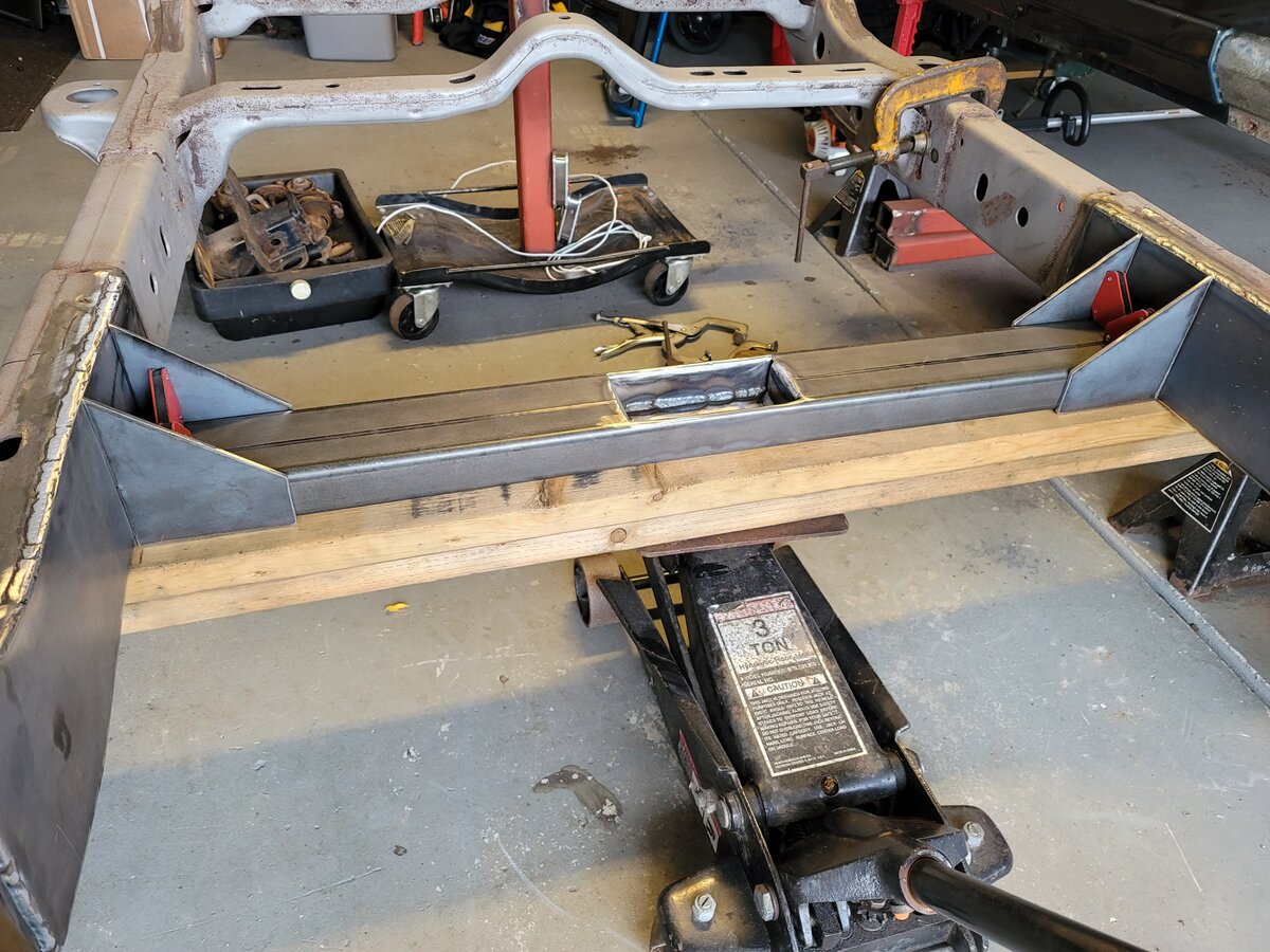

Been waiting on a ton of parts to come in. Made the transmission crossmember and picked up a sheet of 3/16" to fab some brackets and gussets today. Picked up a JKU the other day to fix up for my wife and daughter. It will be getting the 3.8 from the Crawler build and also the transmission as the girls don't want the standard. Picked up a nice Hardtop off a Rubicon today to put on it from a local Jeeper. I will be fabing both front and rear bumpers for it from scratch.
