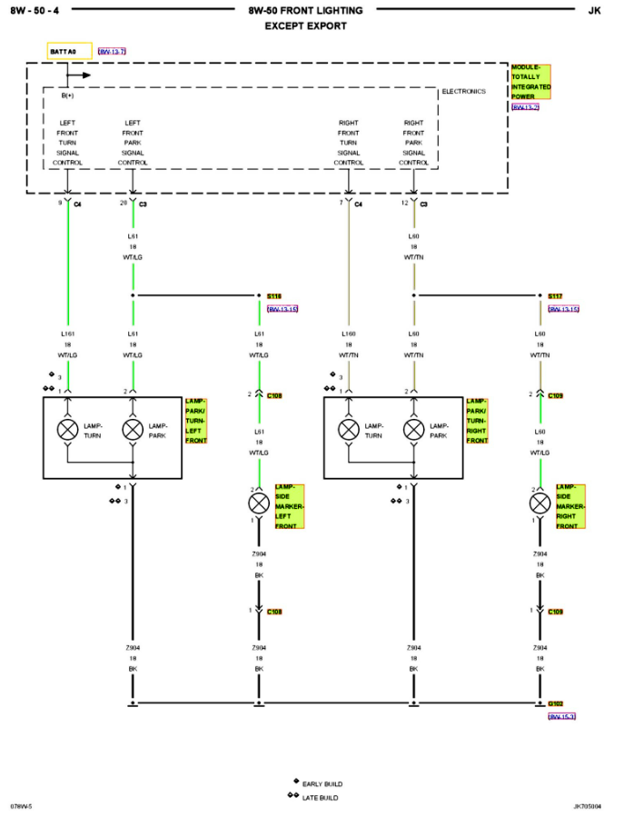

I'm trying to figure out when exactly the split was for early vs late build in regards to the park/turn lamp wiring on the 07 wrangler. Any ideas of a VIN split or perhaps a build month split? Included is a picture of the diagram I was able to find online that calls this out. Hopefully someone here can shed some light on the situation.
