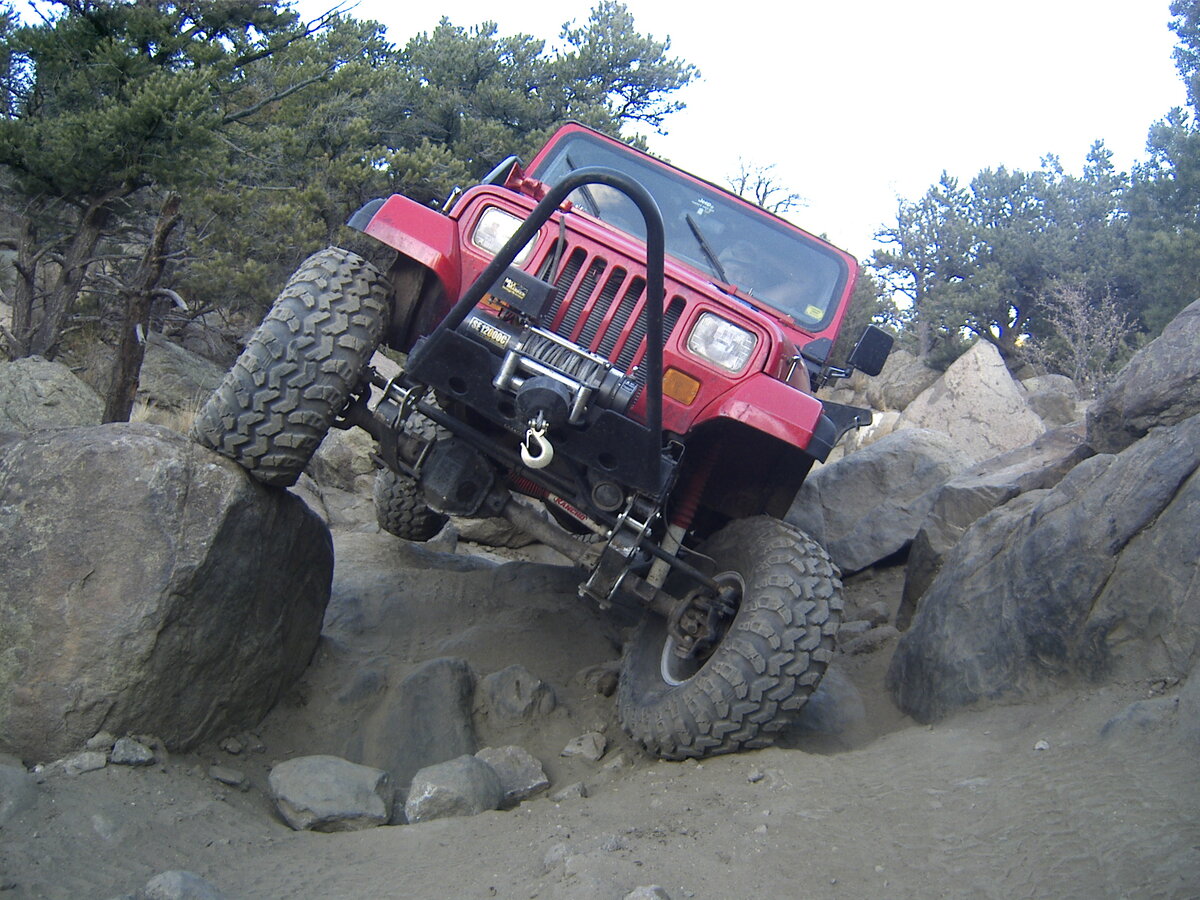

My daughter Katie plowing through in one of my old XJ's.

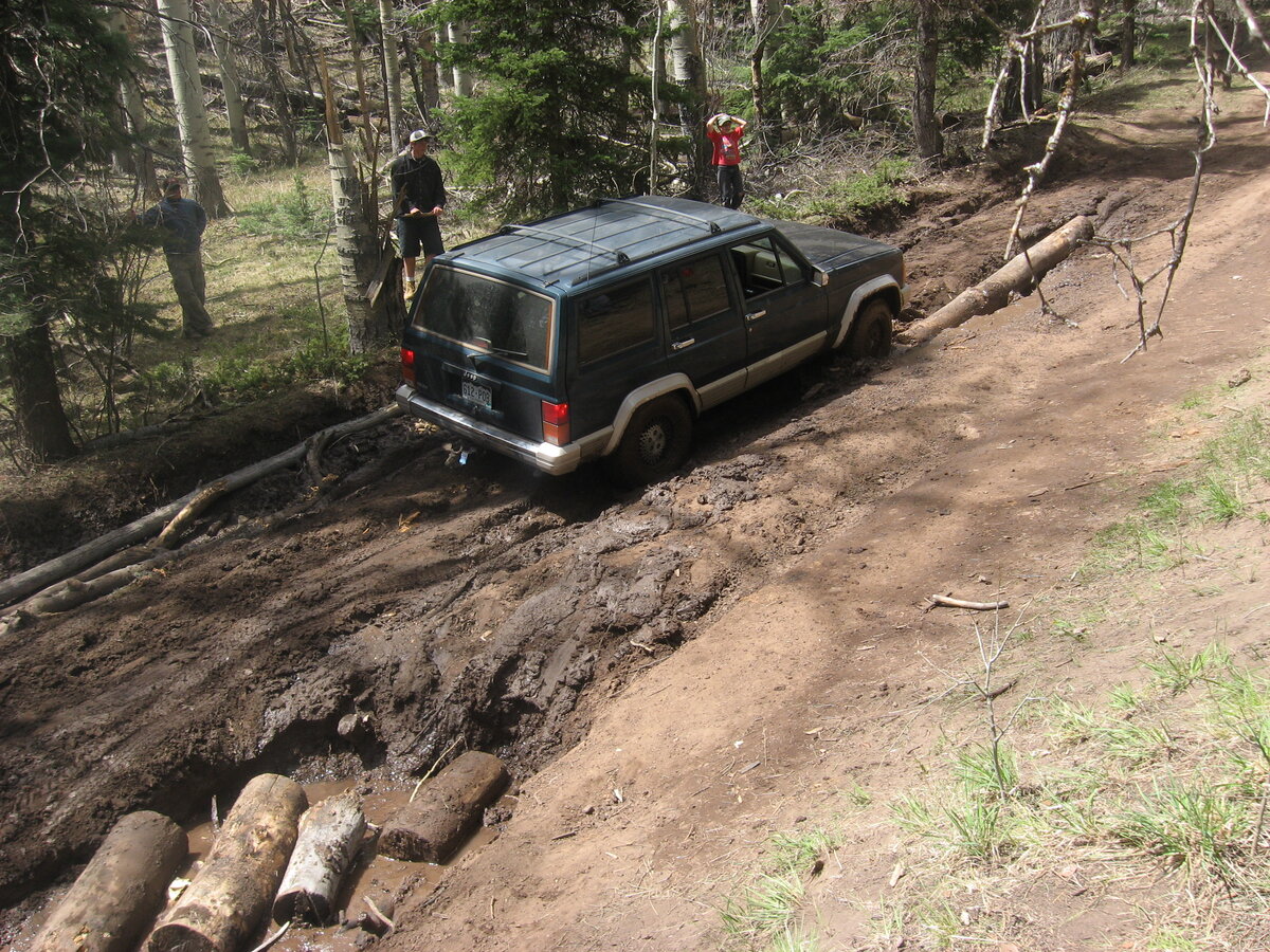

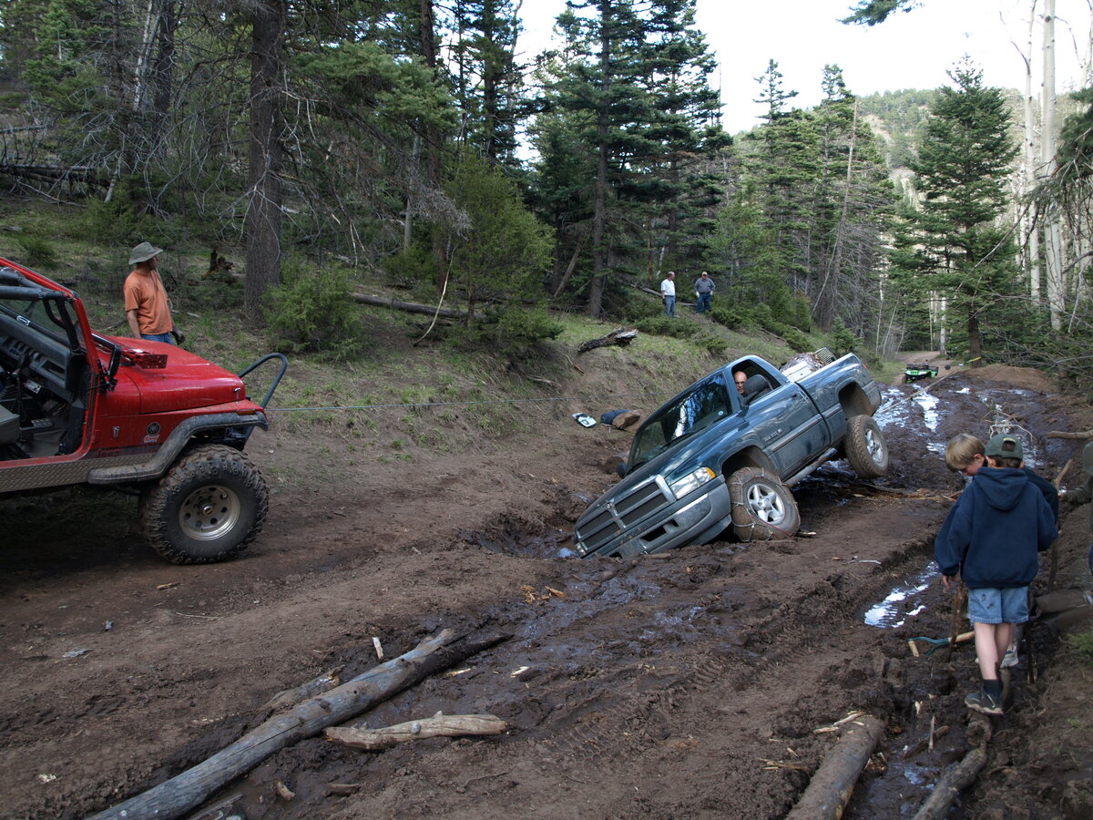

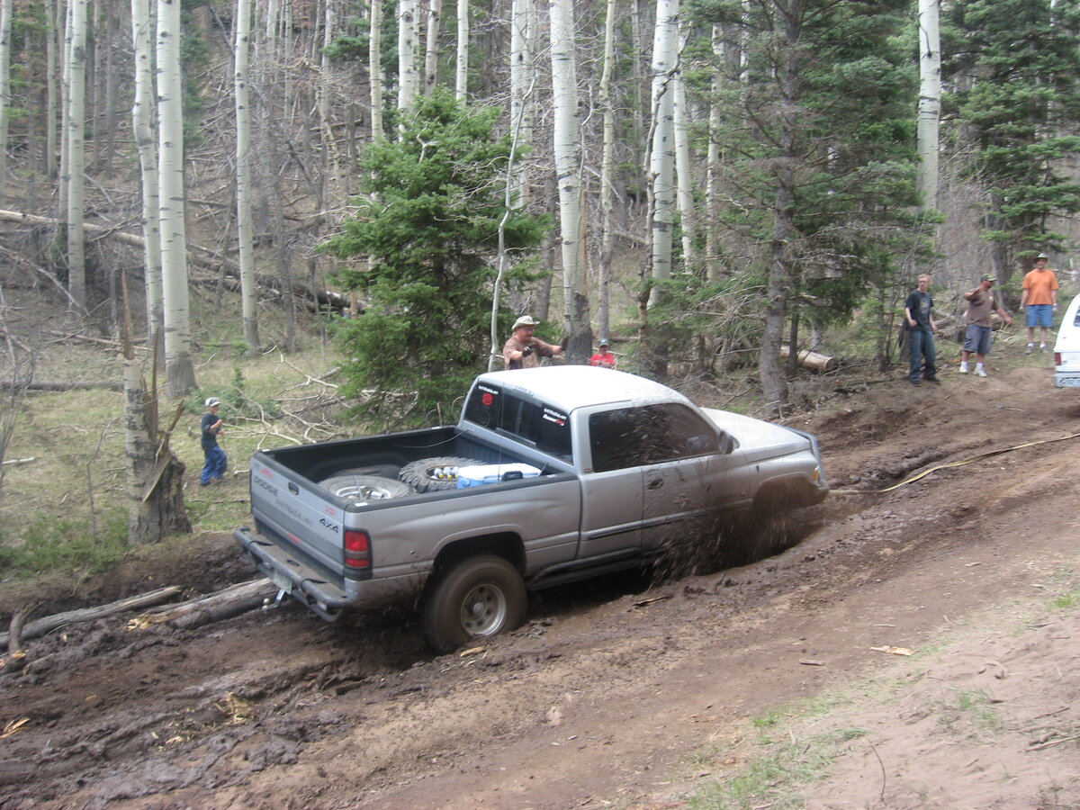

My wife getting my Ram unstuck.

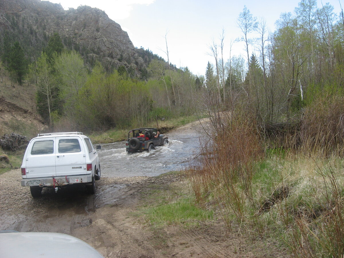

One of the water crossings.
One of many beaver dams.
Coming into the dunes.

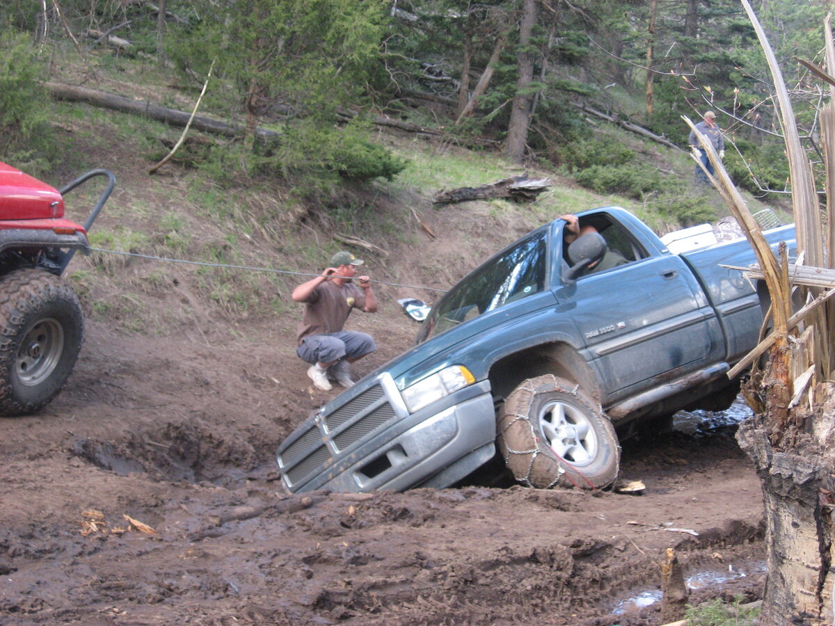

A guy who took his girl and went wheeling solo. Bad idea. He got stuck, and his solution was to put snow chains on the tire that was touching the ground. Of course, he had an open diff, so it didn't actually do anything. They'd been there about an hour when our group came across them. We put a snatch block on a tree behind him, pulled him out backwards with my old YJ, and convinced him to turn around and come out with us.

That Dodge Ram was heavy. A lot heavier than my little YJ. You can't see it in that picture, but there's another YJ behind me, strapped to my rear end, just to add weight. It doesn't show well in the photo, but I was also a fair bit off camber trying to get the angle for the snatch block, and I didn't want to winch myself into a rollover. I had a MileMarker 12,000lb electric winch on the YJ and a MileMarker 15,000lb hydraulic winch on my Ram (the silver one). I used to tell people that between those two, if we couldn't pull them out, we'd just rip their rig into pieces small enough to carry out by hand...

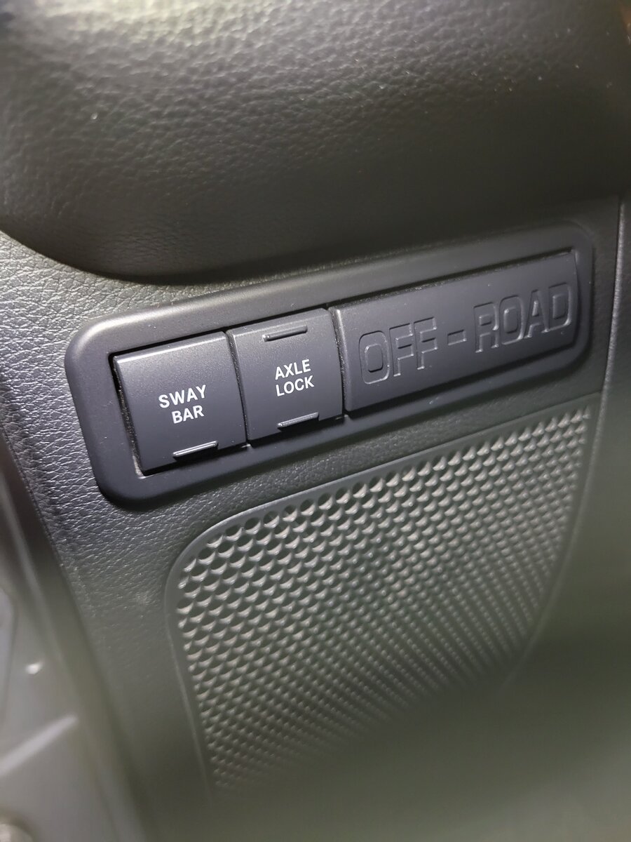

Dog, is this axle lock button something different than the ARB or Detroit you mentioned? Apologize but I'm not that 4wd knowledgeable. Is the lockers something a backyard mechanic like me can install? Thanks.
Looks like you own a Rubicon. The Sway Bar button when pushed will dis-engage the front sway bar. This will give the front end of your vehicle more articulation/flexing allowing your tires to remain planted on the ground when on uneven terrain. This will help to a certain degree. When you get too flexy and have a tire spinning, you can push the Axle Lock button. Yes, this is what Dog was talking about. You have lockers already installed. I believe if you push the button once your rear lockers will engage. Press it again and both your front and rear lockers will engage. There will be indicator lights that show on your dash. The factory lockers in a Jeep Rubicon are electric. The ARB lockers are air driven. There are different brands and styles of lockers. They can make a huge difference in getting through obstacles. When your lockers are engaged it will make it more difficult to steer as both of your tires will spin at the same rate.

Different but similar.
Lockers fall into two basic categories. Automatic and selectable.
The E-Locker that comes standard on the Rubicon (such as yours) and the ARB (and similar) are selectable lockers. You have to flip a switch to lock the differential. The E-locker is electrical, the ARB uses air pressure to engage the locker.
Detroit lockers, lunchbox lockers (and similar) engage automatically when the tires are spinning at different speeds. A small difference won't engage the locker, to allow for cornering without the tires chirping constantly.
Lincoln Lockers are permanent.
Not surprisingly, there are pros and cons to each. If you want to get into the details, we should start a different thread.
No need to apologize. Ignorant is the default state of humanity; we learn as we go.
Installing an ARB, E-locker, or Detroit requires replacing the differential. You'll need to swap the gears to the new differential. Setting up a differential from scratch is not a job for a neophyte.
Lunchbox lockers retain the original gears and differential and can usually be installed without removing the diff from the housing. I think most people could manage this install.

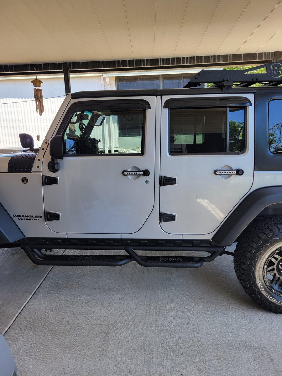

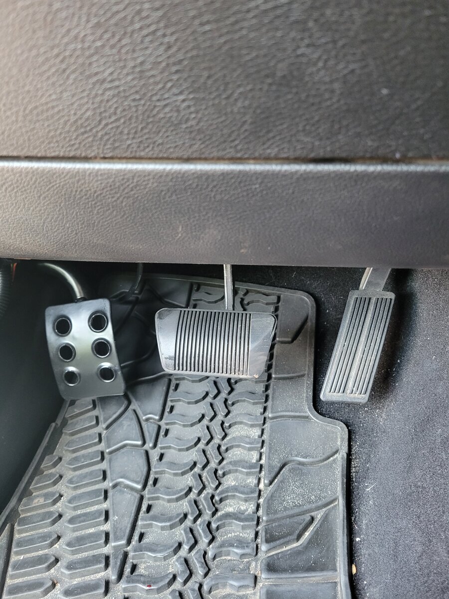

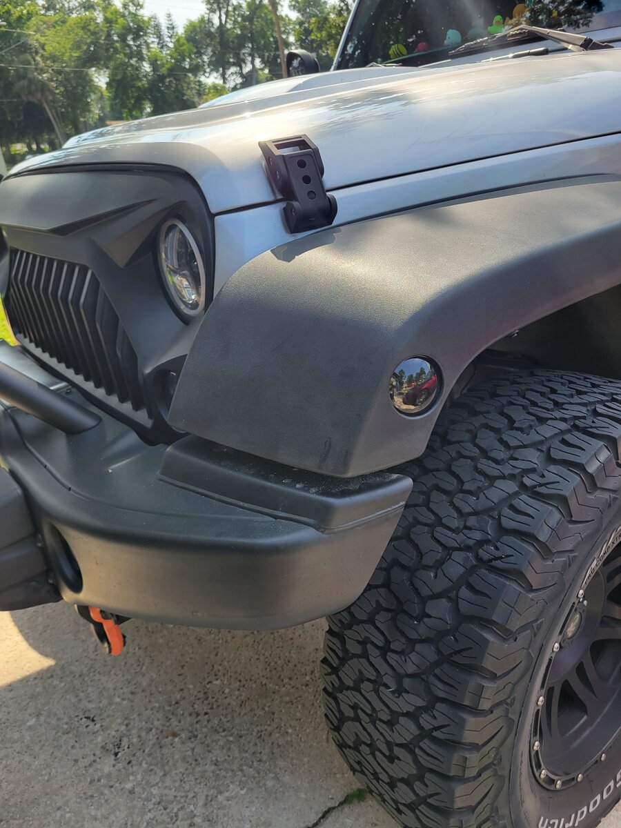

Managed some time to work on the jeep today. Been so busy moving the past few weeks, just haven't had time. Nothing major today. Added the dead pedal and led side markers. Tomorrow I'm going to re-drill and move the license plate up to be more centered with the back bumper.

Think Jeep should have installed dead pedal at the factory . Ordered mine last week . Little dif than yours . Still hasn’t shipped . So not sure what’s going on with Amazon . Usually pretty quick to ship

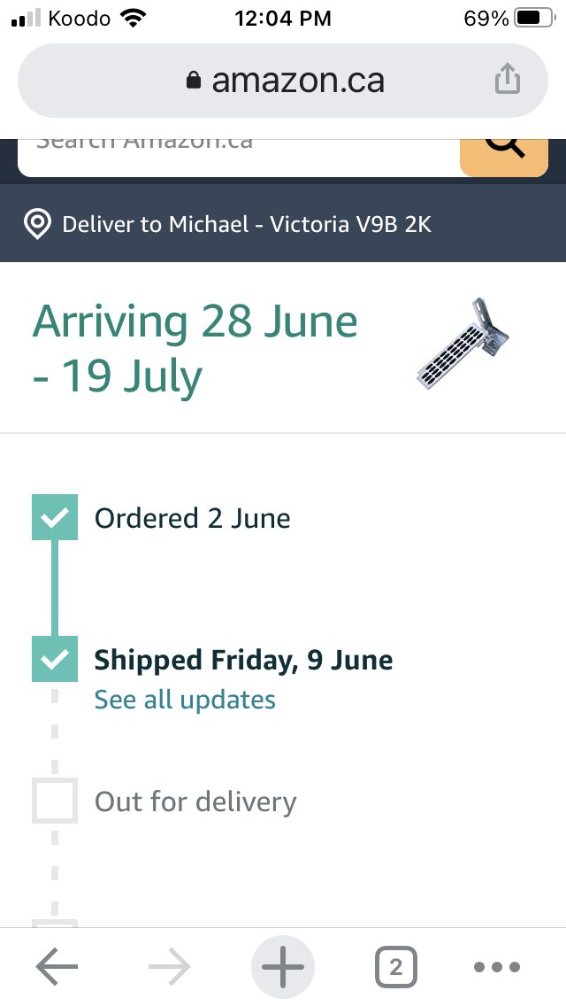

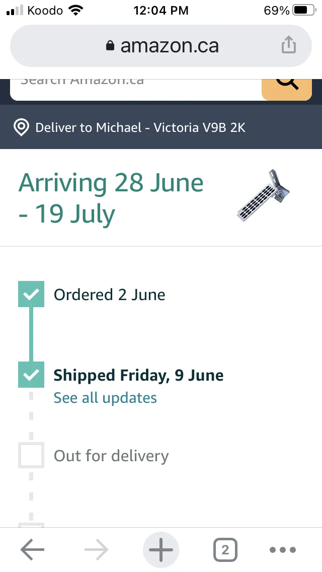

No it’s not coming directly from Amazon . One of the 2nd party sellers . It was finally shipped out . Took 7 days ?
I’ve dealt with a few 2nd party sellers on Amazon and they were pretty quick .
A week to ship is ridiculous.
[Unless they’re advertising things they don’t have in stock . It’s also coming from Putianshi , China .
The eta is June 28-July 19
Have a feeling it’s coming over by container ship . Lol
It’s just a dead pedal so not a huge deal . Just shitty service like this is annoying ATTACH=full]124572[/ATTACH]

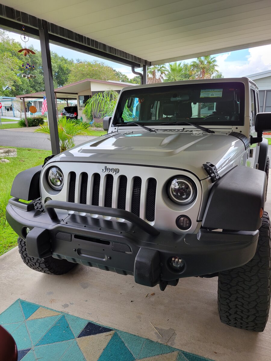

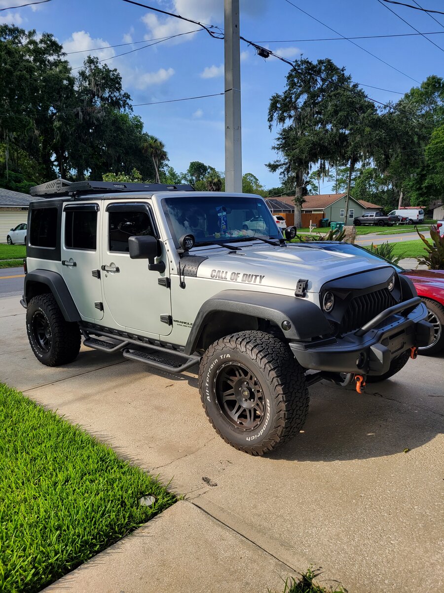

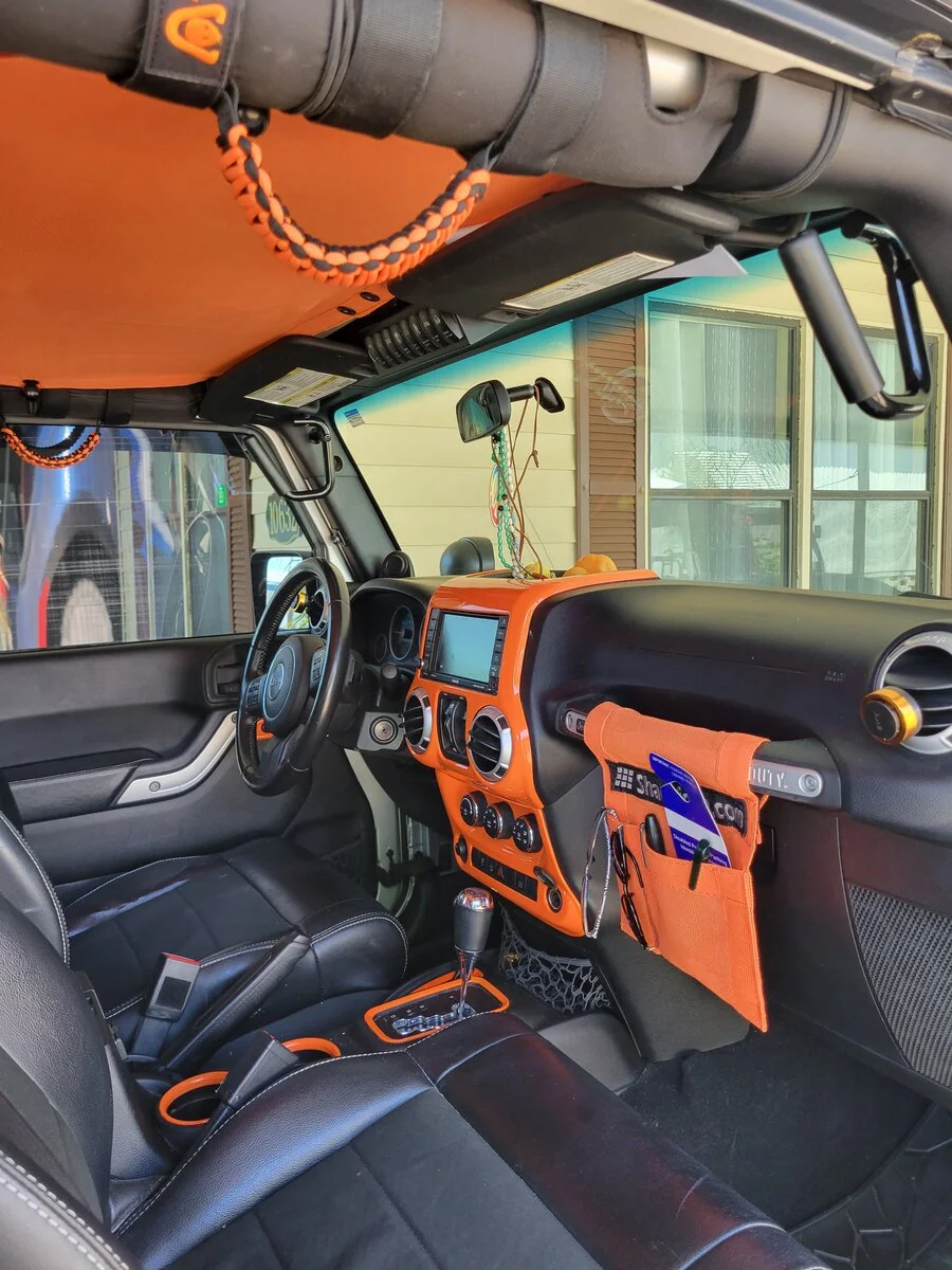

Jeep is looking good. Do you have links for the windshield lights, switch panel and the license plate hole cover? Looking to relocate my license plate.
As soon as I get a chance I'll post the links for ya. I purchased everything off ebay. Buckets, visors, lamps, switch panel, and plate cover. Thanks!
