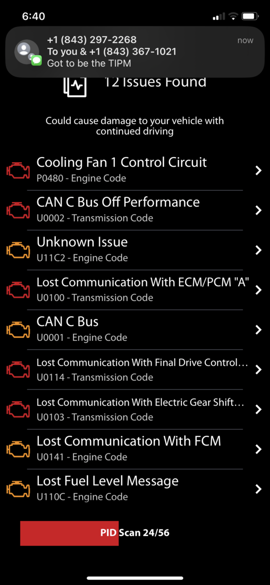

I have tried several other options to try and remedy this situation but I have still yet to find the solution. I replaced the TIPM did numerous soft resets and still with the same issues. I even had to purchase a new battery.

So after cleaning the TiPM and doing several resets, I am down to 4 transmission related codes. Hot Oil quit flashing, and only the engine light is now on. and it now shows a transmission temperature. U0114, U0103, U0100 and U0002 and they all say "transmission code". So that leads me to believe that a ground related to the transmission is loose. My next adventure will be accessing a wiring diagram and looking for the issue one inch at a time. Anyone had that issue and may know a typical place it might happen? You guys have all been real help thus far!!!!
