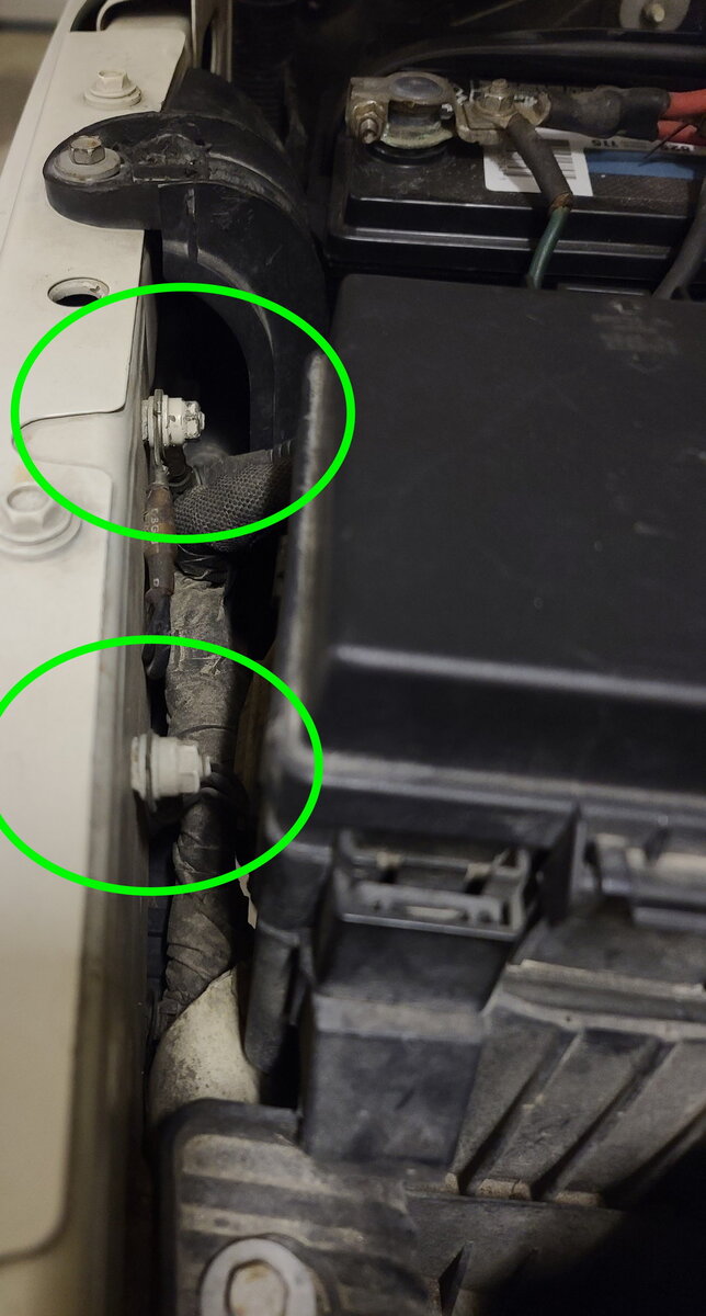

I plagiarized this from another site, I think it's for the 3.8, but I may be wrong.

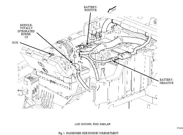

G100

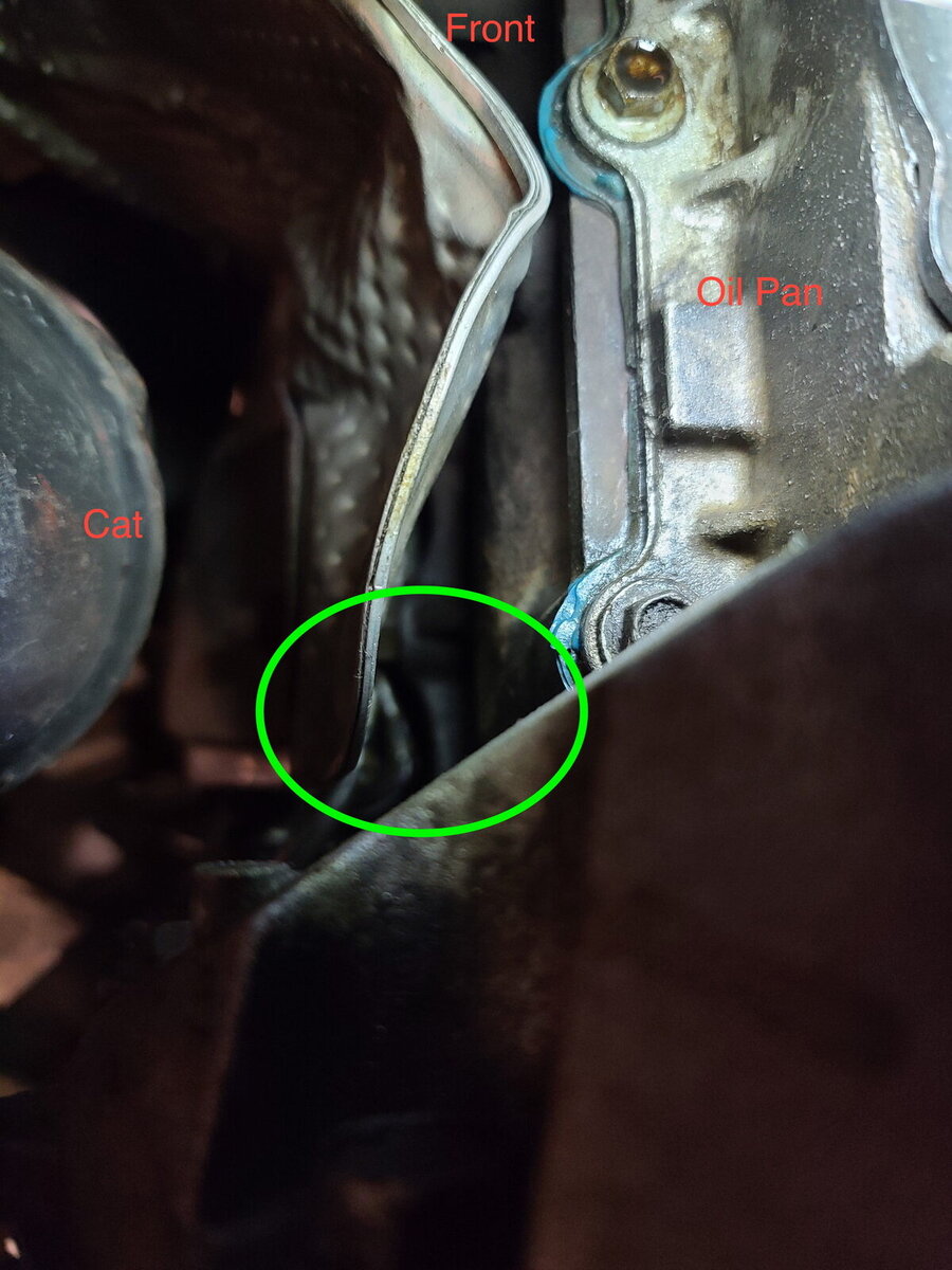

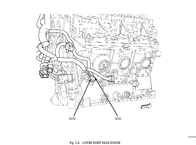

G101 and G104 - These can be found under the heat shield near the catalytic converter on the right side (passenger for US folks) of the motor

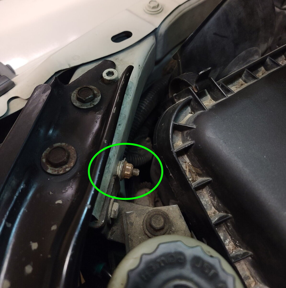

G102 - This one is missing from the service manual. It's located just to the left of the right side (passenger) headlamp assembly, near the power steering reservoir:

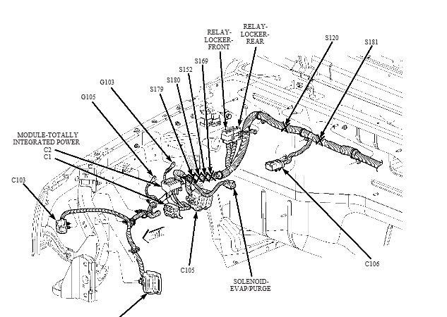

G103 and G105 - Right (passenger) side of the engine bay
