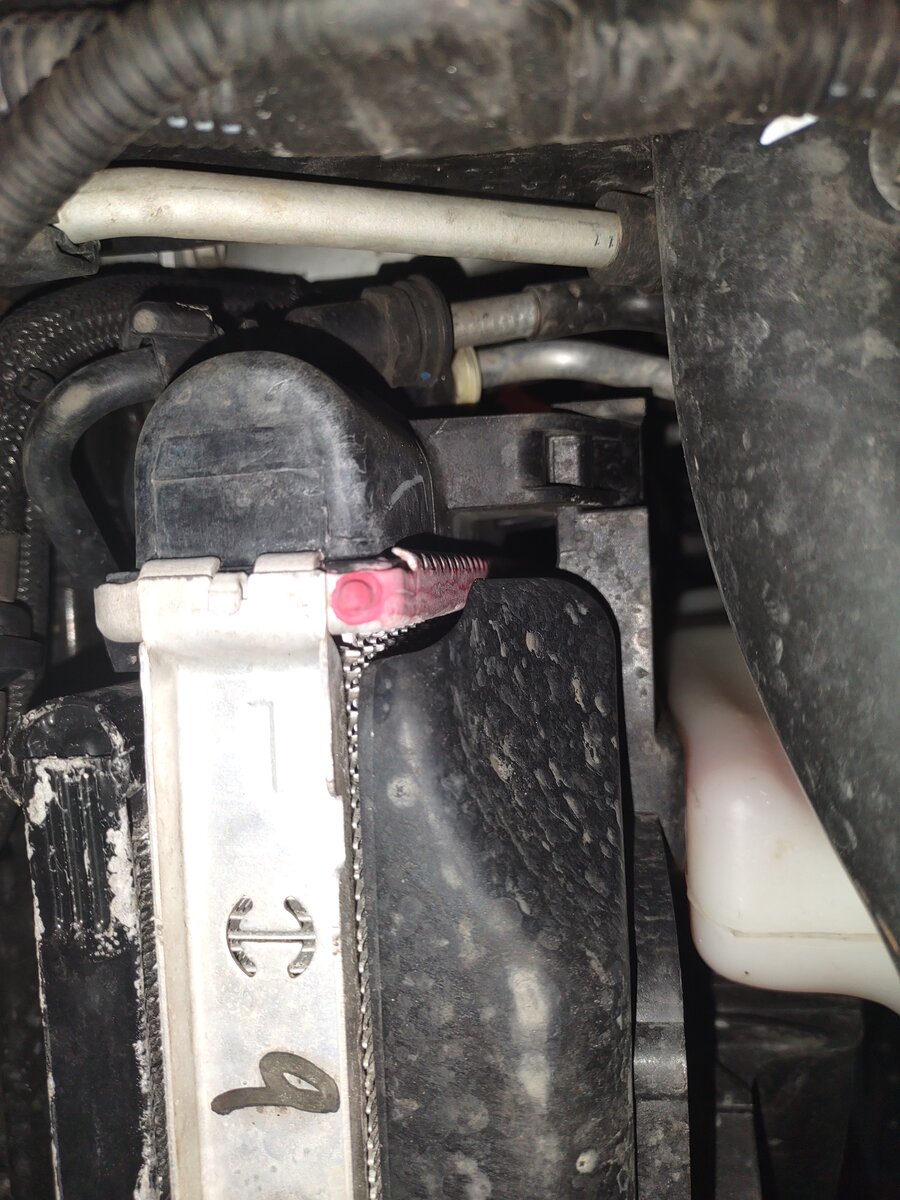

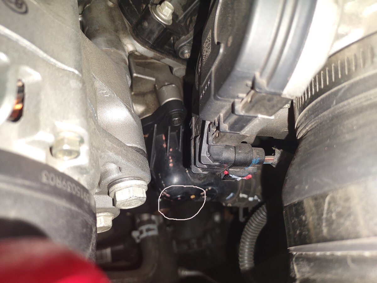

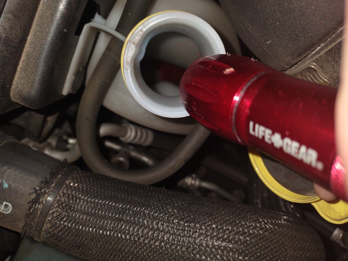

So I noticed this today, pinkish purplish crust build up. The one pick shows the overflow tank extremely low, normal? The other pic is hard to see but its some build up, not sure if it's been there all it's life or what from standing in front of the jeep on the drivers side taking the pic. The other pic you'll see some pinkish stuff, it was worse than this because there was quite a crud of crusty build up and it wiped all that off (circled part of the image, it was a nice build up, kinda like an ant hiil)
Backing up, I noticed that the hoses and everything have white lines to where they connect everywhere because I guess the tech needed to mark everything so he or she could put everything back correctly (actually it's all over the engine bay) when they replaced the sensor in the back of the block.

Ok so I got a like on my reply lol. Is this an issue I need to look into or some normal abnomoly? Theres no other signs of this crust anywhere else, just those 3 pics. Also there is nothing wet at the bottom, all dry, nothing on the garage floor.
It looks like your coolant reservoir is low so you could possibly have a leak somewhere. Best thing to do is to clean all the colored stuff off and then after driving it open the hood to see if you can see any new wet spots.

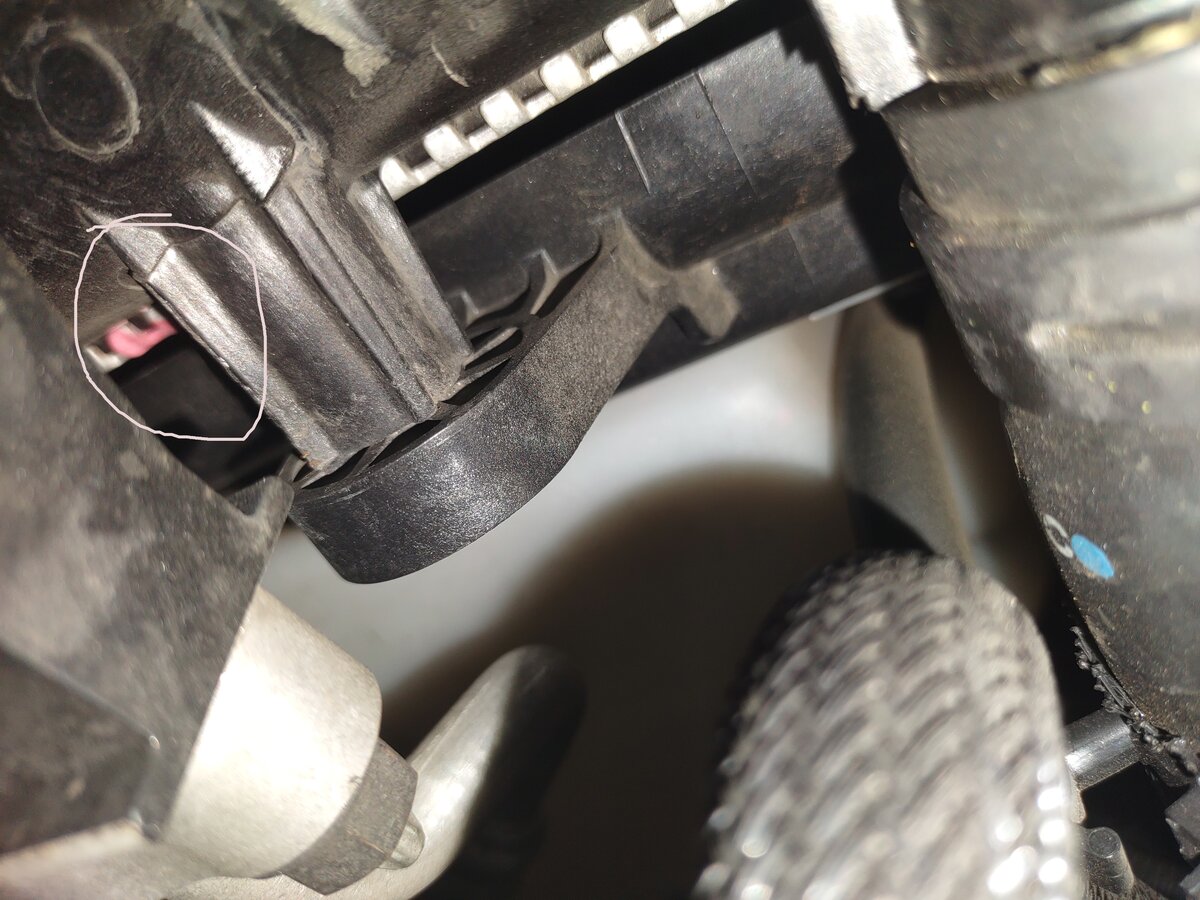

UPDATE. i forgot to look under, ugh. doubt the over flow is leaking, correct? somewhere i have a cracked or pin hole leak in the rad? drivers side looking up from underneath
Is that the side that has the radiator cap, they can go bad and leak. I had to replace mine and it only had 76,000 miles on it.
No, drivers side and i checked the overflow tank, looks like there are 2 black marks and the coolant level in within that range.
That is certainly what that looks like. The geometry of the leak looks like it developed after the vehicle was parked, may just after a trip while the engine was still hot. If that's the reservoir on the right, then it looks like your coolant is low too.

Yes we had an extremely unusual hot summer. that leak is going down so i believe somewhere the seam is leaking or leaked. but it is not leaking now. i drove it, idled it, no wetness anywhere which is weird. either way, i'm going to get the mishimoto direct fit replacement.

No, the seam is leaking on the right drivers side, i posted a photo, that is no overflow tank. also i know the correct one, OAT.
