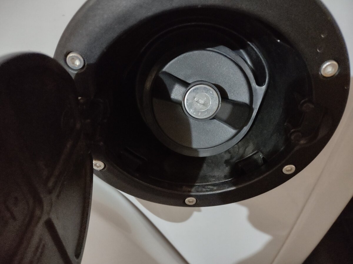

One thing I want to note is looks like the Jeeps in England have key hood lock and gas cap lock that uses your standard OEM key, so I bought those and it was an easy install

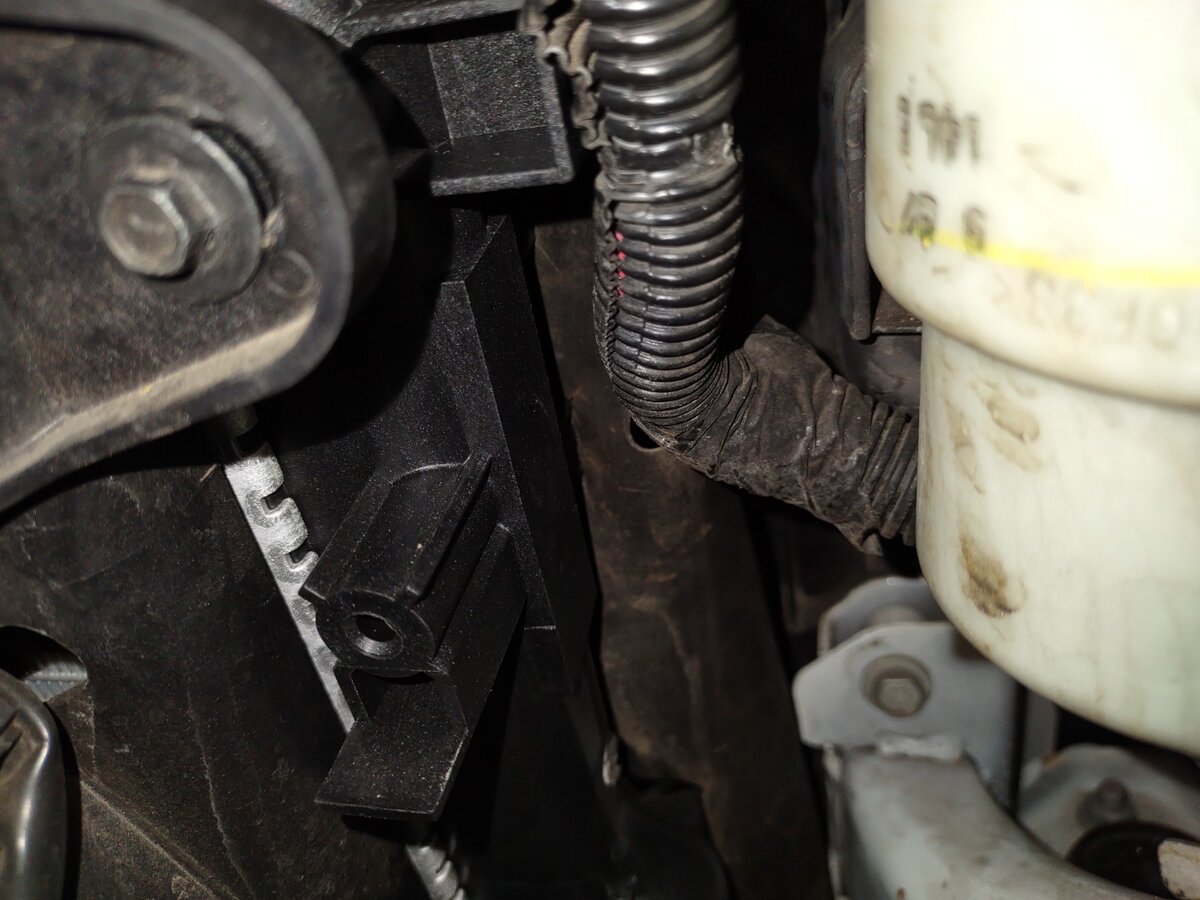

Two things I did. The overflow tank snaps into the fan shroud top and bottom and has a plastic grommet. Trashed the grommet, didn't need it, weight savings? .00000001 micro pounds
The side wiring that clips into the radiator, trashed that as when you snap the connector from the fan shroud and clip that in place it holds it securely (only did that because it was hard getting the side wiring grommet back in

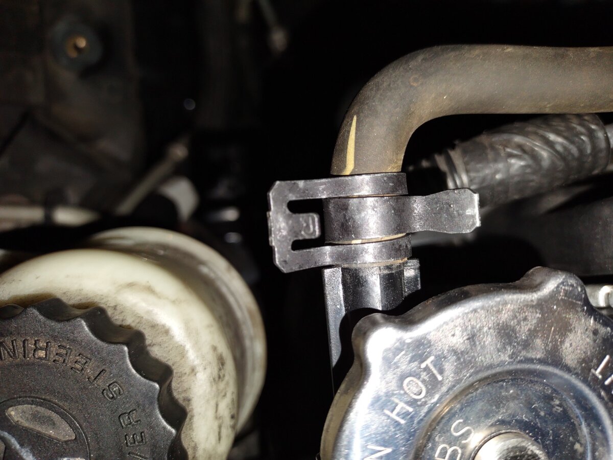

I added a clamp for the nipple by the rad cap, didn't have one in the beginning and was loose, easy fix

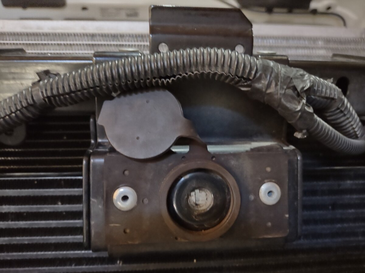

These side flap that go over the rad sides. What a pain to get back in with the rad. So what I did was install the radiator loose and calmly shove the flaps back in. And one other important thing. When you try to screw the cool, compressor, etc back with those flaps behind it, it's hard to get those holes to line up and you can cross thread at an angle by mistake and those holes are plastic in the side of the radiator SO what i did was snip the holes BIGGER with some clippers, made life easier getting those bolts back in esp the lower drivers side.

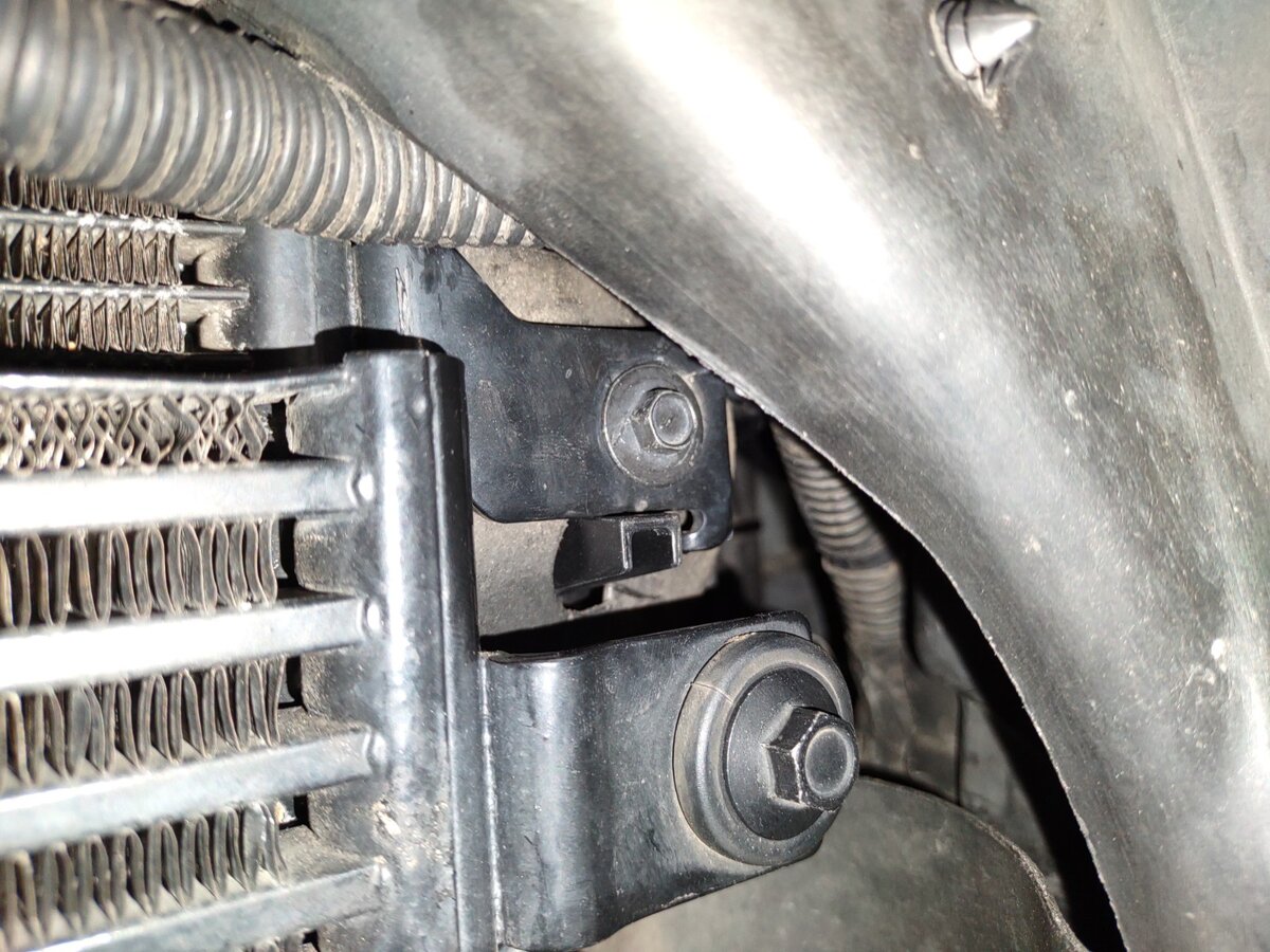

So one photo I didn't take, the bushing on the sides that fit into the body to hold it into place. I think I know why my radiator finally leaked, the stress on the drivers side. The rubber bushing was NOT in the hole on the drivers side, it never did fit, looks like from the factory, the hole in the frame is too small so looks like they just smashed that thing in and bolted it down creating stress on the drivers side seam. The new ones did not fit either, So I took the pass side from the old leaky one and used that and it fit fine.
this
https://store.mopar.com/oem-parts/mopar-radiator-isolator-52079884aa, the part that goes into the hole was not really in the hole, didn't fit, was smashed in and when i pulled was distorted
pulling out the old rad was a pain, you gotta gently work it, i pulled the pass side out back the angled it up so the right drivers side would clear the metal pipe hosing.
the ac condensor is a b!tch when installing the new rad so it will help to have someone kinda jiggle it when installing the new rad.

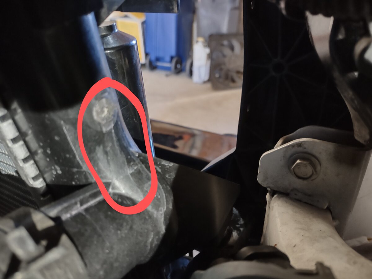

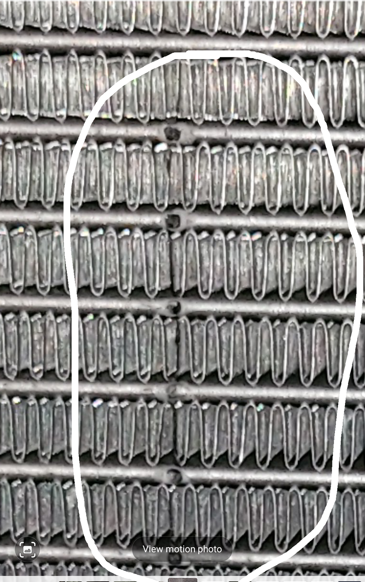

its was spewing fluid all over the side of my air box, thank good ness i was running a closed box or it wouldve sucked all the fluid in. the pic shows the dried coolant but it spewed out fast and quick, not misty but enough to drench that whole area. im pissed lol.

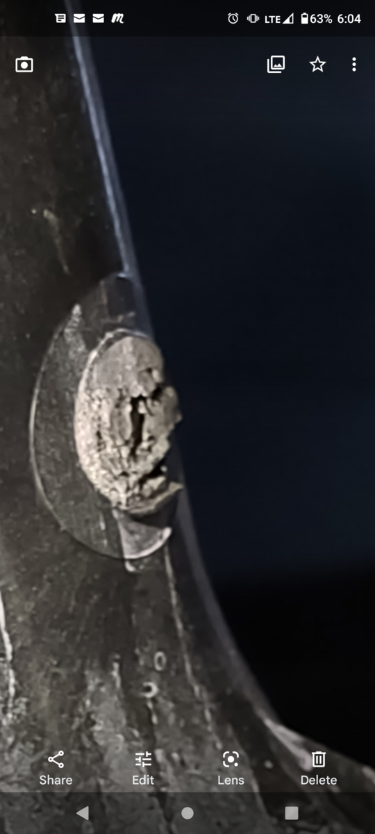

found out they pre drill holes and then fill them in. this obviously by the photo is not filled in correctly.

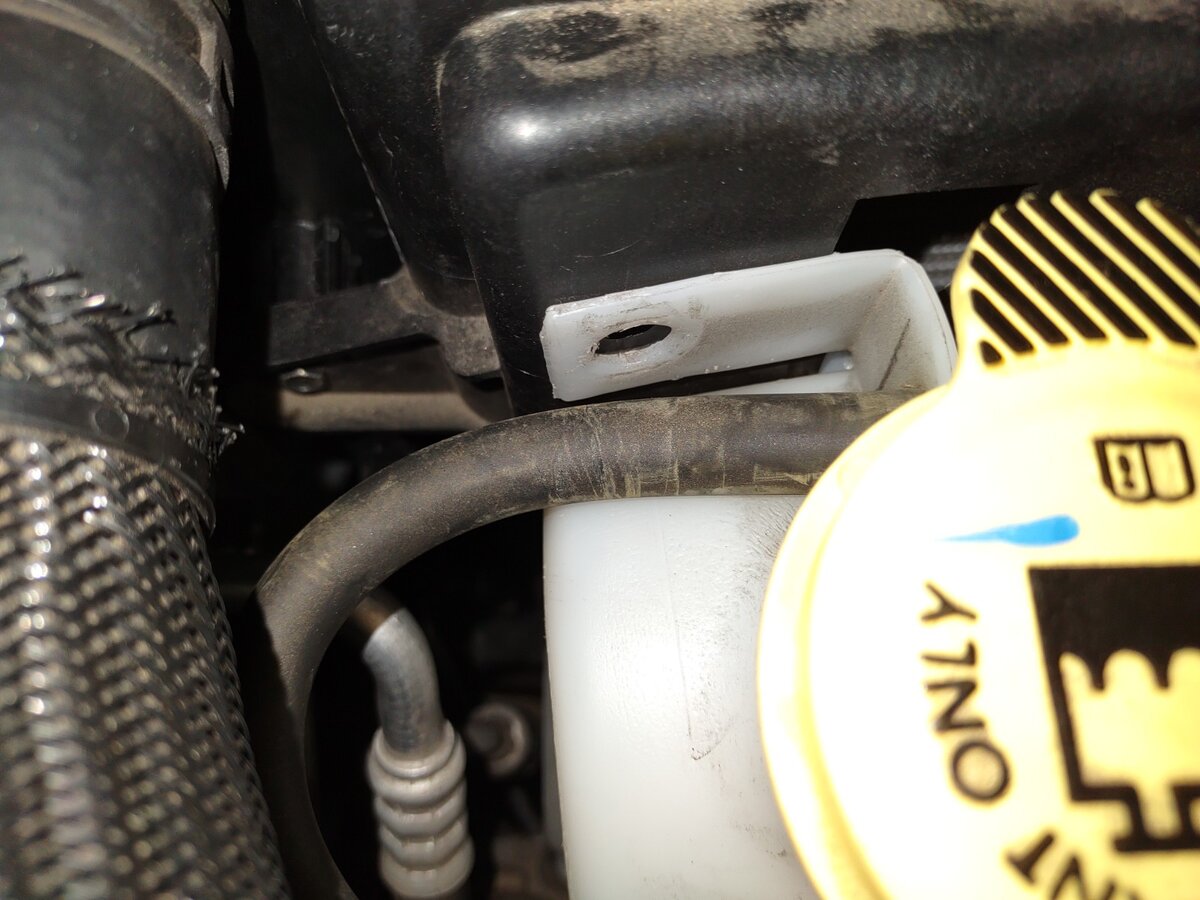

WELP ANOTHER UPDATE. I'm on my third Omix radiator. Let's say these are total junk and I highly do not recommend. They shipped my third one and received it, same blow hole issue AND LOOK AT THIS. No packaging damage, this is their QC.
First one, shipped and the rad fan support bracket was broken off, second one, well you see in this post, and third one, just explained it here. Not risking another one coming in on a Friday night only to have to wait until Monday to get it resolved.
