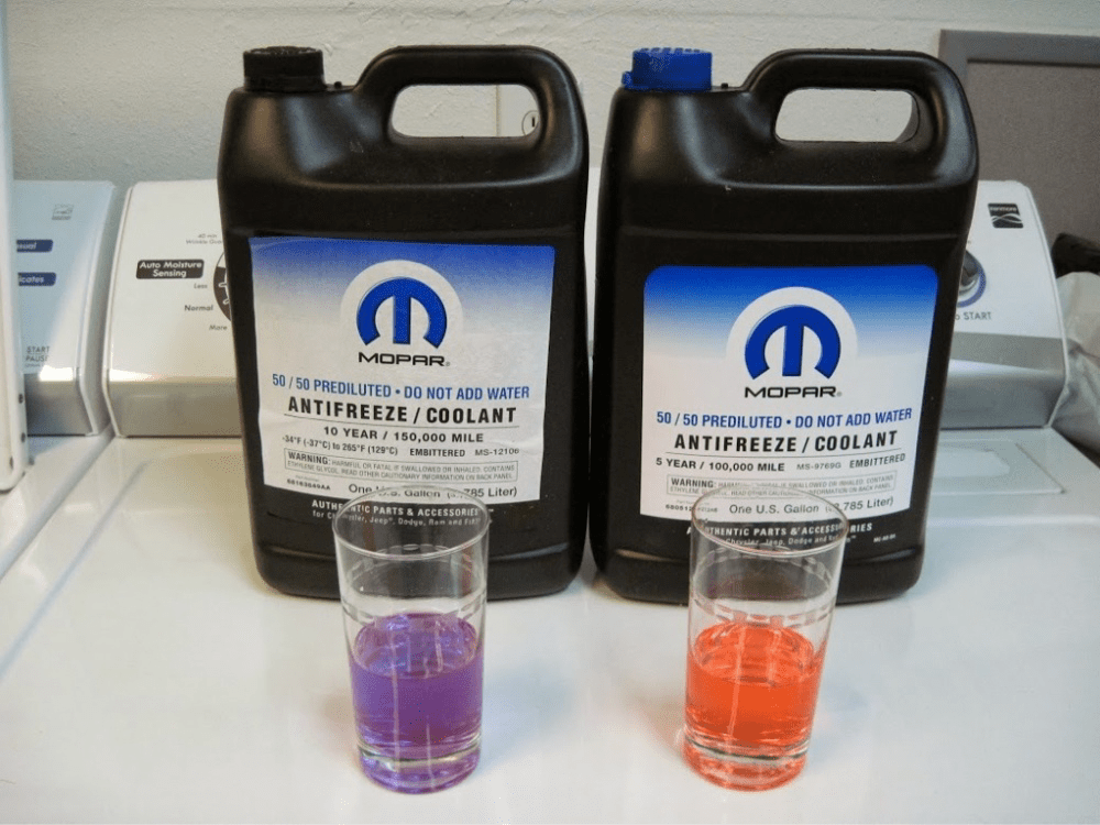

How to tell the difference. For whatever reason, chrysler doesnt label them as HOAT/OAT so you need to know the signs to make sure you are getting the correct one.
The first thing you are going to notice is the color....OAT (13+) is purple and HOAT (12-) is orange. The second thing you'll notice is that the HOAT coolant is rated for 5 years and 100K miles while the OAT is rated at 10 years 150K miles. The third thing you need to know is that the cap on the OAT is black while the cap on the HOAT is blue.
UPDATE, CURRENTLY, BOTH BOTTLES NOW USE BLACK CAPS, SO DO NOT RELY ON THIS BEING AN INDICATOR. I LEFT THE ABOVE IN IN CASE SOMEONE GETS A LEFTOVER BOTTLE FROM A THIRD PARTY
The fourth thing you will know (not from the pic) is that OAT is priced like gold. It is $50-$60 a gallon (yes you read that right) so unless you have an emergency, buy it online, where it goes from $29 a gallon or so. If you go to the dealer to buy OAT, and the price is too cheap, they gave you the wrong one.

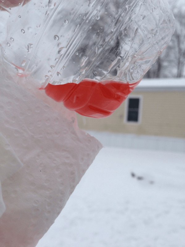

A little background on the color so that the next part makes sense to you guys....As we know, FIAT is with Chrysler now. Fiat has been using orange colored OAT for years. When Chrysler switched to OAT, they didn't want dealers/people getting confused, so to differentiate the new OAT coolant with the chrysler original orange HOAT, they added a purple dye. As a result, due to a weird light refraction, the purple OAT looks weird (even orange) when looked at certain angles. You can even pop open your radiator cap on your 14 and the coolant looks so orange you'd bet me your jeep that it's orange, but it isn't.
You saw the pic above, now compare it to this pic (same purple OAT)

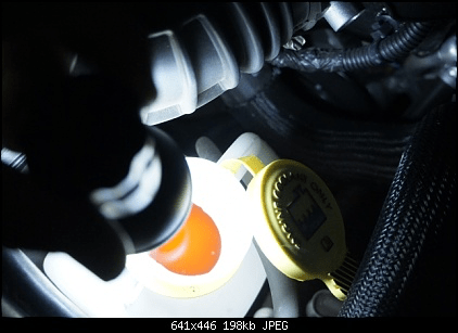

Don't believe me yet? Check this out...open the overflow bottle, and you might see this....
Orange? You would definitely bet me your PR44 that it's orange right?

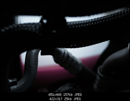

Now lets take a pic by moving the lightsource and changing the angle....
Still think it's orange?
The reason why it looks orange isn't too complicated...the actual coolant is Fiat's orange OAT with chrysler's added purple dye. When it is put into a container that isn't see-through or well lit, the sheen from the original orange coolant comes through which is why it looks orange on the surface. If you suck a little out using a turkey baster, you will quickly see that it's purple. Think of it as a VERY ANNOYING optical illusion.

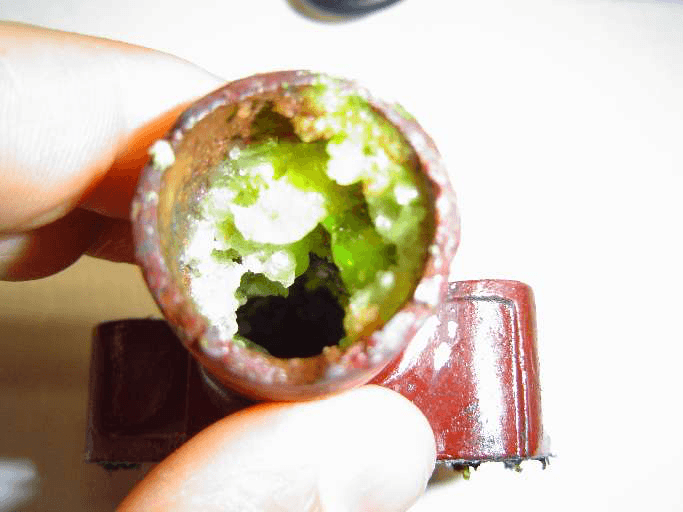

Now, why you should care....mixing the two yields to catastrophic results...if you catch it early enough, you may be able to squeak by with a quick and painful flush, however, if you run it for a little while (a month+) you can completely destroy your system by completely clogging it up.
This is what happens when you mix glycol based coolant (HOAT, 99% of coolant in stores, etc) with OAT.
