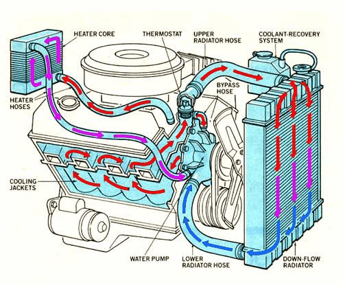

This is the basic principle of a cooling/heating system.
With this diagram thermostat dictates the pump on how hot/cold he needs the engine to be. So you have to start with the thermostat.
