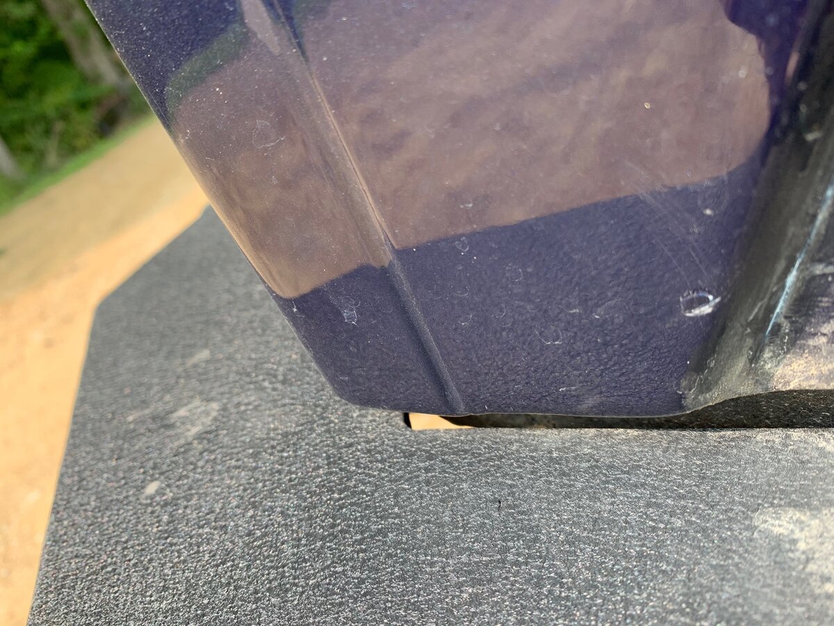

I just found my clunk after three days of looking for everything. Loose bolts, rubs, and such. I ended up having my wife drive while I had the doors off and everything cleaned out of the back including spare tire. We are driving down the road and i am leaning out the passenger side waiting for a bump. We hit some bumps and I heard the noise and noticed the after-market rear bumper touching the tub body. Yeah! Back to the shop and loosened the bolts and move the bumper down maybe an 1/8". Another test drive and so happy! Picture after adjustment.
