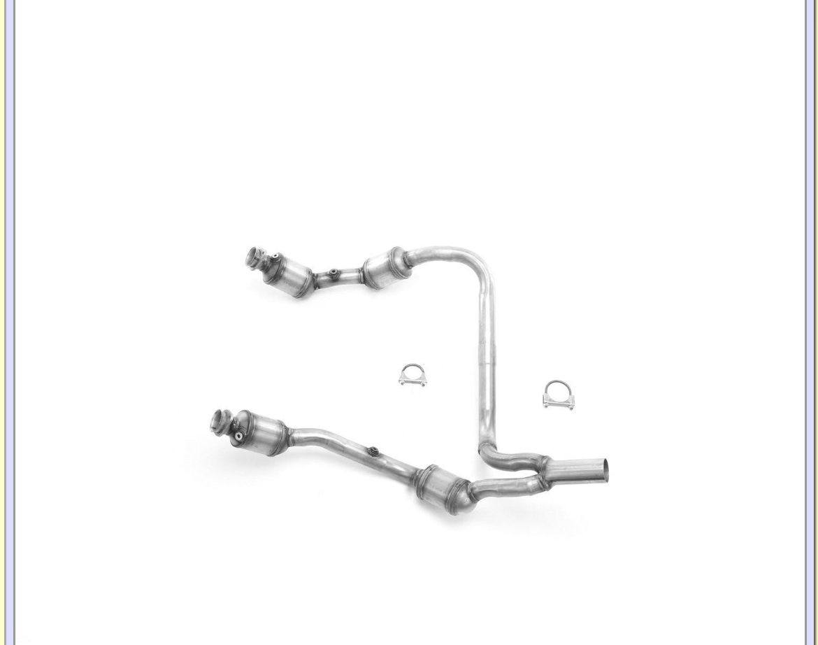

My son has 07, 3.8L and finally ordered replacement cat’s. The parts go from the exhaust manifold to the about mid point back. From what I can tell the system simply bolts up to the exhaust manifold. On other vehicles they have had some sort of “gasket ring” where the exhaust mounts to the exhaust manifold. I am not sure the exact name of the part. Does anyone know on the Jeep does the new exhaust simply bolt up to the exhaust manifold without anything at the connection? Just would like to have all the parts prior to getting it. He has ordered all new O2 sensors. Thank you for any input.

He ordered them from RockAuto.com. I did’t see any donuts in the kit, just the cat’s and pipe and a couple of clamps.

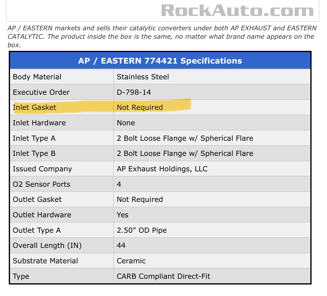

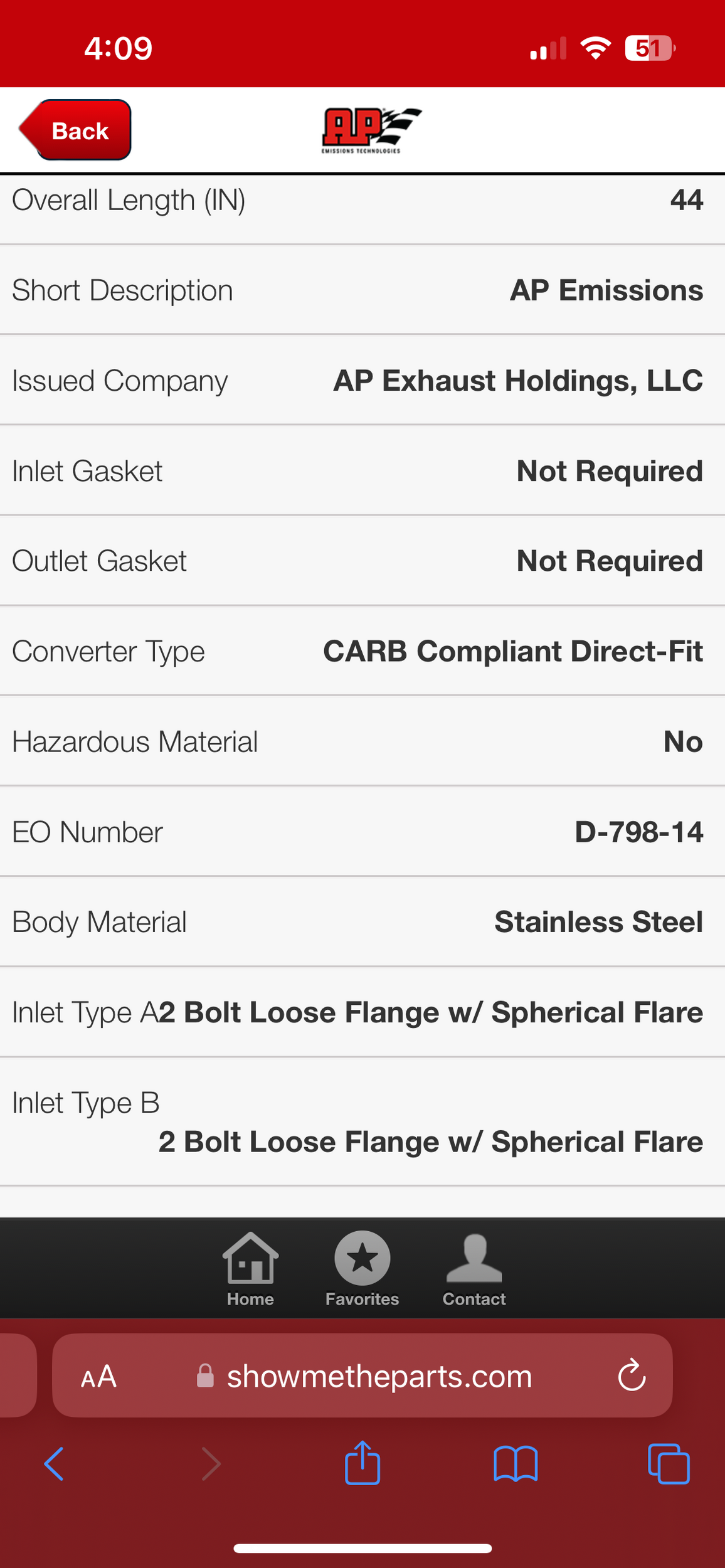

So in case anyone else sees and and has the same question, I decided to go look up the part my son ordered and per their information an inlet gasket is not required. I am not sure if it varies by mfr or not.

I am sure he could have, but in CA we have special rules and replacement cat’s have to be CARB certified (not sure exactly what the difference is, other then cost) and they have to have the executive order (EO) engraved on the cat’s. By law the inspection place is supposed to check and if the EO is not engraved or is different then what is in the system they won’t pass. The EO number is in the image below. It is crazy!

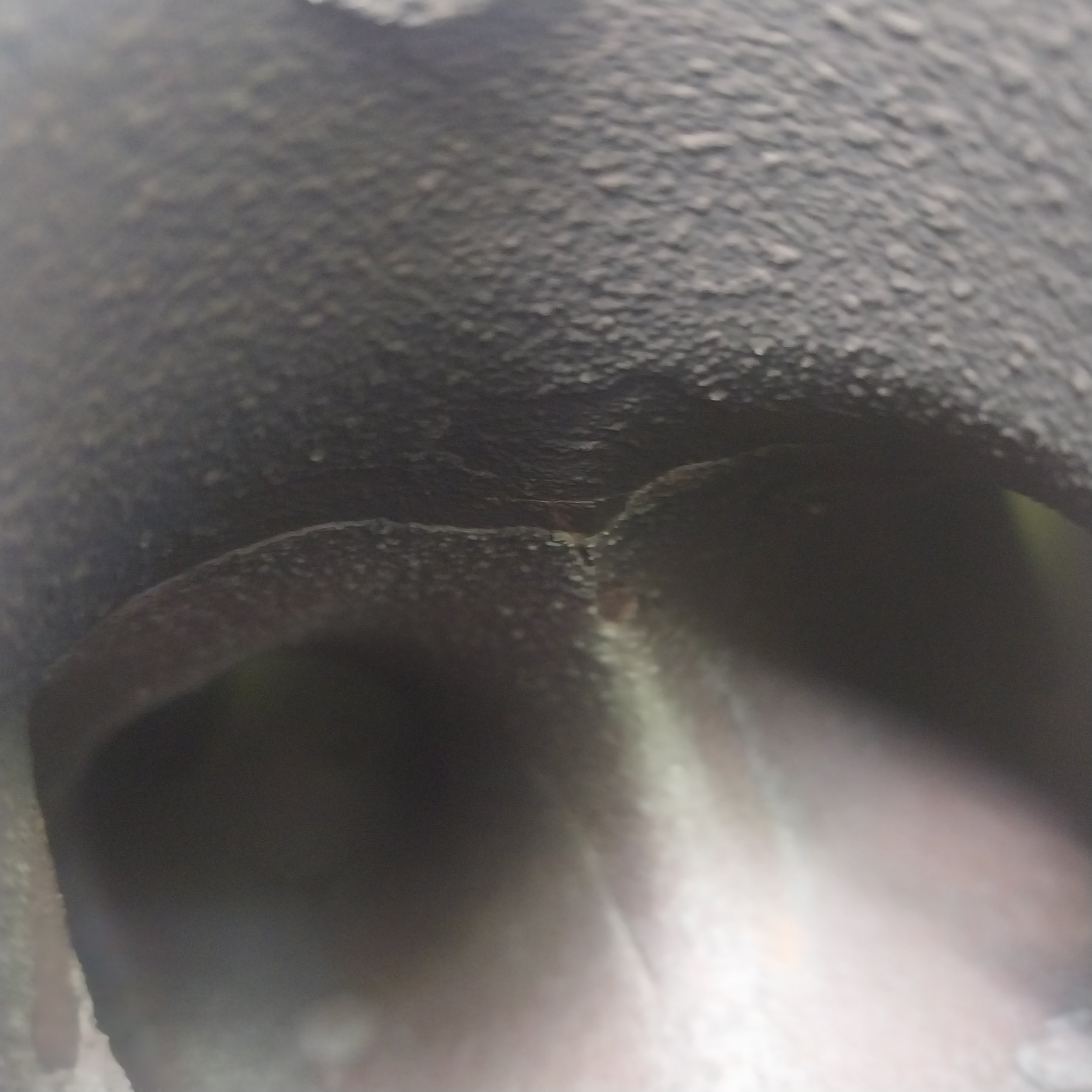

Others have said it, but I'll chime in. You do not need to use the donut. Unless your headers are worn at the connection joint, than all will be well. ReTorque the bolts within 100 miles though. I have the same kit on mine. I installed headers too. Make sure he pulls the heat shields off and inspects the manifolds as they are very prone to Crack. Suck to do all that work to have to pull it all apart to replace them. I got 180.00 for my old cats at a recycling station.
