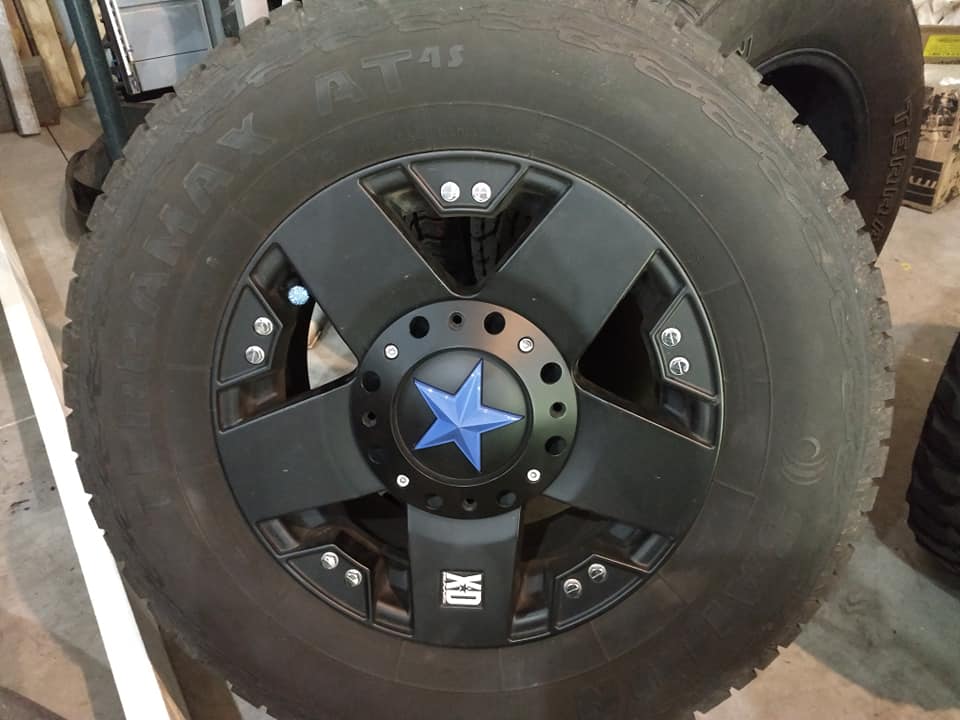

these are the rims i am looking at to start out with for a while (I am new to this jeep thing), they come with some 265x70 r17's as they show in the picture, planned on keeping those on through the winter until i get bigger tires to put on? Sound like a good idea?
I think it depends on the price you can get them for.
If they are cheap enough, sure. However, if you're paying regular money, I would say see if you can get just the rims and mount your existing tires on them.

I'm confused on what you mean, the rims and tires i have now are 18inch, these rims and tires are 17 inch? thanks

It's all good, i have those all the time haha. So in conclusion the 17's are a good way to go, lots more choices and I can mount bigger wheels later on. There is nothing major i have to change when I get 17's? It's a smooth transition?
Yep. You should be good.
I’m not sure what backspacing those wheels have, but when moving to a bigger (wider as well) tire, you may run into issues like @MacGuyver mentioned, but a quick search and it looks like those will have a 4.5” backspacing so that will work great. I would verify though since I don’t know the exact model number of those rims.
In the chance they don’t have enough backspacing you can run a small wheel spacer, but make sure they are torqued correctly. Some people don’t like spacers (I really don’t prefer them), but when it’s a small spacer and they are done correctly there should be zero issues.

Ok, so 265, I thought that may be it, but I don't like to assume. In part because I thought the stock tires for that year of sahara were 255/70/r18
I'm guessing that the reason for this is that the price is right. I would certainly check the backspacing before purchase. Here is a video explaining in exhausting detail how to measure. Click here
