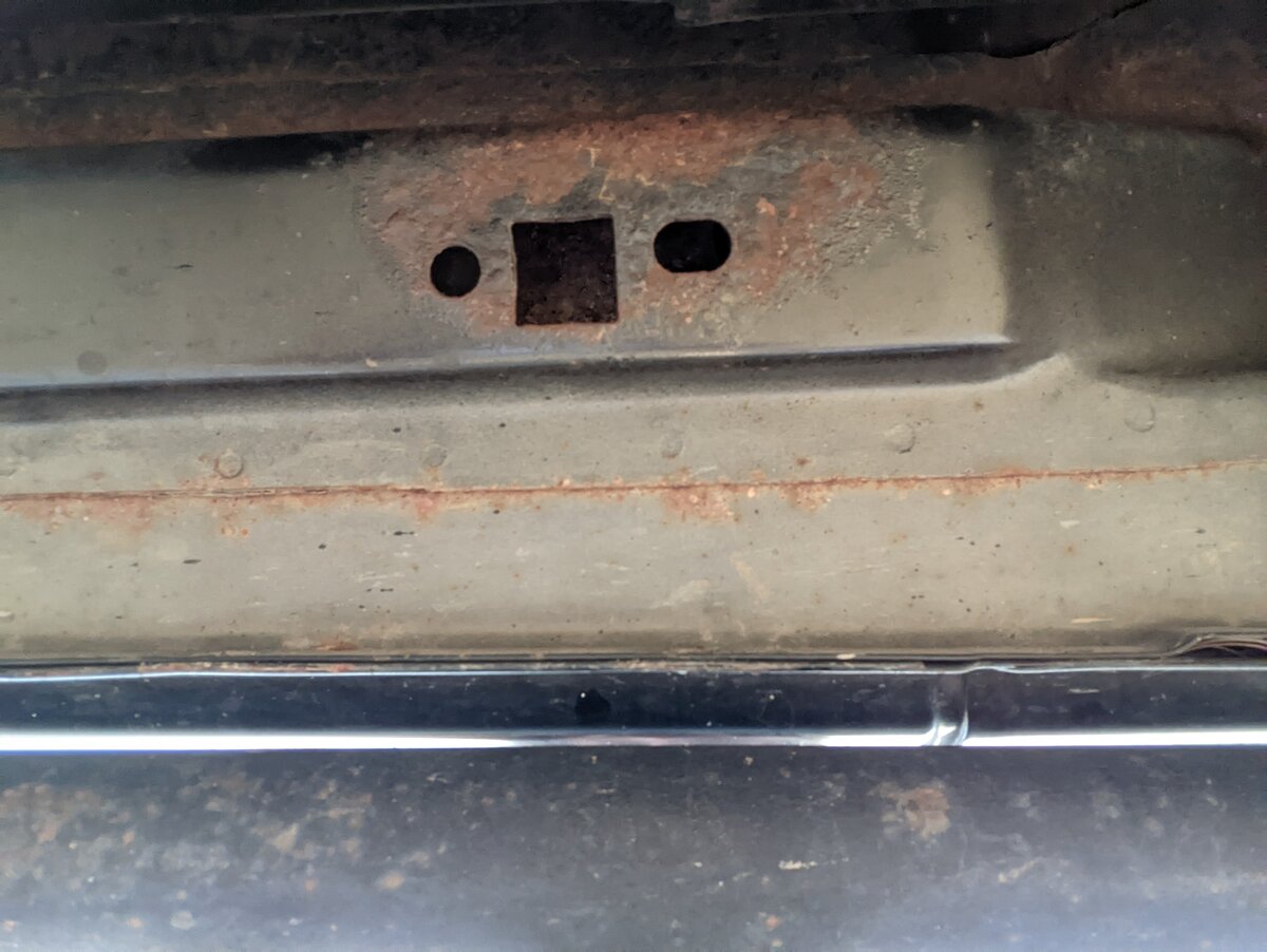

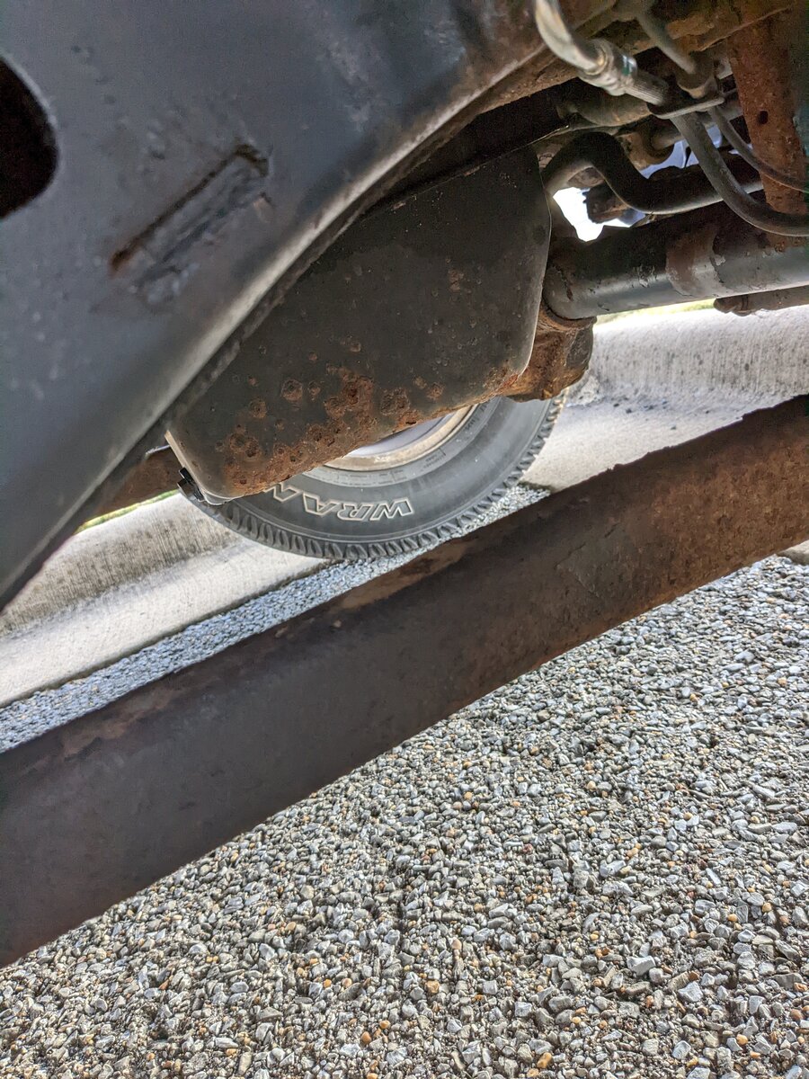

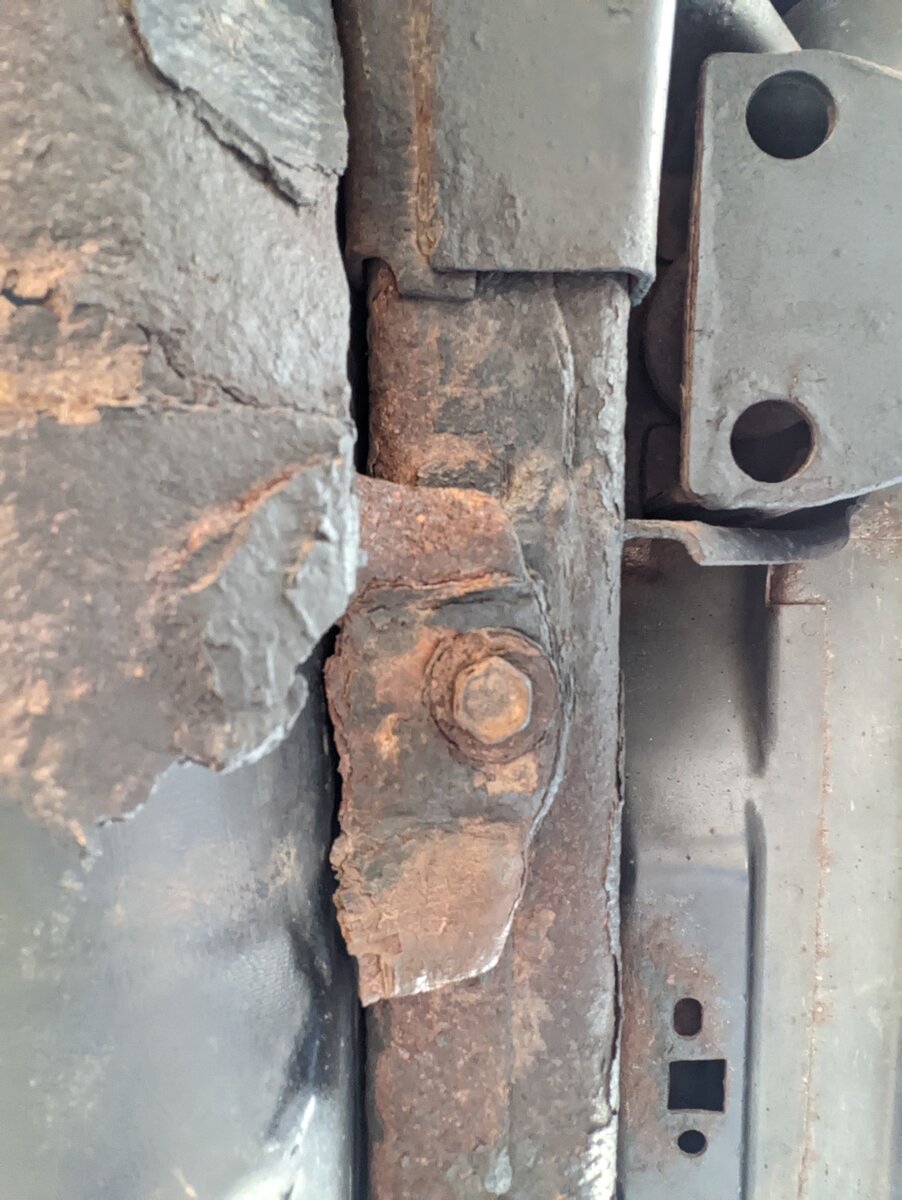

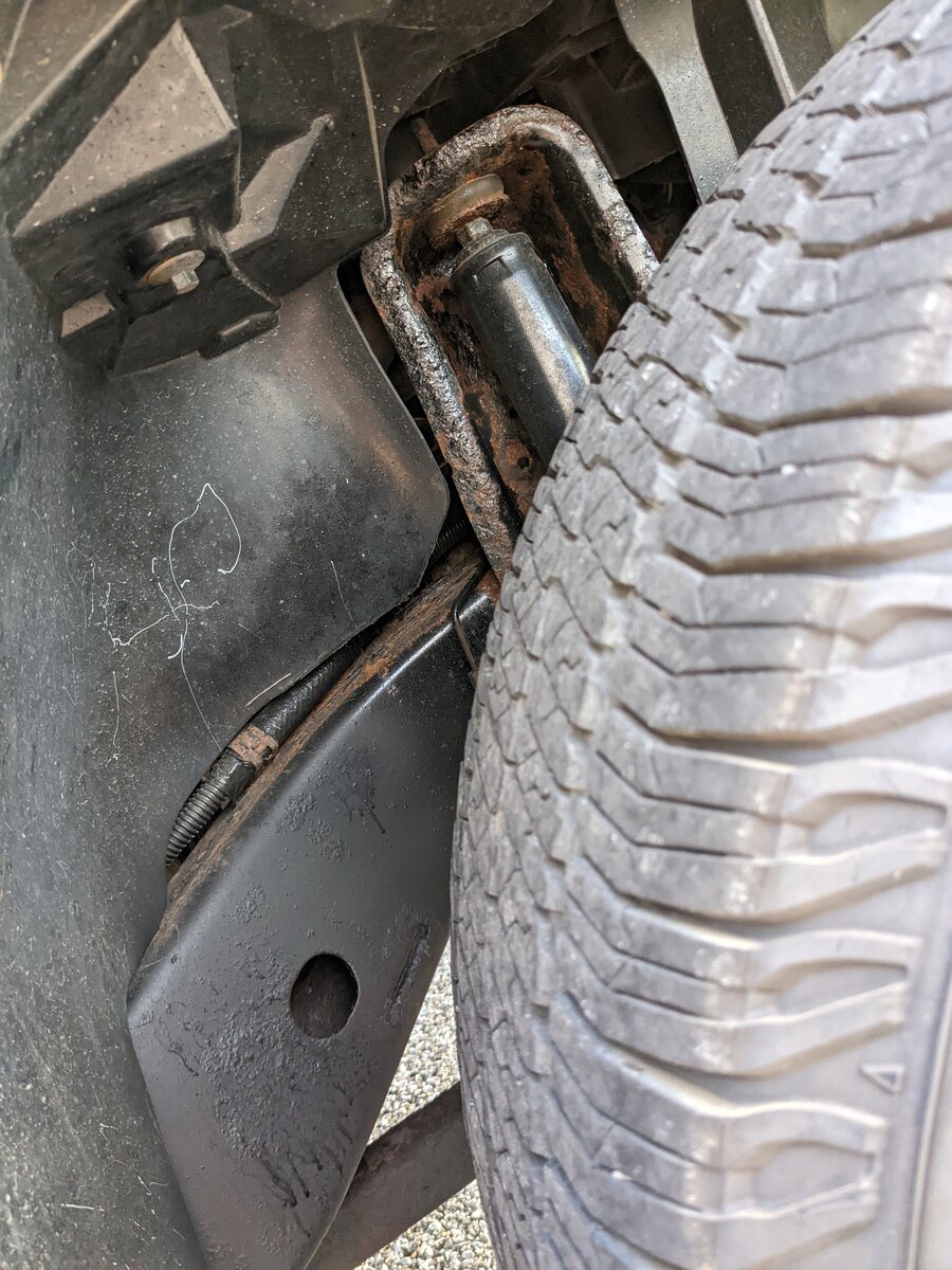

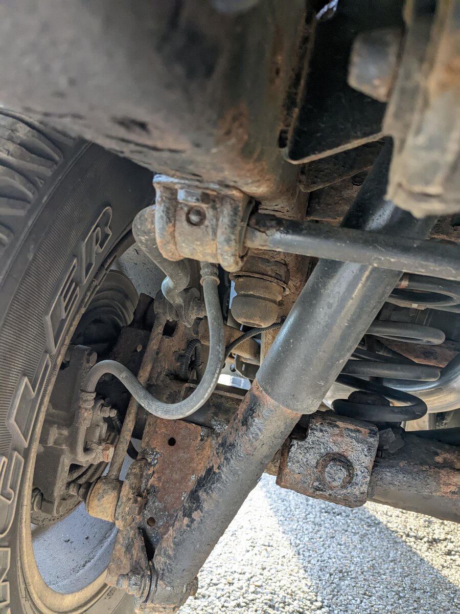

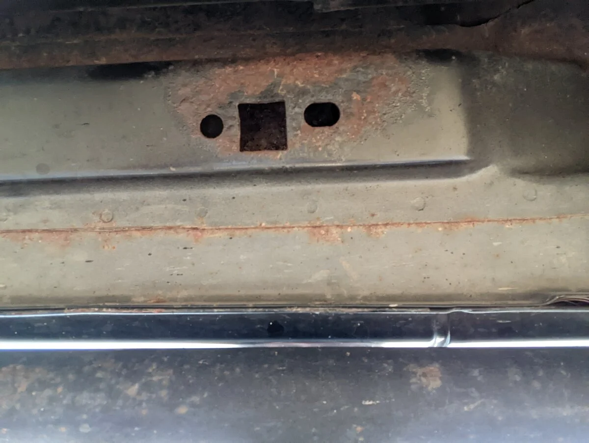

Is this 2011 JK with about 94k miles at $16k in AR worth it, or should I keep waiting and searching? It has been mostly in PA and then MI, so I think a lot of road salt exposure. Dealer had a small exhaust leak fixed and will have rear axle work done. Curb appeal and interior good, seemed to drive and shift OK on 2 test drives.
Someone definitely tried to rattle can black over the rust to cover it up! Your shock tower picture is a dead giveaway. There's a tape line and paint that ran down the frame at the bad rust spots. Your rear shock picture looks like there could possibly be a hole in the frame by the bump stop? Hard to tell if it's a shadow or not. Even if you think it's a good deal and buy the Jeep, you're going to have headaches trying to replace things that need replaced. I'm saying stay away.
I could see what looked like black underneath but also uncovered rust. Taking your advice, thanks!
