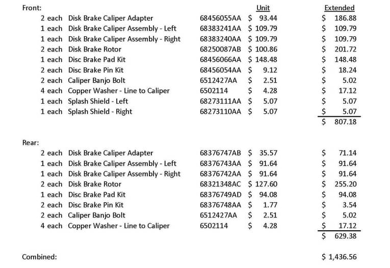

Here is a rundown someone put together on FB. Prices are probably outdated and some parts may be superceded, but it gives you an idea. What I like about this route is all OEM.

If I remember correctly those are 1/2 ton Dodge Ram brake parts from I think a 2007.
