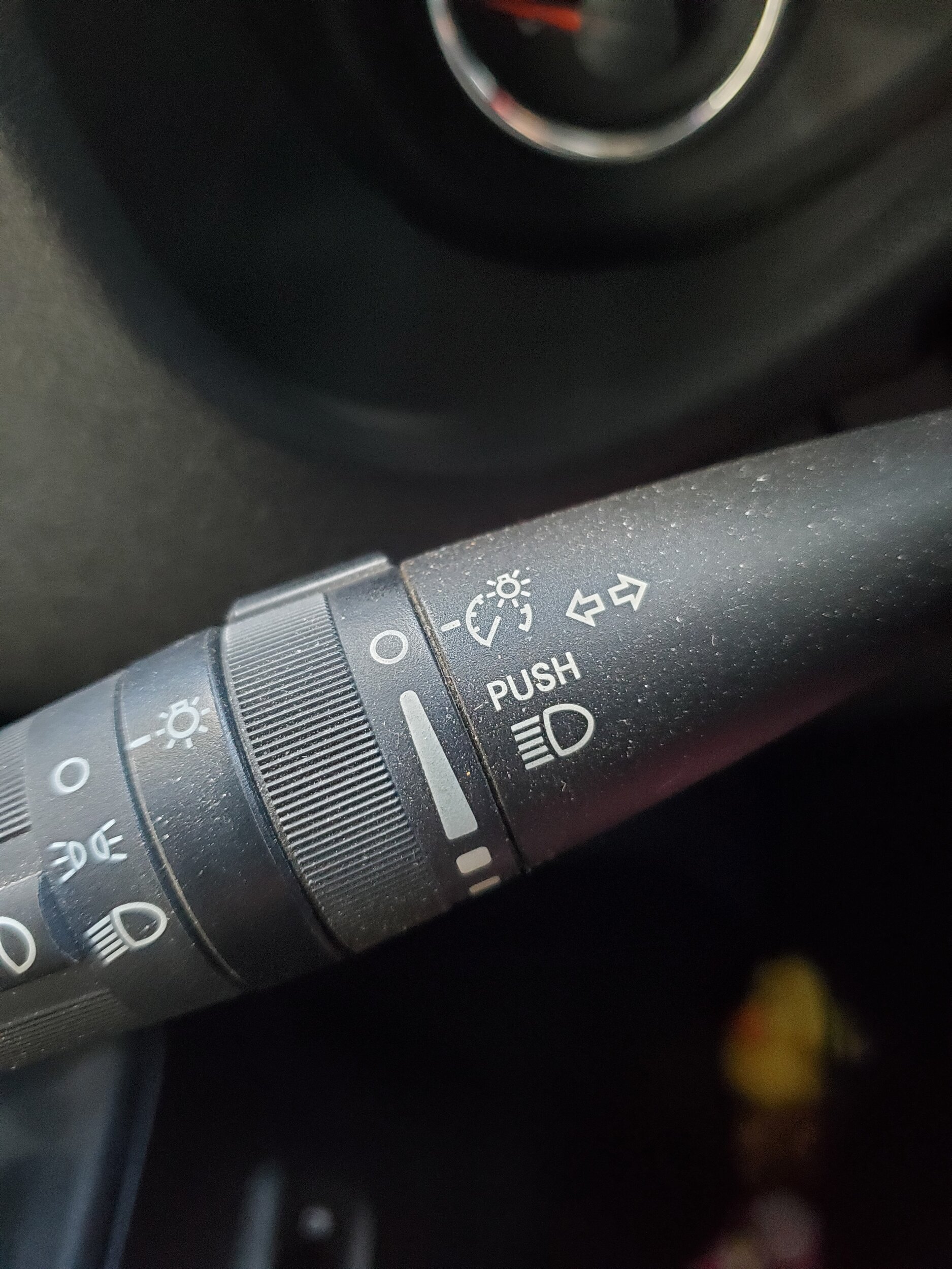

On a side note. I noticed that my dome lights no longer come on when opening the door. Could this have something to do with disconnecting the battery when I changed the clock spring?
Are you sure you didn't turn them off on the stalk? This is the off position.
