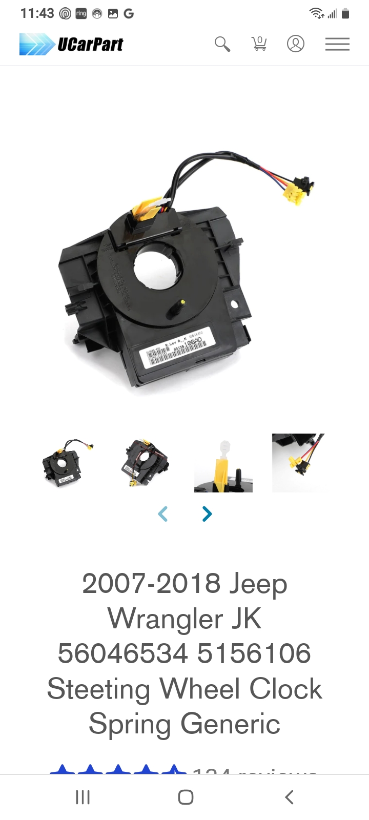

Hey man sorry about your issue but it's sounding like a clock spring to me ..Need advise on what to do about replacing my BCM. Local garage telling me $1200 just for the part. Looking for alternatives before bitting the bullet on this one (
Thanks, I'll check the clock spring out. I looked and couldn't find the BCM anywhere! Not behind the kick panel or in the floor. Any ideas?
I think that is the air bag retainer and assembly here's a picture of the clock spring
Yes you'll have to remove the airbag and steering wheel in order to get to the clock spring. I don't know of any way to test it, but the clock spring is the electrical connection for your stalks & SW buttons.Does the steering wheel have to be pulled and airbag disabled in order to change the clock spring? Is there a way to test it without pulling the wheel? Thanks again for all your help. I have a 2012 call of duty edition w/3.6 engine.
