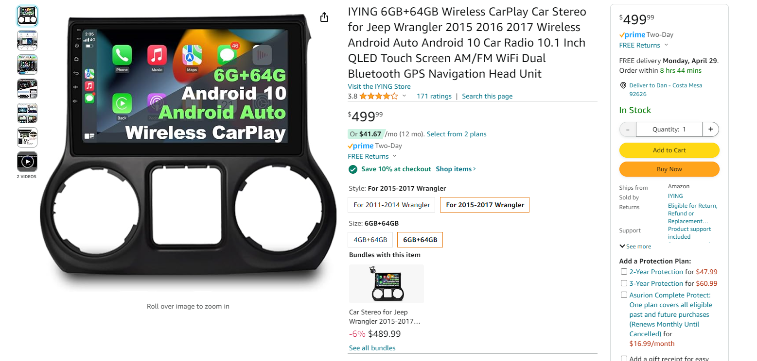

I also installed a RVC and used JSCAN to enable it on the OEM navigation unit in our 2015, then I upgraded to an Android 10.1" touchscreen unit rather than pay $100+ for the updated map software.
I opted for this, and so far it's been good.
I had a few issues initially that a software update resolved, and I managed to break the supplied bezel while installing it with a heavy hand.
They even sent me a replacement bezel for free when I asked about purchasing a replacement.
And as for the RVC, I bought a very middle of the road version for about $20 that works just fine. It's not like I'm taking award winning 4K videos with it.
