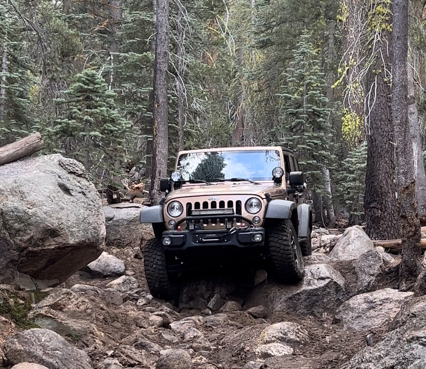

With over 6 months of the lift very happy with it. The ride quality is better then stock, on and off road. The Jeep corners very well and is stable without roll. Different lifts are designed, geared towards different types of wheeling, but I think the AEV is a good lift, comes with basically everything that is needed and I think will give long time of service and would definitely purchase the lift again. Off roading consist of dirt roads, snow, old logging roads and some rock crawling. I think the flex is very acceptable depending on your needs. Below is picture showing some of the flex and this is not even at the limit as the tires are still on the ground.

The rake is still there, but not as pronounced as stock. I am not too sure how much of an issue the brackets would be, they are somewhat close to the tire so that helps the ground clearance. I bought a set with the first lift, but waited to see how it drove without them and overall seems fine. Welcome on the write up, just thought id share my real life experience with the lift. Teraflex and MetalCloak make good systems too. Seems like those are the top 3 I hear about.
