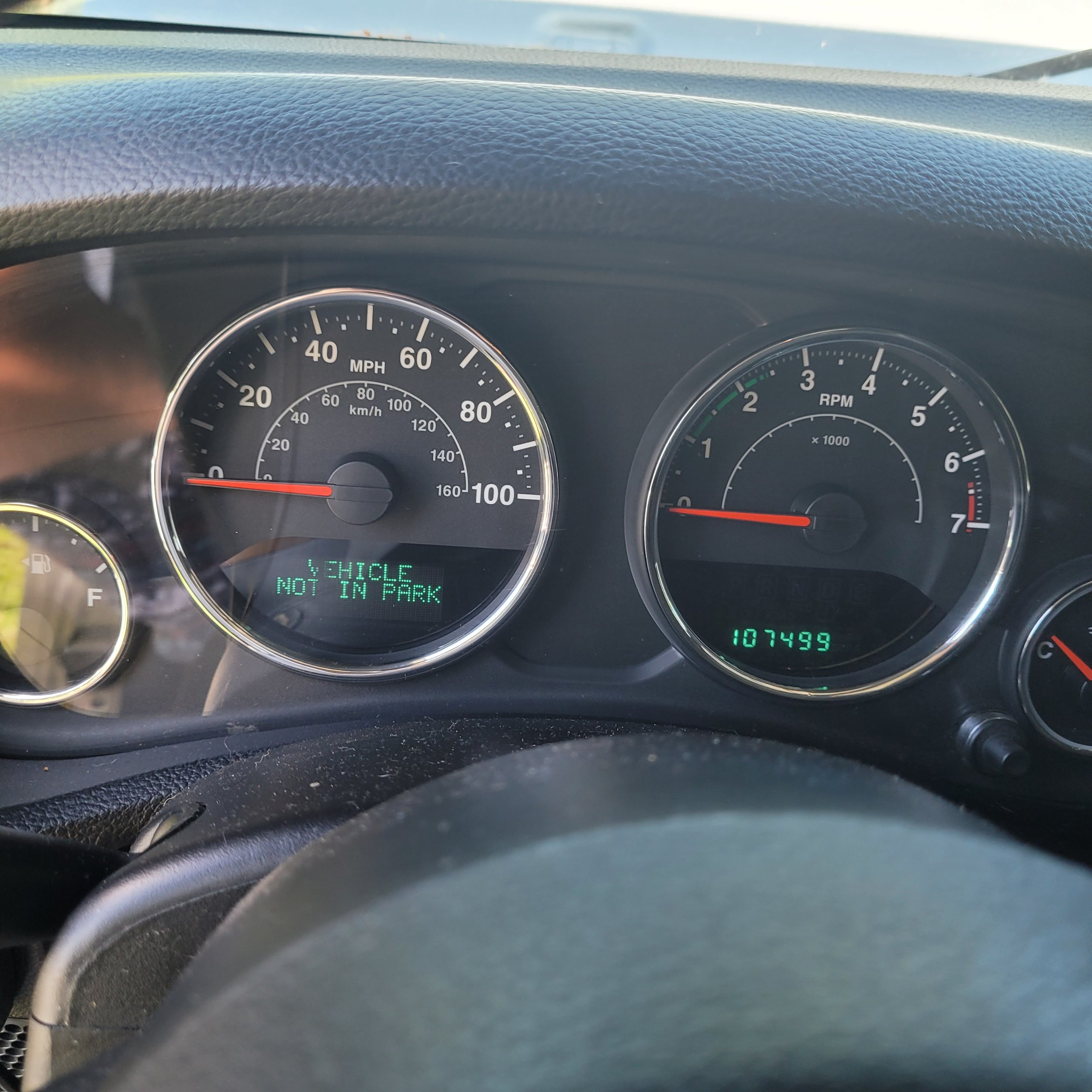

Add on info: I did notice when went to start after putting new battery in "vehicle not in park" had returned (from before new tcm was programmed). Talked to the guy that programmed it and he said it was reading "no communication with PCM" but TCM was programmed & not in park had cleared. So not sure why that is back again. Am going to start at the wires off fuse box and slowly check each one.

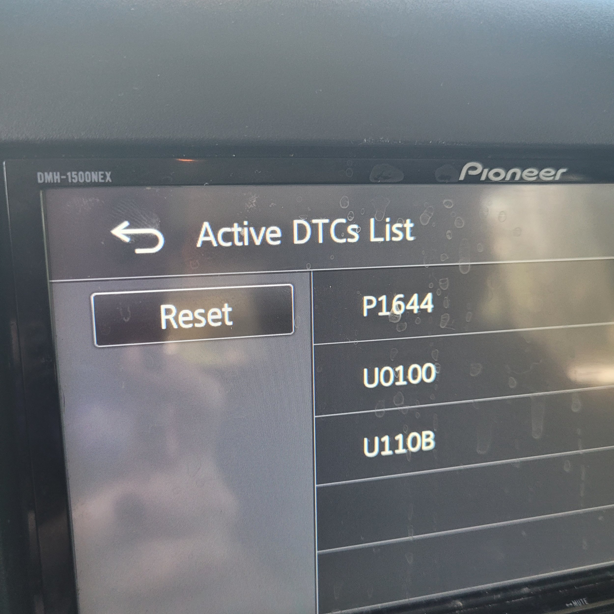

Clicking stopped in relay, go figure. (Nevermind started again, pulled relay and put back in and it stopped again) Got it to turn over, but immediately shut off. Was able to pull codes: P1644, U0100, U110B. U110B is what led me to replace the TCM (regarding all the random codes was getting on and off led to believe it was going bad and was cause of faulty codes). Had a guy come program the TCM, but is still showing not in park and the above codes. He had said it lost communication with ECM but was programmed. Not sure if believe him at this point.

These are current errors showing.
The vehicle not in park could be the shifter bushings are bad, have you tried starting it in neutral?
Yeah will turn over and start in neutral. This came up after put in new TCM. Guy that programmed it said that was cleared and it was properly flashed but since it's back ....? Guessing he didn't program it correct, which would explain P1644 code. Still stumped on lost communication to ecm. Really do not want to toss a new one at it!
