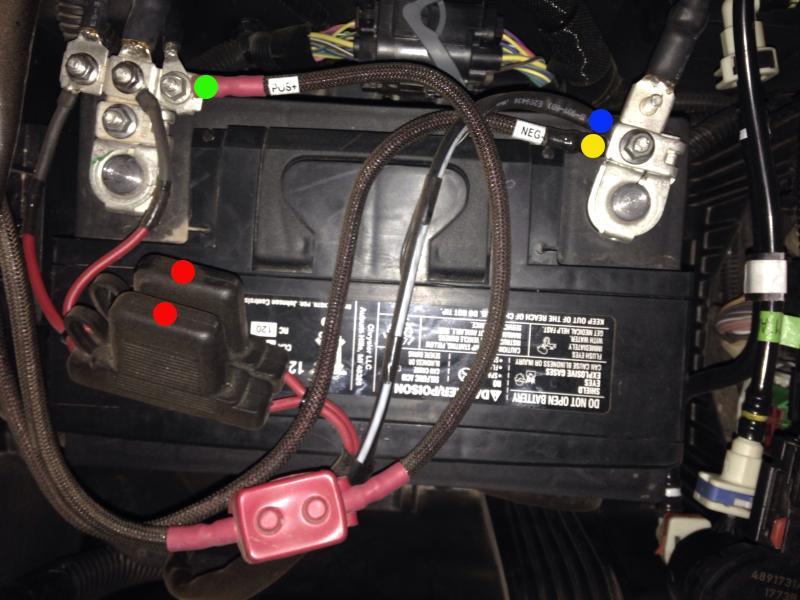

Pop the hood and disconnect the positive battery cable from your battery. Ground the positive battery cable to the negative battery cable for 30 seconds. This will erase the electronic charge in the capacitors, which is what retains the ECU's memory. After 30 seconds has passed, reconnect the positive battery cable and shut the hood.
Figure 1. Remove the positive battery cable and ground it to the negative cable for 30 seconds.

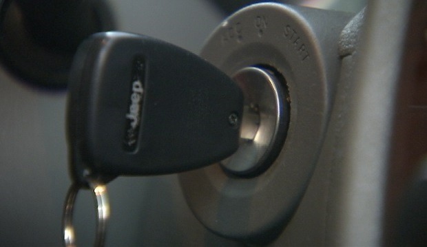

Insert the key in the ignition, but don't start the vehicle. Turn the key to the "ON" position, then turn the headlights on and back off. Turn the key off. The ECU will be reset to factory settings at this point. Over the next 50 warm-up periods, the ECU will gather the necessary information involving your driving habits and the parts installed on the vehicle.
Figure 2. Turn the key to the "ON" position.

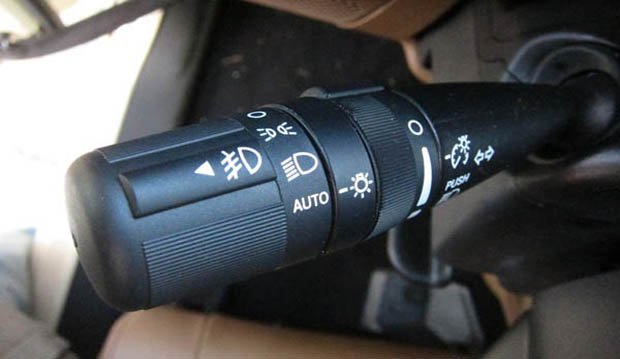

Figure 3. Turn the headlights on then off, and remove the key.

So you are saying to remove the "Positive" cable and hold it to the negative cable for 30 seconds.
Is it necessary to have the ground (negative) cable still attached to the terminal of the battery? I ask as this, as this could pose a dangerous move for some people not familiar with batteries, as rule of thumb is to always remove the negative cable first on a battery to reduce the chance of spark and ignition of battery gases.
