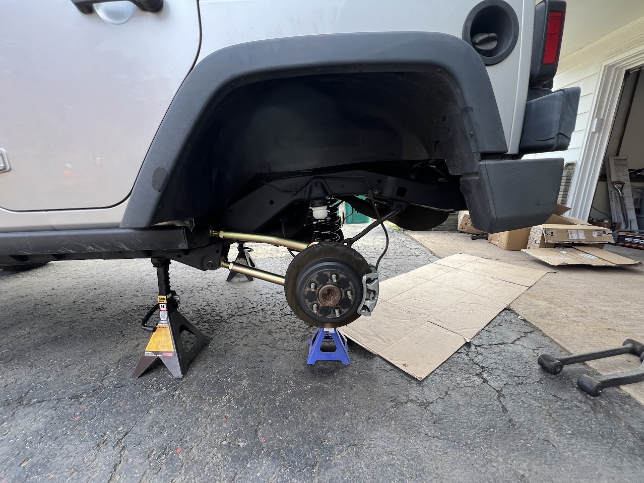

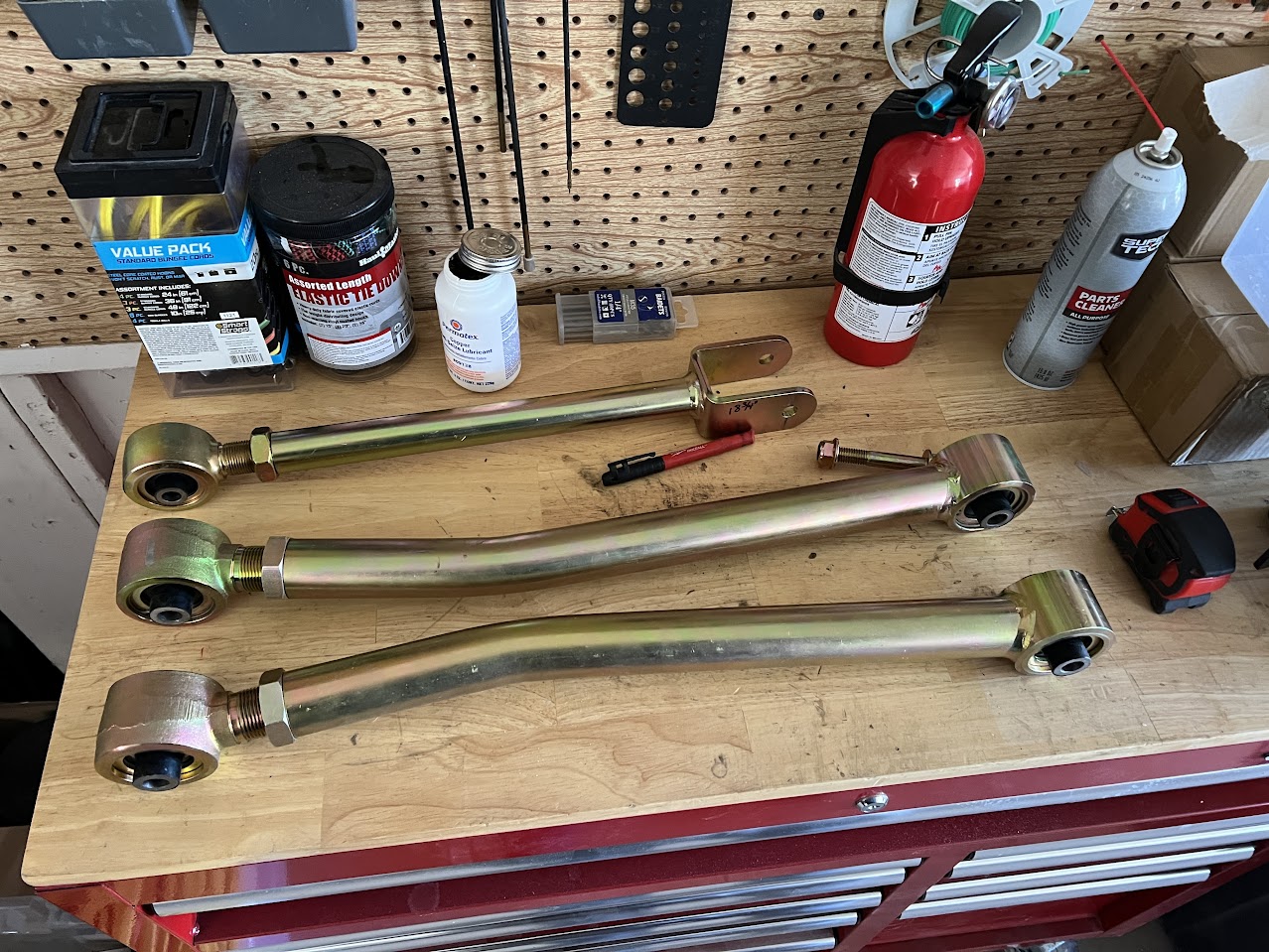

I got back from my work trip to Tampa and decided to take a few days off of work to get the Metalcloak lift installed. First up was double-checking my inventory and then pre-setting the arm lengths according to the MC instructions:

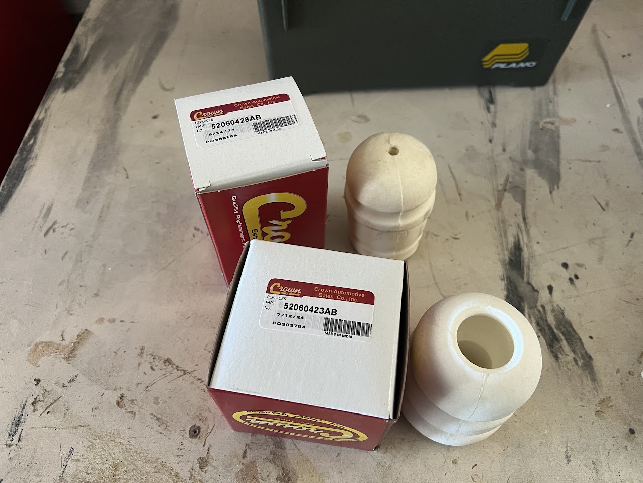

New Crown bump stops since my fronts are totally missing and the rears are crumbling apart:

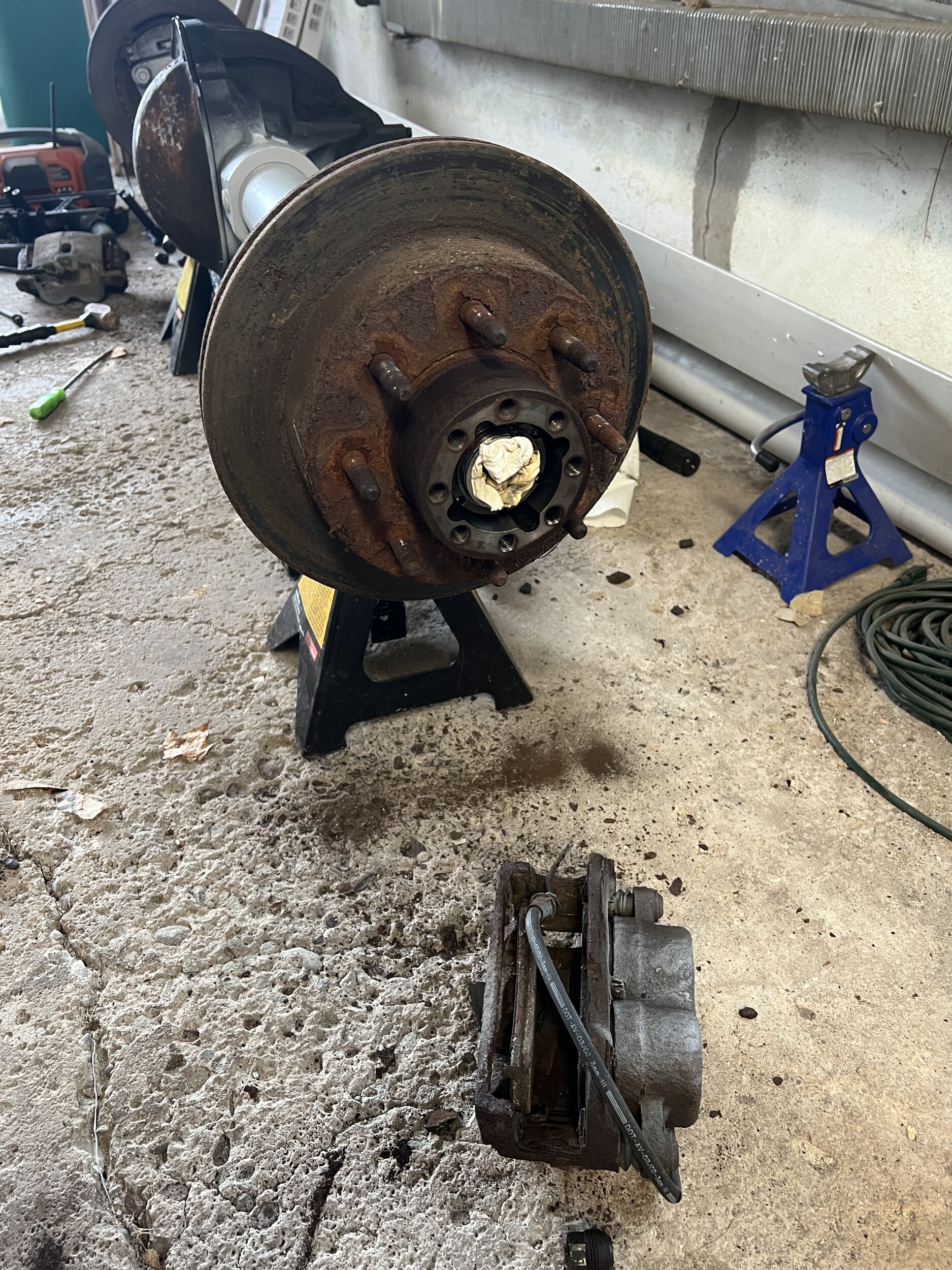

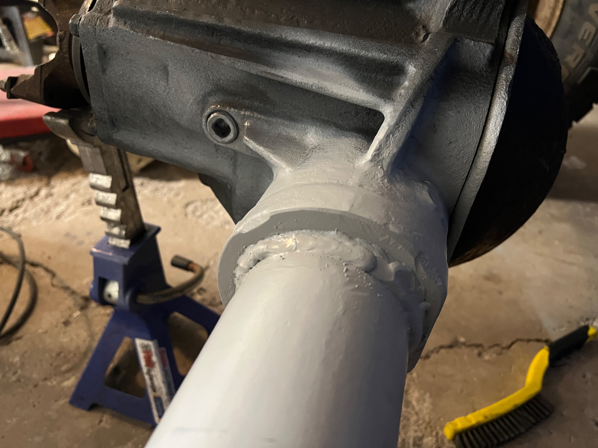

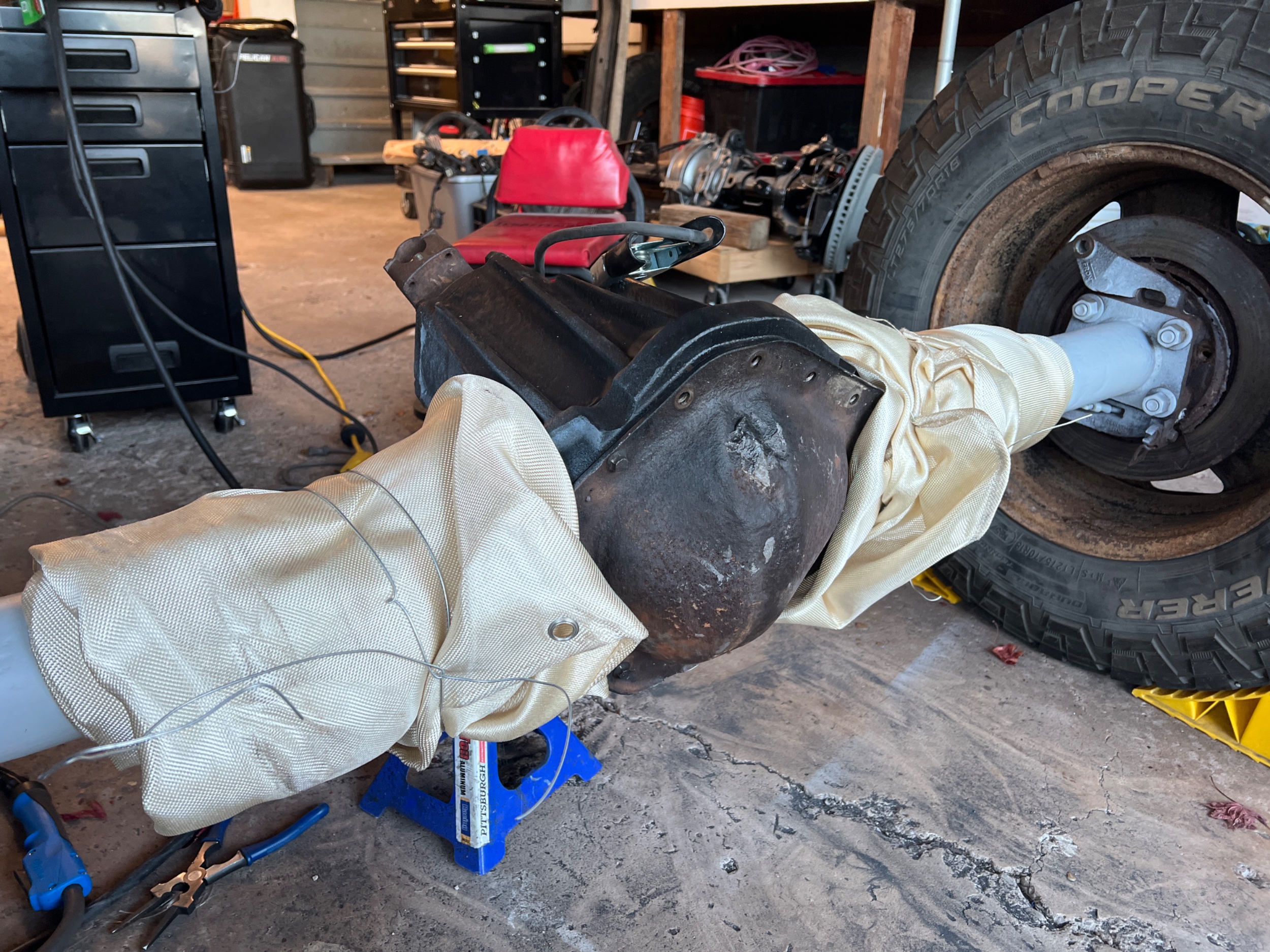

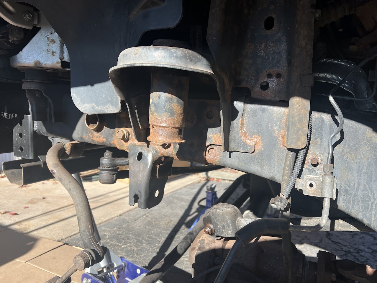

It took me a good bit of time to do the full install by myself, at least much more so than I thought it would. Truth be told I'm past the 40-year old mark and am slowing down a bit. Plus, I stopped a few times to run some other errands and get some stuff done around the house. I also spent a good bit of time cleaning up the frame and undercarriage. Here it is after some wire wheel and air needler work:
Nothing major again, but it did add at least 3 hours to the total install (for both front and rear) as I took my time and did a thorough powerwash and dry before applying rust-converting primer and paint. Aside from the two front brake lines (going into the hose) that did not want to rotate (I had to "twist off" the hose and reinstall the new MC hoses the same way!), the install went incredibly smooth.

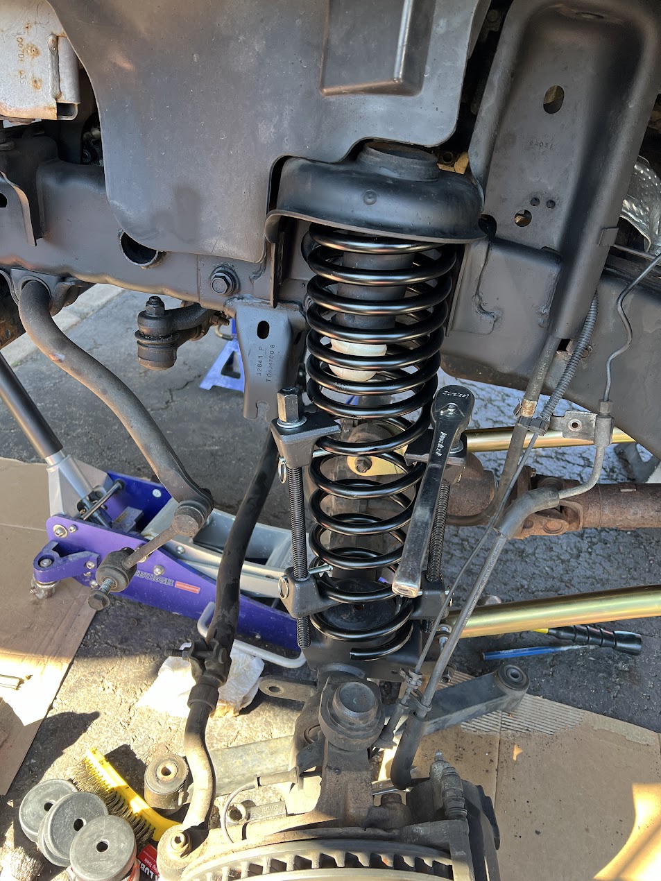

The only major unexpected thing was when I was installing the springs. A lot of people say you can install these springs without a spring compressor. I didn't feel like disconnecting the speed sensor wiring (worrying about damaging it, given its age) or pulling/hanging the calipers, so the compressors certainly made life easier:
Thankfully there weren't any rust or corrosion issues that prevented disassembly. Overall, I got to the point of bleeding brakes and centering the steering wheel after about 11 hours of total work.

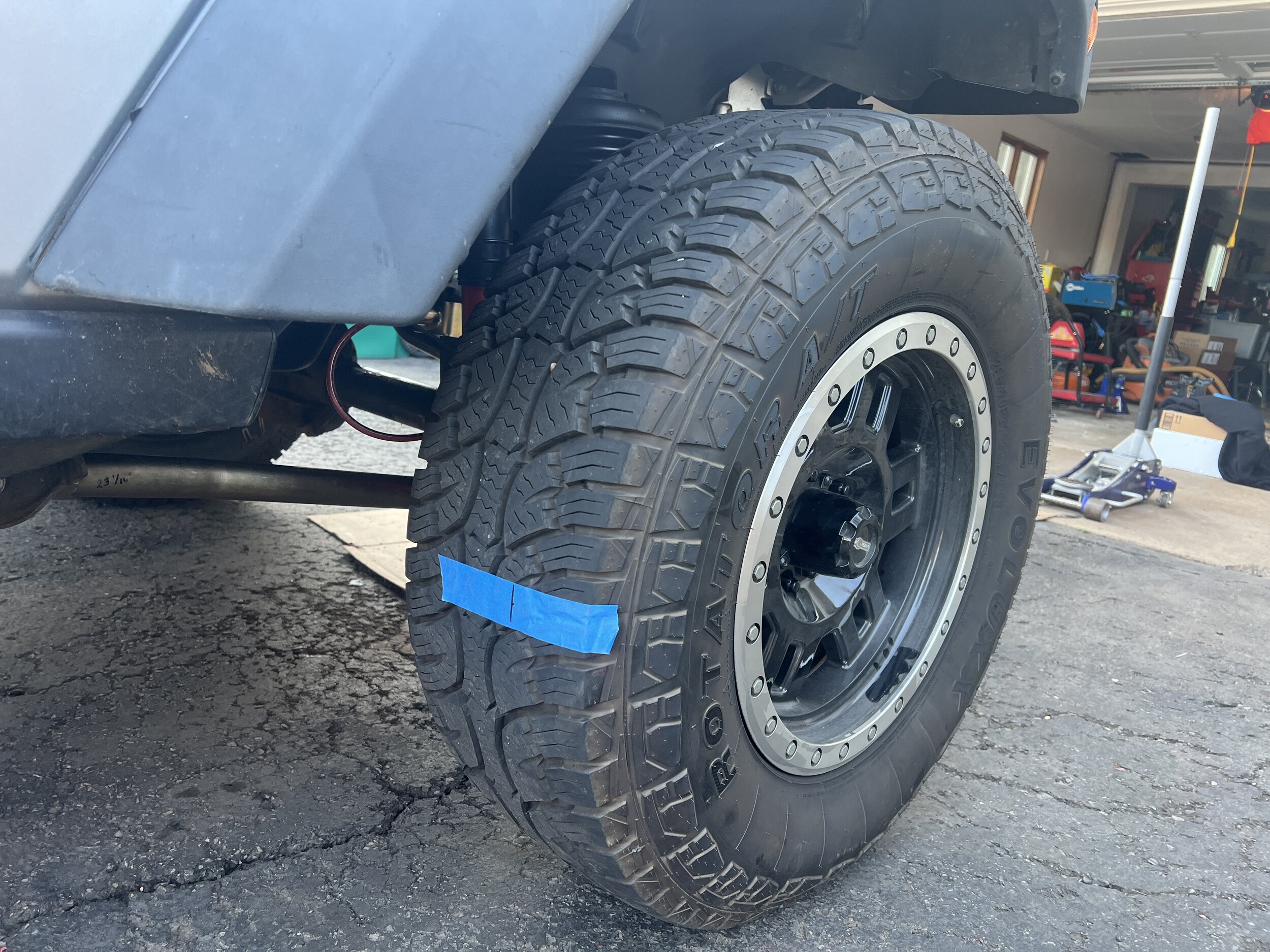

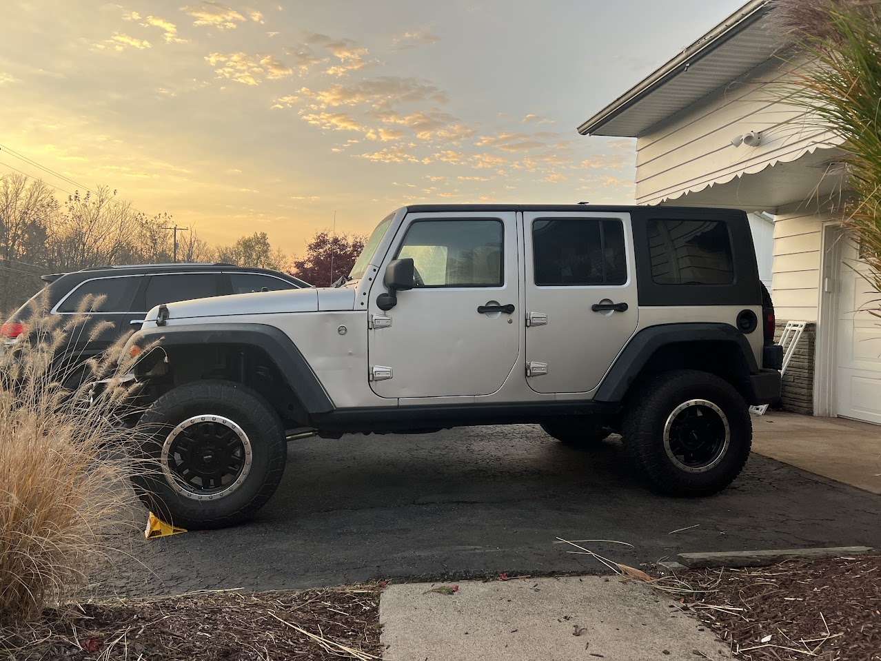

After the first test drive, I'm really happy with the set up! I no longer have to bite my teeth together to brace myself when coming up the driveway, or going down certain roads waiting for the suspension to bottom out. I was worried that the 2.5" springs were going to look like I skipped leg day too many times but overall I'm not upset with how it looks in the short term. The backspacing on these wheels help push the edge of the 285/75's out to the edge of the fender flare, and their slightly larger size helps a bit. It would look better with a set of 35"s slapped on there, but such is life
She'll be wearing a set of 37-38"s soon enough (once I swap the axles this spring), though if I find a nice set of 35"s, I would consider doing a short-term swap (again, these wheels are likely going to my daughter's rig when I'm done with them).
