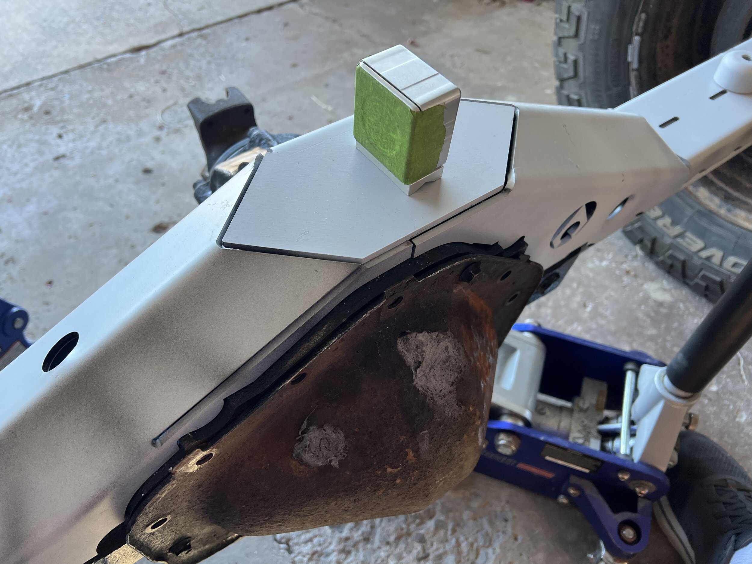

From everything I've seen, plus commonsense, and confirmed by Artec, it seems the best way to do this is to center the Apex truss over the center chunk for best fit, tack in place on all corners, then burn in deep. At that point, it seems that it's best to set the pinion angle, which appears to be ~6-7° for nearly every JKU running tons with 3.5-4.5" of lift...
Once pinion angle is set, you level the spring perches, tack in place, then go nuts.
I've "paused" welding in the plates until I confirm a few things, particularly clearance between the upper link mount and the parking brake backing plates. This means I'm working on disassembling the hubs at the moment and while I'm here, I'm confirming what wheel studs work best. I've ordered two 10x boxes of a few popular Dorman options, though I think Dorman 610-194 will work best.

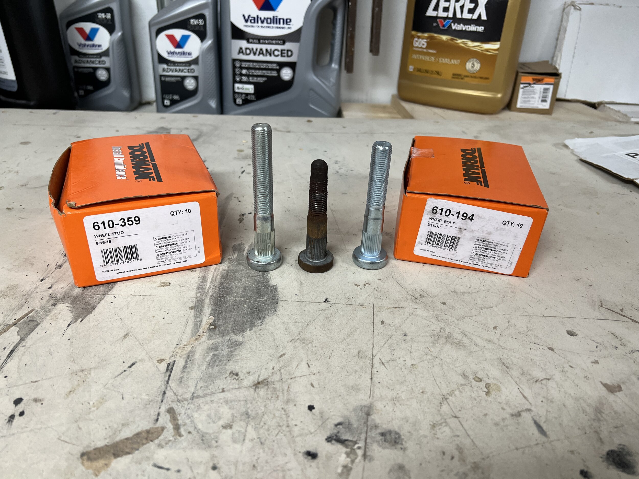

The studs I ordered finally arrived, two days late but just ahead of the storm. As you can see, the 610-194’s most closely match the original M14 wheel studs, but in 9/16” thread:
The 610-359, which many on Pirate4x4 said was their stud of choice, would appear to work as well, but is really long. The shoulder diameter (ahead of the knurling) is also slightly larger than the shoulder diameter of the OEM studs and 610-194 studs, as well as larger than the knurling diameter (not sure how that works but I checked multiple studs to confirm). This means that the 610-359 studs would possibly require the stud holes in the hub to be drilled slightly larger.

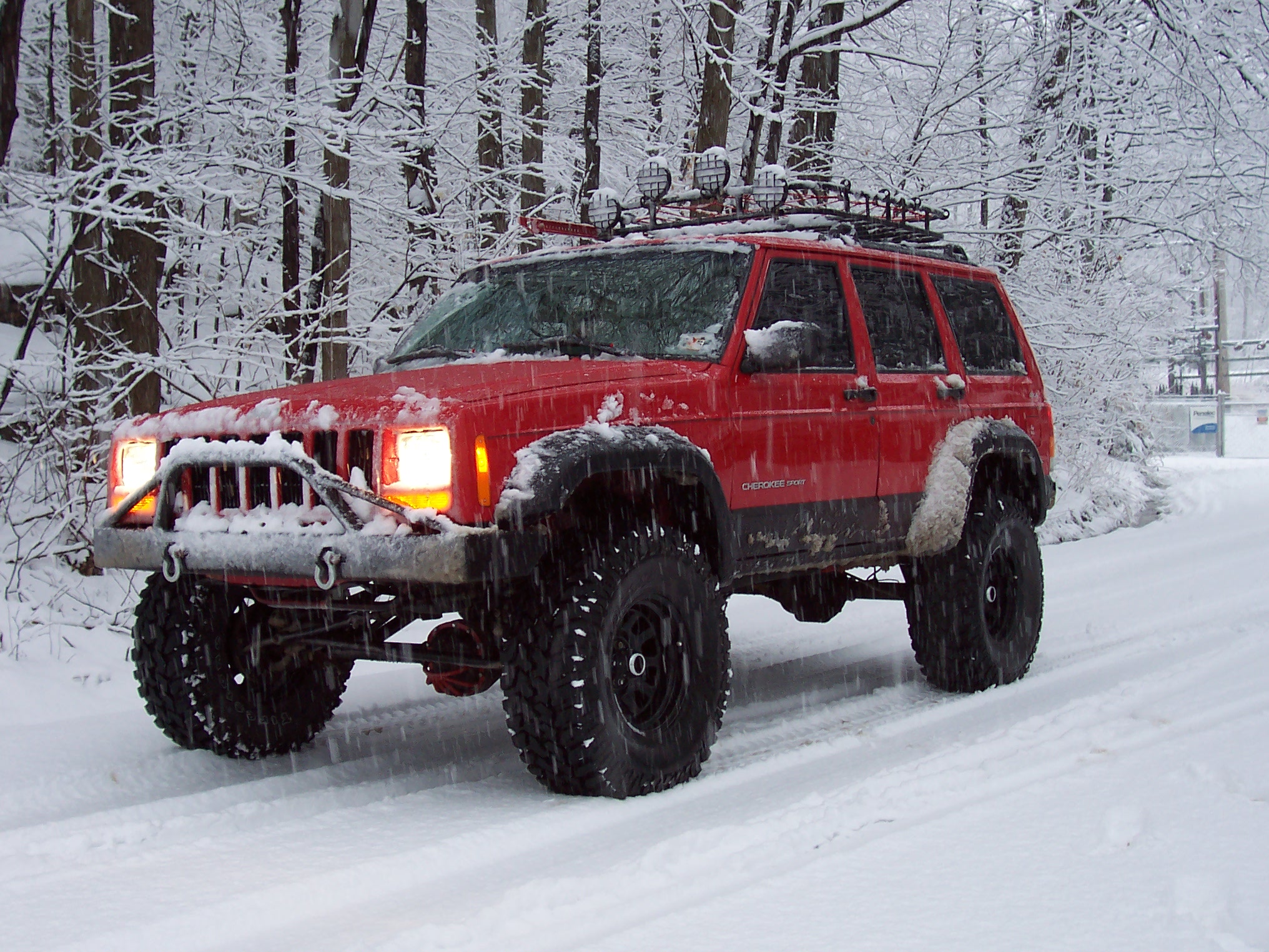

This is something I know well; when we lived in AZ, we frequently took trips up north to go skiing and all my Jeep buddies could not understand why I was taking "Suzie" (my Outback R above) instead of my Jeep. We would pass stuck SUVs, Jeeps, pickups, and cars running standard SL tires stuck in ditches time and time again. It got to the point where my wife wouldn't even get nervous and would nap on on the drive up to Flagstaff/Williams, a true testament to how well it performed...
The problem is of course that no one makes true "snow tire" in sizes meant for lifted Jeeps/rigs. The best we have are a handful of "M+S" (mud + snow) rated SL and A/T tires, as well as a few decent 3 Peak Mountain rated A/T tires. While these offer some improved traction during "normal" snowy weather driving, and provide a bit more grip on icy surfaces thanks to increased sipping, they tend to suck when it gets deep (just like you said).
I've found over the years that A/T tires will pack with snow in the centers and that packed snow acts like a "snow glue", gripping at the fresh snow below, giving decent traction in slow moving use. However, when it gets icy out, the "glue" effect doesn't work at all. Alternatively, when slushy, that packing effect also doesn't work at all and the tires float on top of the slop without being able to dig deep into grippy snow.
A M/T tire on the other hand has a paddle effect and will cut/claw through slop and the deep stuff much better. This became apparent to me early in life. On my XJ above (circa 2004), M/T tires never let me down when it got deep (and living in central PA, we got plenty of opportunity to test!), though I did spin out a few times on side streets and when driving from campus to work (AutoZone).

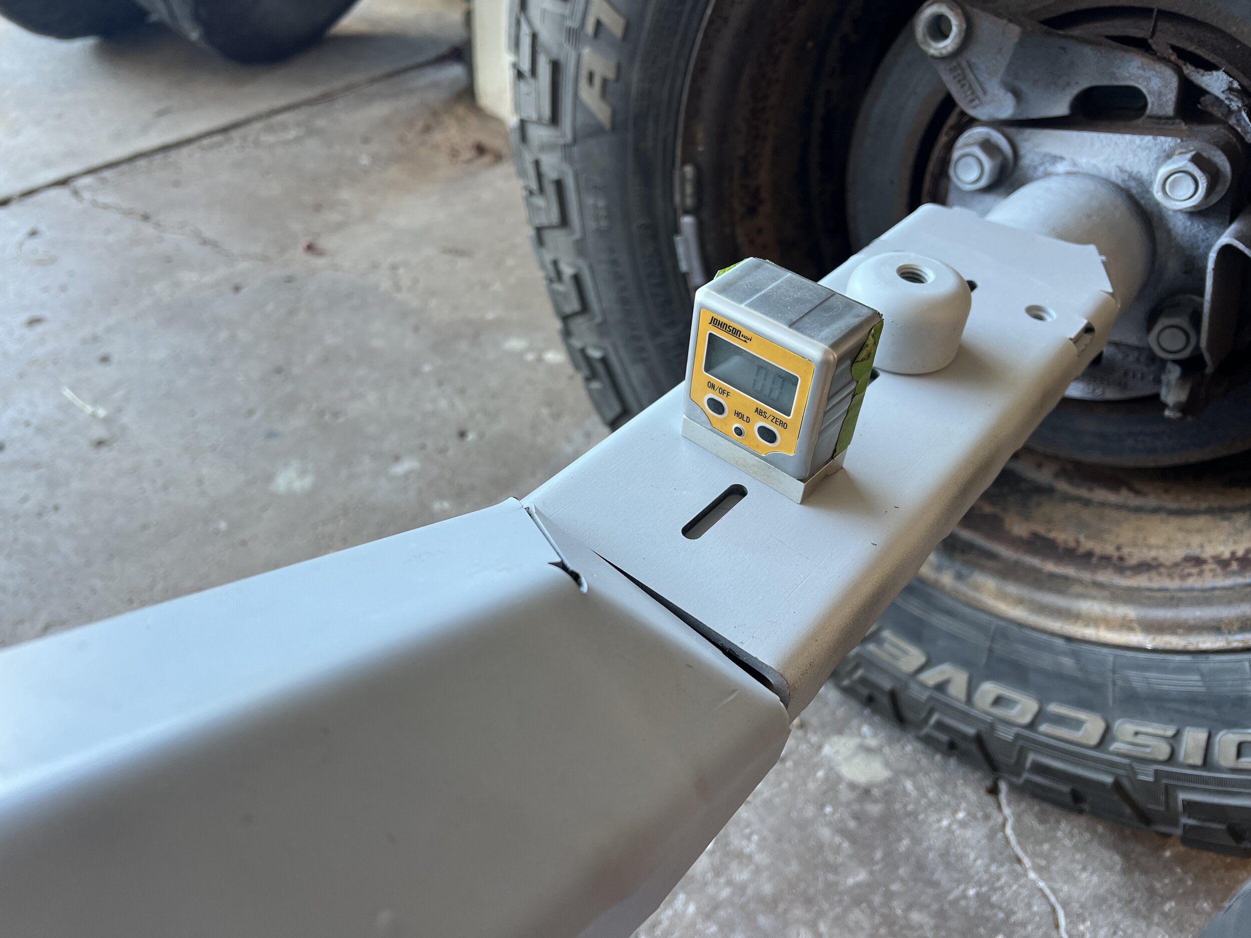

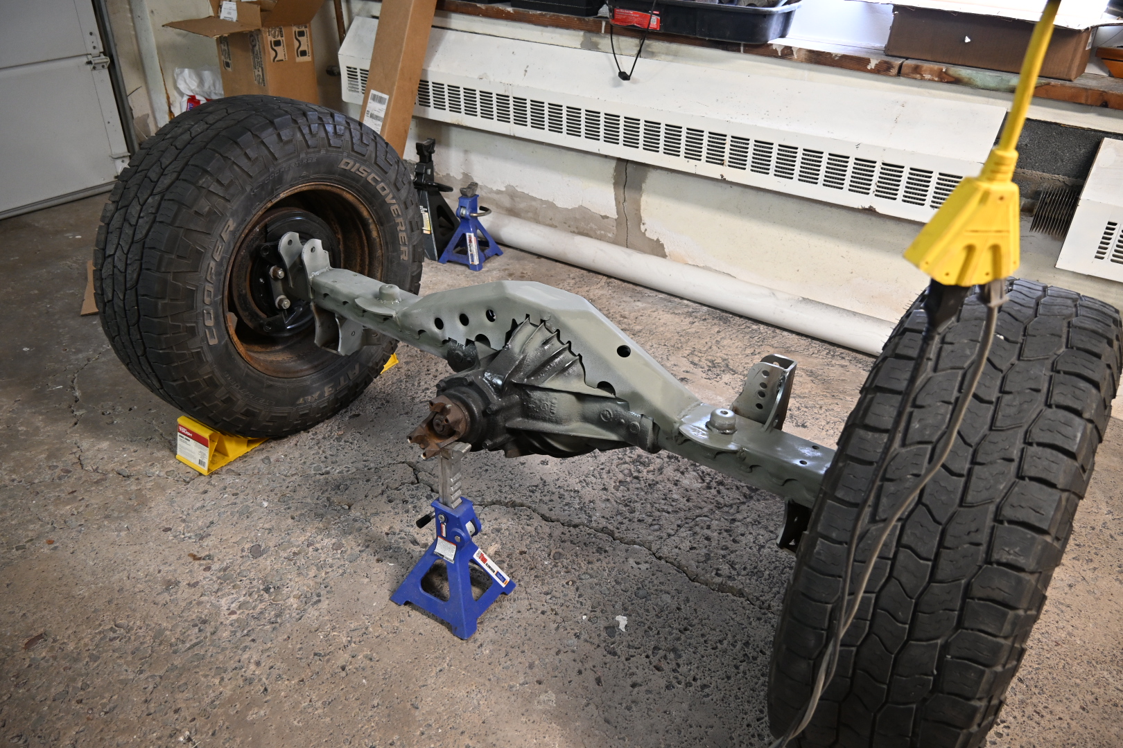

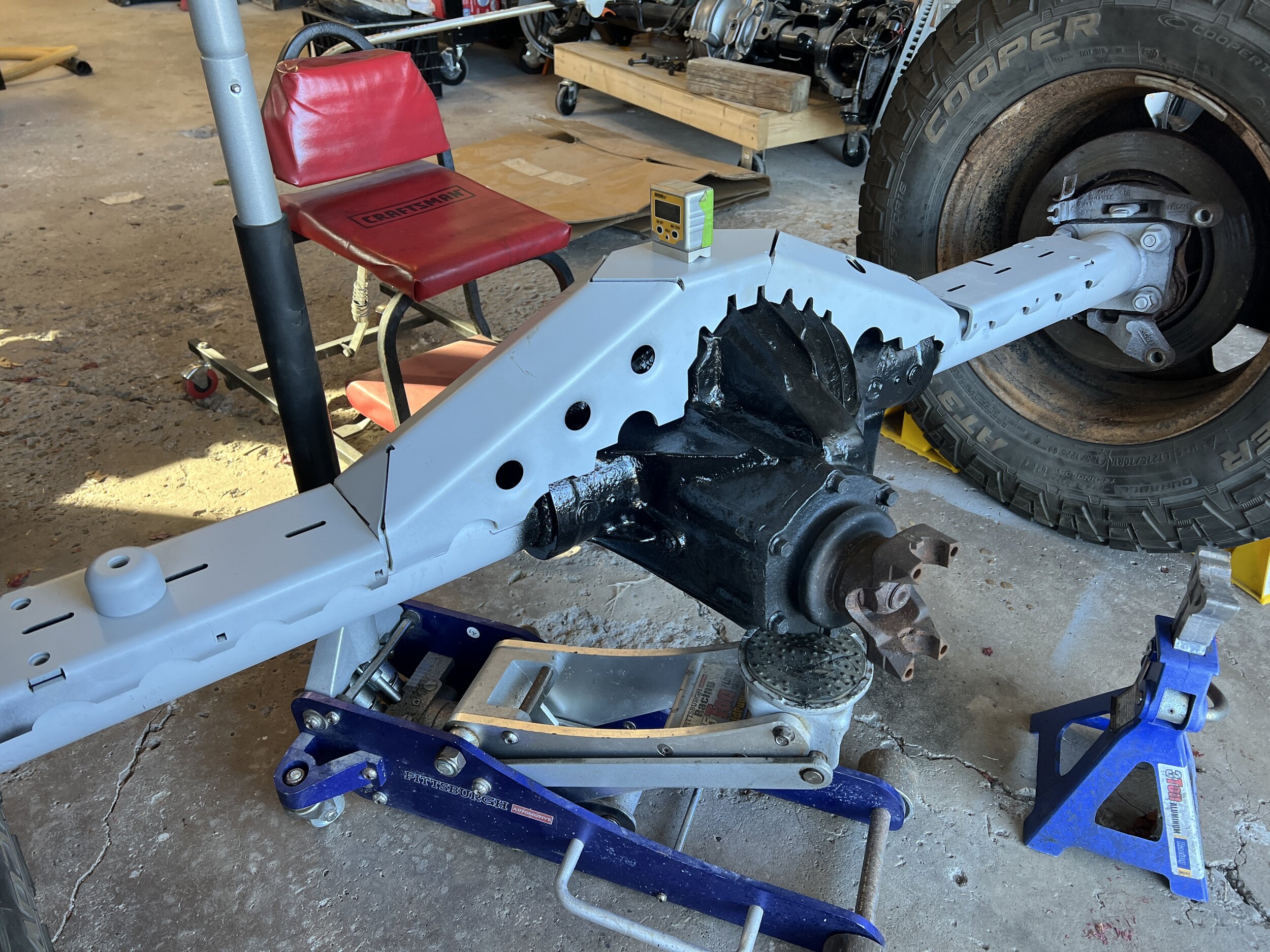

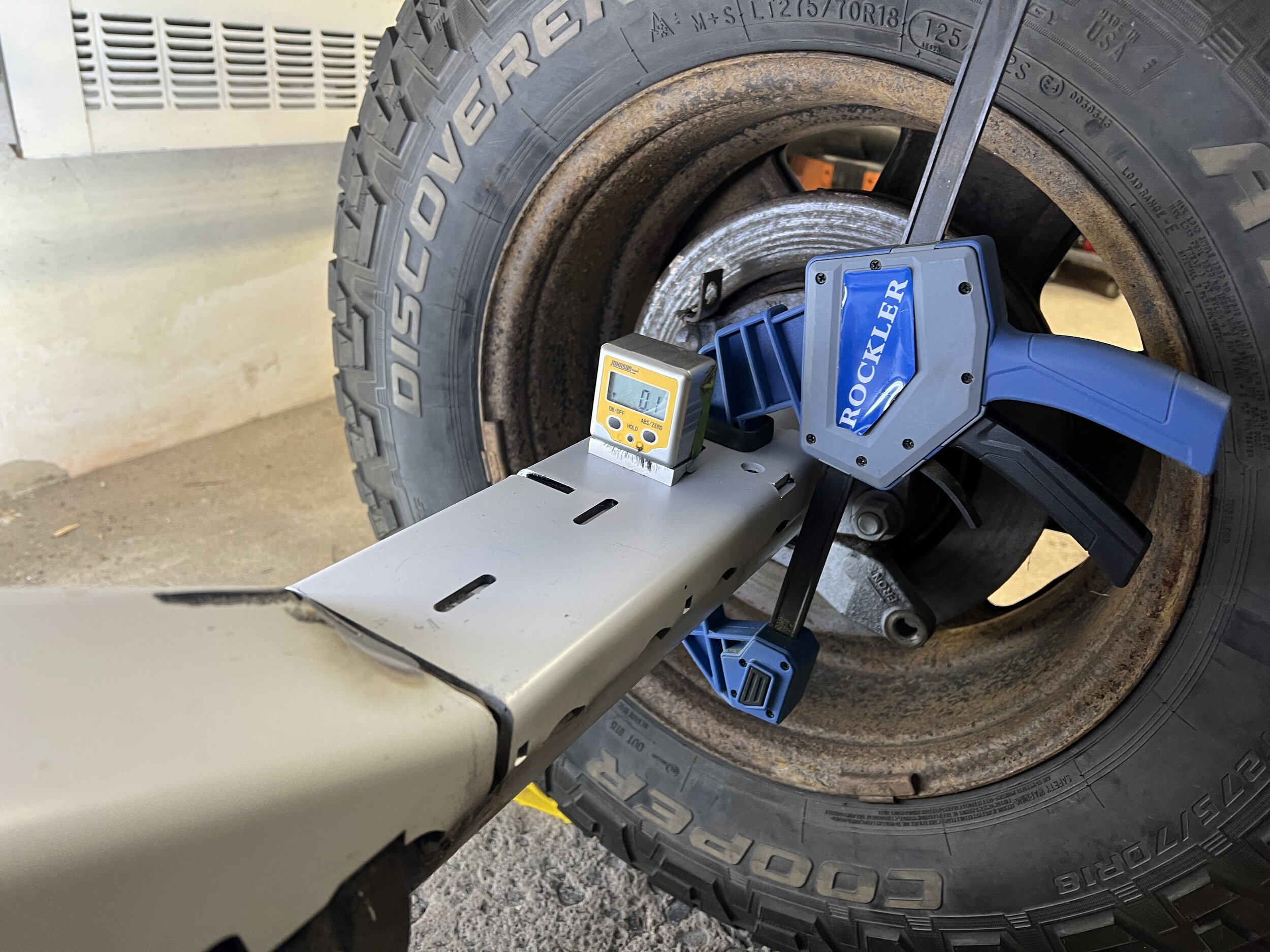

Had a quiet afternoon with a few cancelled meetings, so I decided to get the truss at least tacked in place to make me feel better…
I set the pinion angle to 7° based on seeing nearly every person say that this was about perfect for a 14B on 3.5-4.5” springs. From there, I leveled the the spring plates and clamped them down and starting tacking everything up…
The center of the truss, the part over the pumpkin, is completely welded to the tubes. The spring plates are tacked in a few spots and in the morning, I’ll verify angles once more and go through and burn everything in! From there, I’ll go back and weld up the seems on the truss itself. That’s likely all I’ll have time for before having to stop and pack, but I’ll at least be able to close the garage door with a few more things crossed off the list…

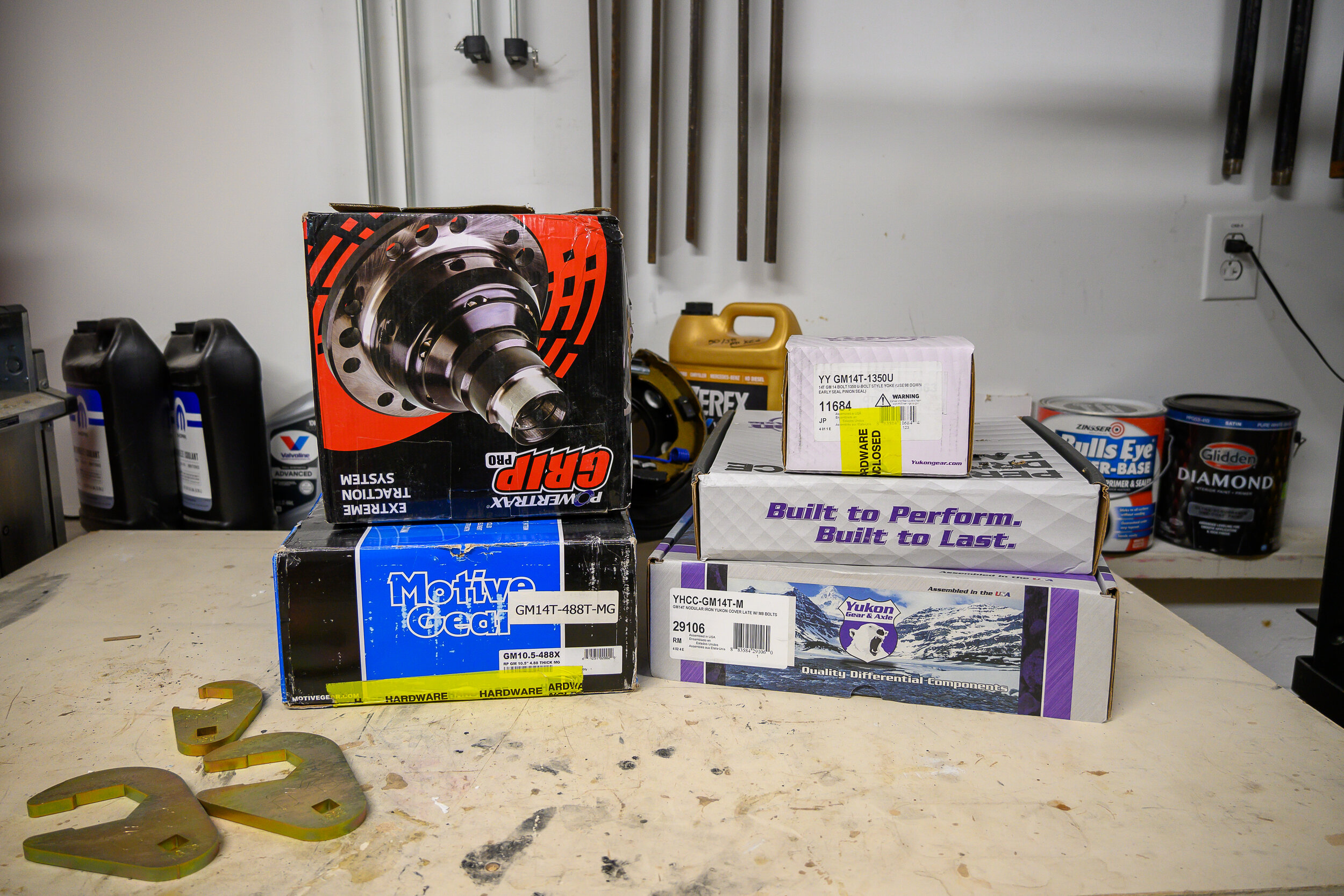

The last of the parts I've been waiting for have arrived... I'll get to regear the 14B as soon as I'm done with the axle brackets.
I ended up going with the Richmond Powertrax Grip Pro. It's comparable to the TrueTrac, which I've used plenty over the years. There was a decent price savings (about $175), though that honestly wasn't the driving factor. I really just wanted to see how the PowerTrax compared and the guys at ECGS said they've had nothing but success with it.
I also picked up some Metalcloak Crow's feet while they were on sale. It breaks my heart to spend near $90 on a few pieces of steel, but it is what it is...

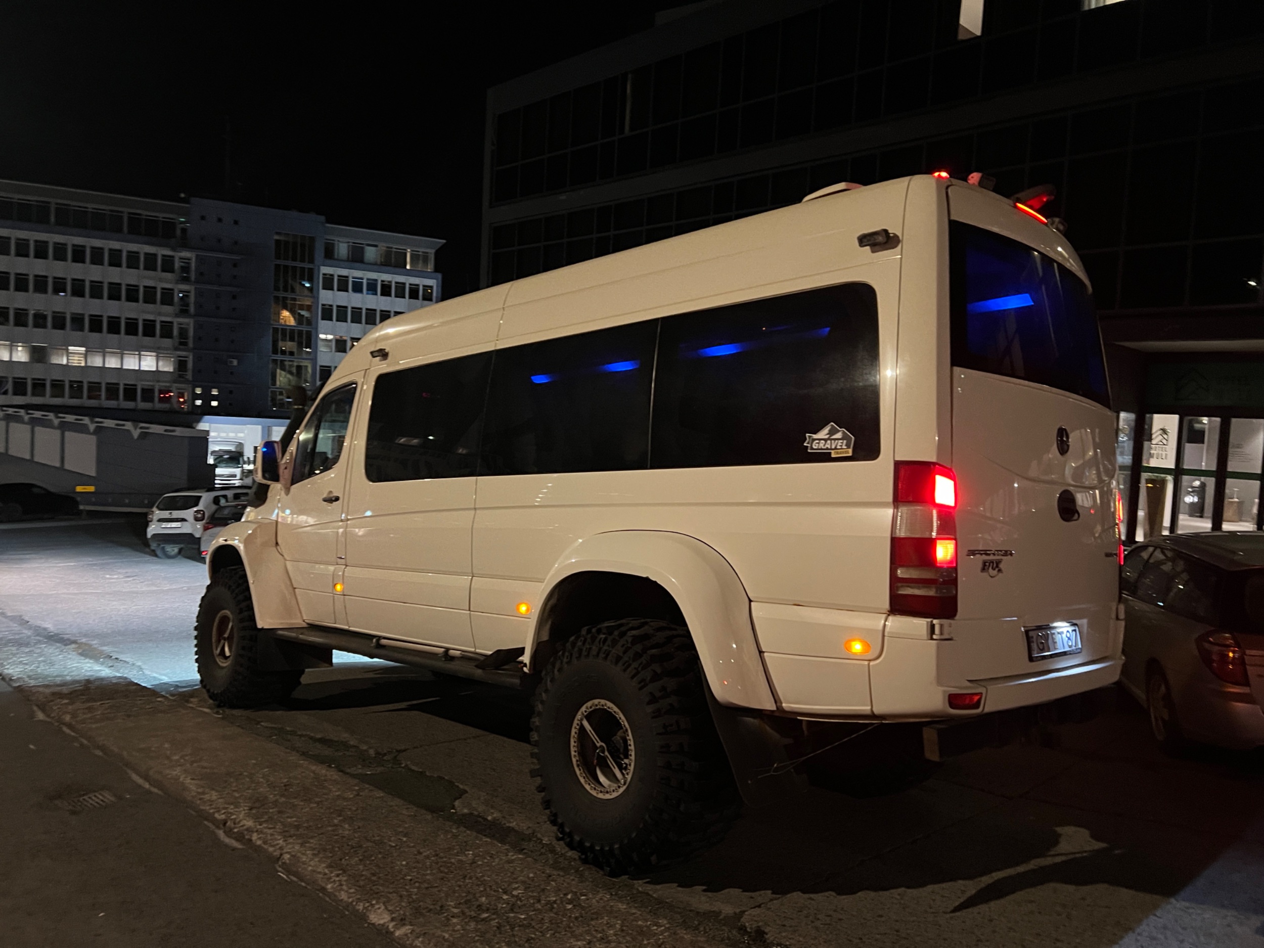

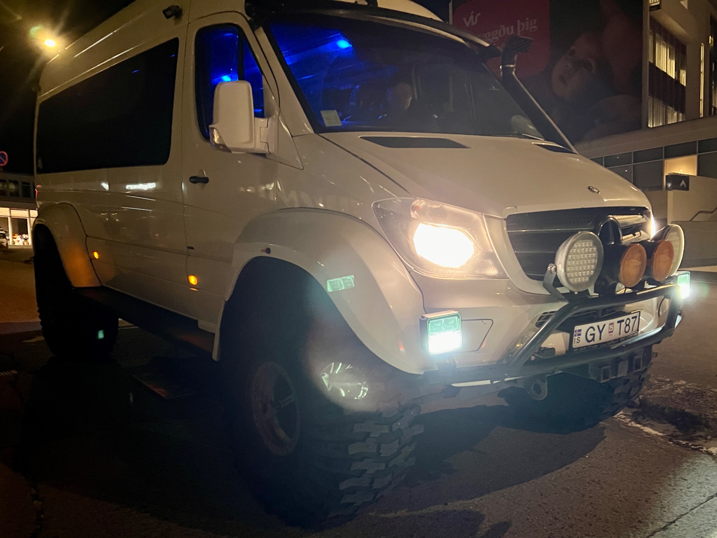

Well that answers the question of “what would I drive if I moved to Iceland?”…
Lots of cool rigs here in Iceland, but the one I’m most jealous of are the diesel Land Cruisers:
Not many Jeeps here. In fact I’ve only seen one, a JK Rubi on stock tires and wheels. There is a Suzuki Jimmy, what looks like a modern Samurai and I kinda want one of those too (lots of fond HS memories bombing through the woods in a old ‘Suki on 31” M/T’s

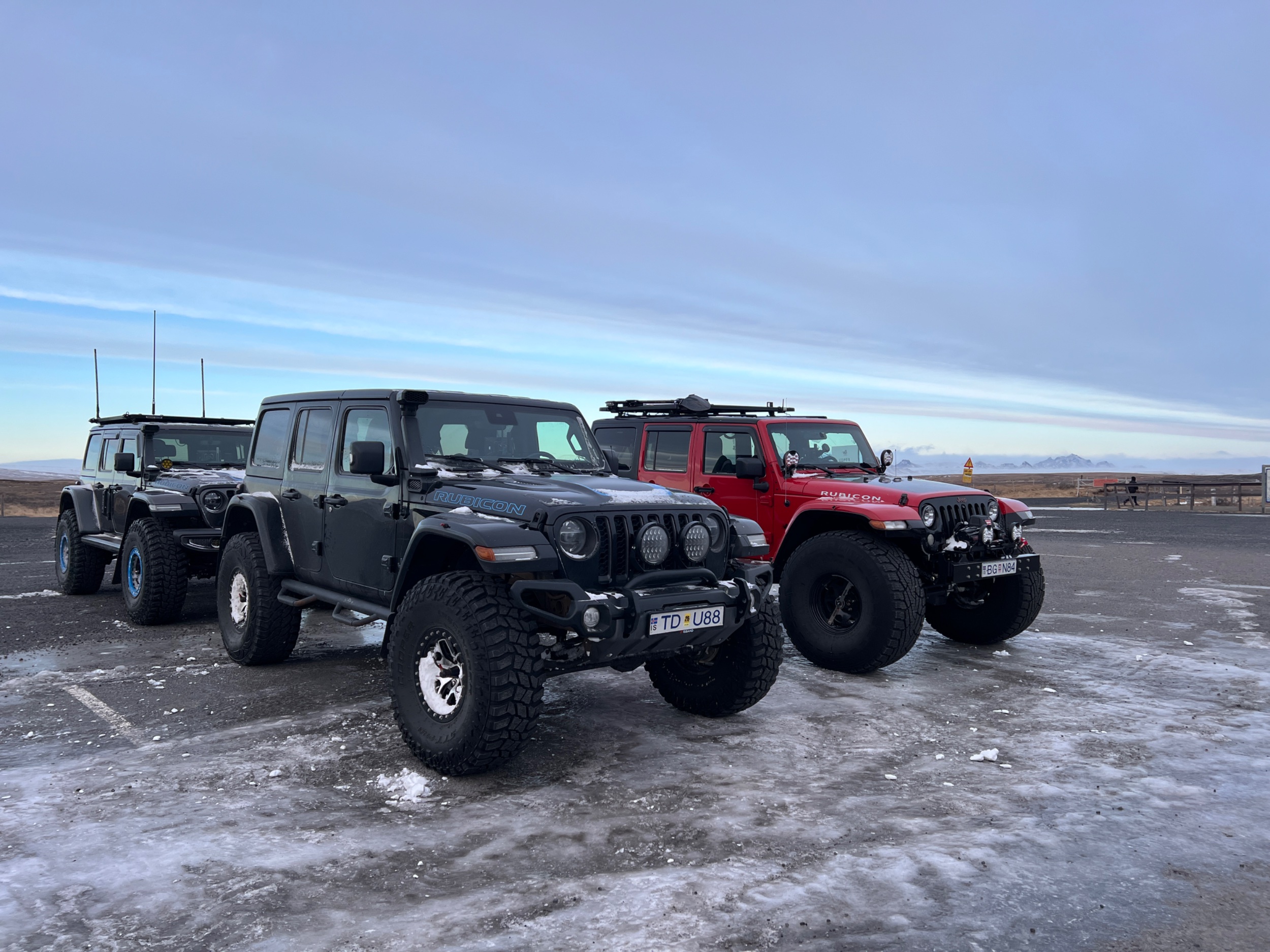

Found them after all… Apparently these are called "Super Jeeps", even if they aren't "Jeeps".
Some other cool Icelandic rigs and just general cool trucks during my visit:
I need to do some reading up on wheeling up there. Some things are a little off from what I was expecting. For example, many rigs had snorkels on the intake. Don’t see how that would help here and can think of a few reasons why it would be less than ideal.
One thing that stood out - and what confused the owner of one of the Jeeps who I struck up a conversation with - is that all the rigs use factory axles. Even that big red rig used what appeared to my eyes to be stock Rubi 44’s, all on 45” tires! I mean, they’re not really torque loading these axles up much, at least from what I can tell (any Icelanders please chime in!!), so they should survive. But that said, if I’m running across glaciers in sub zero temps on a part of the island where you only have a few dozen people, I’d probably want an extra level of beef.

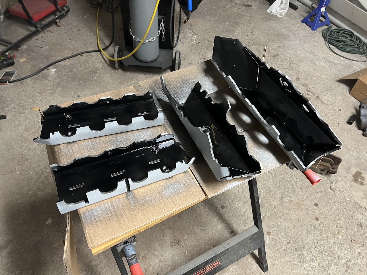

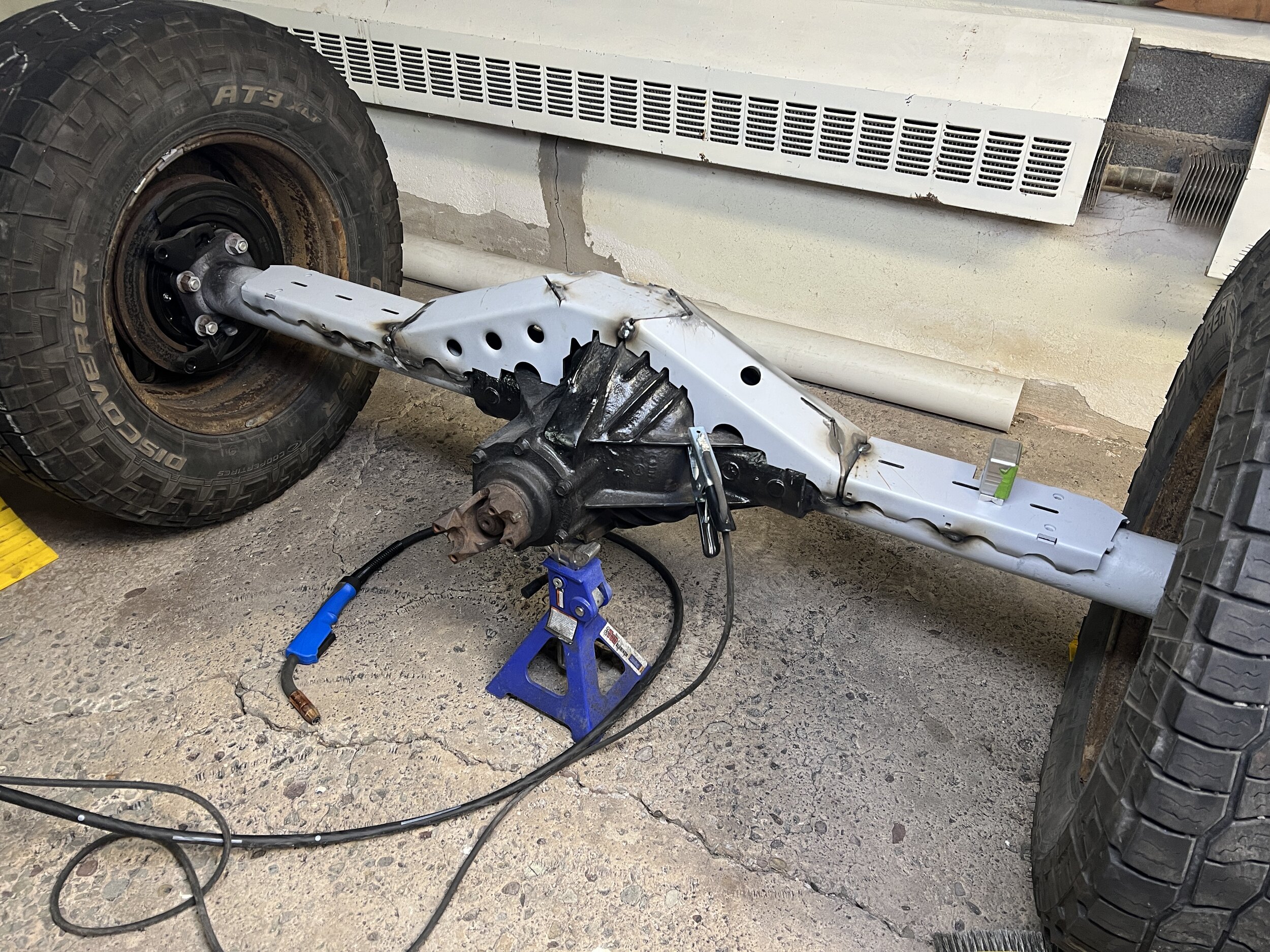

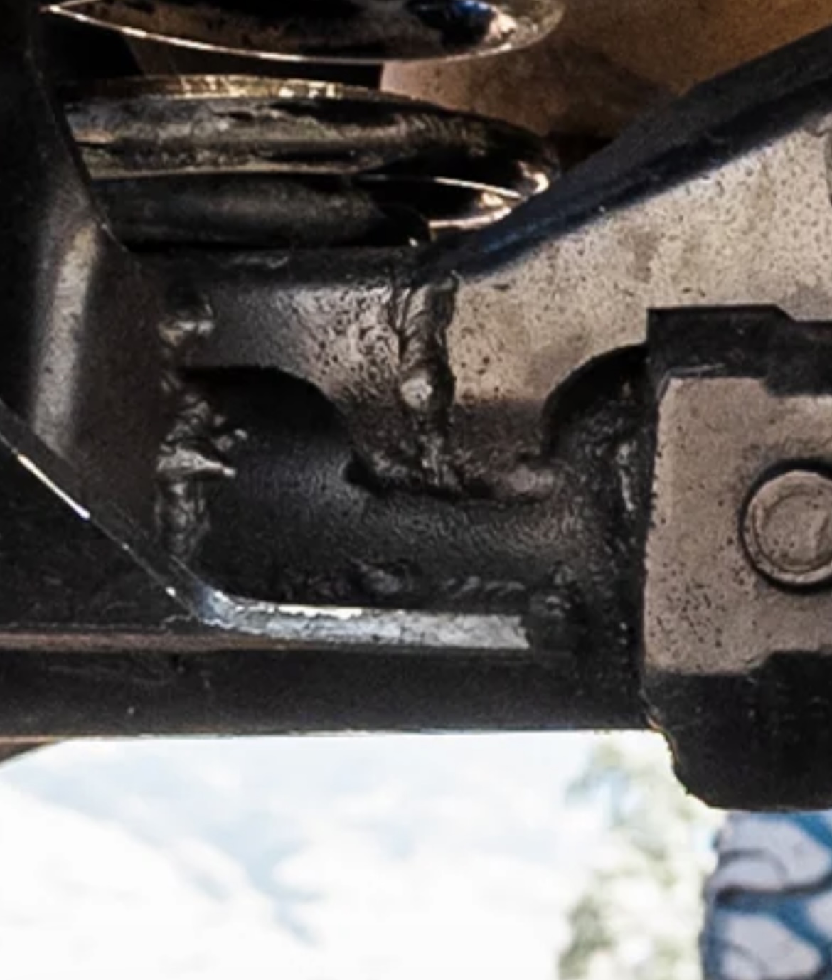

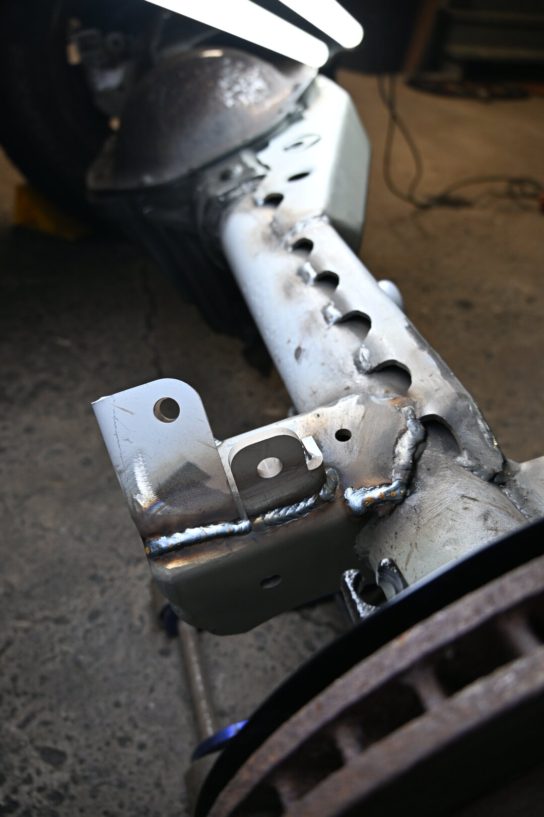

Finally - FINALLY - got all the welding done on the Artec truss and brackets.

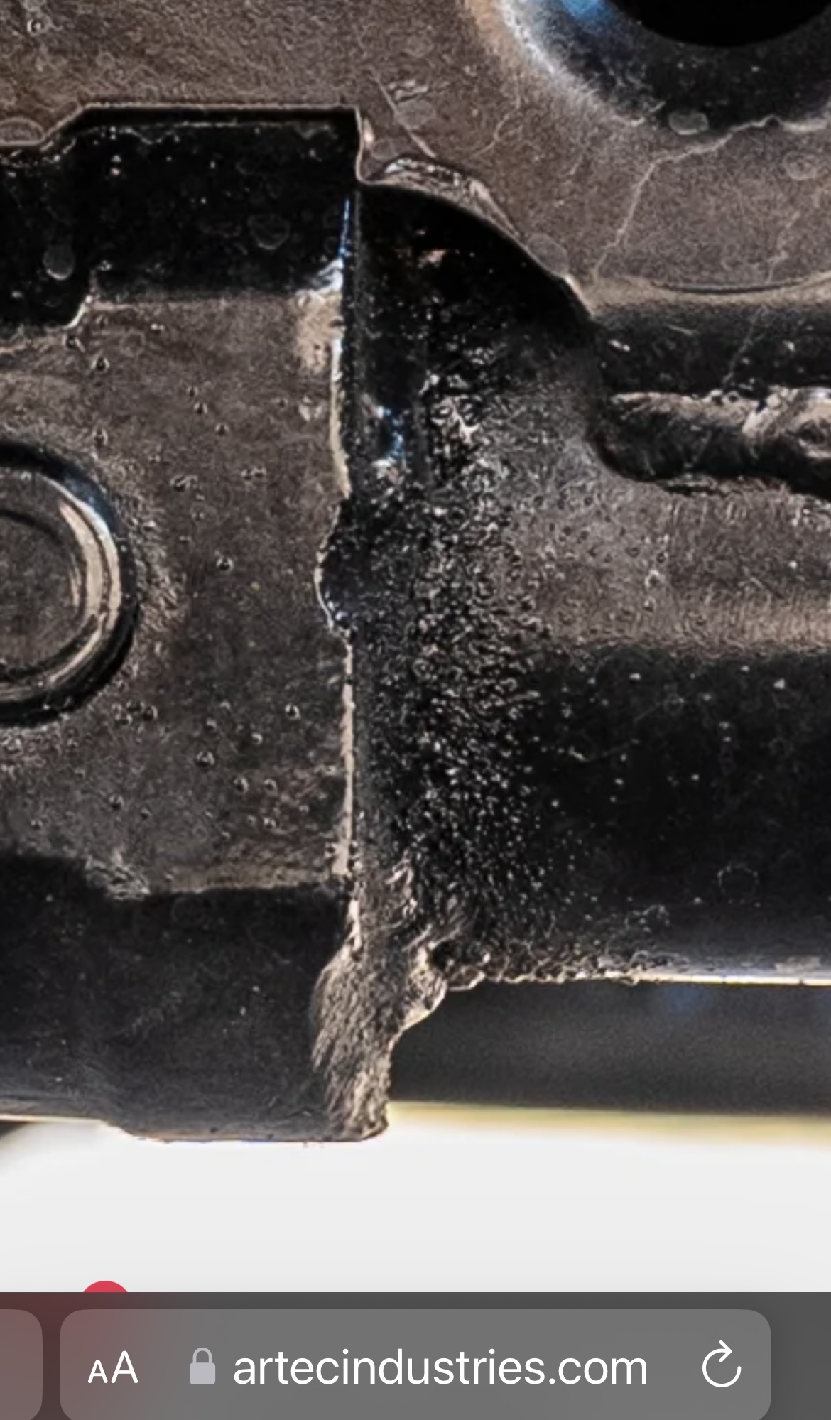

I always get self-conscious posting my welds, but then I remember that these are the welds posted on Artec’s page…

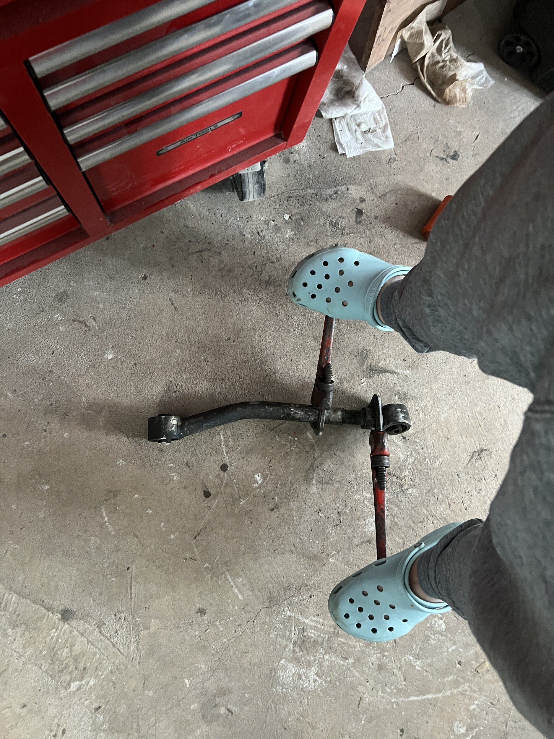

Picked up a set of lightly used MetalCloak control arms - figured I’d have a spare set that I could keep ready to go, then swap out as needed during the recommended yearly maintenance and greasing…

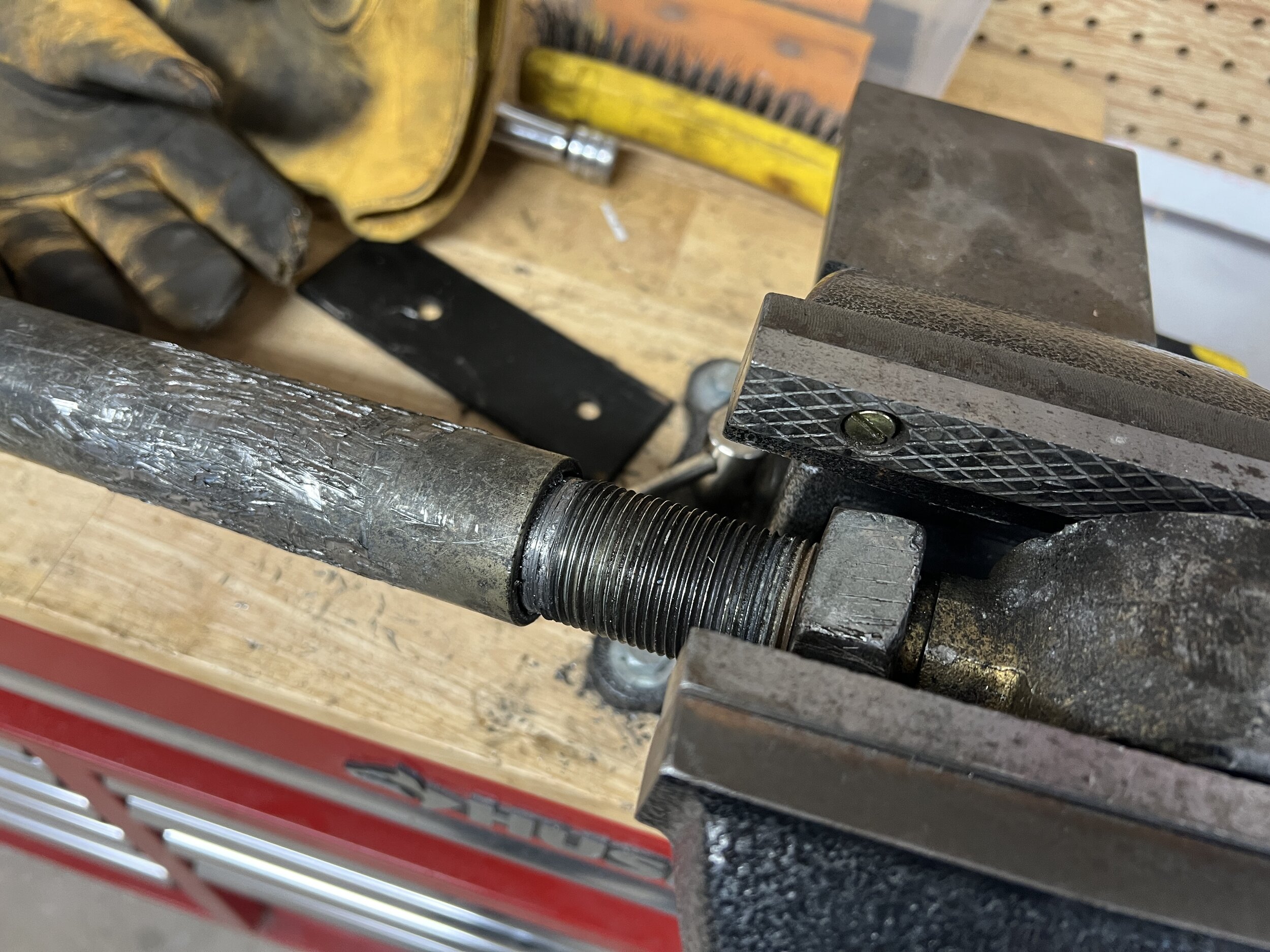

The first arm I took apart gave me fits - stripping one of the joints:
I literally had to stand on the wrenches to get the joint moving (I’m 6’3” 350#!}:
Thankfully, all the other arms and rear trackbar came apart super easily. I’ll need to keep an eye out for a set of upper rears to replace this one, or maybe see if MetalCloak will just sell me one…

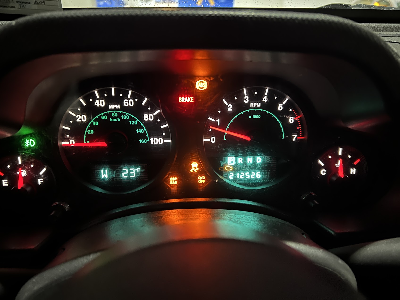

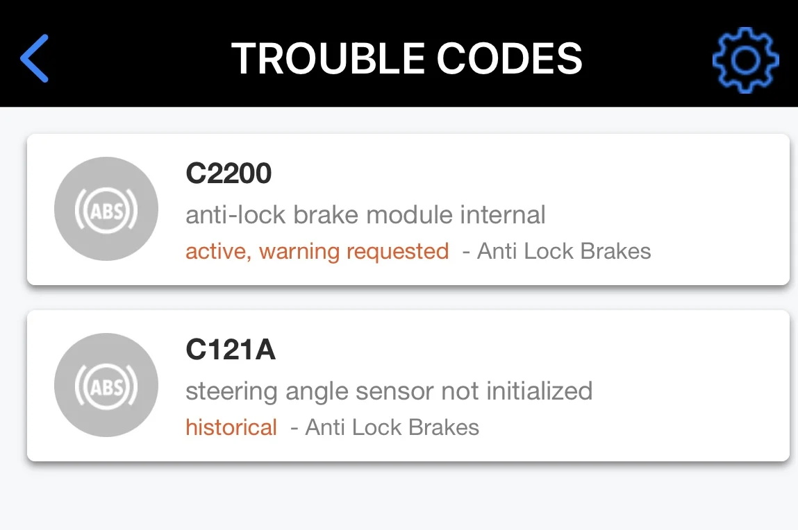

I did run into a slight issue with the Jeep. During one of the snow storms, I was coming up my steep and freshly covered driveway. It caused the traction control to engage, and likely the BLD, and eventually made it up without much issue. About a day or two later, I was driving my Jeep to the school to pick up my son, and the dashboard lit up like a Christmas tree...
I thought maybe I had ripped out a sensor while I was slingin' snow getting up the driveway. I did a walk around and nothing looked wrong. Parking and turning off the Jeep reset everything and it appeared fine. However, now every time I drive, once I get above 10-11 mph, the Christmas Tree lights up again. It was extra cold and a snow-filled few weeks, so I figured I'd just let it go and deal with it once the cold snap ended.
Fast forward a few days and I was driving through town, stopped at a stop light, and my horn started blaring, my windshield washer pump squirted for 2-3 seconds, and the wipers started. By the time I realize wtf was happening, it all stopped. However, the transmission would not shift out of 2nd gear. It would go into PRN and D, but it would simply not shift out of 2nd gear in D, 2, or 1 on the shifter.
A few days later, while I was parked in my friend's driveway, the horn started blaring, washer pump sprayed almost the entire container dry, and the wipers were going nuts. The Jeep also turned the motor off. I turned the key off, everything stopped, and when I restarted, it was like nothing happened.
Needless to say, I haven't been driving the Jeep for a little while. Now that it's supposed to warm up a little bit (yay, no longer single digits!), I've pulled it into the garage to let it thaw out some and hope to get to working on it. Based on what I've read, the likely suspect is the clockspring. I'll be ordering a new one shortly and hope this fixes the issue. I've heard that the TIPM could also cause similar issues, though all indications here suggest the clockspring is the most likely problem. I did use JScan to check the steering angle and there were a few times where the angle did get erratic and bounced all over the place, though it mostly acts like how you would expect - further evidence that it's like something internal. I'll replace the turn signal stalk while I'm in there, since it doesn't want to "lock" when turning right.
